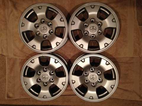

Hi guys ive found a good deal on a set of 09 TACOMA wheels (16")
My question is do these wheels have the same specs as the stock 3rd gen 4runner wheels?
Same Backspacing?
Offset?
Bolt Pattern?
Thanks For the Help!

Bolt pattern is the same. Not sure on offset/backspacing. I'm sure it's very close. I know they will work though, there are a few people running those on here.
You'll prob need spacers. Actually went to buy a set for my 1997 and test fit one. They sit in to close to the vehicle. Plan on spacers
Yup, I don't remember what the backspacing is, but it is fine. I actually bought a set of those, then mistakenly thought they wouldn't fit with my lift and tundra brakes, but later saw a couple guys with these on, and they are fine.
If they are anything similar in offset to my 4th gen 4Runner wheels, you will need spacers up front. With tires on and without spacers, they were rubbing the upper control arm badly.
Max
I'm not sure about those wheels in particular, but I know the TRD sport wheels have way more backspacing than the stock 3rd gen wheels. My guess is these would be the same. Might be fine for stock-ish sized tires. Might not. I would say mandatory wheel spacers for anything wider than stock tires. Maybe run a 255/85/16 :D
