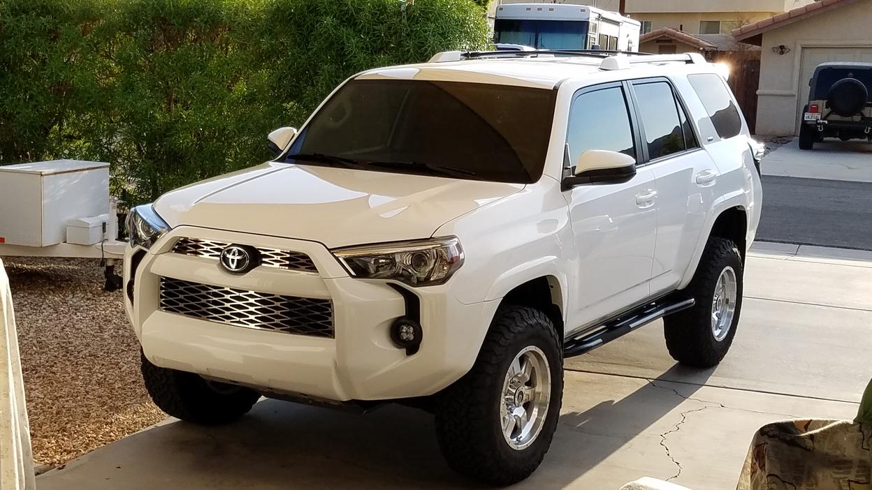

2010 t4r. 3" lift, 285/70/17

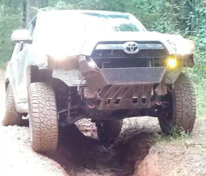

As you can see very handy for super fun ditches! Also notice I have clearance when flexed in back.
