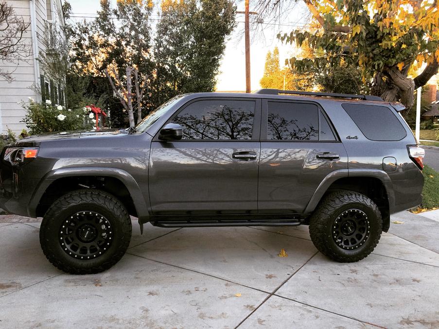

Thanks! I never took any before/after measurements of my lift, but I definitely don't think i got 3" from the 884 coils... probably somewhere around 2.5" I would guess. The SAW coils look like they did settle a little but i can't say how much... I do have some added weight (cargo drawers, sliders, skids, roof rack) since i originally installed my lift so that probably added to the settling.
Here's a shot a few weeks after i installed the lift, and it does look like it sits a bit higher than it does currently:

What's your center of hub to bottom of flare measurements? And from the ground- for shts 'n gigs.
I had them written down somewhere. I'll get them tonight and post it.
Found it:
FL
B- 20.5
A- 23
FR
B- 20.5
A- 23
RL
B- 22
A- 24
RR
B- 22.5
A- 24.5
I didn't do anything on the driver side as you can tell. So the driver side is about 1inch of rake and the passenger side is 1.5 rake. It's almost stock rake.
So for you the Sway a Way springs gave you 2", a half inch higher than advertised, yes?
