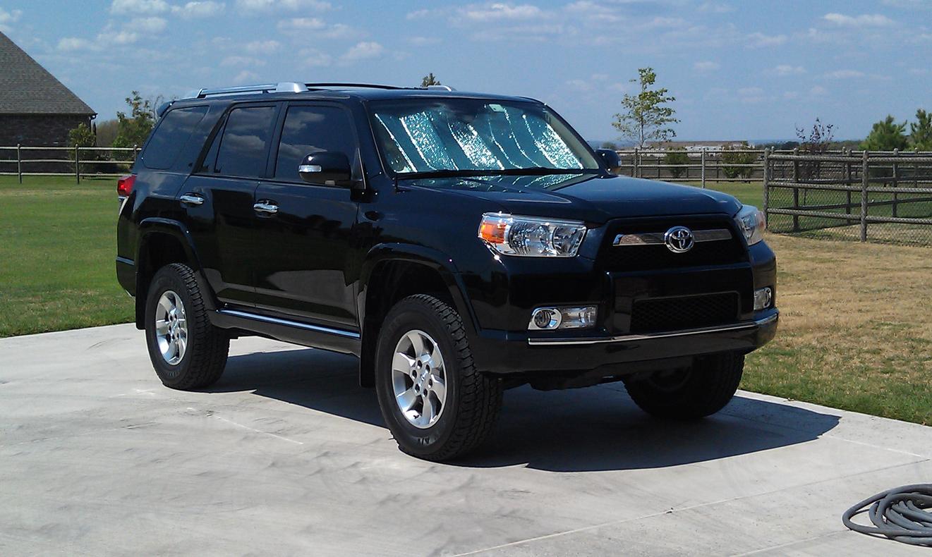

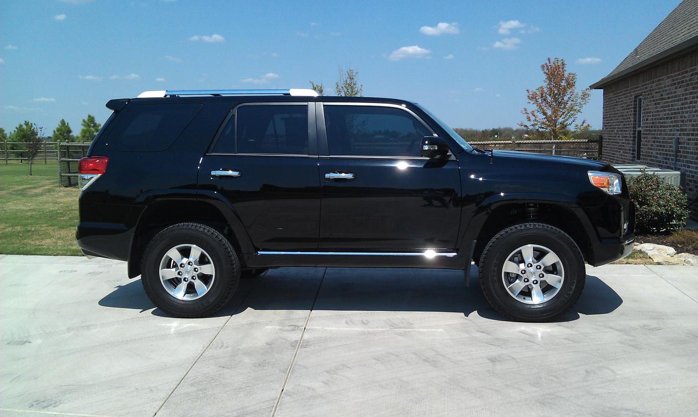

SAW 1.5" springs after 6 months
Here's a pic I took today...about six months and 8k miles on my lift (see sig). The SAW 1.5" springs have settled to about a 1.75" actual lift. I think it looks pretty good with my 275/70's. Currently about 37"f/39"r +-.25" at the top of the wheel arches:
Looks great KC. The last I measured mine I was still at 2"+, but I don't have the miles or the time you have but I think it looks great where its at.
