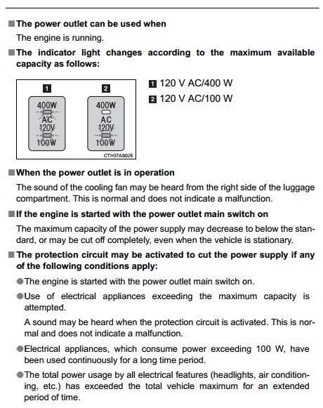

Are doing any of these things below to trigger the protection circuit? Are you Okki????? :)
Start the truck, push the button and the plug will work. The 400w light is while parked. As soon as you put it in drive the 400w light will go out and the 100w light turns on. Not sure Toyotas thinking on why they only allow 100w while driving. Still enough to power the cooler though.
The picture in the first post was taken while driving and I had been driving for about 7 minutes.

I will try to remember to test it out again later when I drive, but I distinctly remember the light switching to the 100W automatically once I start driving (and it does not go back to the 400W unless I turn it off completely and on again). I turn it on exactly the way you described too...I wonder if something is up with yours since it does not seem to be switching to the 100W setting even after driving?

When I turn mine on after the engine is running, both 400W (green) and 100W (orange) lights are on. The power to the phone charger will turn on in ~5-10 seconds after I press the button (I tested this a few times on the front and the rear outlet). When I switch the gear lever out of park, the 400W indicator goes out and the 100W indicator stays on (the phone charger does not seem to loose power during the switch).
Maybe something is wrong with yours since only the green indicator comes on?
