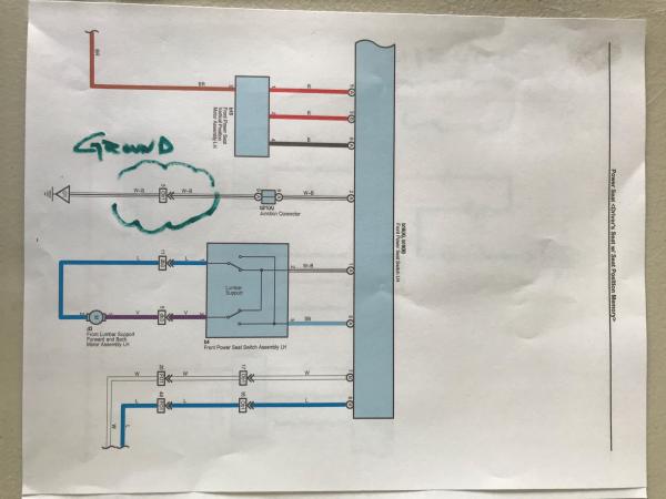

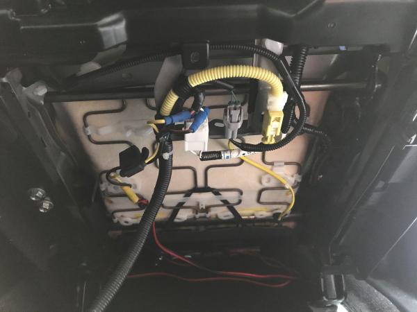

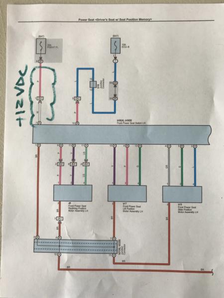

If you have the drivers side powered seat this modification will work for you. The wiring is easily accessible under the drivers seat by removing the four bolts that fasten the seat to the body and then tilting the seat back. The below picture shows the completed wiring.

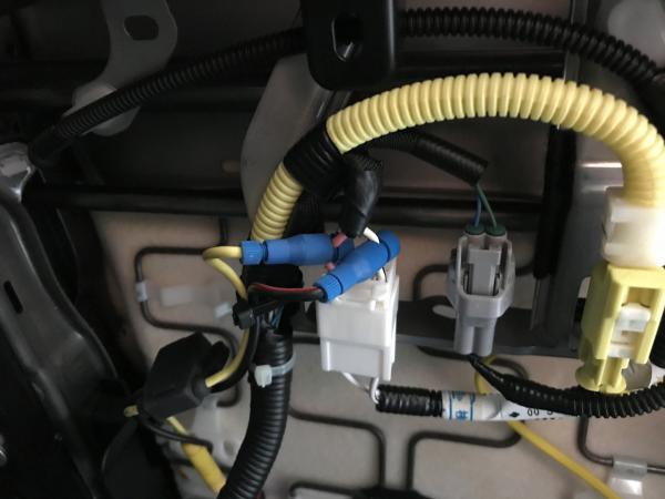

The pink wire on the OB1 connector is from the 30 amp battery supply circuit and the white/black wire is the ground. I used Posi-Products Posi-Taps to connect to them.

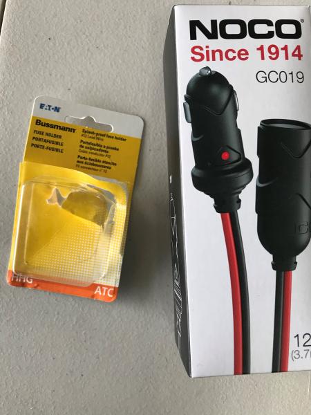

Here's a picture of the fuse and cigarette extension cord parts I used.

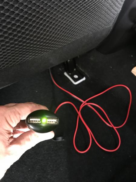

I cut the plug off the extension cord and wired in the jack. The below picture is shown with a dual port USB adapter plugged in.
