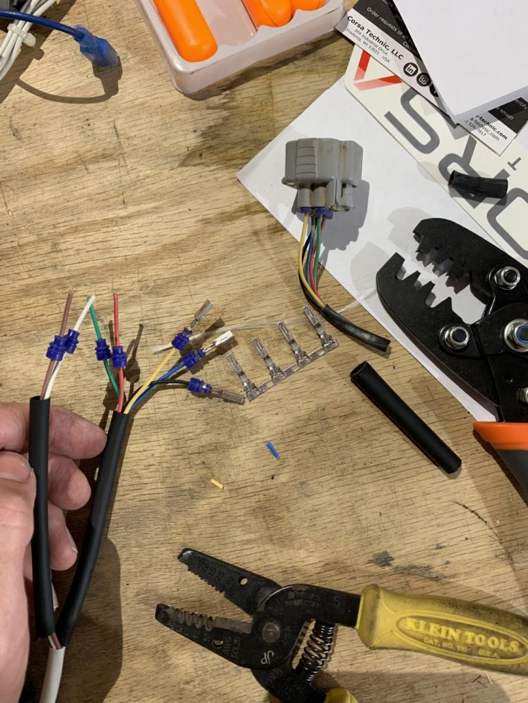

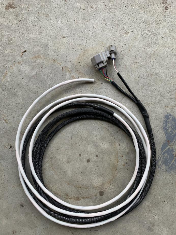

The good news is that I found a guy on ebay selling 50' lengths of Genesis 3117 18/8c plenum cable, so that'll do for now. Guess I get to build a harness after all.
Thanks for everyone's help so far.
I used Car Audio 8 Way Speaker wire to run my harness. I have the OEM Locker/ECU, but received a cut harness with everything spliced together and no middle harness.
I just matched up all wires, made myself a color chart, and went for it. I think you should probably be able to get some of that from a local car audio shop.
This is pretty much what I used - 8-Conductor 13AWG Unshielded Loudspeaker Multiconductor Speaker Cable - Per Foot

I wish you had posted that on Monday haha. 50' of 18/8 plenum cable showed up on my porch this afternoon.
Just in case anyone is skimming the thread and missed my question to Devbot:

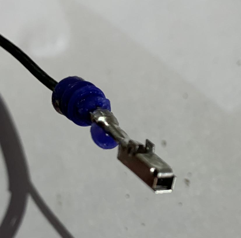

What kind of pin/socket and crimping tools do I need? That's 18awg wire and the pin/socket/whatever you wanna call it is 3mm wide.

Easy mode works again. Thanks everyone for your help.

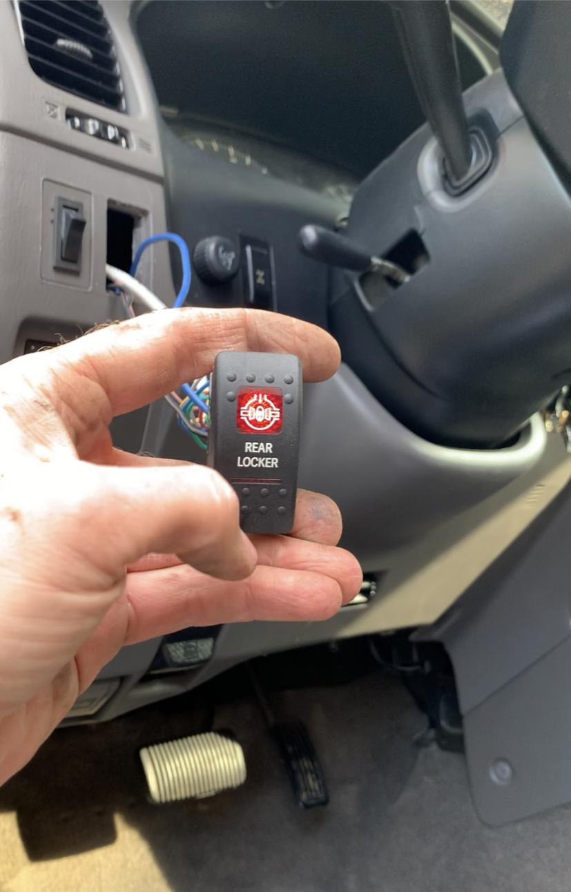

12 volt elocker switch schematic
Anyone have a working 12 voltguy harness and could grab a picture of the wire order on back of switch?
Took mine apart haven't been ablev to hook it up right, can't get ahold of the guy.
Need to know the order of the wires on back of locker switch.
Thanks.
Thanks.
I can get a couple pics for you but probably can't get to it until next week. Does your switch have all the colored dots on the side? If so, those correspond to the wire color that connects there.
