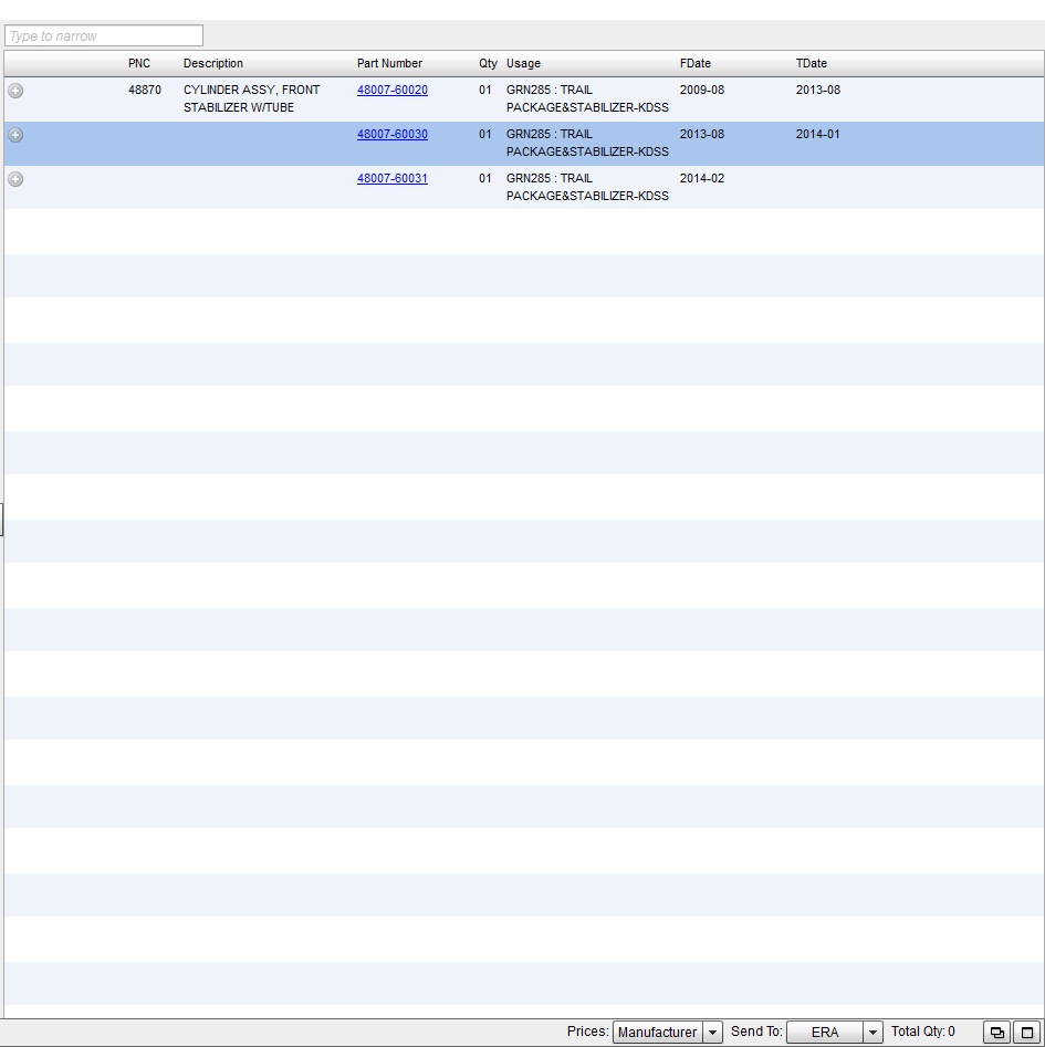

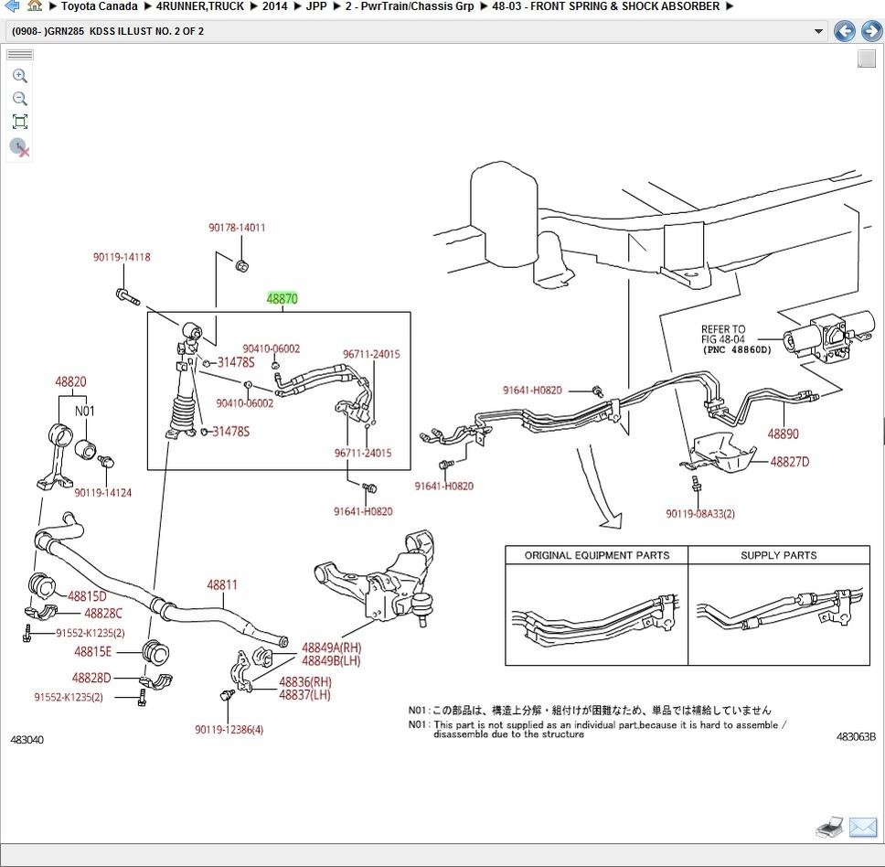

I got an email from him less than an hour later with this:
It looks like they changed the KDSS cylinder for 2014. From 2010-2013 they used 48007-60020 and then from 08/2013 to 01/14 they used 48007-60030 (this is what your truck has….) and then from 02/2014 on they used 48007-60031. So yes, there is something different about the KDSS in the 2014 4Runners.
I would see if you could get some production dates from some the other guys on the forums and see if there’s a pattern. These cylinders are all mounted on the driver’s side which seems consistent with what you are hearing.
On the other hand, before we could do anything about it we’d have to verify where the noise is coming from.
Please find out your production date from Toyota and post it here and specify if you're hearing this noise or not. Probably the best case scenario, assuming the front stabilizer cylinder assembly is the culprit, is the post 02/2014 production trucks w/KDSS aren't experiencing this.

As in the email; the production date of my TE w/KDSS is between 08/2013 to 01/2014.
