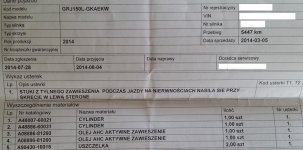

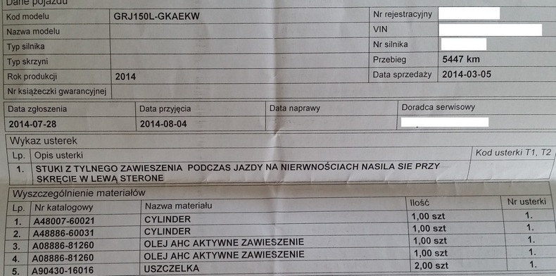

KDSS new update from Poland
Hi!
Toyota has finally managed to solve the KDSS issue by changing both cylinders from the Prado (Land Cruiser 150) 2013 model (before facelifting).
They tried the replacement 2014 model cylinders but they were acting the same way as mine (so it is a factory issue).
Now everything is perfect with the suspension - KDSS is working smoothly on bumpy roads, finally! (it took my ODO to reach almost 5500km).
Find attached list of spare parts changed in my car (sorry it is Polish :)
Good luck with getting your KDSSs into order!
