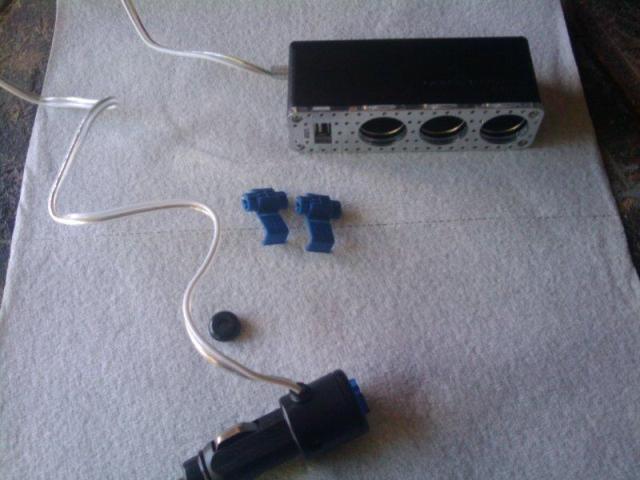

1. Get the stuff you’ll need together. You can go ahead and cut off the cigarette lighter plug off the multi-12V power port. I bought the triple socket power port at Walmart for $10.The two scotchlok quick splice connectors and the grommet, I had laying around.

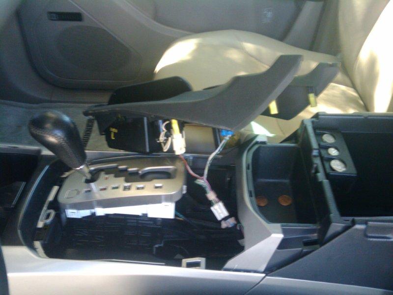

Pull up on the center console piece that contains the power port and surrounds the shifter exposing the wiring for the cigarette lighter.

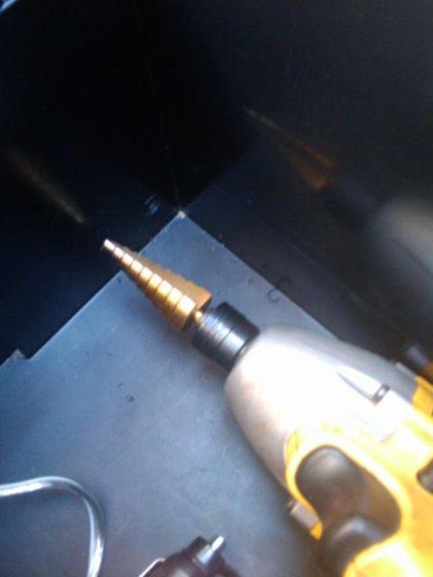

Drill a hole in the center console bucket under the coin holder. I couldn't get a full size drill in there but a step bit with the impact driver worked great. The hole size depends on the size of your grommet if you use one. The hole is towards the shifter on the passenger side.

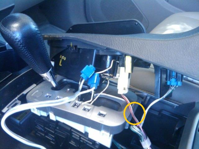

Cut the cigarette lighter plug off the triple socket tap, feed the wire through your hole (and grommet if you used it). Run the wiring around to the wiring for the cigarette lighter. Use the quick splices to tap into the power port circuit. The white wire goes to the white wire in the truck. Note that I would recommend that you not put them where I did but rather on the other side of the connector (circled in orange) so if you ever had to remove this piece of the center console, you could easily.

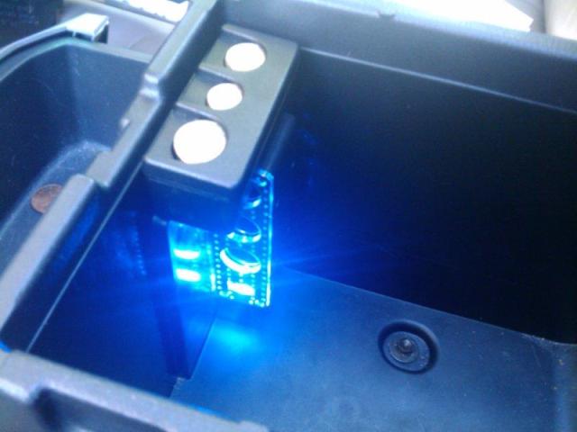

Final product complete with blue LEDS (that I'll probably remove someday unless it seems like they will be good bucket lights). The only other thing I don't like is that the screw hole for the triple socket's case face into the bucket. You could probably mount it the other way but then the USB port would be hard to get to.
