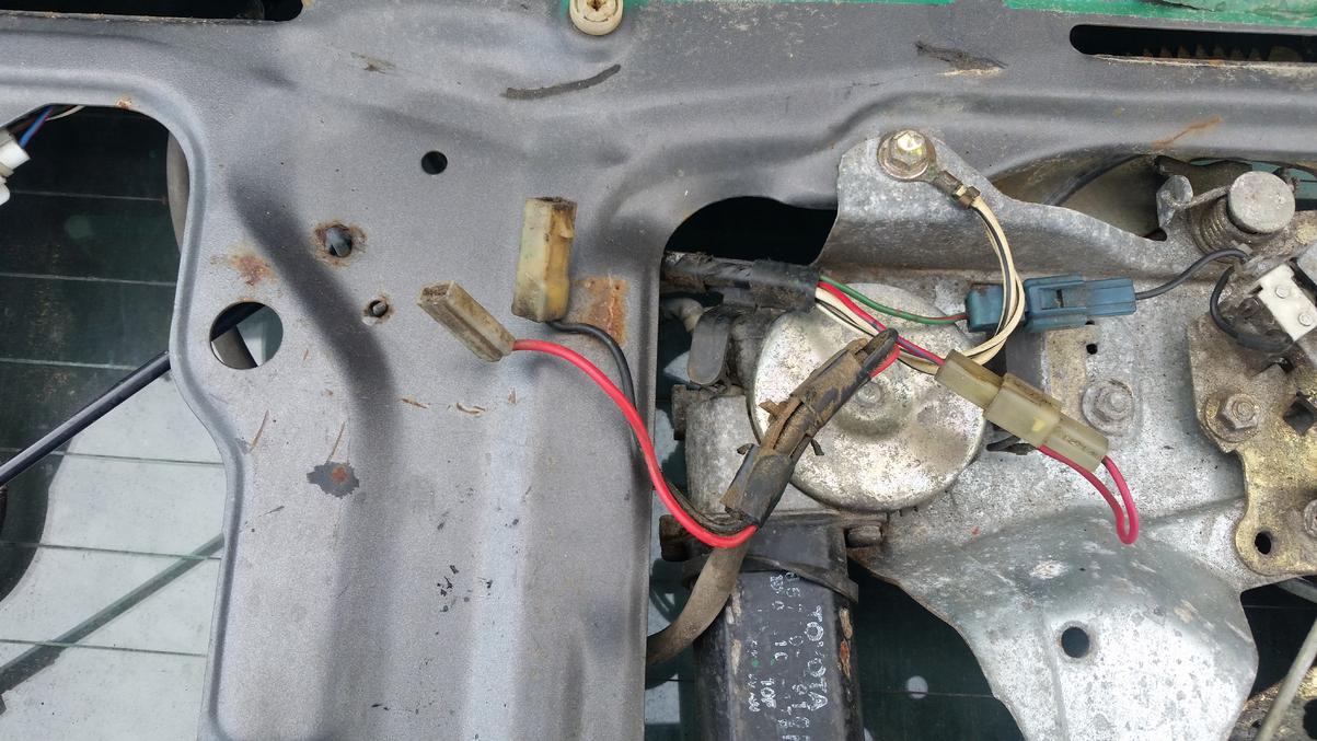

These are the two wires I was referring to, any idea where the go?
I can double check when I get home. But without looking at my tailgate, it looks like someone rigged something in there. I believe the red and black that are also in that same picture (looks like they're plugged together, but tough to tell from that angle) are the opposing male/female you're looking for. ...something doesn't look right there...

The black and red wire looks like they go to the rear window defroster.??? Look at the back glass on the drivers side, near the window track.

Thanks! Pretty sure I can see where they connect at the bottom of the window.
