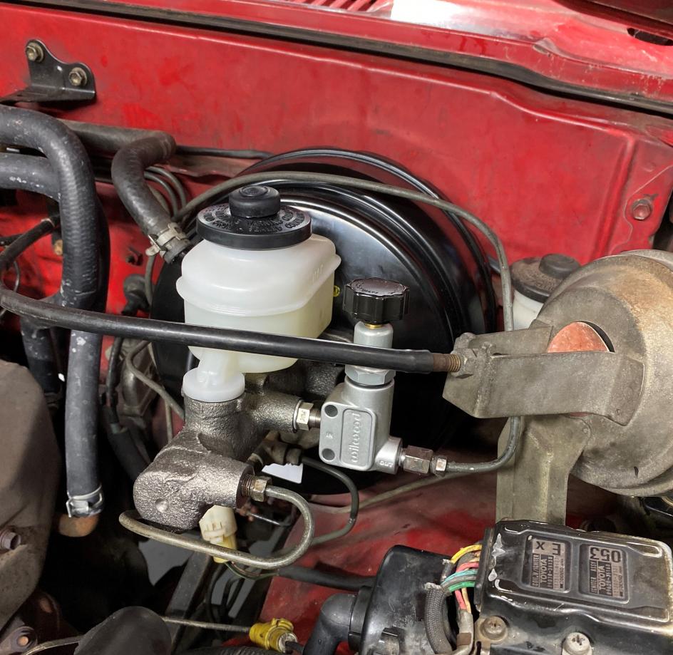

Done! All went well and didn't have to cut/flare a single brake line. Complete 91' V6 OEM brakes from firewall to hub. Additional: Removed load sensing valve, new rear wheel bearings/seals, fresh diff fluid and Wilwood prop valve. Stops like it never did before.
S.
Only cut/flared one line, at the rear deleting the original load sensing prop valve. So far this is very easy to adjust.
