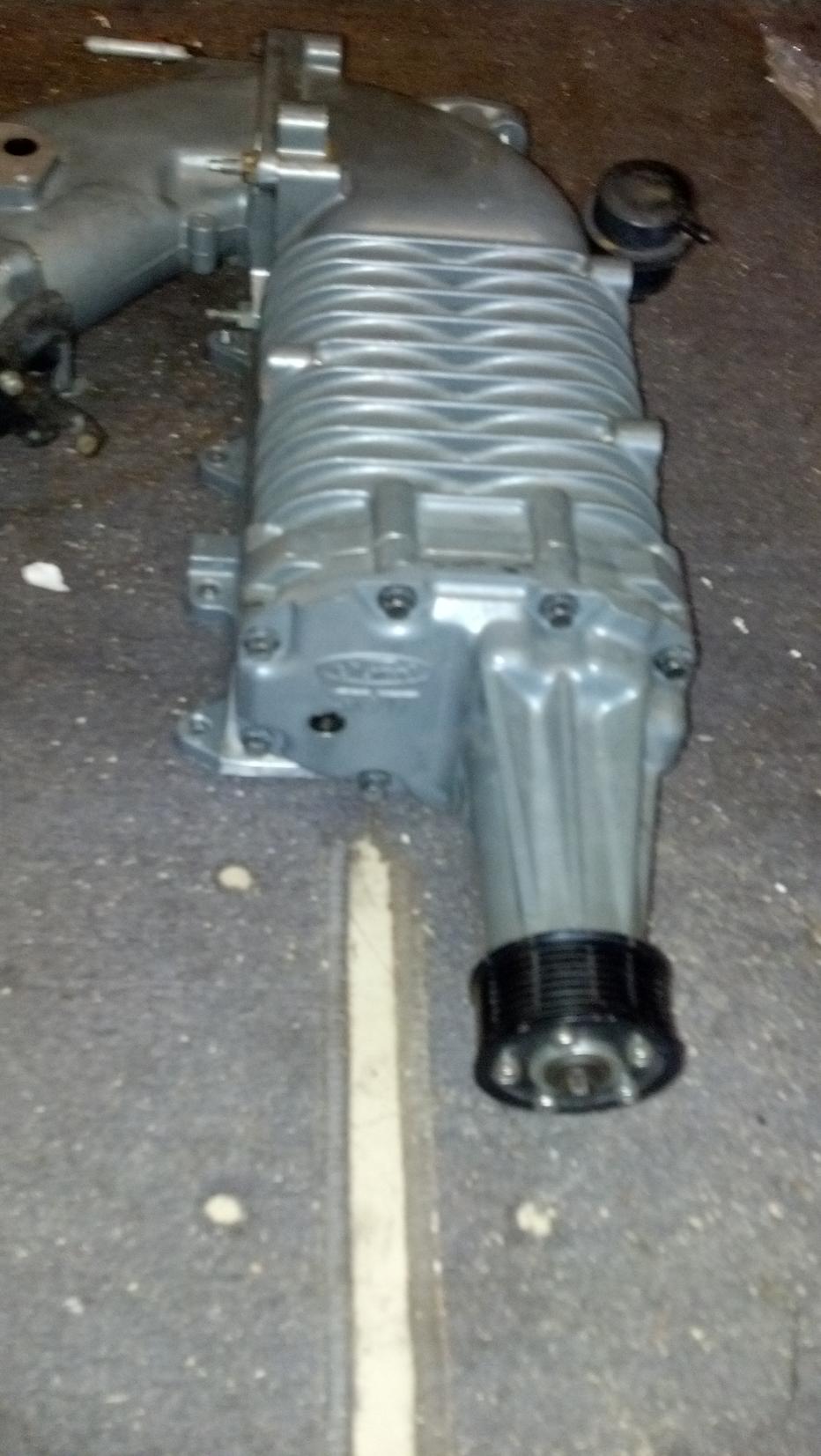

M112
Picked up the M112 yesterday. Will have to grind off the inner lip underneath the supercharger so that it will mate with the modified lower intake manifold.
Also was emailed that marlin crawler had the R150f short throw shifters back in stock, so I ordered that as well. My shift was sloppy anyway and needed a new replacement.
From a guy who has previously installed an M62 (TRD supercharger) on a 3.4, this m112 is massive compared to that. I was shocked at how much bigger this supercharger is compared to the smaller TRD unit. I was getting 9lb of boost on that little M62 with the URD fuel upgrade kit, I'm hoping for 6-7lb on this unit with a 3.25" 6 rib pulley and AEM water/meth kit for boosted gasoline engines.

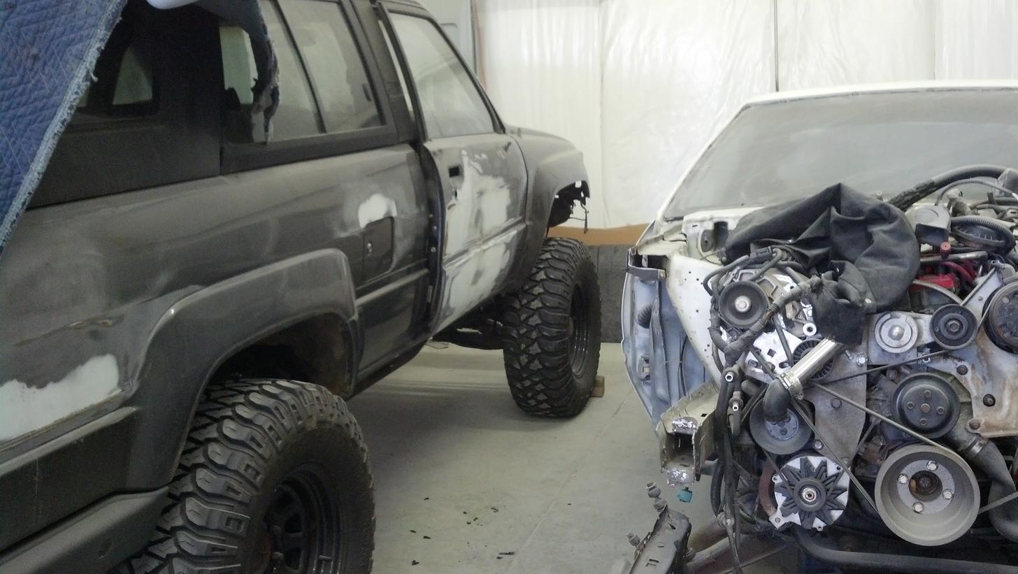

The body is on the way for total restoration. Going with titanium metallic from 4th gen 4runners.

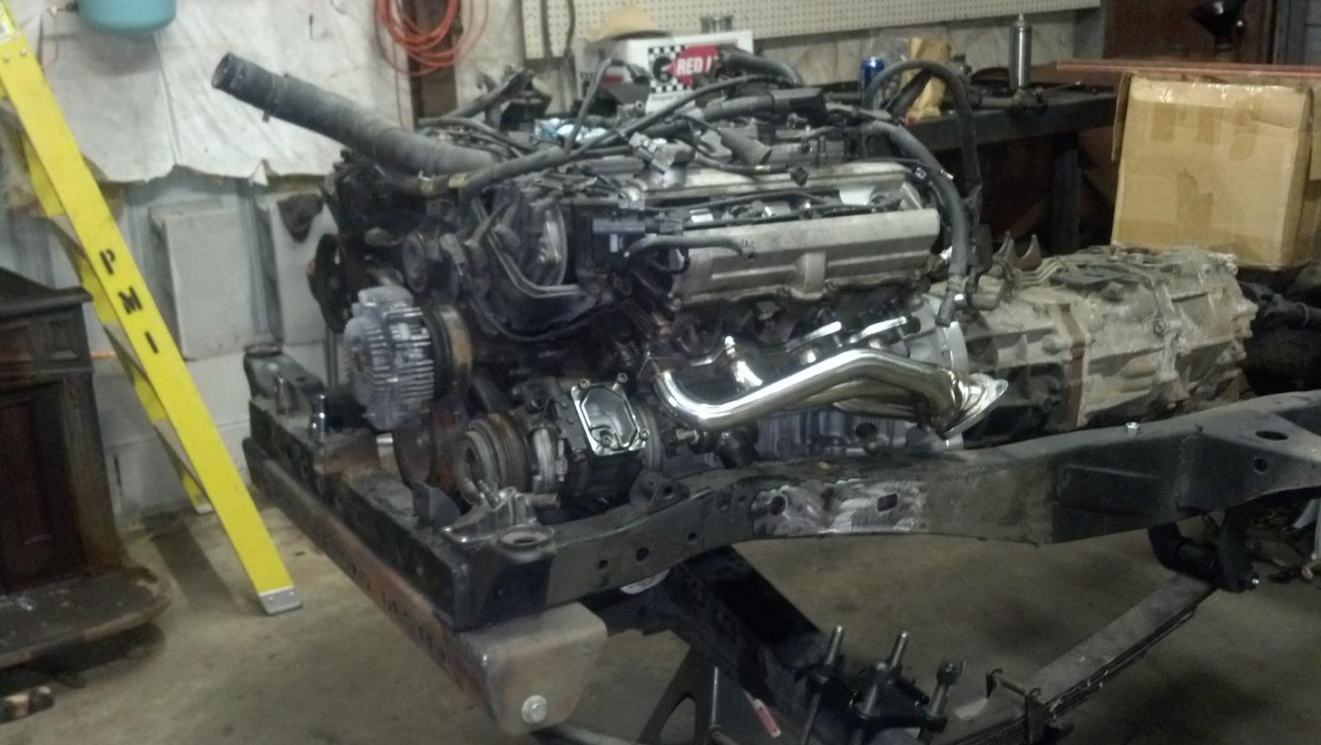

Time for an update
It's been slow going, since I'm not doing the fabrication myself, I rely on the experts and a big project usually gets pushed to the side for smaller well paying projects :) Thanks to Dous for riding along with me to check up on my project last weekend! A lot of things still underway, I have two vehicles, I took the body off one to work on the chasis while the other body was at the bodyshop. Once the bodywork is done, I'll take that body off and put it on the Solid Axle Swapped Chasis. we fitted the entire drivetrain and made the clearance for the steering. Motor is fitted and mounts are in. The engine is being torn down to replace all gaskets and seals, starter contacts, sensors, and then the heads are being ported to open them up a bit. Supercharger Cams are going in along with better Valve Springs. I'm in contact with a tuner for the standalone ems to run this beast. Didn't want to use factory ECU because I wanted no complications with the 5 spd, I wanted to use the Ford Cobra throttle body, and I wanted a good tune. Let's just hope the transmission hold up. Keep you updated as I know more.
