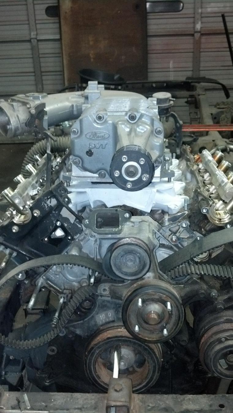

Made some progress. I tore the heads off the engine to have them completed. Porting them, installing Kelford 207-SC cams for the supercharged engine, lextreme heavy valve springs, and new valve seals. Also picked up rear main seal, crank seal, head gaskets, intake gaskets, denso remaned starter, bearings for the idler pulleys, and some Marlin Crawler Billet steering arms. I lost my steering arms somehow and found a guy selling a used set for a good deal so I upgraded! Also, a little head gasket info for anybody researching this, the pre 98 non VVTI 1uz head gaskets are not MLS but the 98+ head gaskets are, so rather than buy expensive aftermarket MLS gaskets, just pick up a set of OEM 98+ VVTI 1uz head gaskets, I think I paid $80 for both from sewell lexus. I know I have a lot of parts but trust me, I have saved thousands from used parts and doing my reserarch and shopping around. I buy used when I can and it makes sense and then use promo codes for everything new! Anyway, here's a pic of the supercharger placed on the engine.

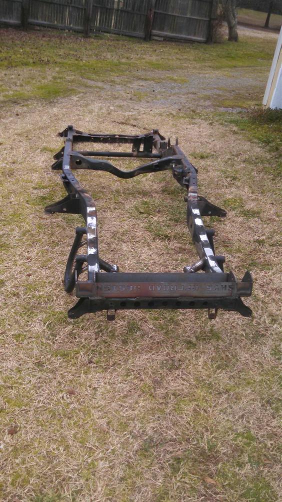

Lates update is the chassis is going to powdercoat this week. To have them media blast it and powdercoat it is around $350 so plenty worth it to get a perfectly painted frame. Engine heads are being built this week, Kelford cams looked awesome and the engine internals looked baby skin smooth @ 98k miles! I bought a used car trailer to haul this baby around, I figured Chassis to powdercoat, back to the engine shop, body shop to engine shop, engine shop to performance shop for ECU install would suck in cost, so instead of spending the money on that, i bought a trailer to use, refinish and resell and make some money on it.

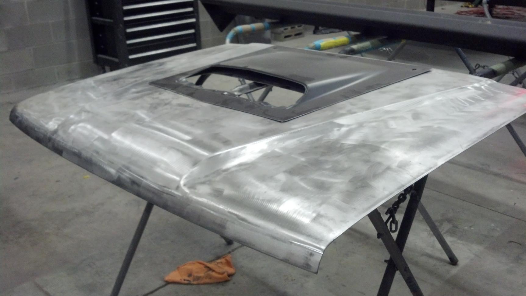

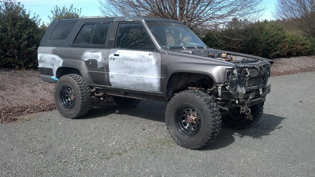

I dropped the chassis off at the powder coat place to sand blast and paint satin black. Also had them go ahead and blast the arb bumper. Checked it on the body shop who hasn't done much lately, but has began to graph the 4th gen hood scoop in.
