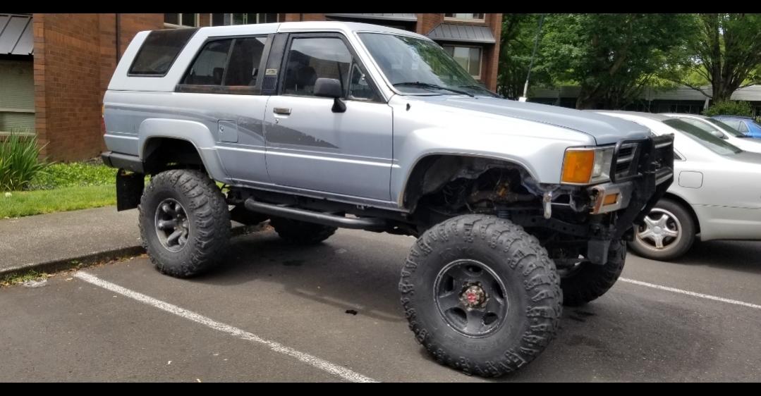

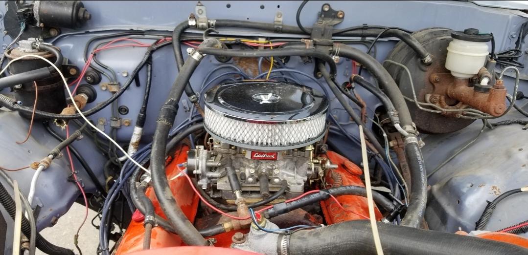

I give a rip. I know its years later. But I have 89 with a sbc 350. I bought it that way. But i really would like to do another swap and go toyota v8. So your posts are very informative and inspiring. I saw a similar thread but your getting alot more descriptive in my opinion. So thanks for taking the time to post this build.
