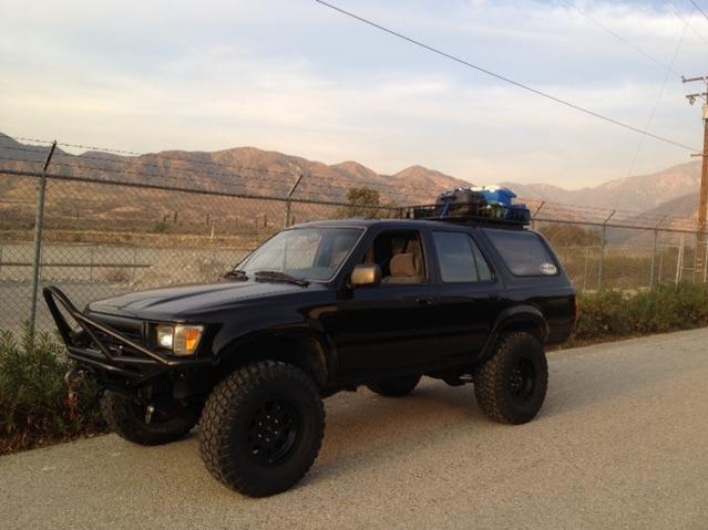

FWIW here's a pic of my 4runner with a 1.5" balljoint spacer and the rear coil spacer
285/75/16 km2's with 16x8 kmc enduros. 4.5 back spacing 0 offset. no rubbing. factory 4.56 gears and a 5speed. Wish I had the 4.88's though :/
