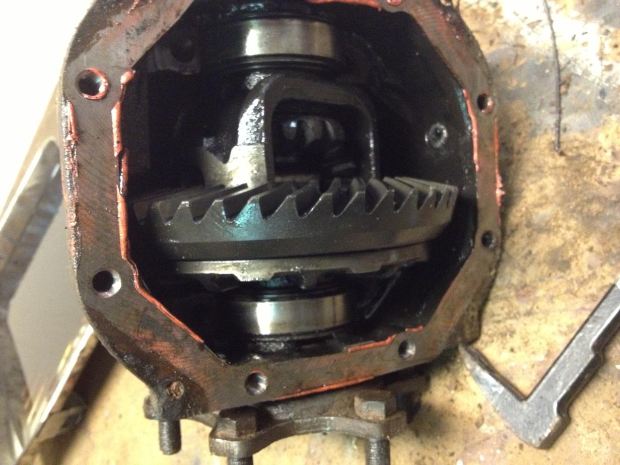

I've got a 1991 4runner and the right, passenger side flange from the front differential is loose. It is causing an annoying vibration and it's just terrible to listen to. So I figured it's the bearing inside the front differential. I've ripped out the differential and taken pretty much every bolt off i could find, i just cant seem to be able to get this bearing out. Any help is appreciated, thanks. :ybrick:

You have to remove the side gear shafts, and you'll probably need a puller to get them out. IIRC there is a snap ring in side on the end of the shaft, holding it in, so that needs to come of first.
Then remove the diff assy to get to the bearings.
When I pulled the gear shafts, I put a fat flathead screwdriver between the crosspin and the end of the gear shaft and gave it a stiff whack. They popped right out.
