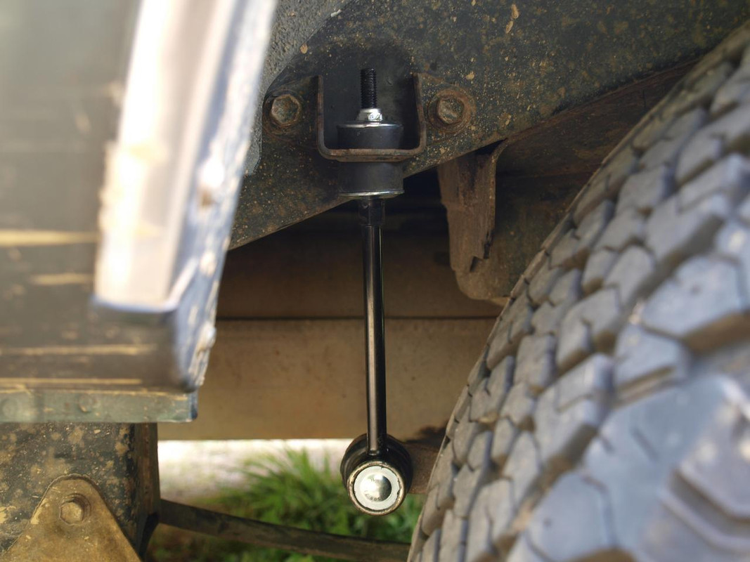

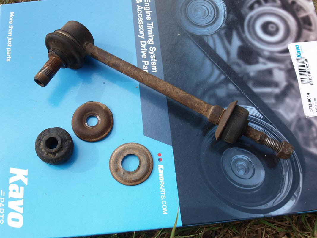

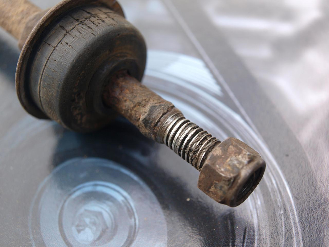

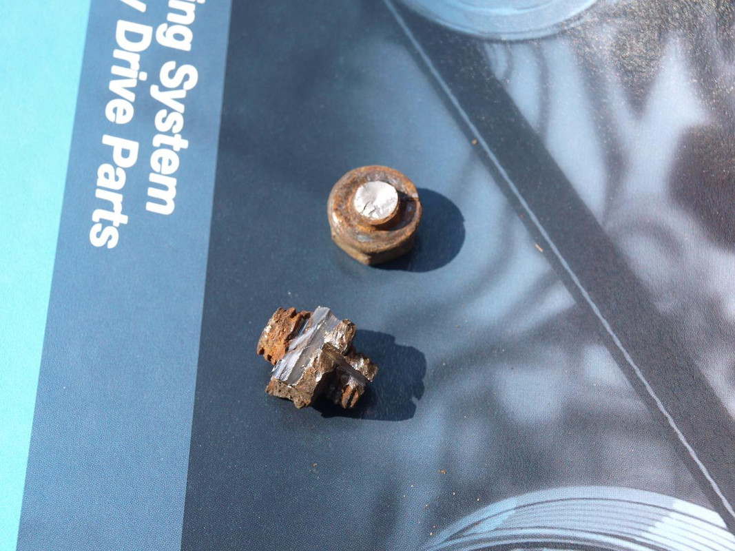

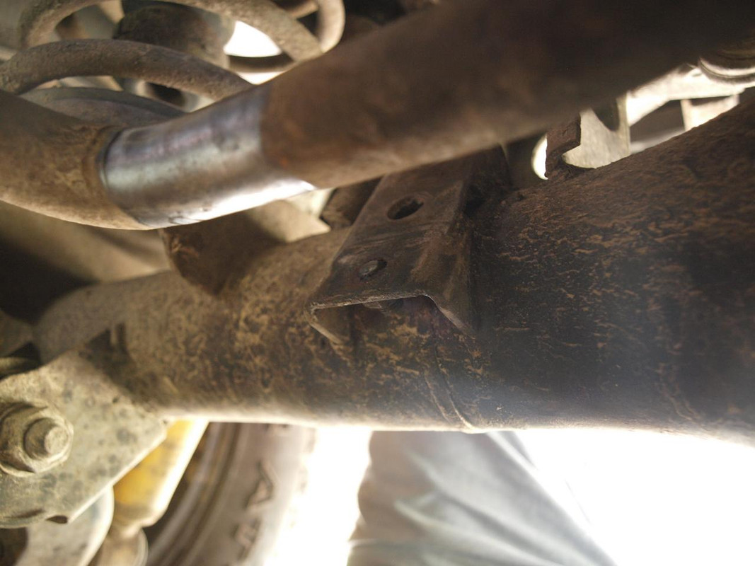

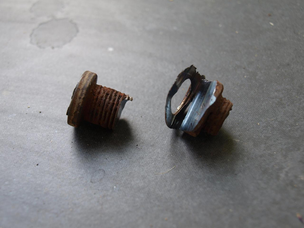

Couldn't wait and installed the stabilizer bars today. This should be an half our job but one bolt decided not to cooperate... :frusty:
The nut was welded so i had to cut it off.

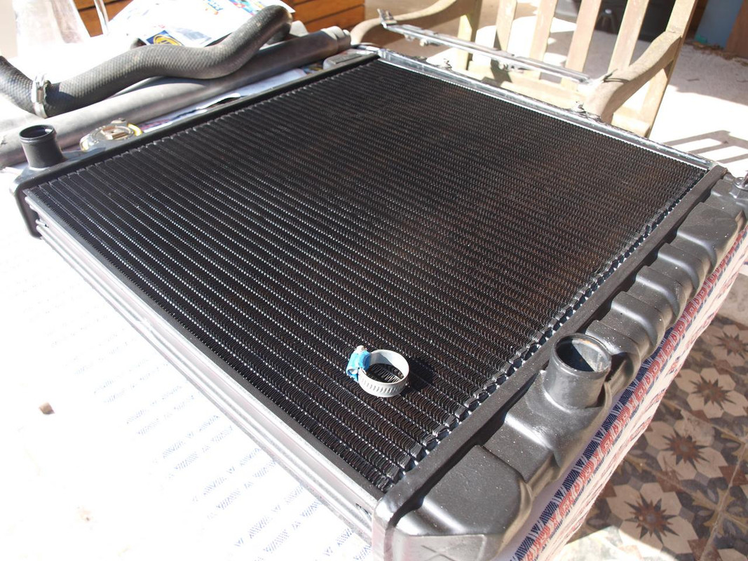

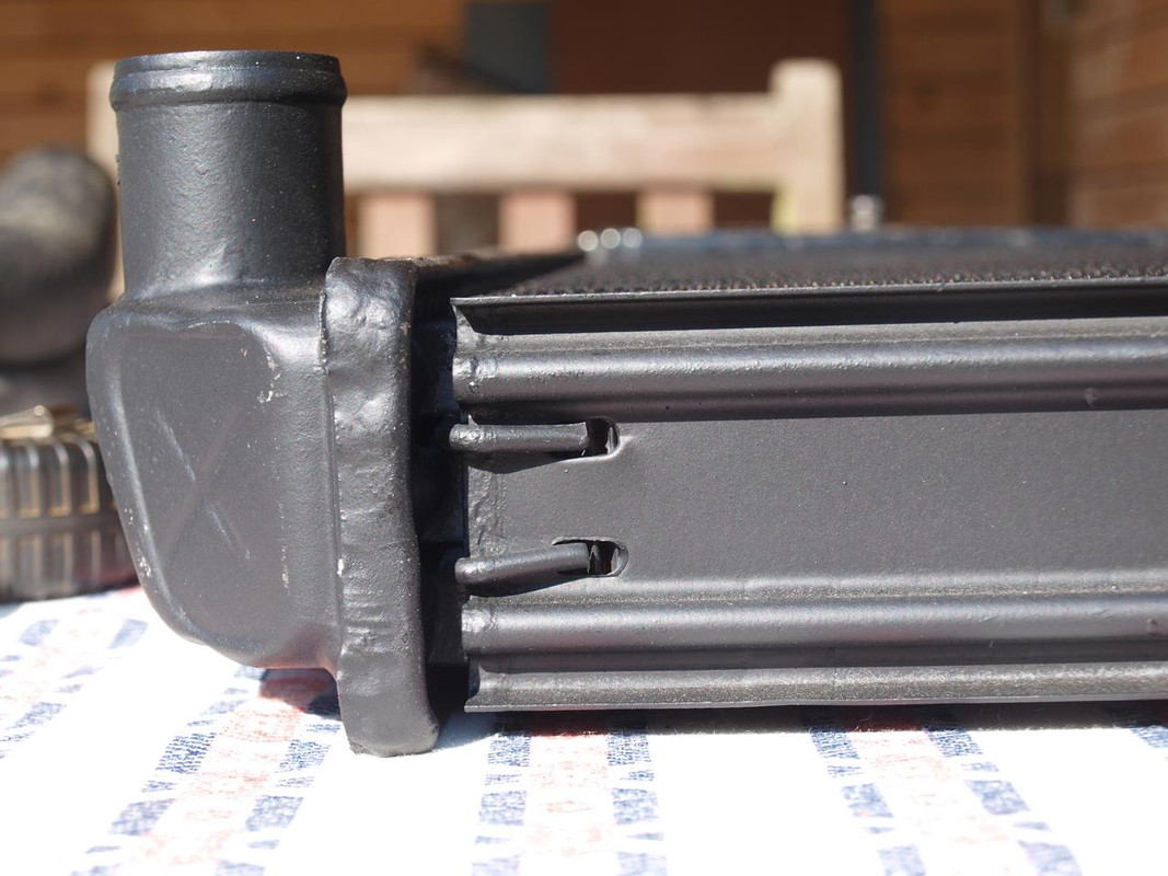

Got word on the radiator yesterday. The can put in a new thicker net. The original one is 4cm and they can add another 1,3cm and an extra water-channel. Cooling capacities will be improved but i'm not %100 sure if this solves the problem. For €270 i think this is a good investment anyway.
No torch yet. I'll put it on the list under the multimeter. :)
More coolant capacity is never a bad investment.

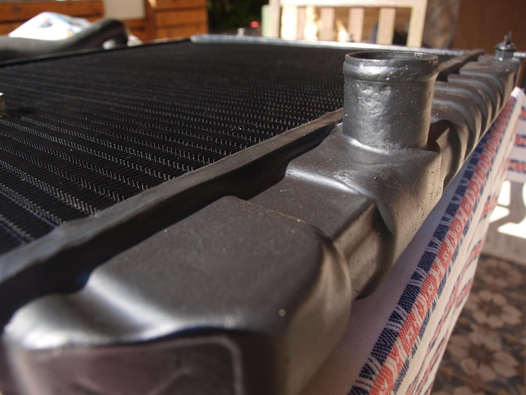

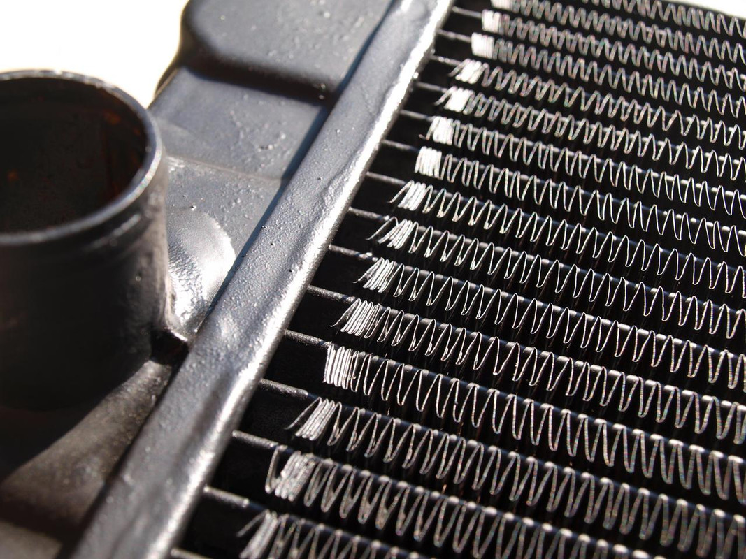

Picked up my new radiator last week. It is thicker than before and tested for leaks. The new fins are copper also. No aluminium.

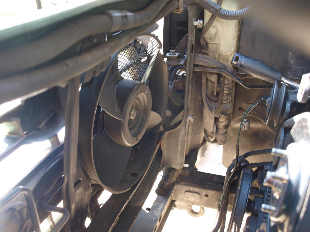

Now here's an idea but i'm not sure it's a good one:
I removed the AC pump and rad to allow more airflow to the rad for the engine coolant. (This is Belgium, not Australia. Temps are not so high here...)
I was thinking of using the fan of the AC as additional engine cooling. I just need to figure out the wiring...
