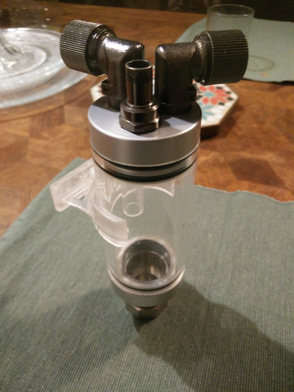

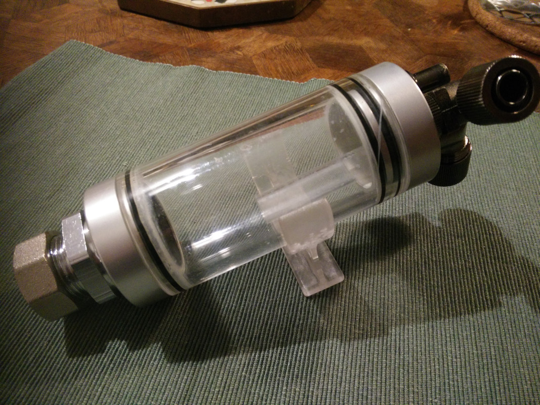

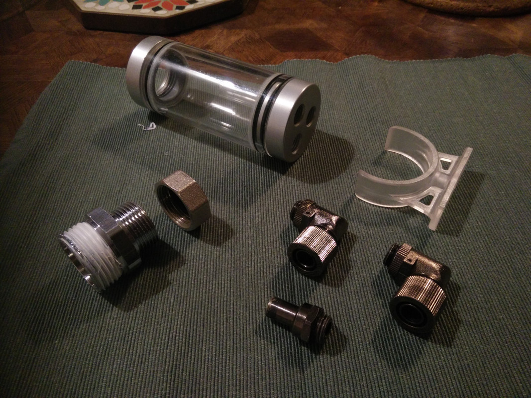

Thank you for the ebay link but i made a DIY catch can from stuff i had laying around from my early 'computer-building' days. I hope the acrylic reservoir can withstand the hot oil...
It even has a mounting bracket :) i only need to stuff in some metal sponge. It's worth a try. We're off to a 900km trip to Italy next week and i'm VERY excited to test our new old 4runner!

Ah, it looks good. From photo it looks kind of small. I know that acrylic tubes can be heated with heat gun and bended, but no idea how hot are gases inside crankcase. In worst case it would crack and leak. I am thinking now of adding some float contact to can to light up indicator when collected oil/stuff get to full.
