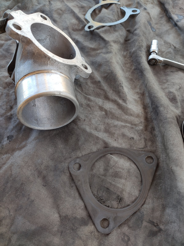

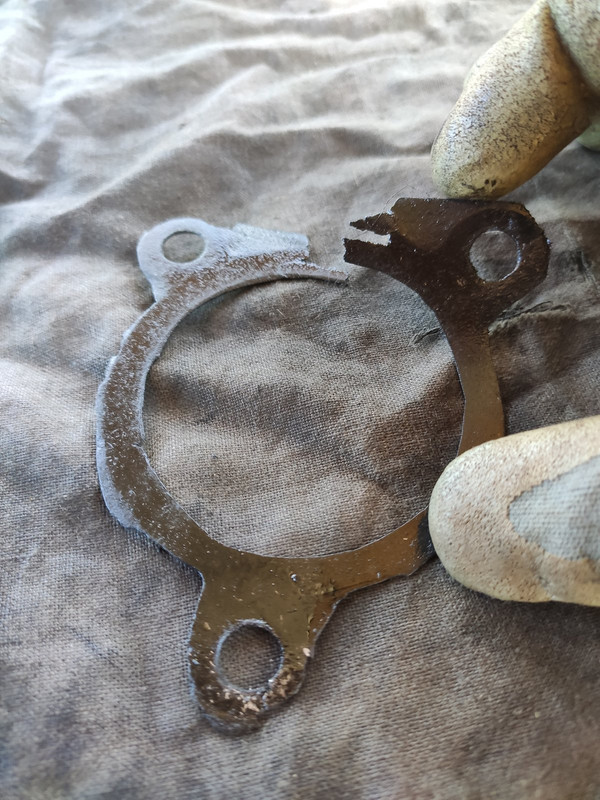

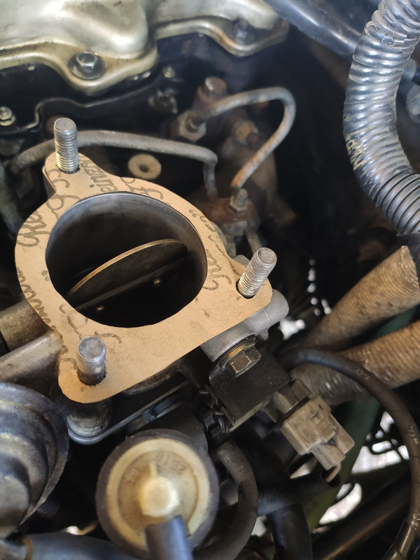

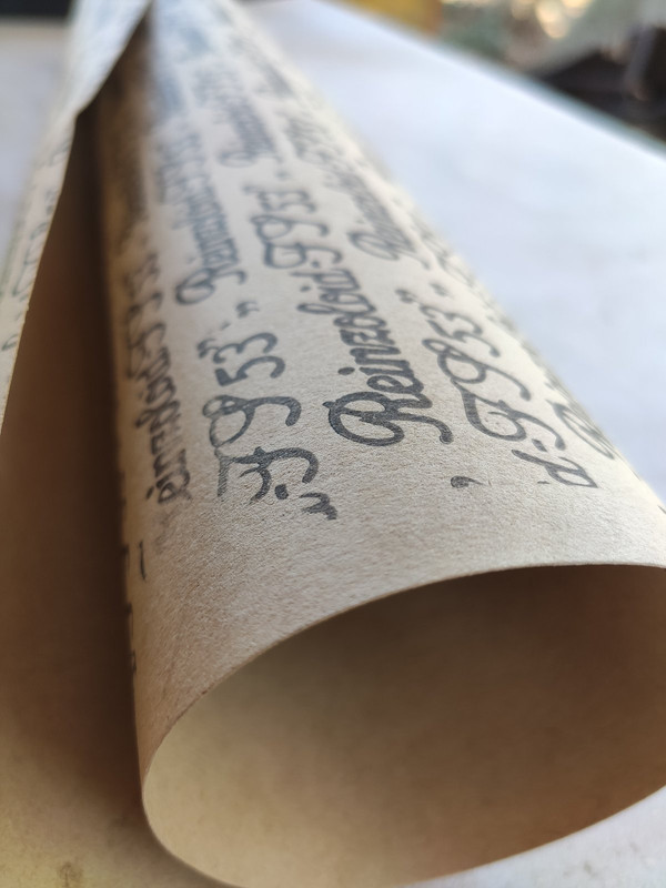

The engine gave a loud whisteling sound when pulling up. I feared the worst and tought the turbo went kaput. Fortunately it was just a broken seal of the throttle valve housing. I went out to buy some oil paper and it was fixed in half an hour.

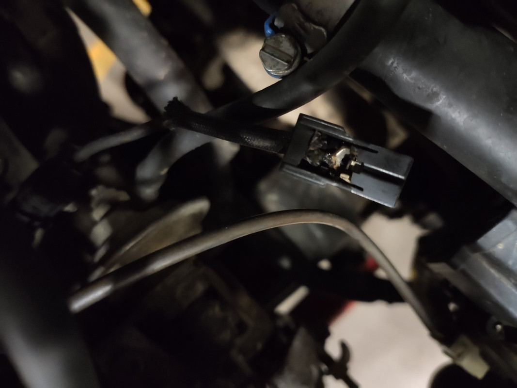

Turned out the connector for the afterglow was melted too so it was replaced as well.
