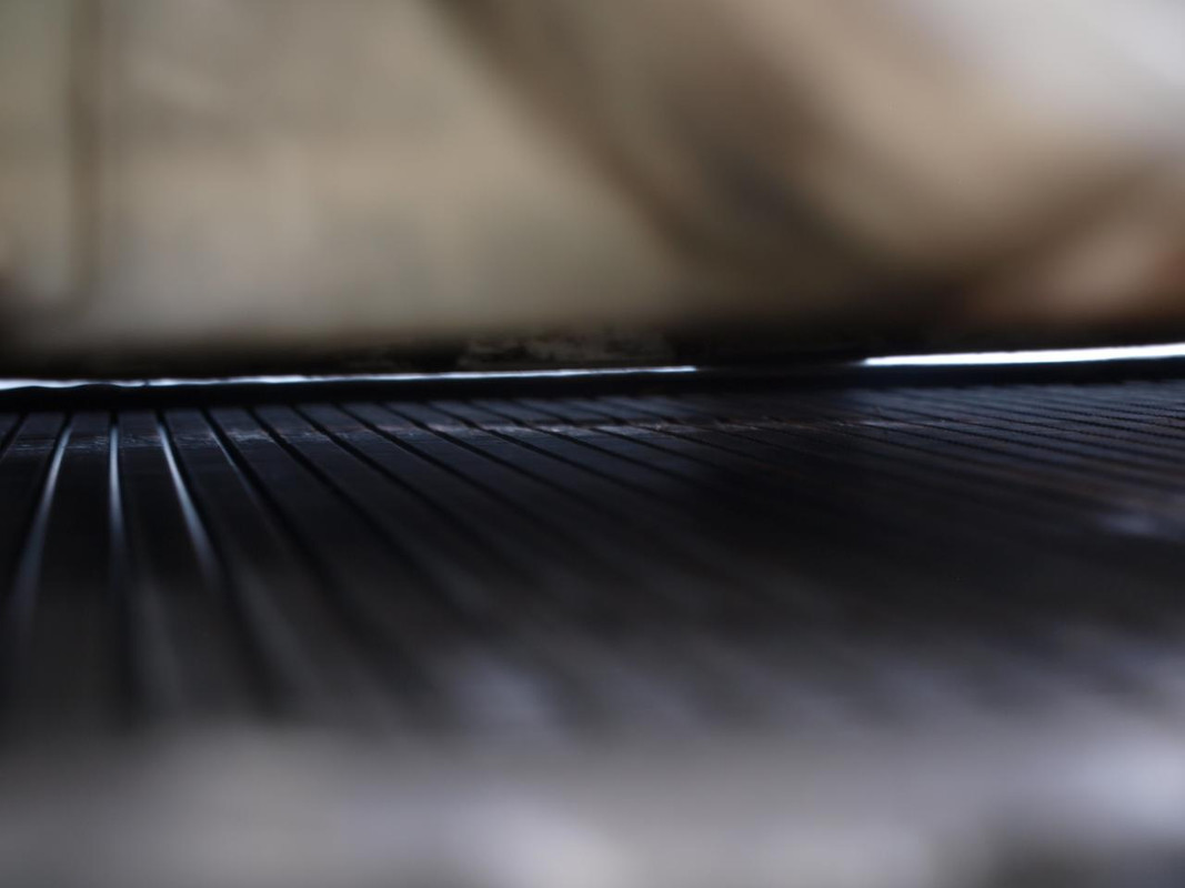

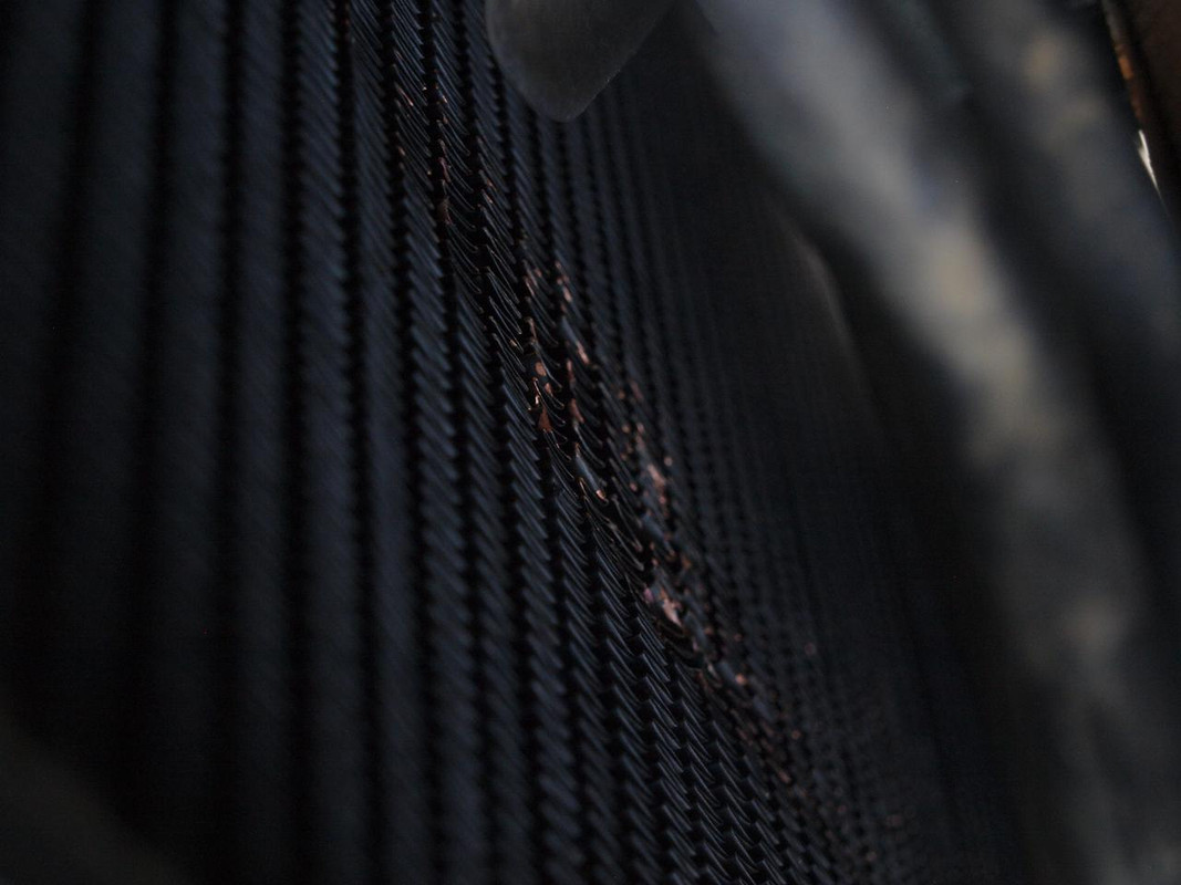

The fan touched the (brand new) radiator:

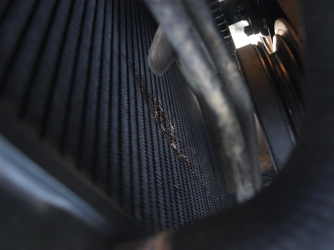

You can clearly see the scrached surface:

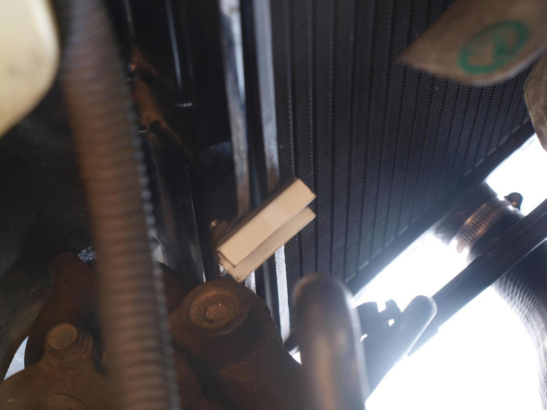

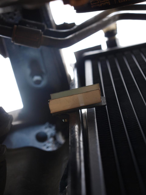

It didn't hit the water channels but i think we were lucky. No leaks and the fan looks still ok. The radiator wasn't welded onto the two radiator mounts so it could move back and forwards. This is something i overlooked while installing the new radiator. Completely my own fault but lesson learned!
Made some ghetto-brackets for now to hold the rad in place:

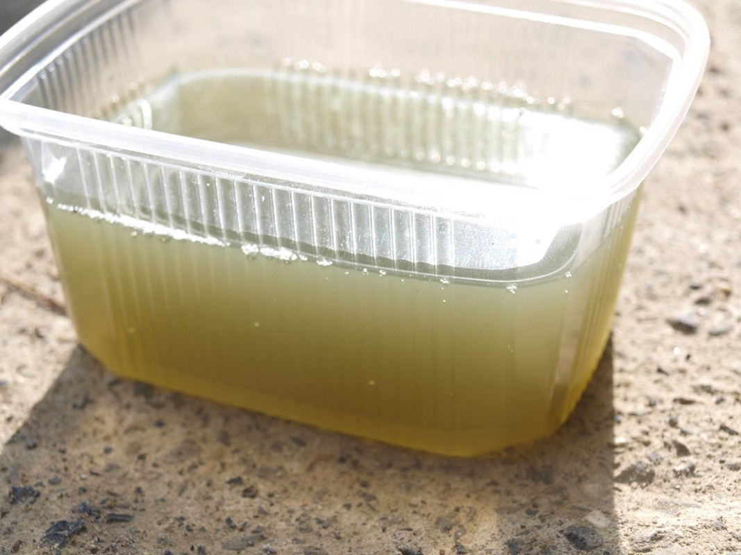

Also changed the coolant again. Put in some radiator flush before the holiday:
Think i need to do it once more...
I put a new rad and fan in my kz... first test drive fan tears into new rad and sprays fluid everywhere. That was a good 300 bucks lol
I guess the engine moves around more than an inch
It looks like i had more luck then you then. I have about 2cm of clearance between fan and rad. These diesels do dance around a bit but it's not like the samba or anything :) At least not when they're warm.

That fan thing sucks, but hey rad is still in one piece so not that bad. Your coolant looks clean compared to mine with brown color :D I am afraid of flush since I have old (original?) rad and I did hear stories about flushing rads only to find out they are leaking somewhere and debris inside did actually seal those leaks :confused:
