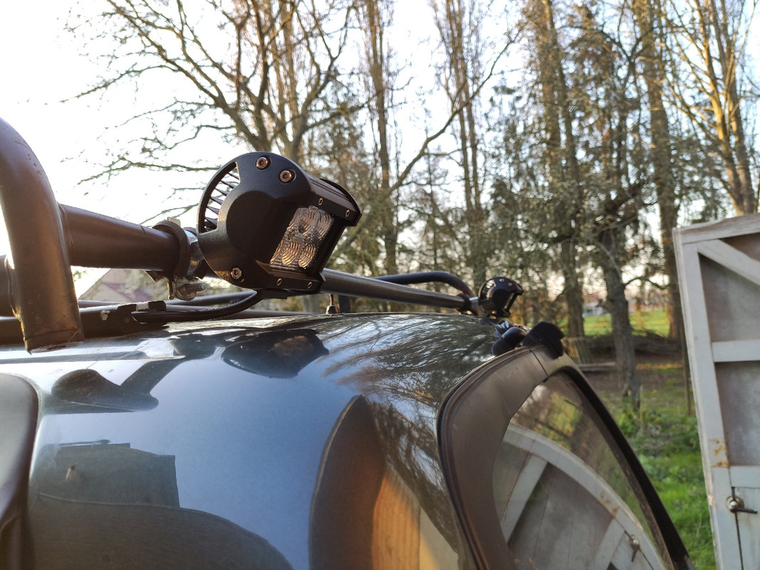

The goal was to install some extra back-up lights so i can actualy see something when backing up in the dark. Parking space in europe is quit narrow...
Then i thought 'why not use them as work/camping light also'.

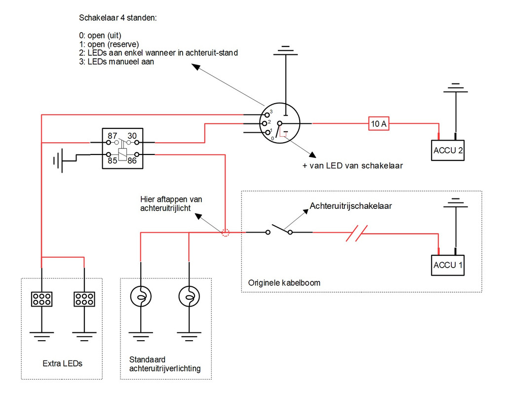

So, i needed the LED's the go on automaticaly when put in reverse AND go on manually without the engine running.
I'm not an experienced electrician but i managed to make my own (very simple) wiring diagram:

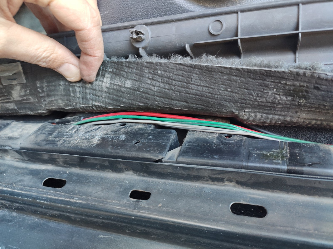

So we need to splice the original wire from the original back-up light to power the relais. I did it all the way from the back.
The color-scheme here is red/blue. Yours can be different. Use a multimeter! I spliced the wire behind the panel on the inside.
The wire is routed to the front under the carpet.
(getting crowded under there...)
Before you proceed, it's a good idea to test that wiring diagram. So i frankensteined it all together and verified that it worked.

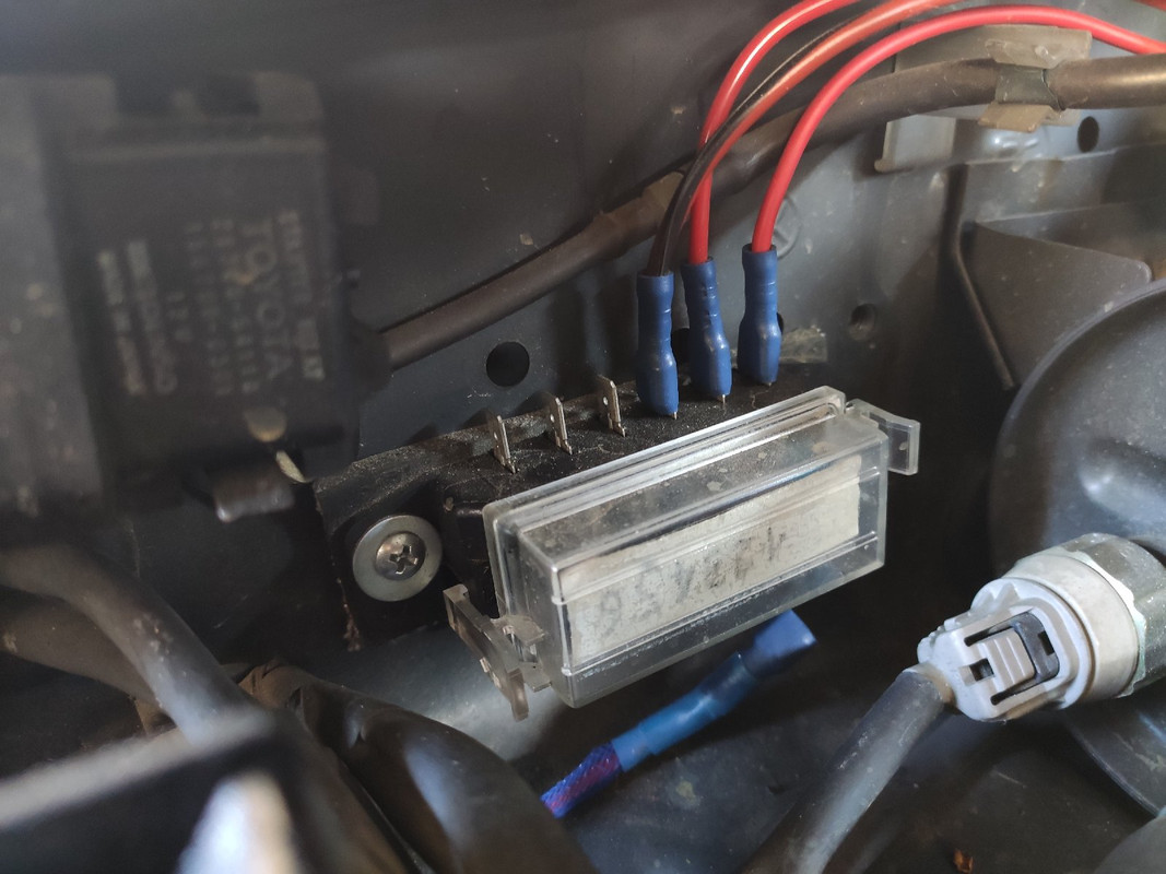

I have a secondary battery so i tapped the 12v supply from it's fusebox.
Everything is fitted under the dashboard on the drivers side. (NOT the fusebox, it's best to place fuses as close to the battery as possible)

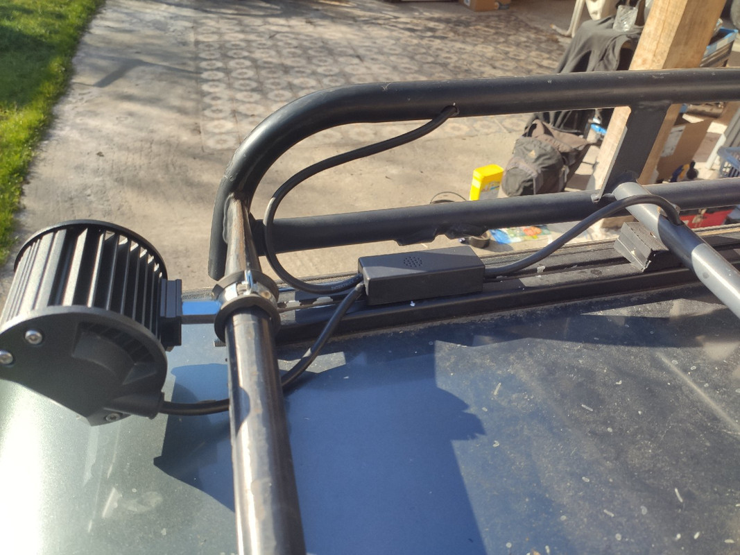

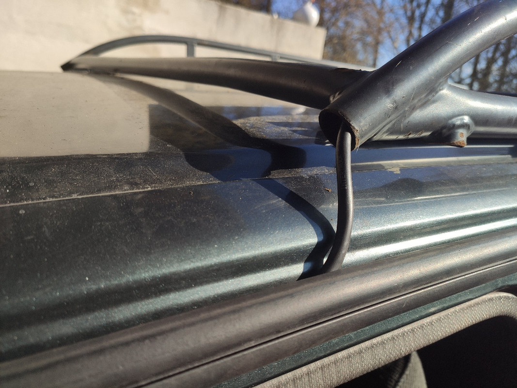

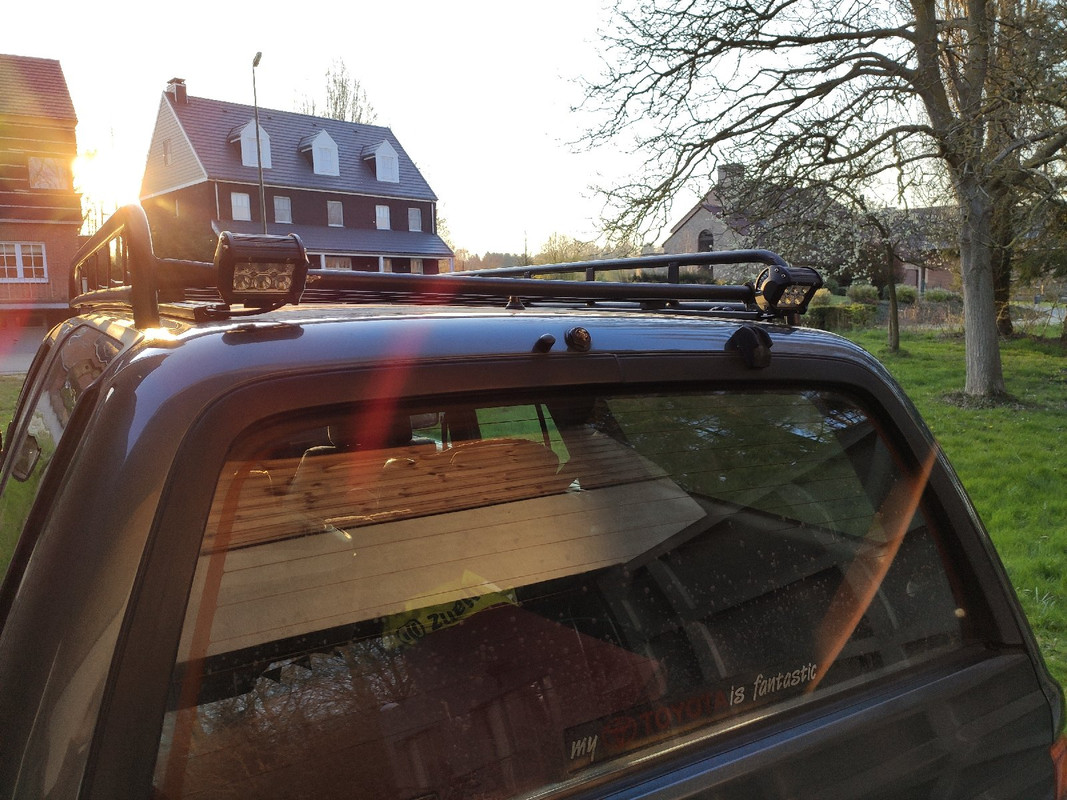

I had to figure out a way to get the 12v supply wire to the roof. And i don't want to drill another hole in it. A popular solution is to route the wire behind the rubber door seal and that's what i did.
Into my retro roof rack...
And out again to a splice-box.

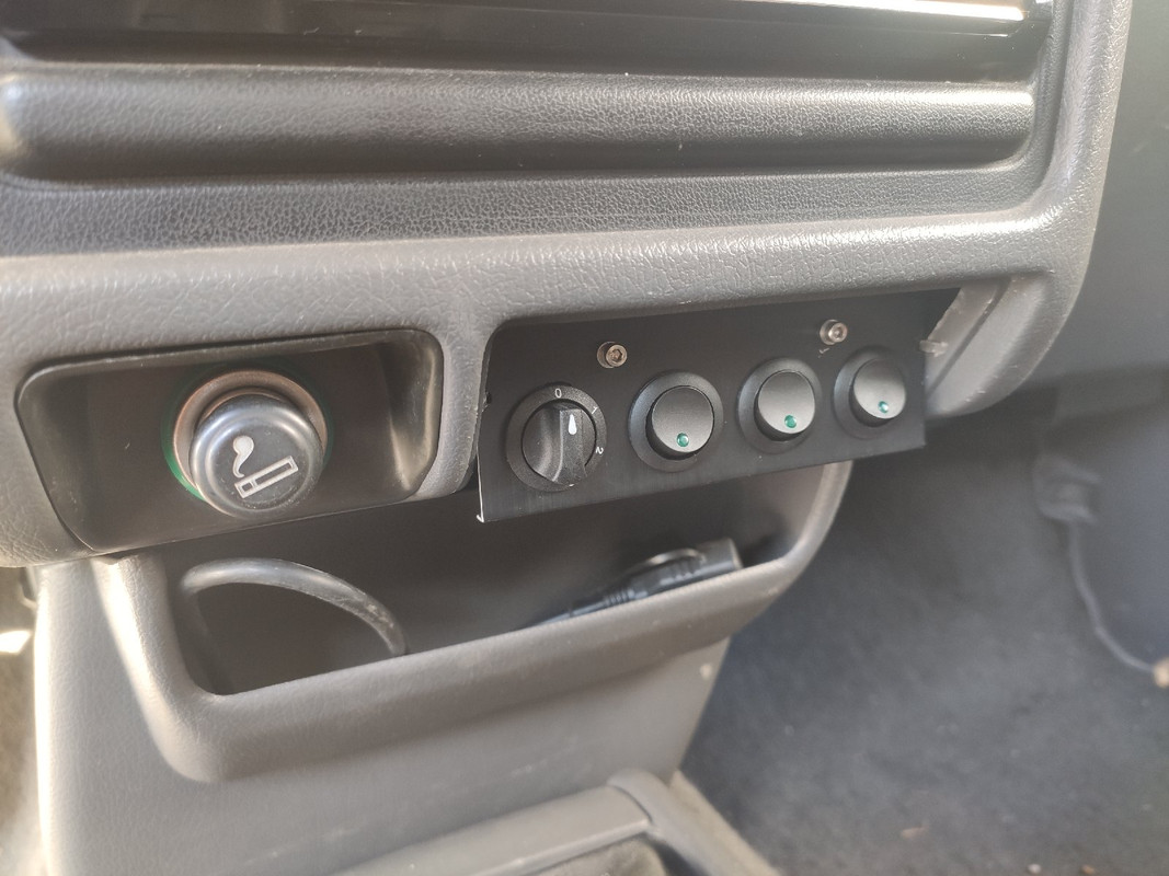

For the switch i used 4-position switch. 0, 1, 2, 3.
0: open
1: open (not connected, reserve)
2: ON when in reverse
3: ON manually
Note: I used 1,5mm² wire because the LED's are 36W only. That's 3A so 1,5mm² is enough. Again, your's may need to be thicker depending on what you're hooking up.
That's it, now i just have to wait and see for the first time when i need them :)

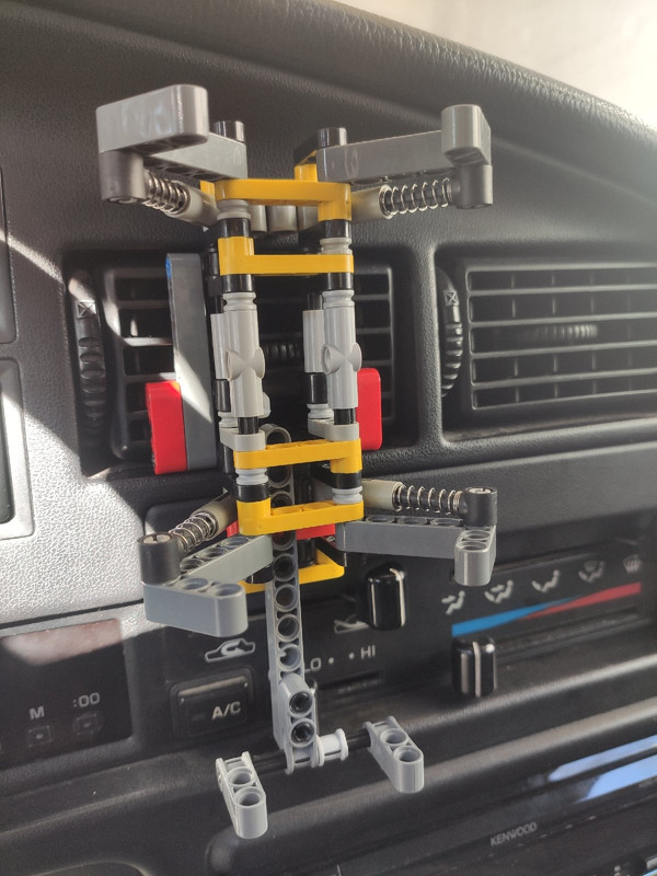

And gave my cell phone car mount an upgrade...

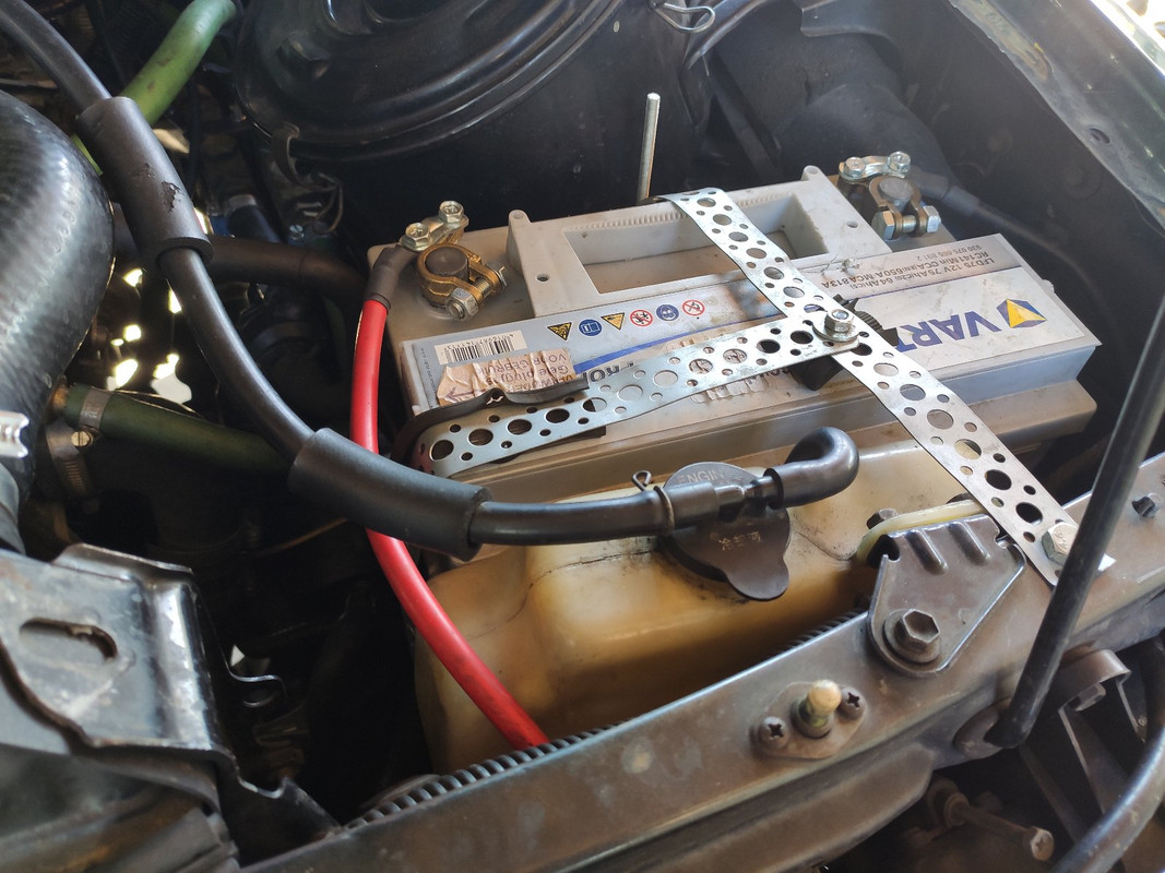

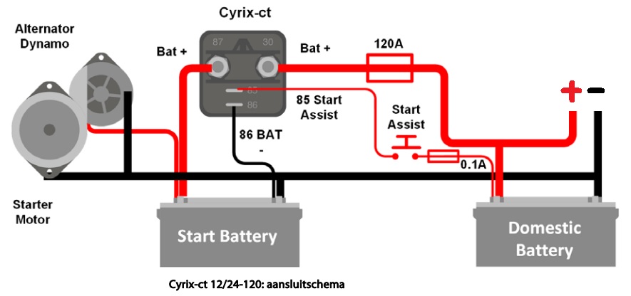

Got the second battery installed some time ago but never posted pics, so here they go...
75Ah and 650 CCA so when my main battery is dead, i can still use this second one to start the engine. I'm searching for a decent battery box.
Battery combiner installed.
Wiring.
The idea came up last summer when we were camping and had no cold ru.., uhm i mean, milk... Now our (small) fridge can last 36 hours before the battery is out of juice. :mod:

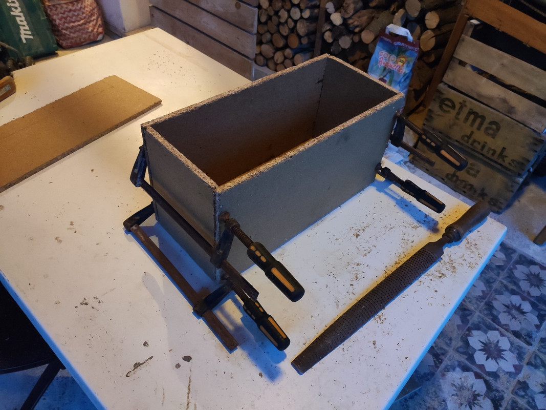

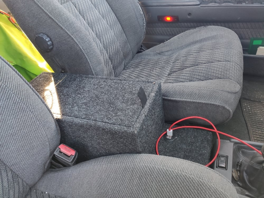

Working on a diy center console.
I'm not yet sure what i want exactly but cupholders and cooling compartment are on the list. More ideas are welcome.

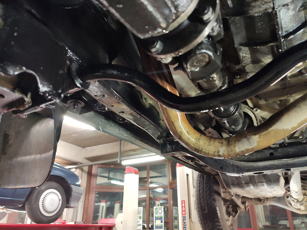

Nice work and nice truck! Might consider putting a rubber boot over your positive battery terminal. I've had a clamp come loose and short pos to ground before, fried my battery and almost started a fire. Wouldn't want to burn up all your hard work.

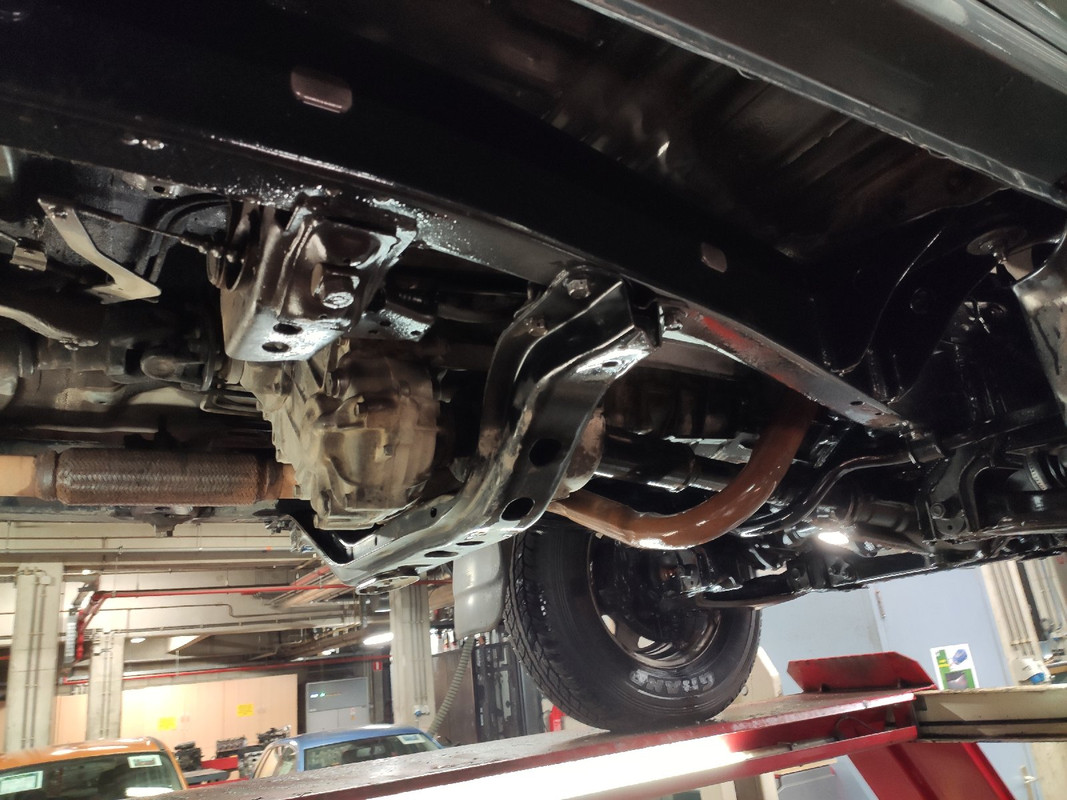

You may also want to get something behind that rust area or it will continue to spread under the paint. Bondo is hygroscopic so it's best to put fiberglass down first and bondo over, if possible. Also check behind the bumper on you rear quarters if you haven't, that's usually the first area to rust but impossible to spot without pulling the bumper corners.
Here's my writeup on a permanent rustproofing solution - Ultimate oil undercoating guide (DIY Waxoyl) but any non-solidifying oil will work well enough for most of a winter. Would def recommend drilling into the body and fogging the area behind that rust with something, then grease the hole and insert a body plug. Someone mentioned POR15, that will put off rust repair but is not a long term solution and has been known to cause more issues than it solved.

That is the last rust-spot on the entire vehicle.
The rear bumper was removed 7 weeks ago because i wanted to install one with a swignout arm but then some virus happend... I'm driving without a bumper ever since... If all goes well, i get the new bumper next week. (fingers crossed)

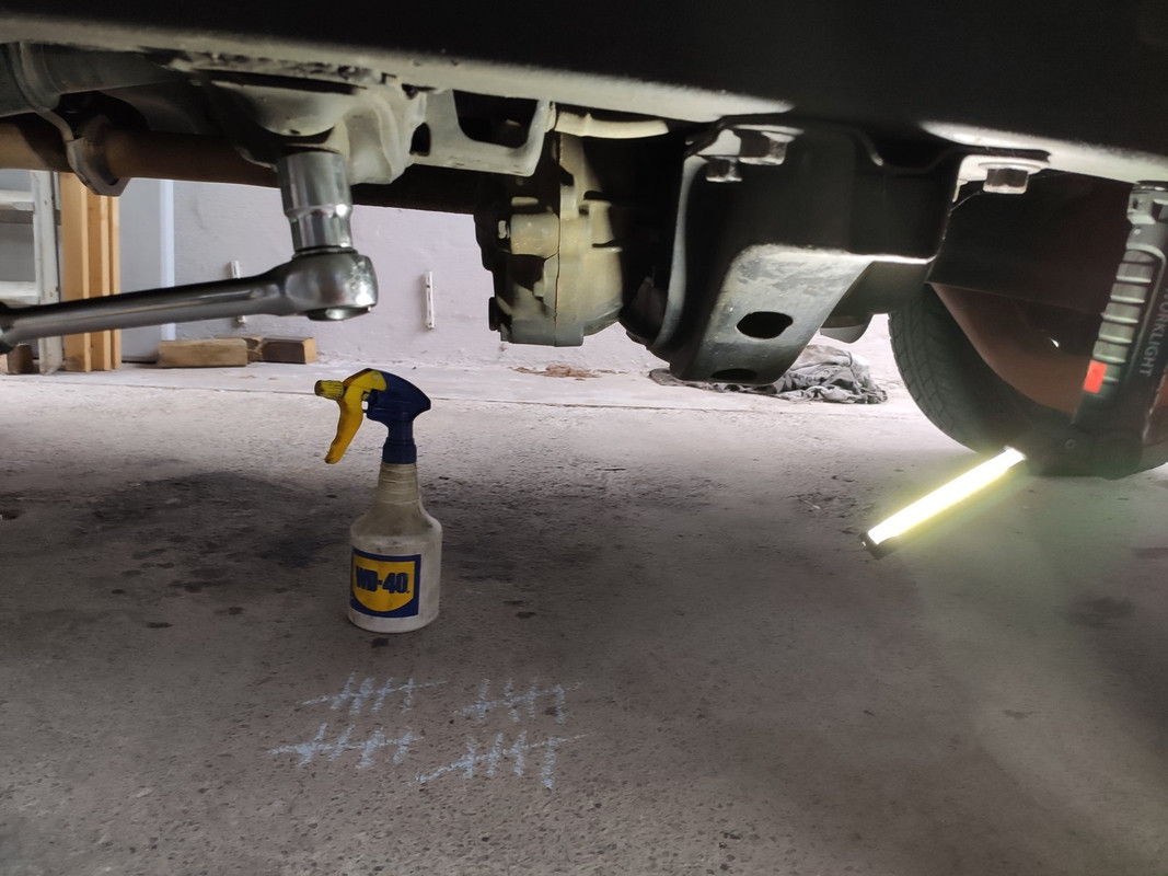

We (a few friends and i) actually just use WD40 and spray the entire underbody with it twice a year. Just before and after the winter. And we use alot of it. We literally take a shower of WD40 while standing under the car wearing dust-masks. Our government-officials at car-centra don't like permanent undercoutings because they can't see what's underneath. And i don't like it either because they start hammering your chassis all over the place :nono:

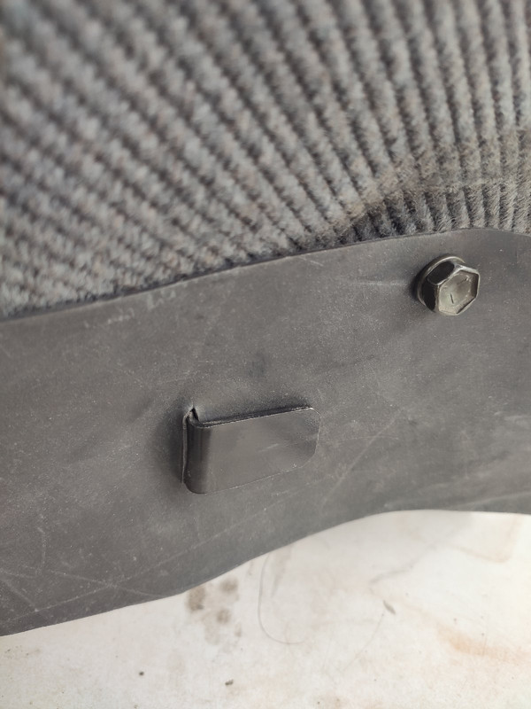

The inside of the rear fenders can be reached by removing the small cargo-panel/box. I modified them so i can take them out without removing the entire sidepanels.

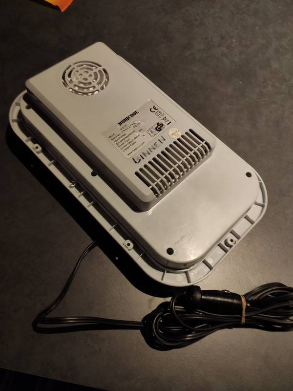

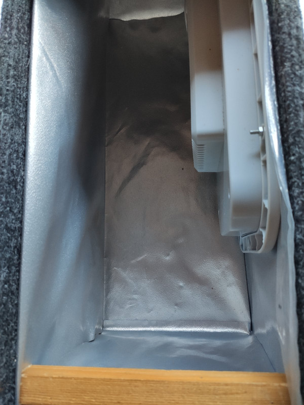

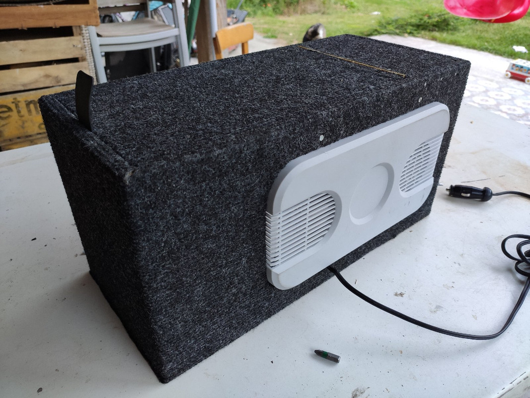

Coolbox is sort of finished...
We tested it @ 25°C outside temp (inside was hotter) and it was cold but not as cold out dometic compressor-fridge. But that's ok.
Now i need to connect the wires as i'm not using the cigarette plug. This will be wired to a switch and the secondary battery.
And because of this new middle console the USB charger has to be relocated so i still have some little work to do.

The new middle console does it's job.

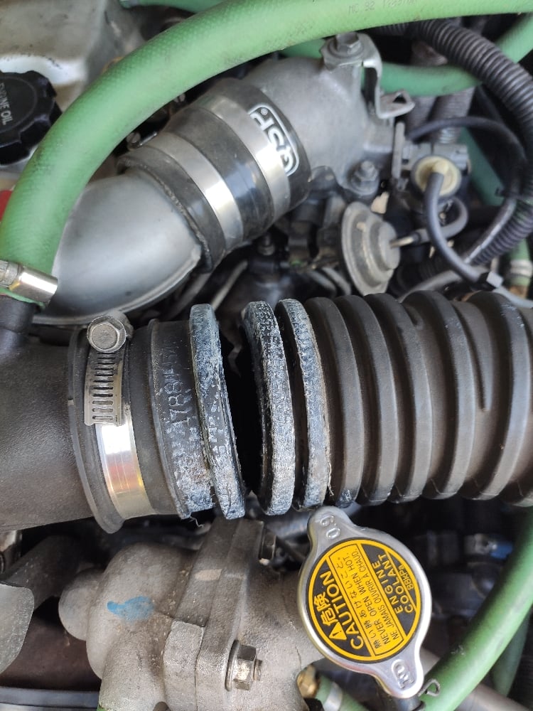

We're on our way back from holiday. Started this morning in Italy. Just when we crossed the French border the air intake duct/hose cracked. Not a mayor problem but we still got 500km to go. Alot of dirty air will be sucked in.
Ok, the air duct may be cracked but with it we got a noticable difference in power. Well, it's not that he gained 10hp or so but there is definitely a 'smoother' ride when going uphill for example. Also less black smoke when pulling op a little harder then normal. The sound on the other hand is more like riding a tractor...
This is logical because the engine just gets more air but i didn't expect it to be so noticable.
So, i'm going to try and open airfilter and see how it compares. A new air intake hose costs about €50 +transport which is too much because it will crack again within 2 years so i'm not gonna bother...

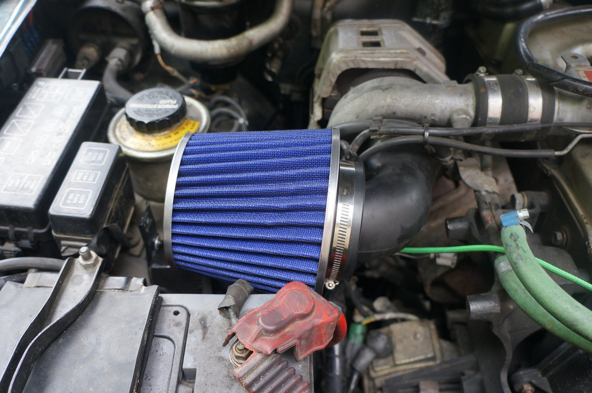

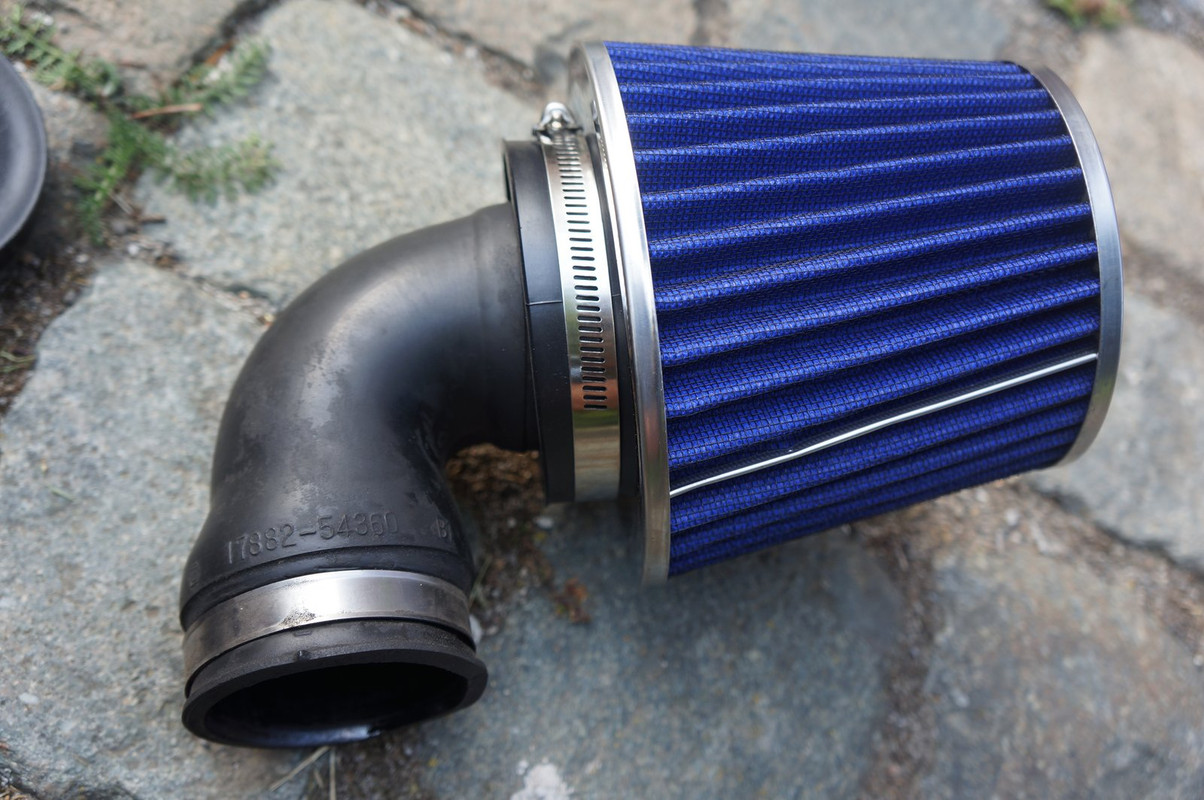

Speaking of power. I installed an open air filter today. Definitely +50 horse power! :guitar3:
No, that would be to easy. But the engine revs more easy and smoother then before. I did e little test drive and the difference is noticeable.

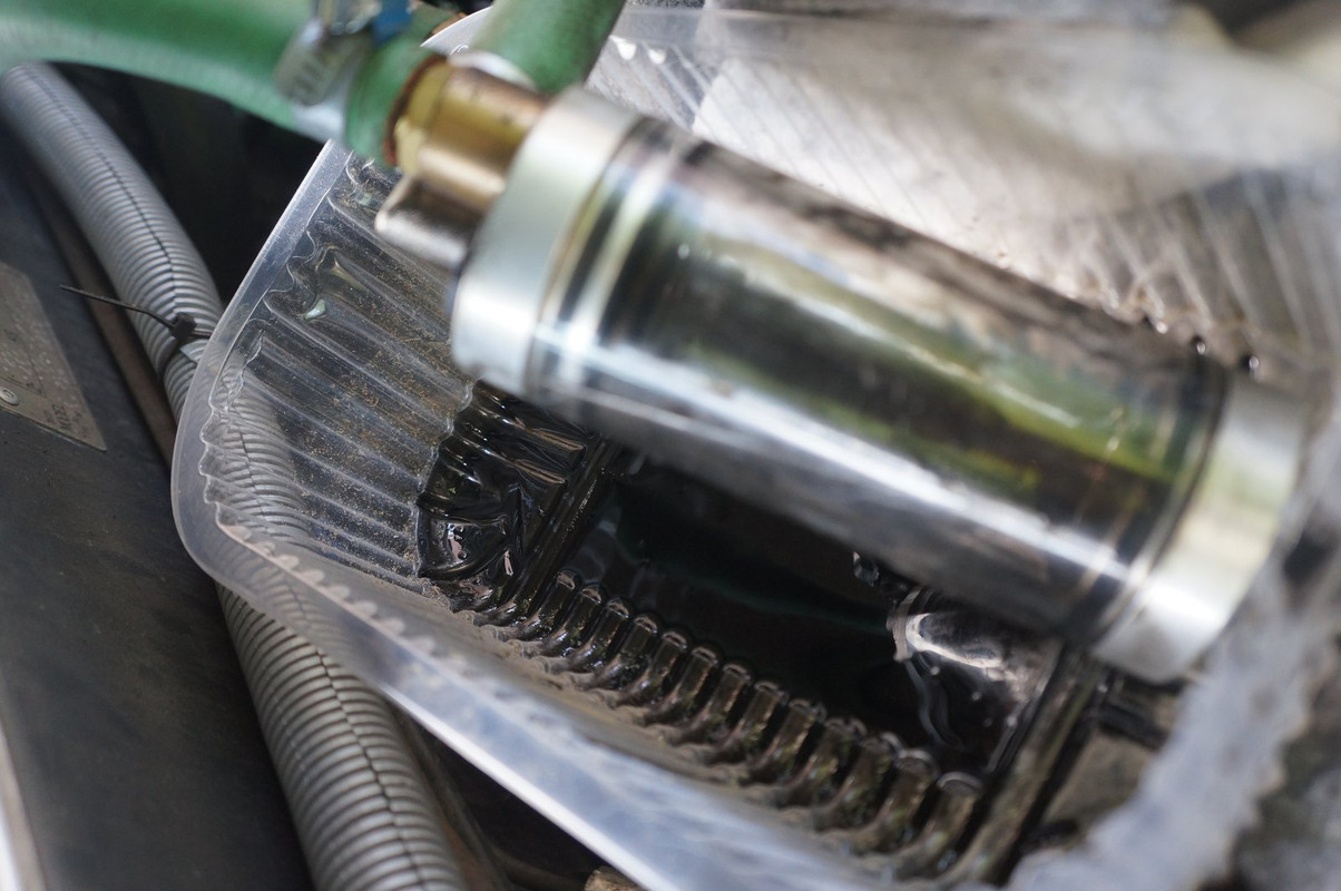

But, there is also a downside. She may get more air but the air itself is also less cleaner. I don't know how or if this will have any affect on the engine. What i do know is to inspect the airfilter on a monthly basis and possibly change it more often.
Another problem is the PCV system (not much of a 'system' with this engine:) ). Normally a return hose is connected from the crankcase to the air intake system in order to re-burn toxic gasses. I still have to tap a new connector to connect that hose. For now it just ventilates into open air. This must be fixed very soon as i do care a little about the environment and i won't pass road-regulations.
Picture time:
Catch-can cleaned after 3000km holiday trip.
And the new 'tuning' :rolleyes: air filter.

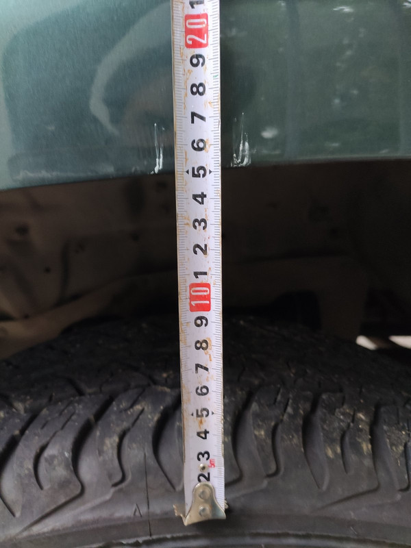

Well, i had to go to annual car control last week and the 4runner didn't pass. I got a 'red card' as we call it here in Belgium. the car didn't pass because of three things:
  1. suspension check: difference between left and right is to high - bad shocks

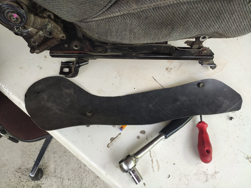

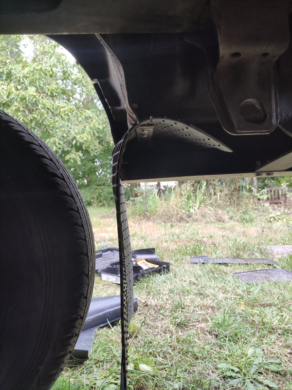

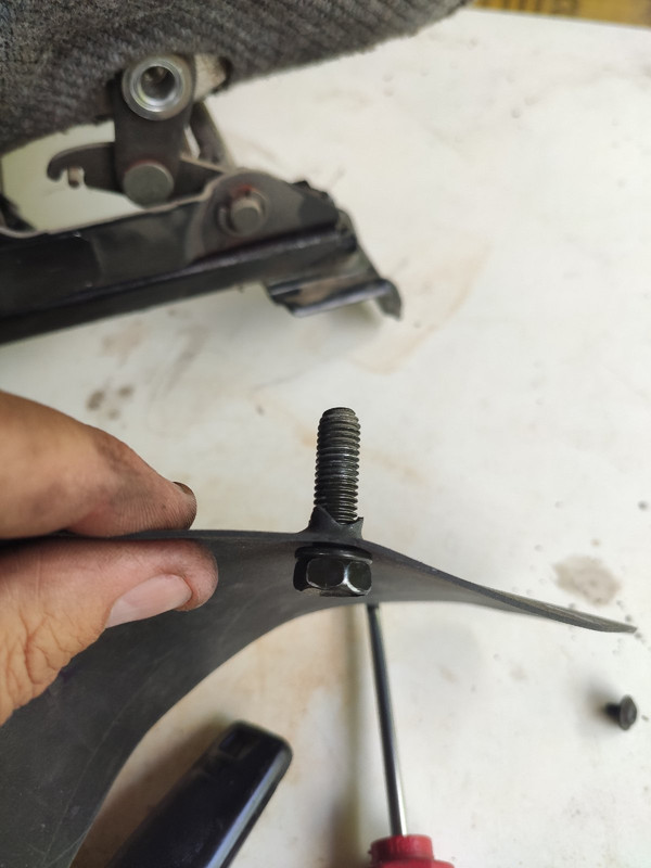

  3. mud flaps: no mud flaps/splash guards installed
  1. this surprises me because the shocks were replaced at 306.802km on the 4 october, 2019. They have only 10.000km on them.
  2. nothing wrong here. This is normal wear. Afaik these are the original ones.

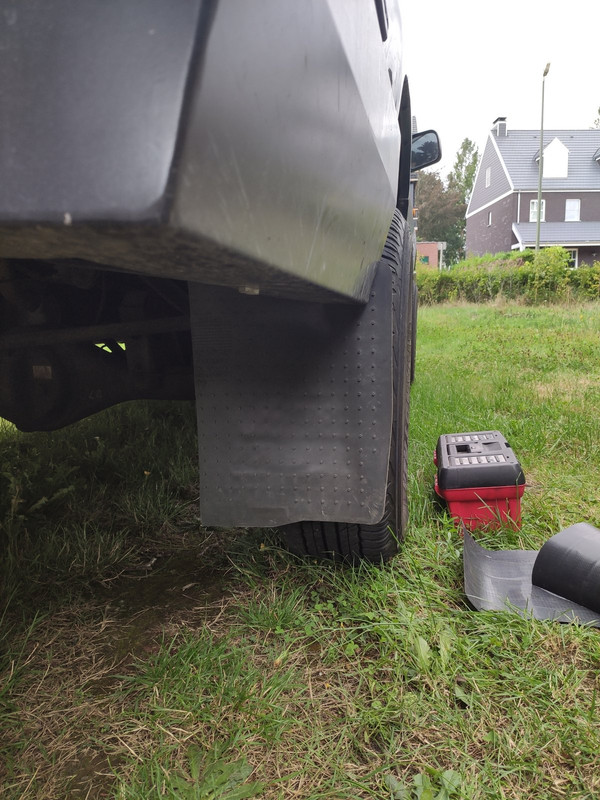

  3. the new bumper is still not finished so i installed temporary mud flaps.
So i ordered some parts:
Mudflaps are already installed:

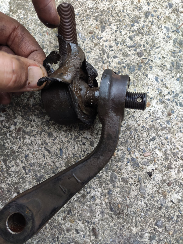

Thanks. I started replacing the outer tie rods. The first one wasn't very cooperative...
Just some basic tools needed to remove the outer tie rod:
The boot was still intact but got smashed during the process:
My initial plan was to replace all the tie rods but there is a saying: 'don't fix it if it isn't broken'.
So, second visit to annual car control. (how do you name this in english?)
Tie rods and mudflaps were ok but suspension was still a problem. 3 officials gathered around and under my vehicle.
One of them approached me and said: "your springs are missing...".
:suspicious:
Seriously. I, myself, had to explain that a 4runner uses torsionbars instead of springs. I was flabbergasted! (love that word)

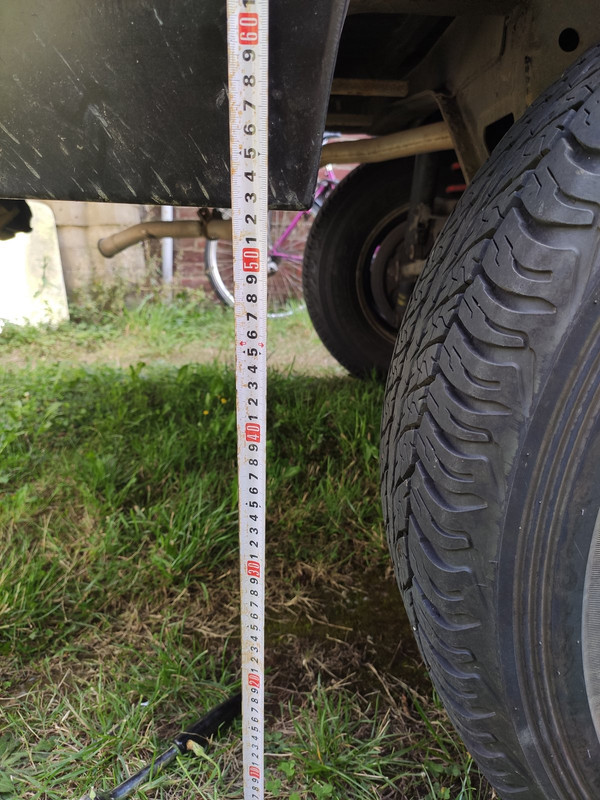

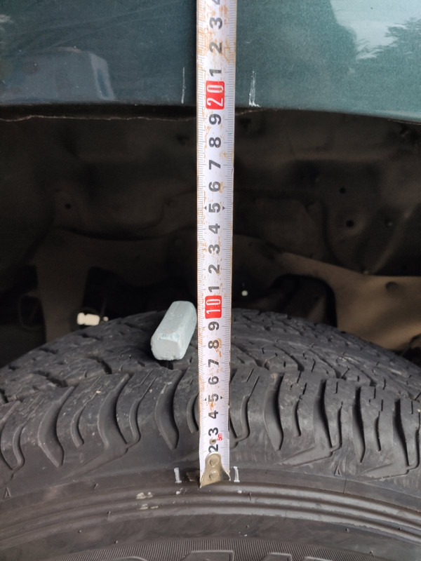

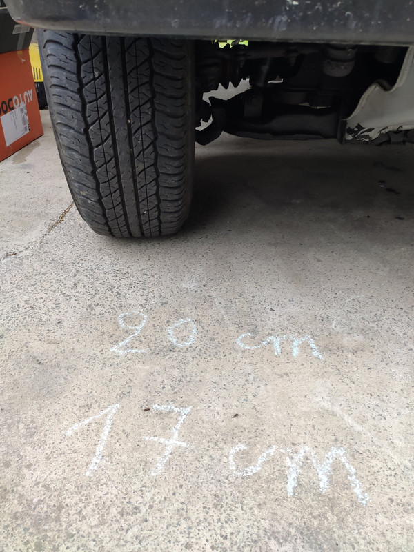

Anyway, i still did not pass the test so i have to go back for a 3 visit so i lowered the torsionbars and deflated the tires to 2.0bar (29psi).

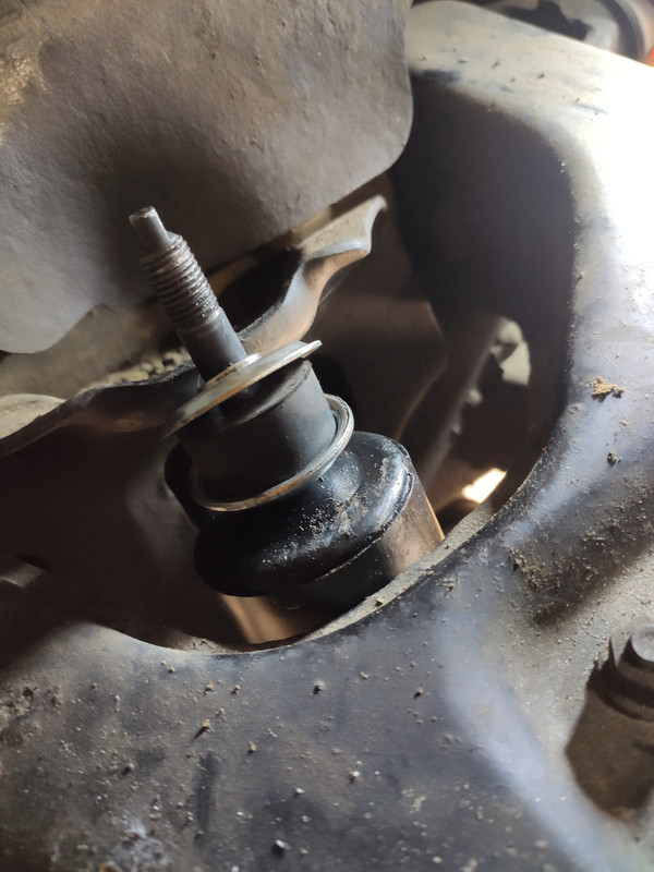

Turned out one of the front shocks was bad so i replaced them both. But i couldn't torque them down all the way because the thread was too short. We (a local mechanic and i) verified the MPN which was correct so we didn't order the wrong product. This likely was a production error or something.
Anyway. We made the thread longer and all was good.

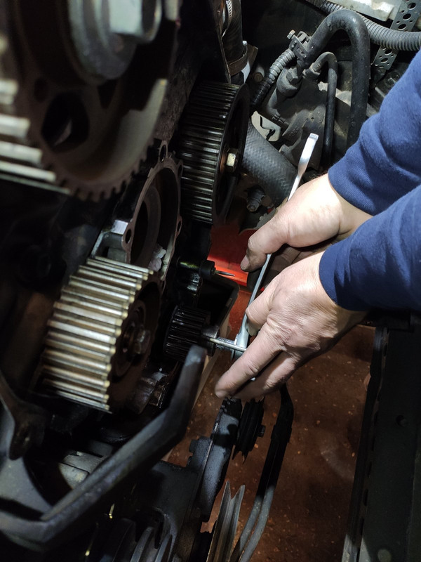

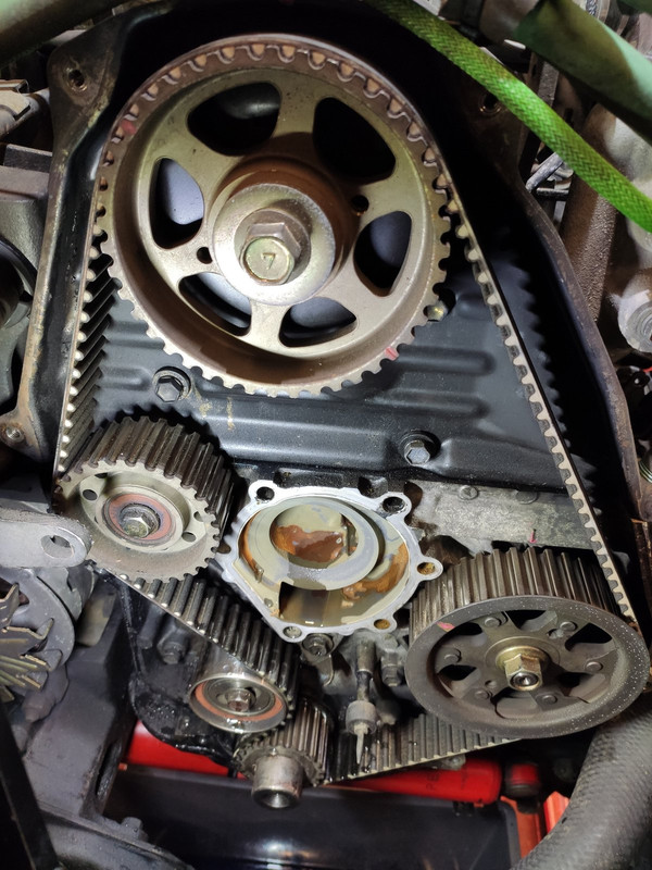

Replaced some more vital parts:

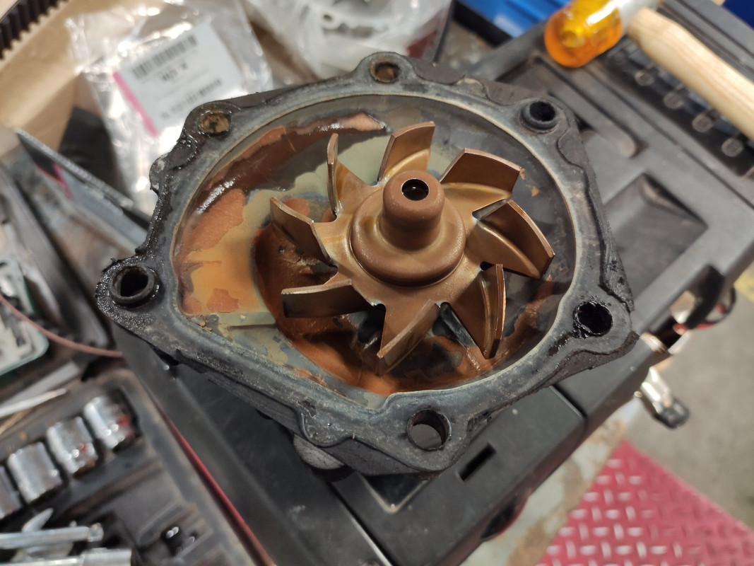

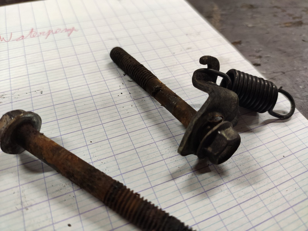

Timing belt, idler pulley, idler gear pulley, tensioner and waterpump. There was some minor rust on the inside of the waterpump but nothing sandpaper couldn't solve. The cooling fluid was also in good condition so no worries there.
Bolts from tensioner had a little surface rust.

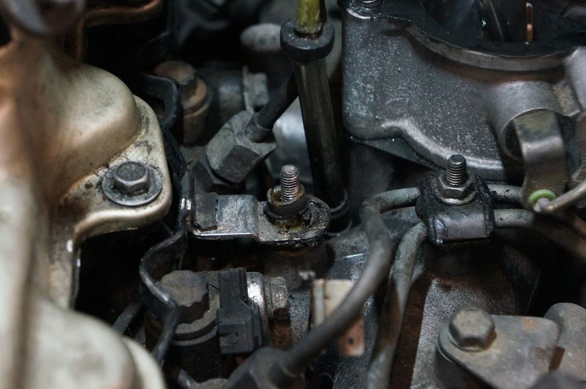

Last 3 weeks the 4runnes had cold start problems. I had to let the engine turn 6 to 8 times before he started. With lots of white/grey smoke as a result. So i checked the glow plugs by removing them from the block to test them with a seperate 12v battery. All of them worked so the problem was elsewhere.
The 80amp fuse was also good but after testing we measured 0.0v on the supply rail. The problem was a melted isolation washer between the rail and engine block.
Starts within a second now. So before removing the air duct and 4 glowplugs, be sure to check voltage before and after the rail.
