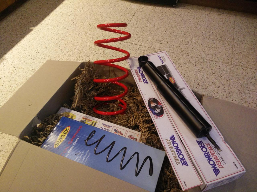

Got a delivery today.
Also ordered the bj spacers from AliExpress. (i know... :ohwell: ) Delivery date is between 2 and 12 november.
I just need to play the waiting game. :whistle:

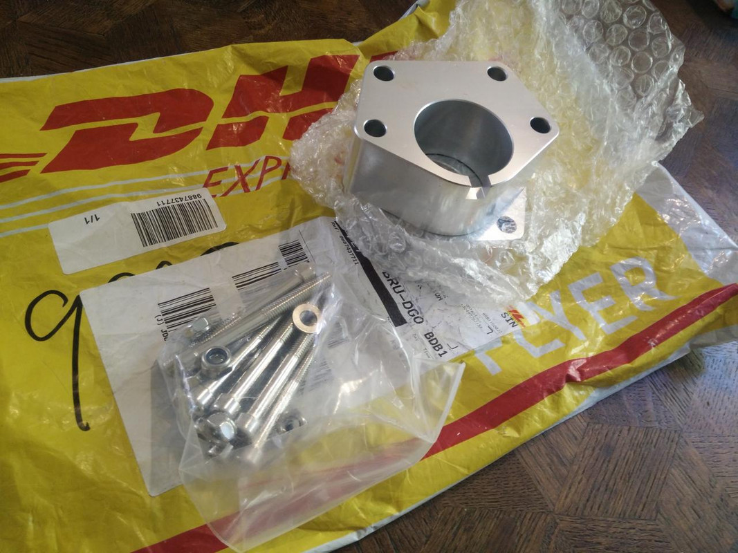

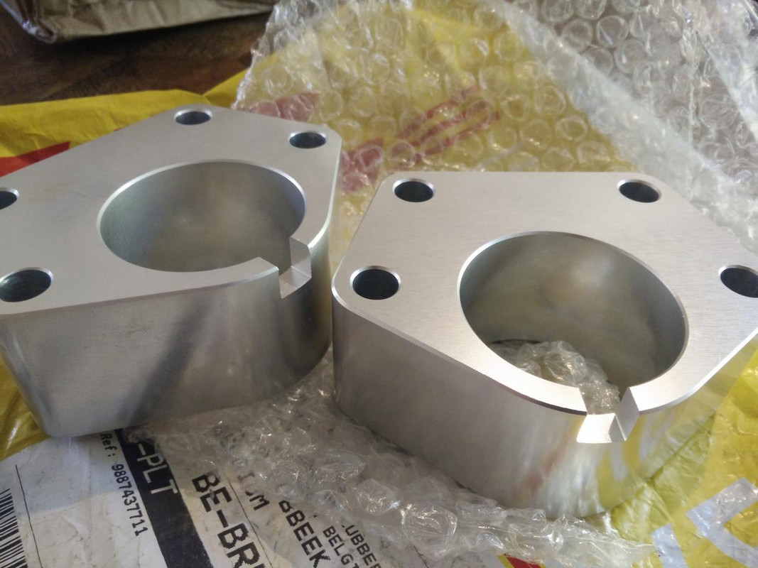

Wow, my BJ spacers arrived today. 5 days delivery from Singapore... I'm impressed. Had to pay extra EU-taxes though...
Block itself is 3,8mm (or 1,5") thick. The nuts are rated A2 70. Which is 700N/mm² tensile strength (or how do you say that in english?) and actually good. I expected less for that price. But no rating on the bolts.
Now i need to find some time to get everything installed...

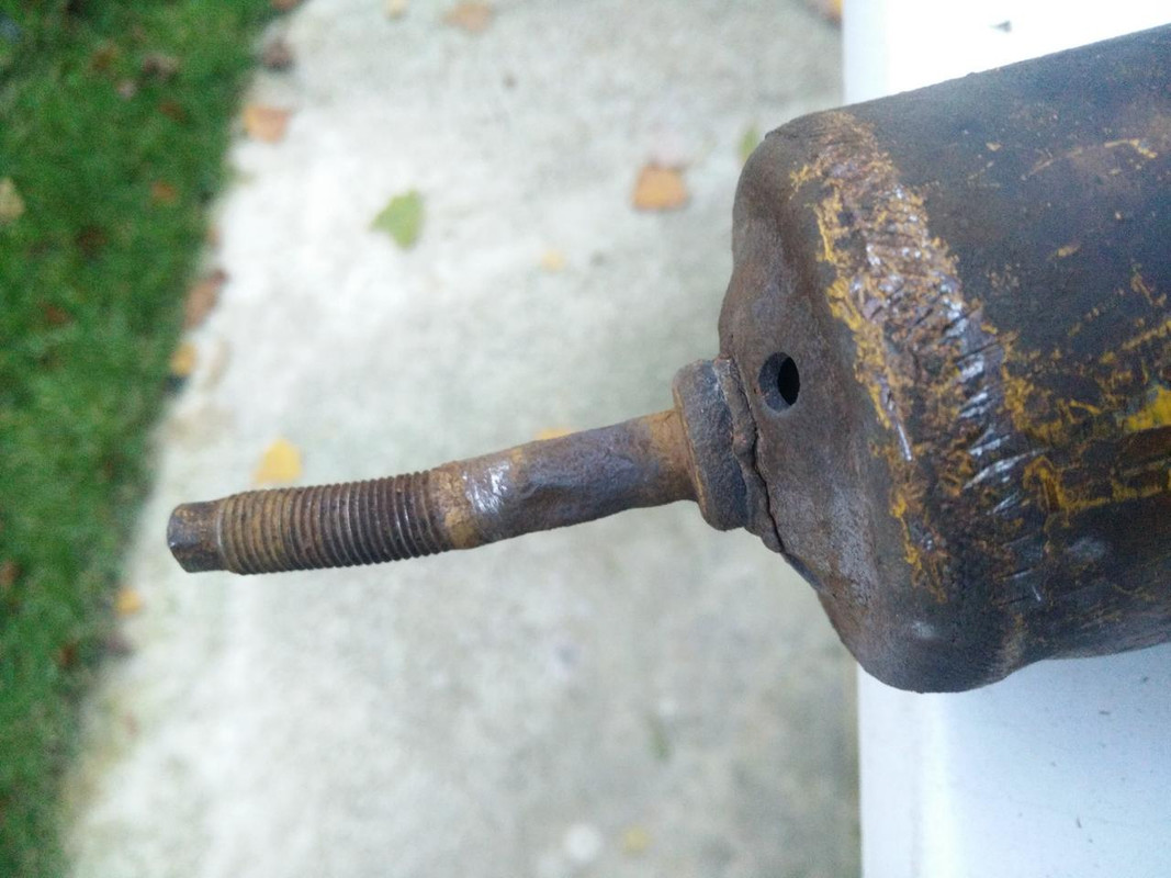

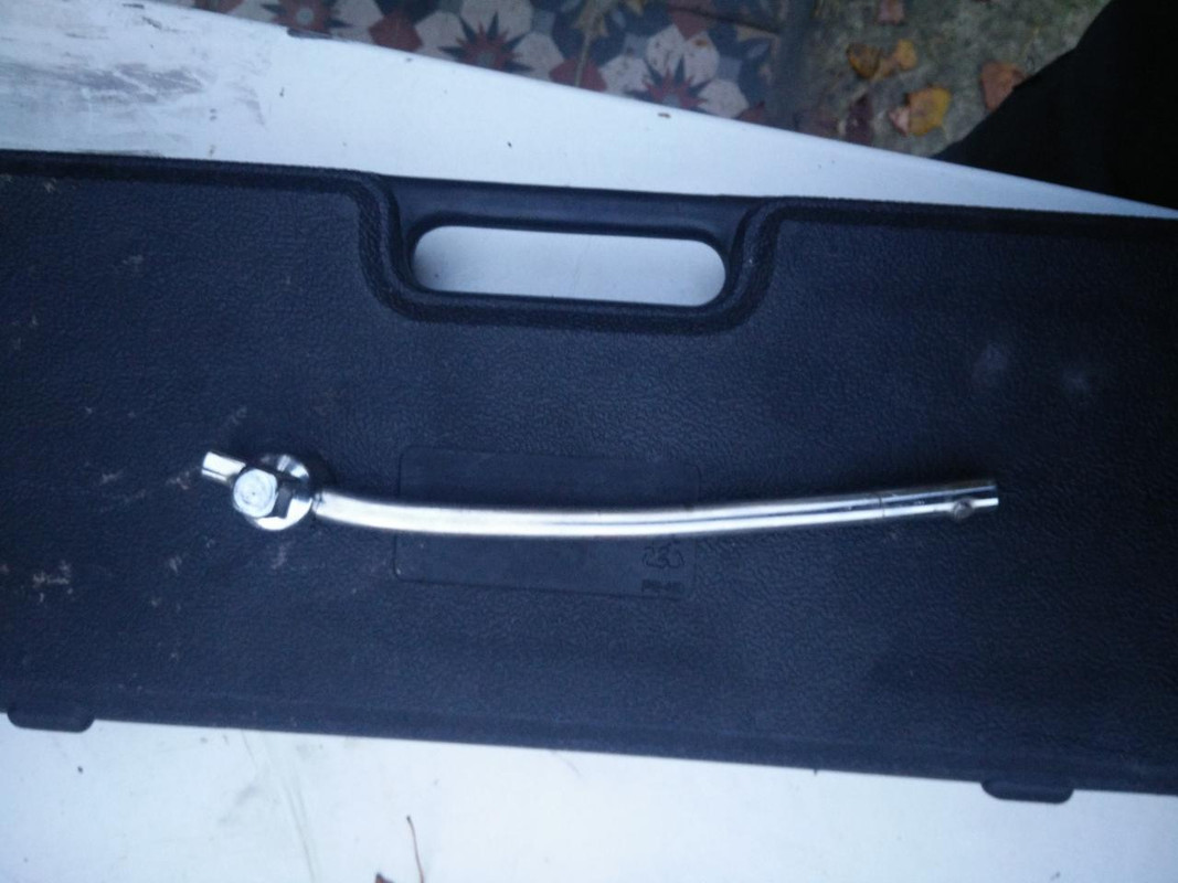

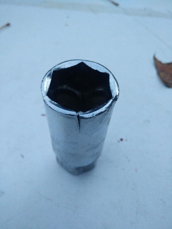

We have a saying 'good tools are half the work'... Well...
So much for quality...
I soaked the upper bolt from the shocks 3 days ago but no succes. So we 'squared out' the chrome bar. (if you know what i mean...)

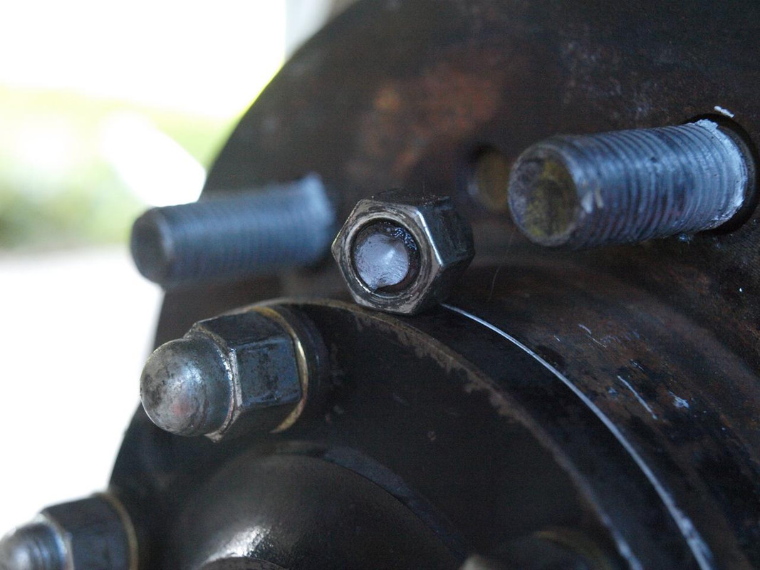

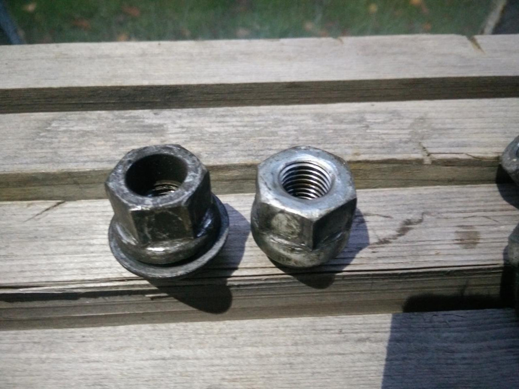

Found out that the PO used 2 different wheel-nuts. It kind a worried me a bit.

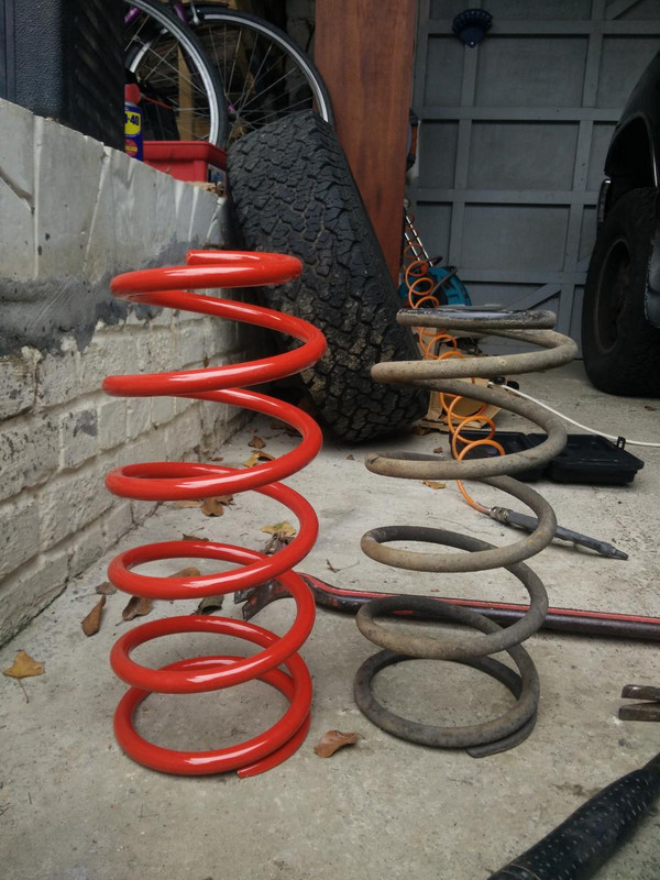

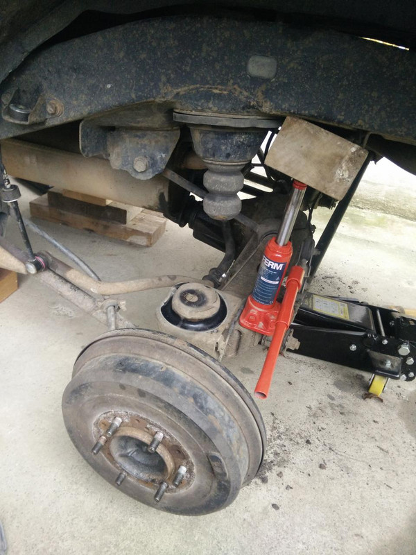

Some more work on the rear suspension...
Old vs new:
The rear is all done. More pictures will follow because it's already dark. Winter time here...

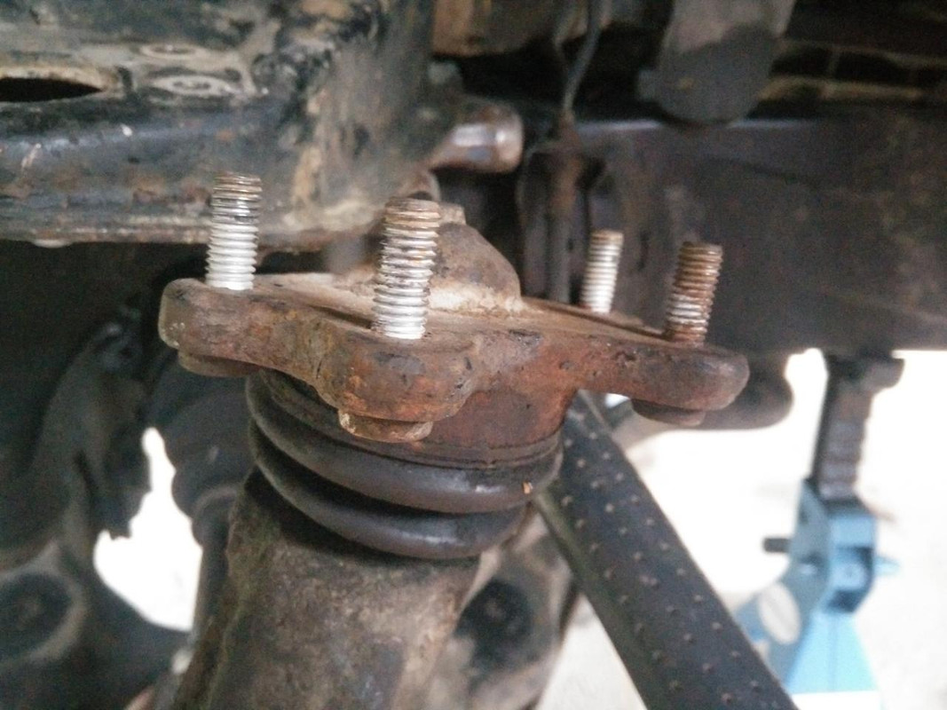

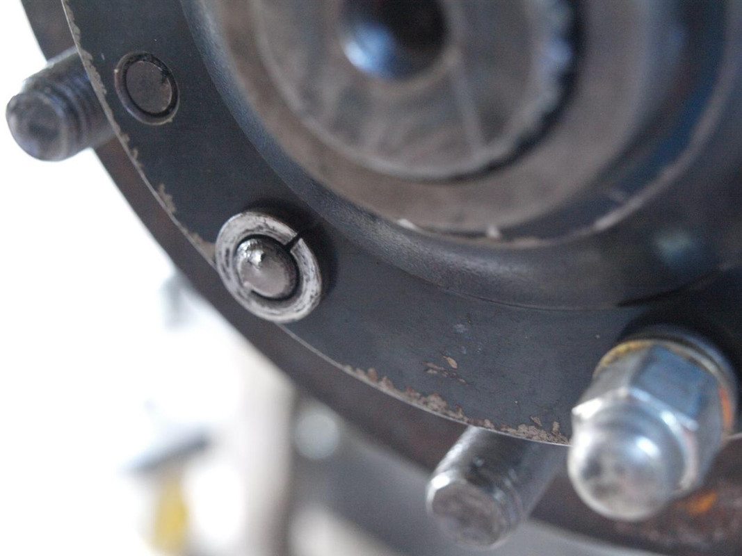

I got the ball joint free from the a-arm but but couldn't get the screws out. Looks like they are pressed in or something?
We tried to remove the entire BJ but the lower bolt wouldn't move either.

Get yourself a big hammer and swing away. You don't need to save them anyway's.
Yeah, we tried that already...

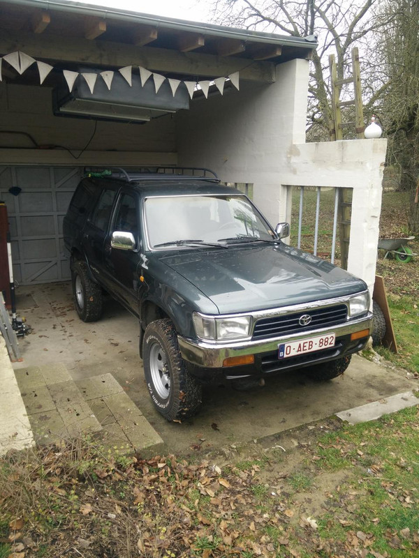

This is how she currently stands:
Clearly the front isn't lifted yet. Tires are 235/85/R16 (31.7 X 9.3 R16).
I'm thinking of leaving it this way. If we install our RTT and rear bumper with tire carrier, the rear will drop and level out a bit.

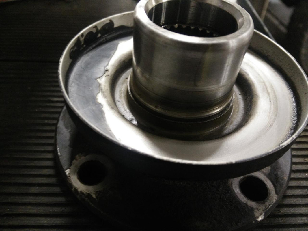

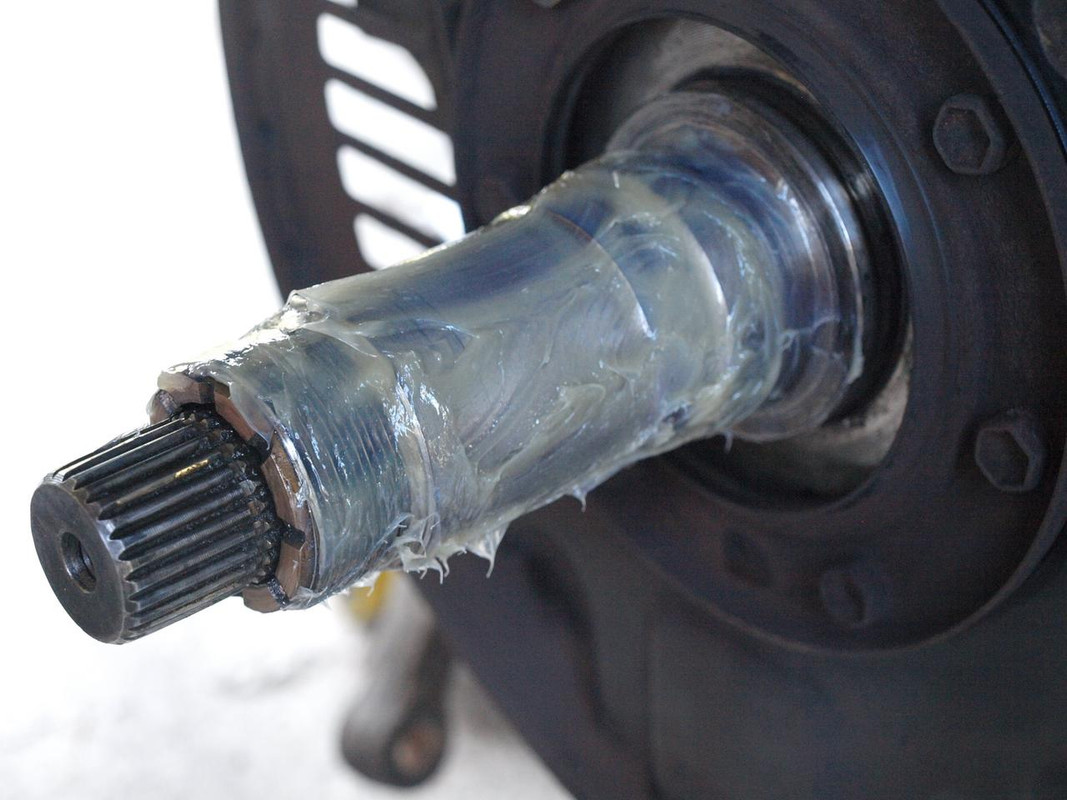

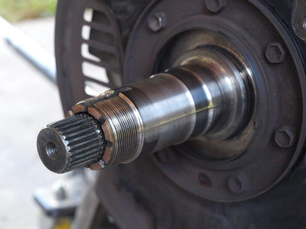

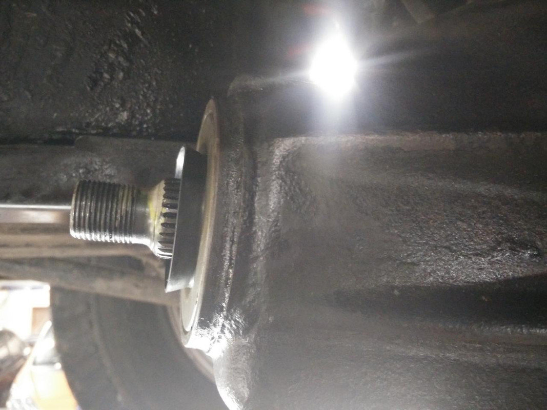

I made some progress this week and replaced a leaking pinion seal.
(sorry for the bad pictures. forgot to bring my camera)

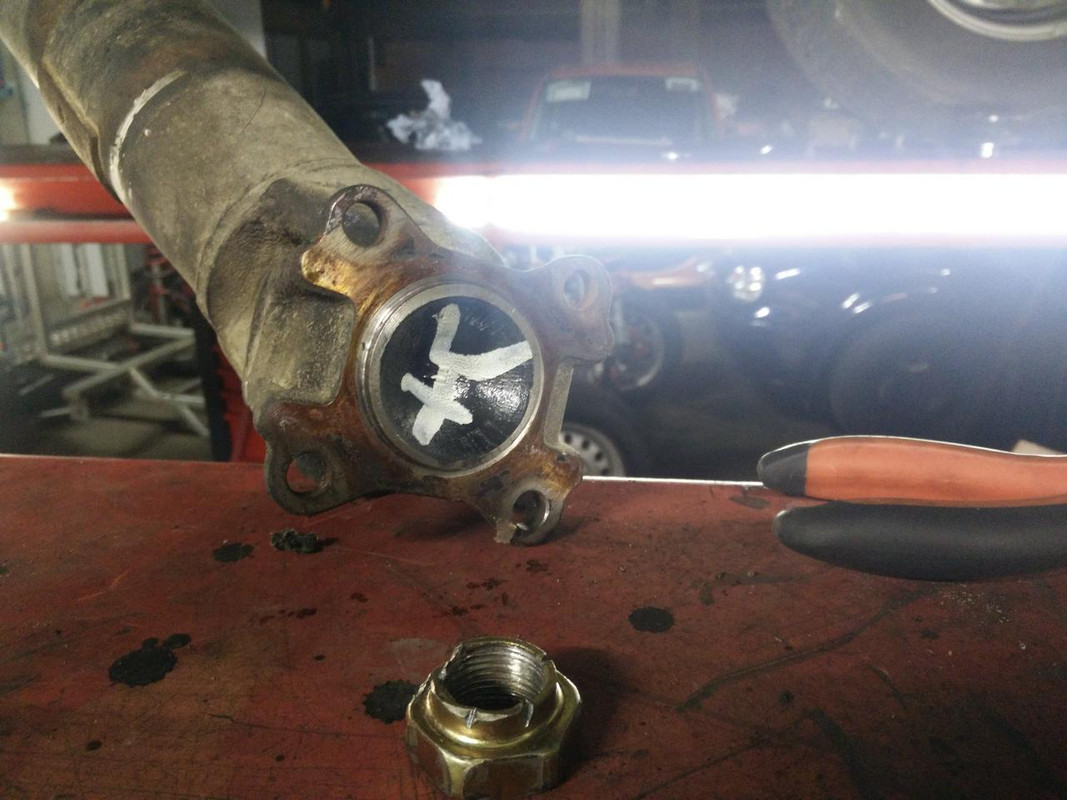

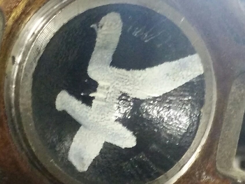

It's not to difficult to do. I found a (japanese?) mark on the driveshaft. Does anyone have any info on this? I'm googleing but without succes... I think i've seen it before on a Landcruiser 60 series.

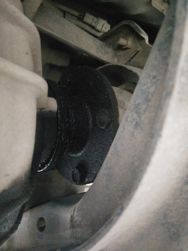

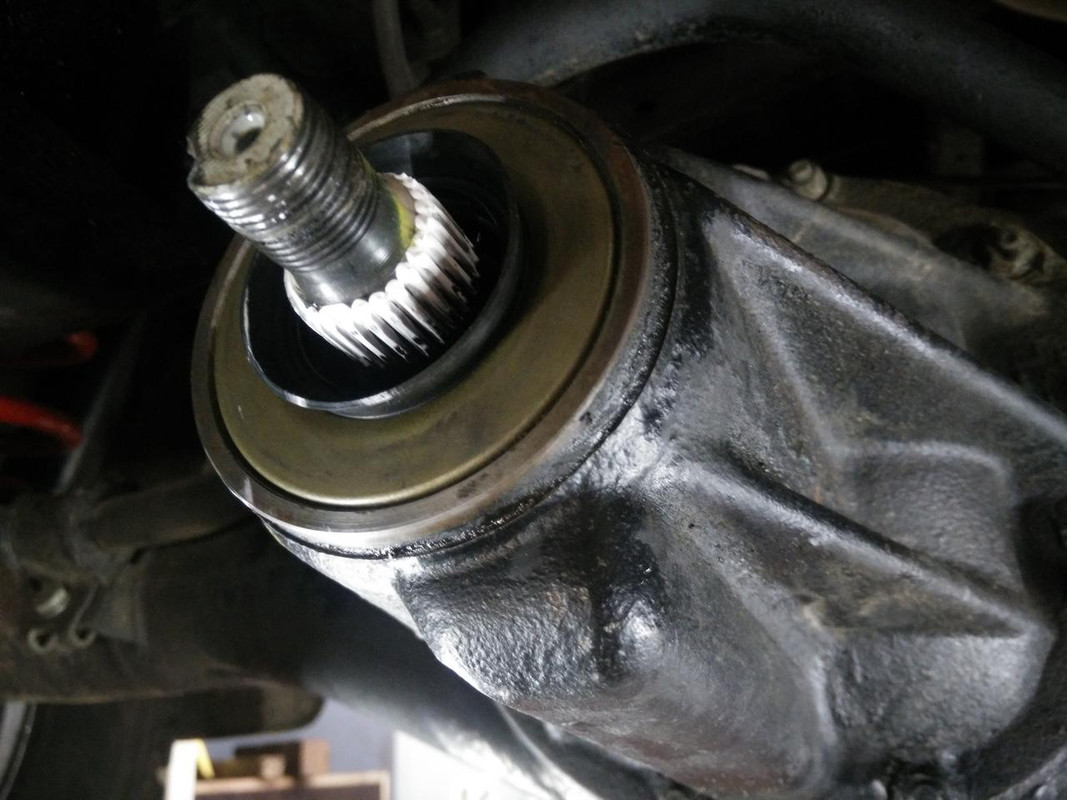

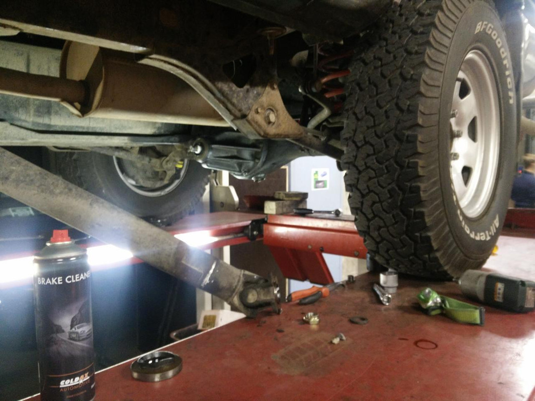

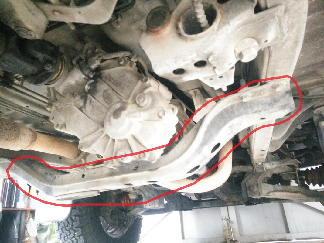

Ok, I need some help here. Has anyone replaced the seal of the front T-case companion flange?
The pinion seal of the companion flange of the driveshaft to the FRONT wheels is leaking and need to be replaced. I wonder if you need to take out that transmission support beam-thing i marked in red?
I'm having a hard time reaching the bolts of the flange. Any hints some of you can give me?

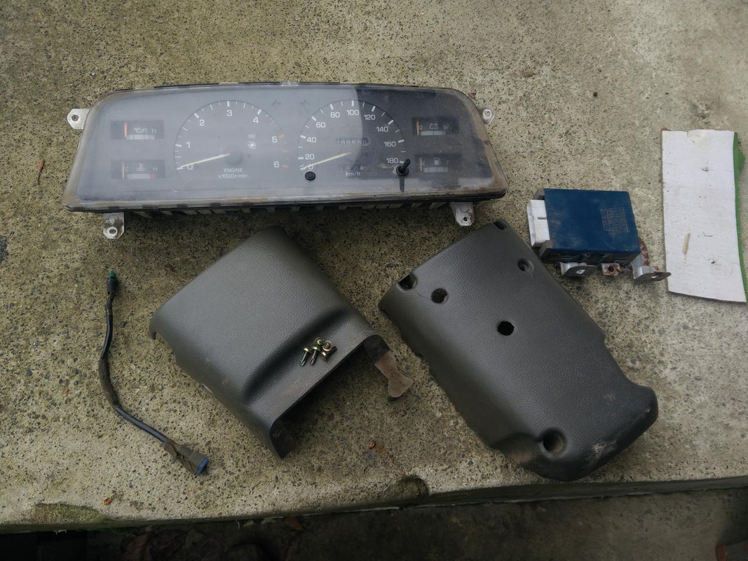

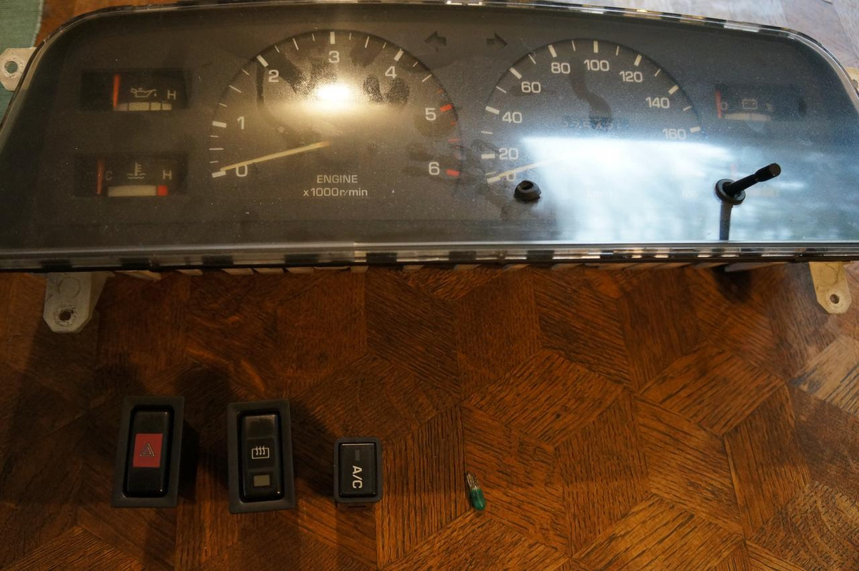

Went to pick up some spare parts. €80 for front indicators (not in picture), rear window relay, steering wheel harness and a complete dash cluster.

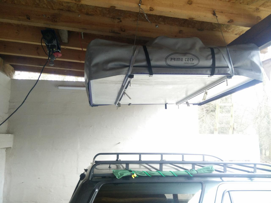

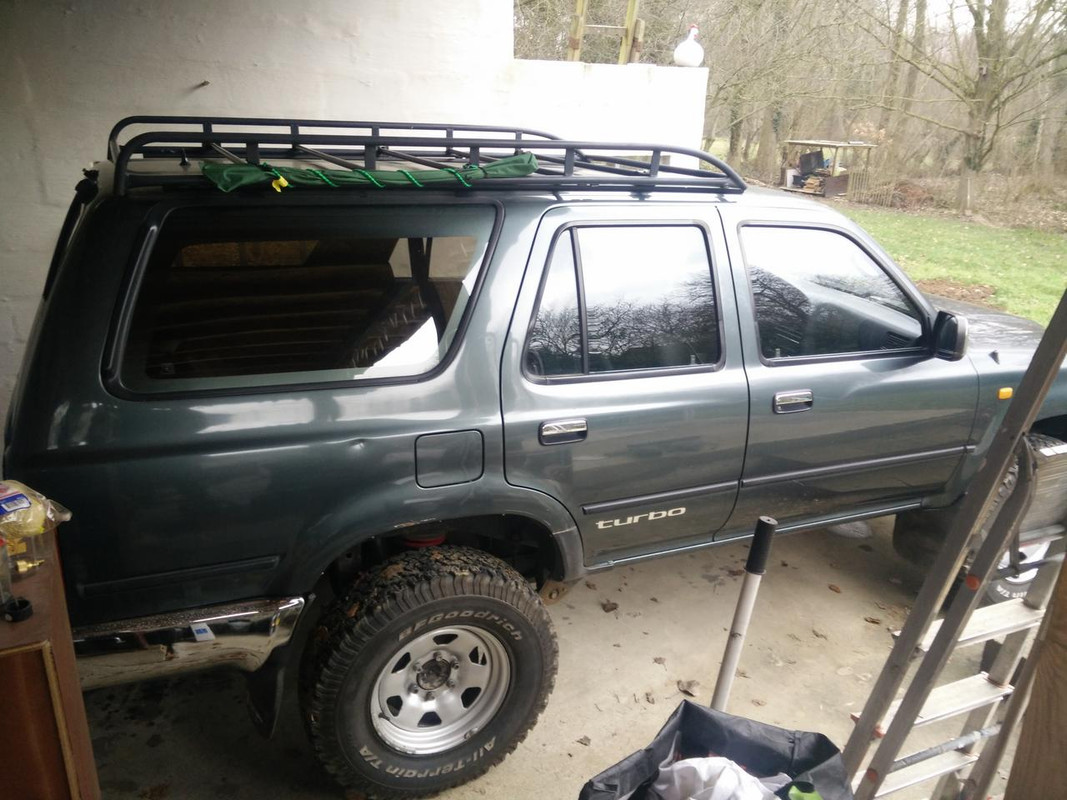

I also installed a roof rack that i bought for €100.
That winch does come in handy when instlling the RTT. :thumb3:

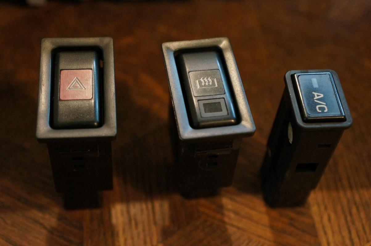

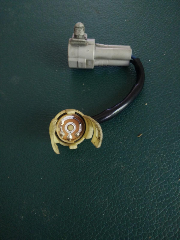

The rear window went up only when using the key. We had to open it with the console switch which was a real bummer... There are a TON of forum topics floating around on the internet but none of them worked for me. I spend the last two months figuring out what the problem was but no luck. Until last weekend :jump:
It was not a faulty relay
It was not the wiper safety
It was not a broken switch
It was not a bad motor
It was a cracked lock-switch
I have no picture of how i fixed it but i just soldered it back together. However, those metal pieces are really, really thin so i don't suspect the fix would last long. I'm planning on installing a new one in the near future. But now i can operate the rear window again with the key!

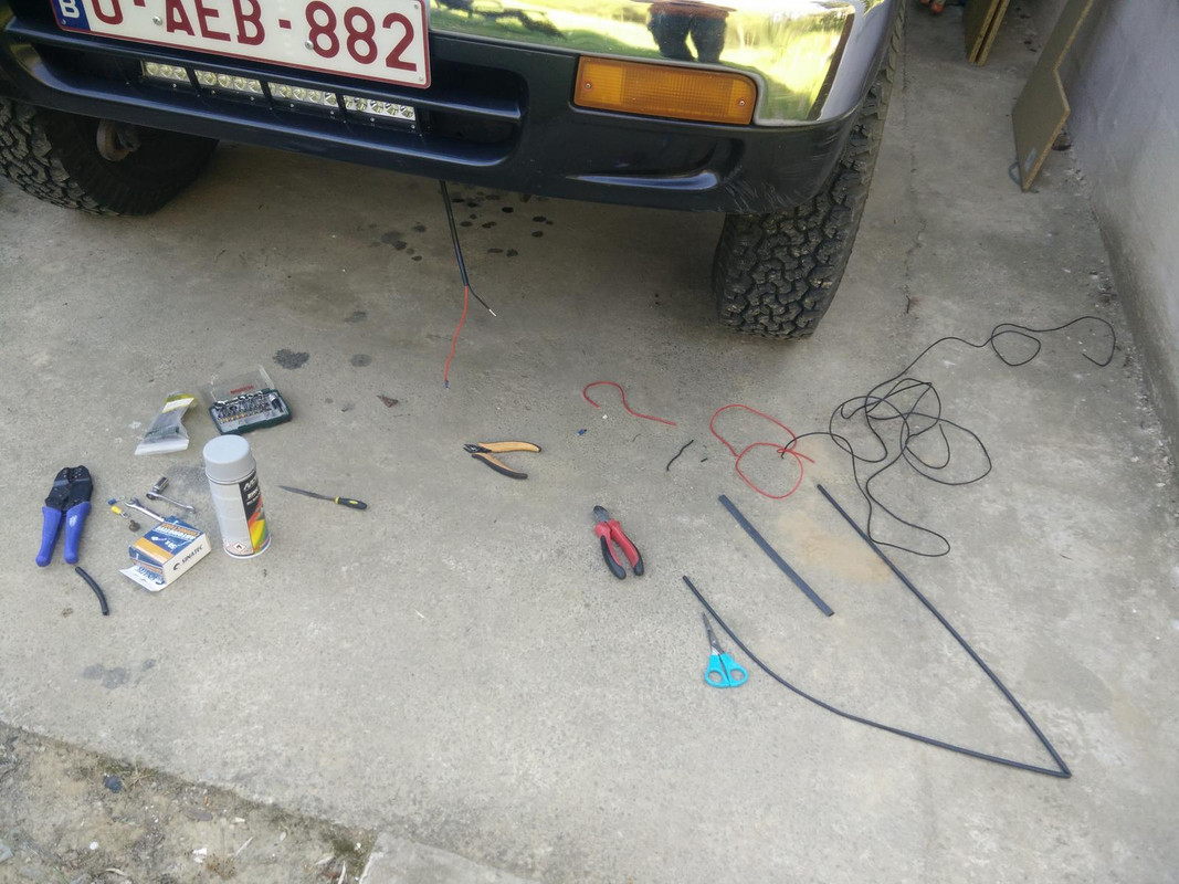

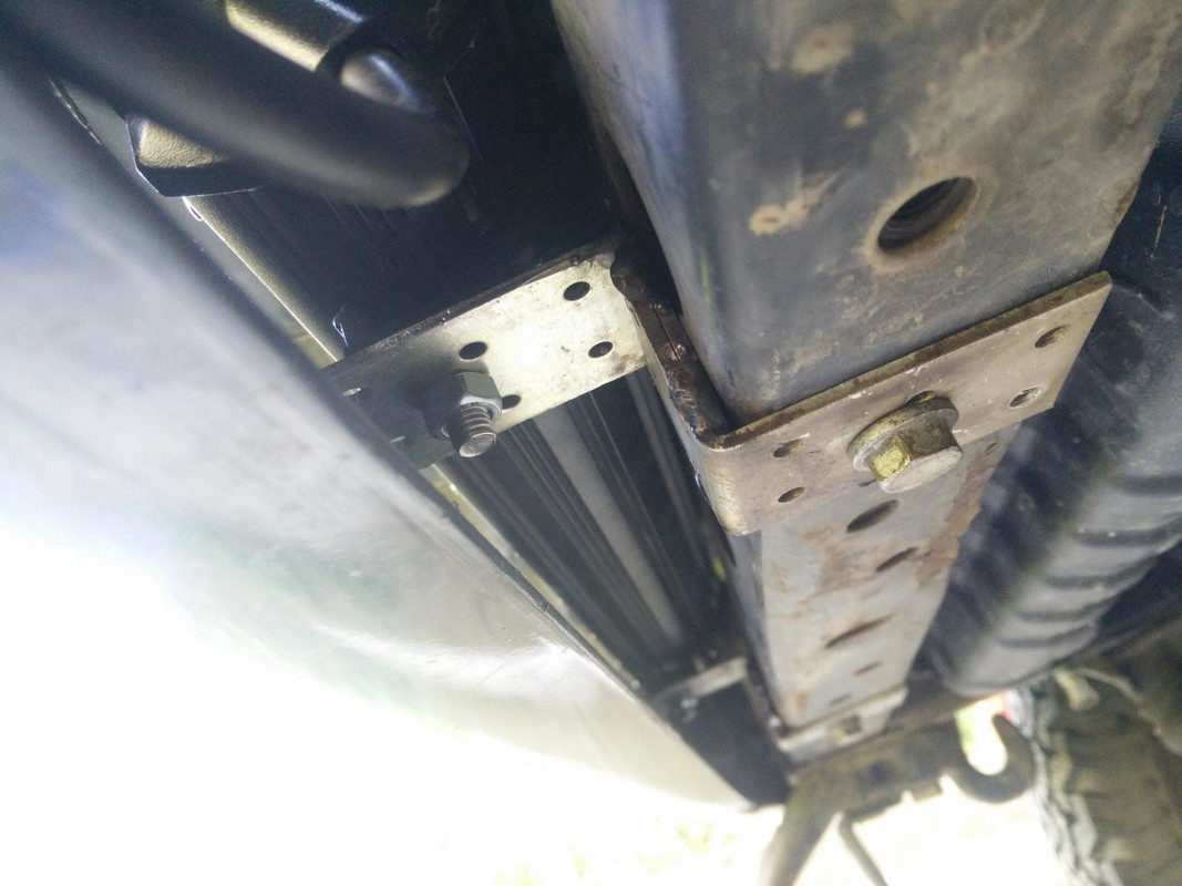

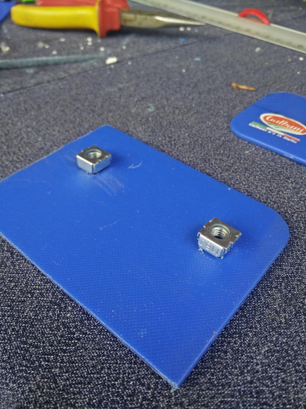

Another thing i did was a bit more fun. I installed my 'given-to-me-because-it-doesn't-work-anymore' light bar. It was a 1 meter wide light bar but only half of the leds worked so i just cut it in half and put it back together.
Home-made brackets...
Ground contact.

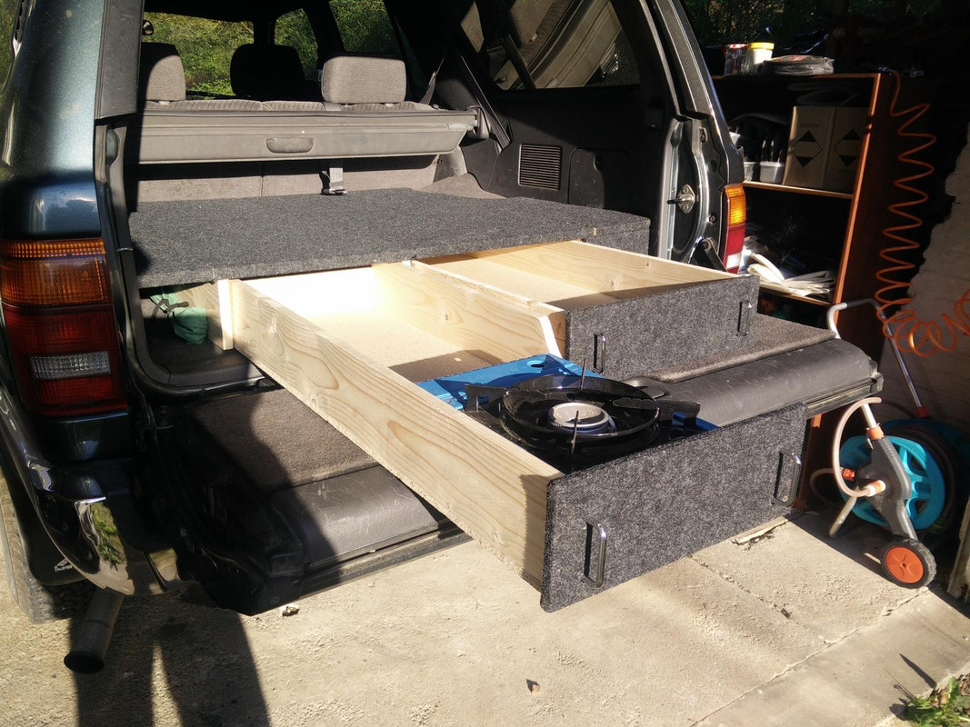

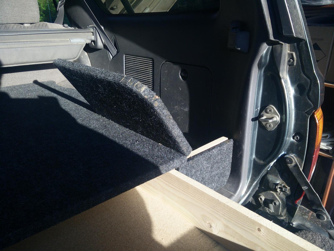

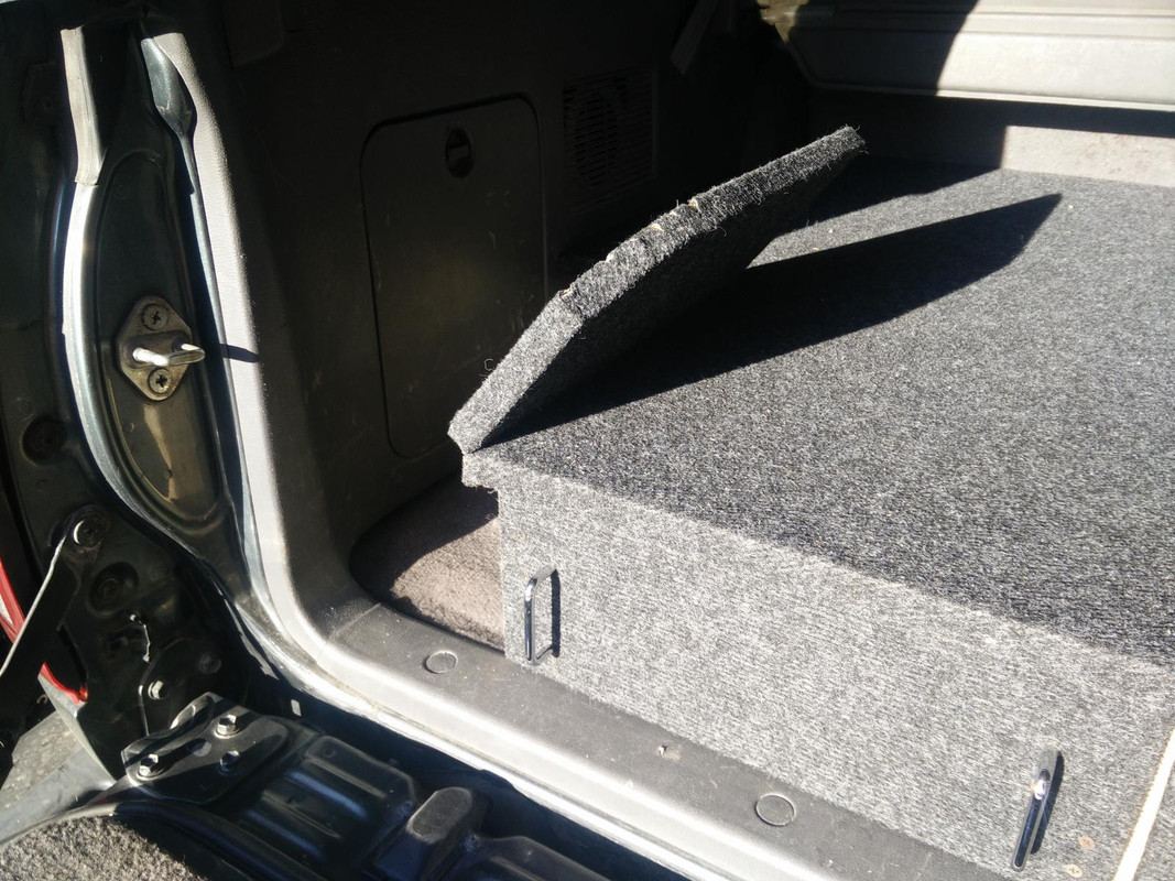

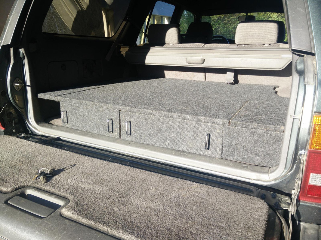

And last but not least, i made a very simple truck bed with drawers.
I want to install a 12v usb charger in the back but i haven't figured out where to put it...

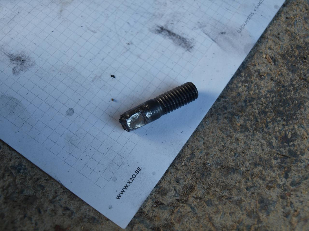

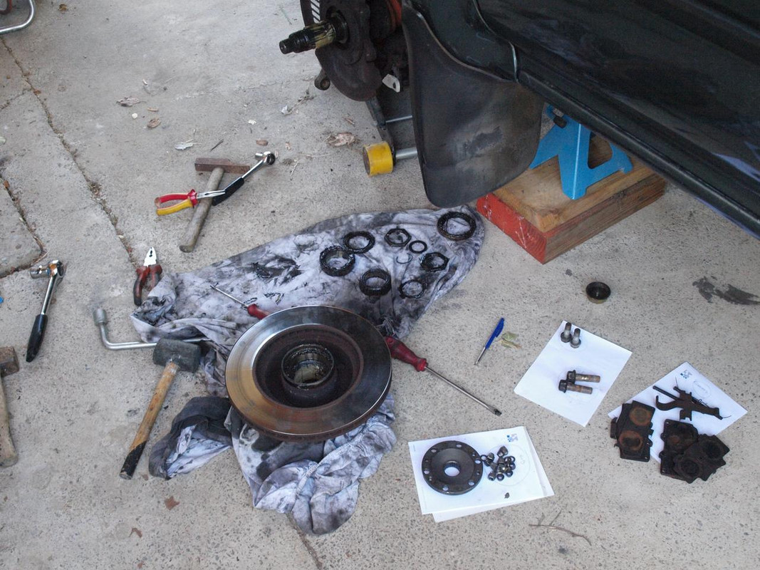

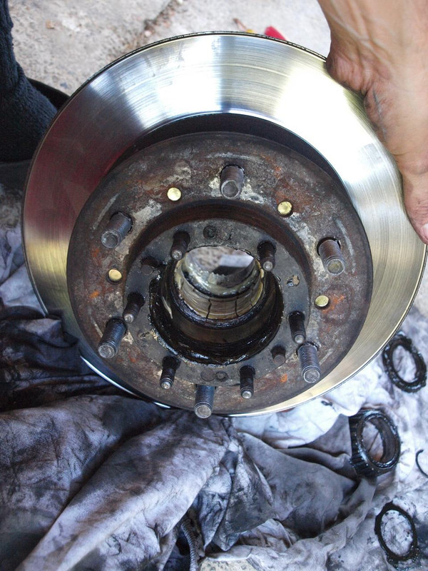

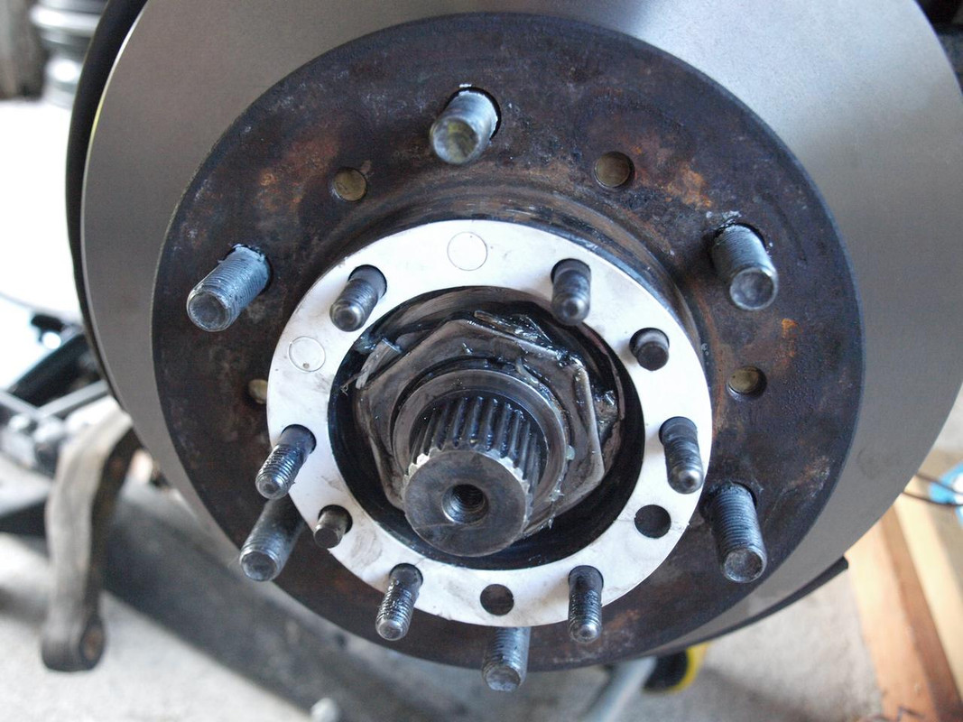

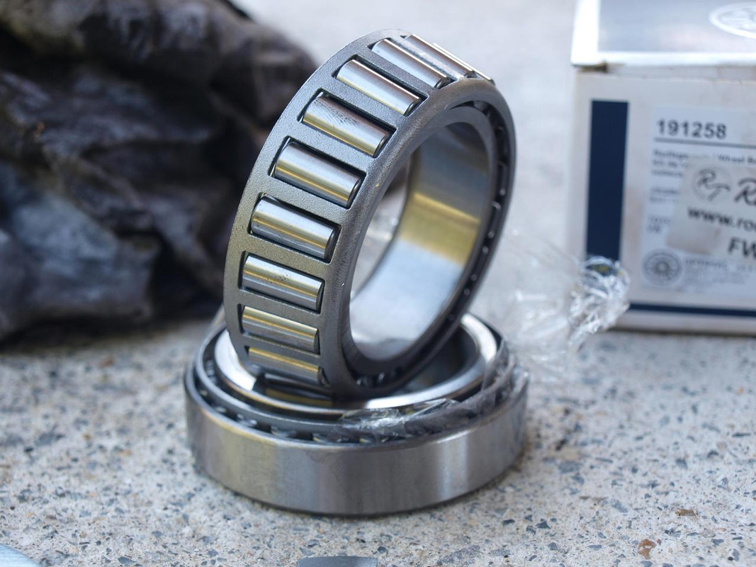

The most important thing i've done was installing new front discs and bearings.

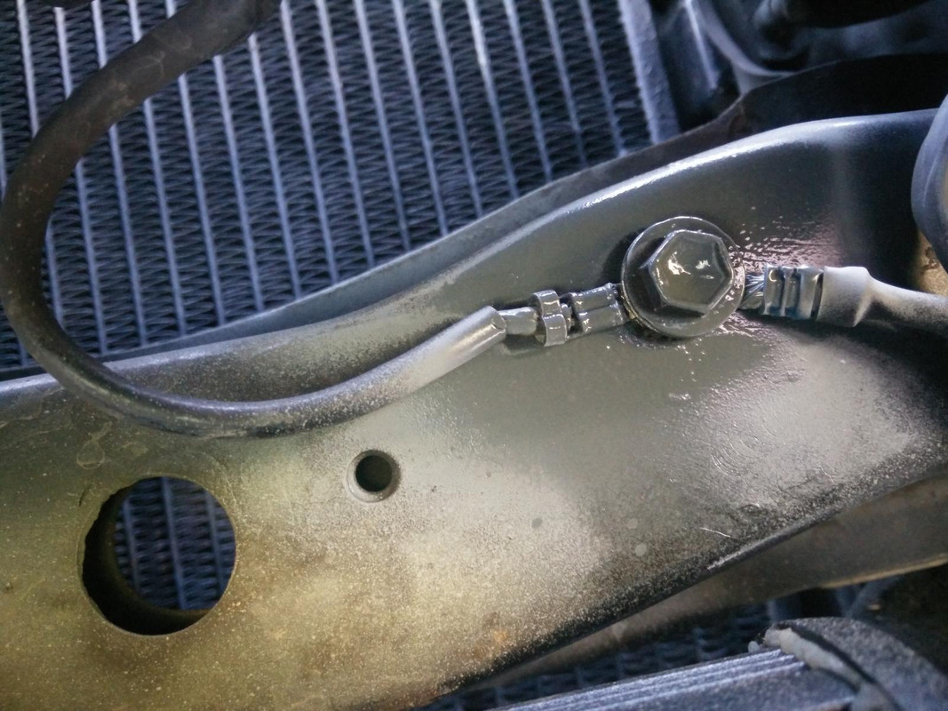

And then this happend...
This was done WITH a torque-wrench @ 31Nm so it's either a bad bolt or trorqued wrong by PO. Anyway, this one is fixed but i'm planning on chaging all of them just to be safe.

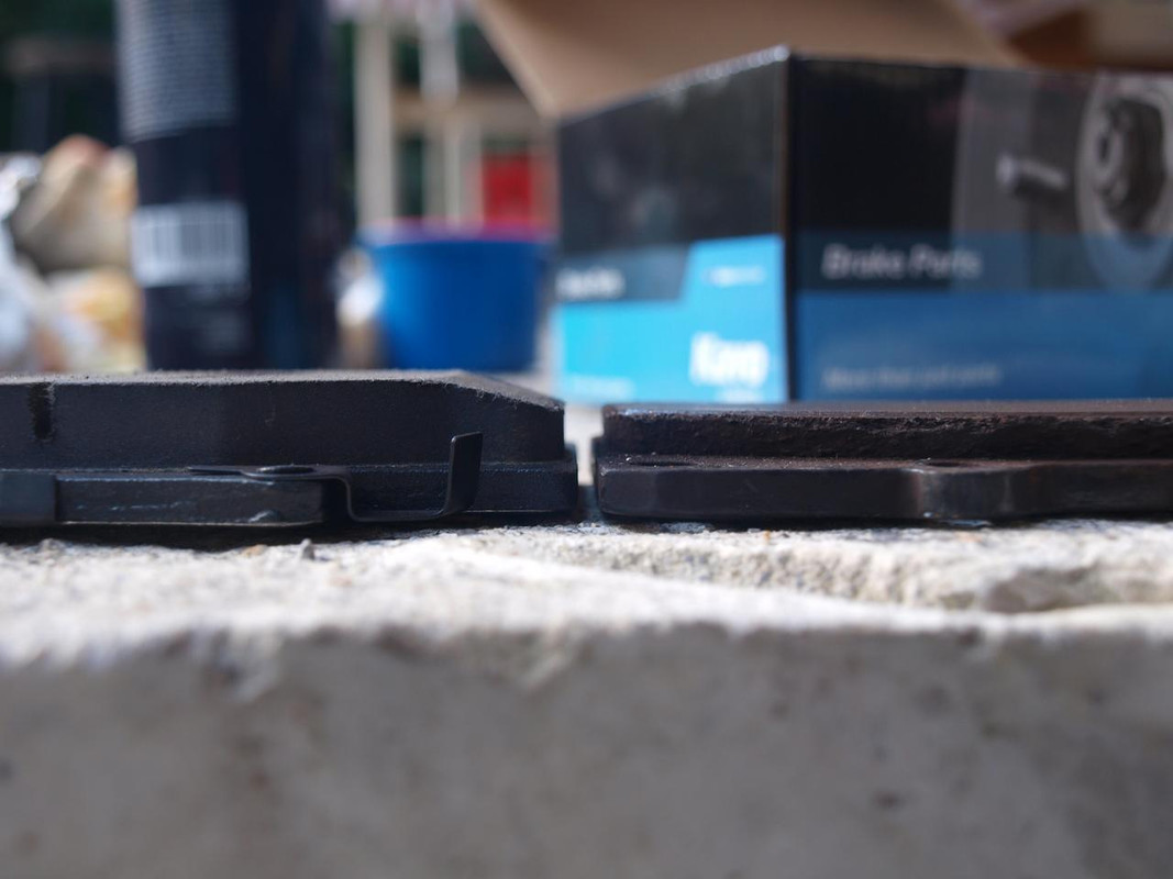

With the front discs removed i also replaced the front shocks and of course new brake pads which was a simple job.
Monroe Adventure if anyone is interested. Nothing fancy.

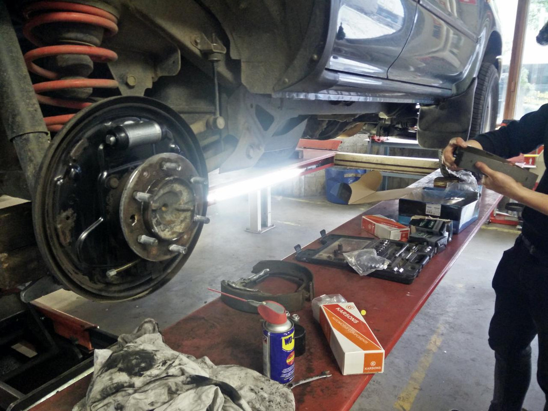

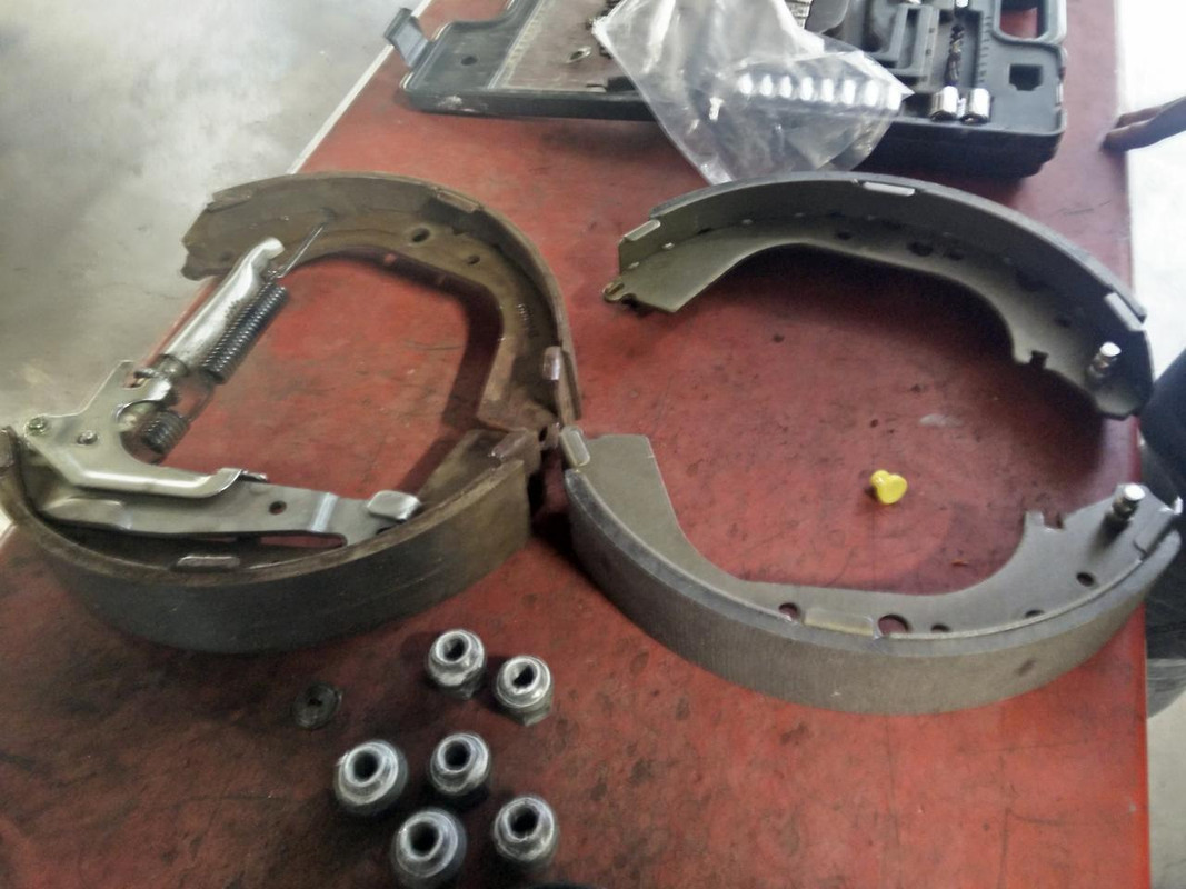

And because i was into brakes the rear drum's (+ pumps & springs) where replaced too.

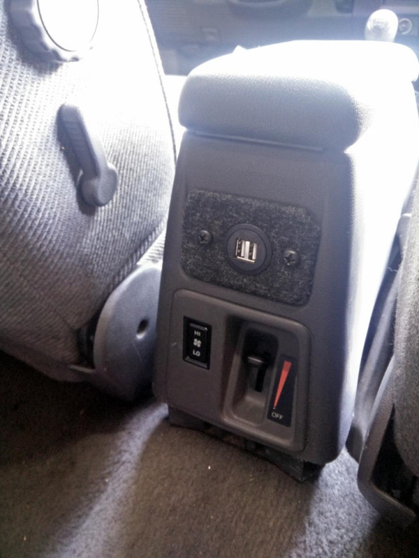

USB-charger installed between the front seats. It's a decent one with 4.2 amp. Passengers can charge their devices now :thumb:

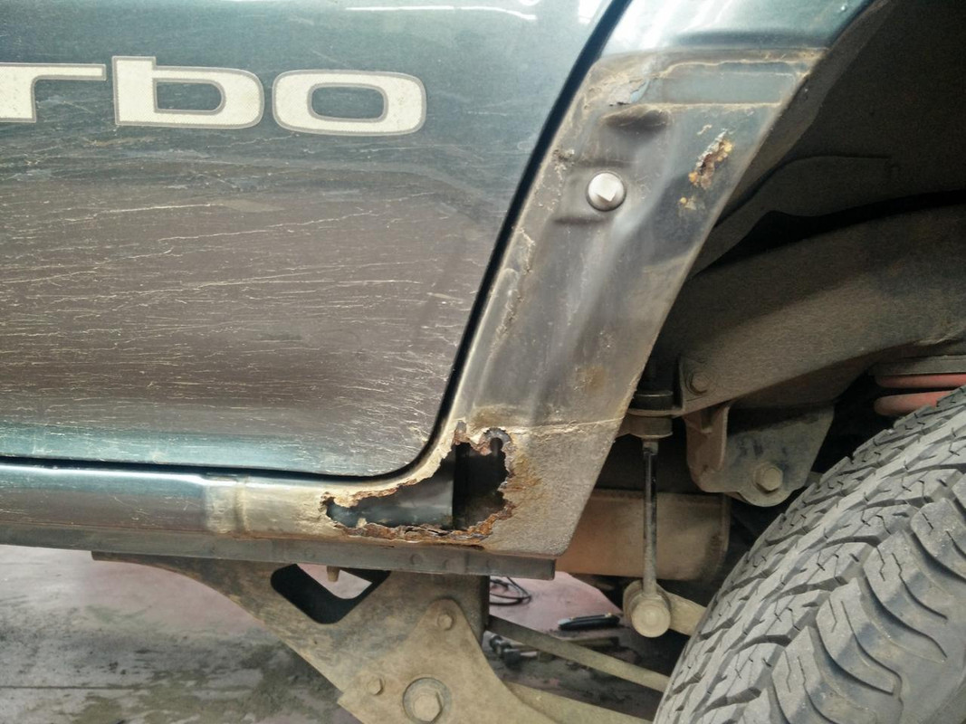

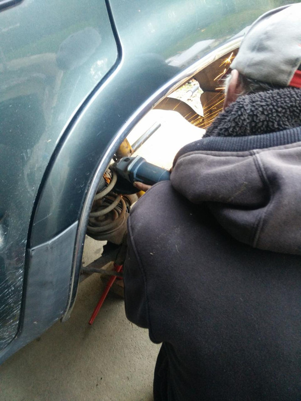

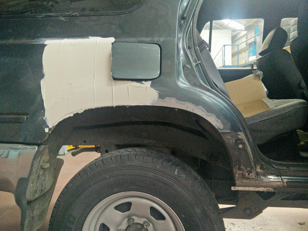

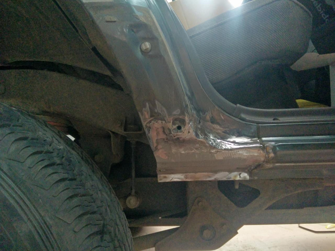

And finally a rust-job:
Both sides are done. Not by myself so i spend some €€€€ here. But now i have a rust-free 4runner!! :thumb3:

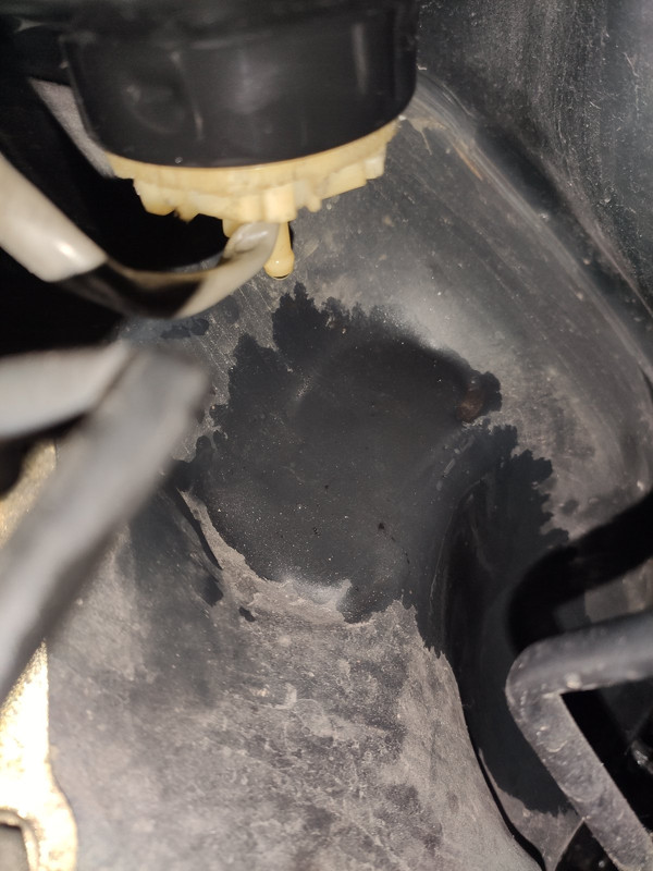

I need some advice. We replaced the fuel filter yesterday and pumped fuel back in with the built-in hand-pump on top of the filter. Here's a list of what happend next:
  • The engine started normal.
  • Lost power after 2min drive and stalled. (No warning lights on de the dash)
  • Difficult start with lots of white smoke.
  • Run well for next 2min
  • Lost power again.
  • Shut down engine my self.
  • Checked the fuel filter and it was dripping diesel.
  • I tightend the water nipple and the dripping stopped.
It runs fine now but sometimes the idle speed drops well below the normal 700 - 800rpm's.
I'm afraid there is some air trapped in the fuel lines or something. Another cause can be dirt in the fuel tank. It also happend when the tank was fairly empty btw.
So, how do i troubleshoot this? Any help is welcome.
Update.
I noticed there is a little breather hole at the top there where the fuel cap is. So i opened the fuel cap and started the engine a few times. It got better and better every start. So i guess there was some air trapped after all.

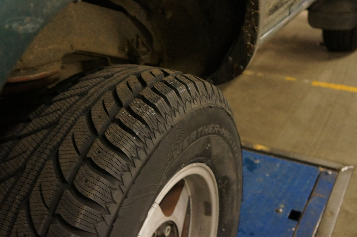

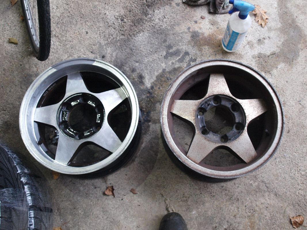

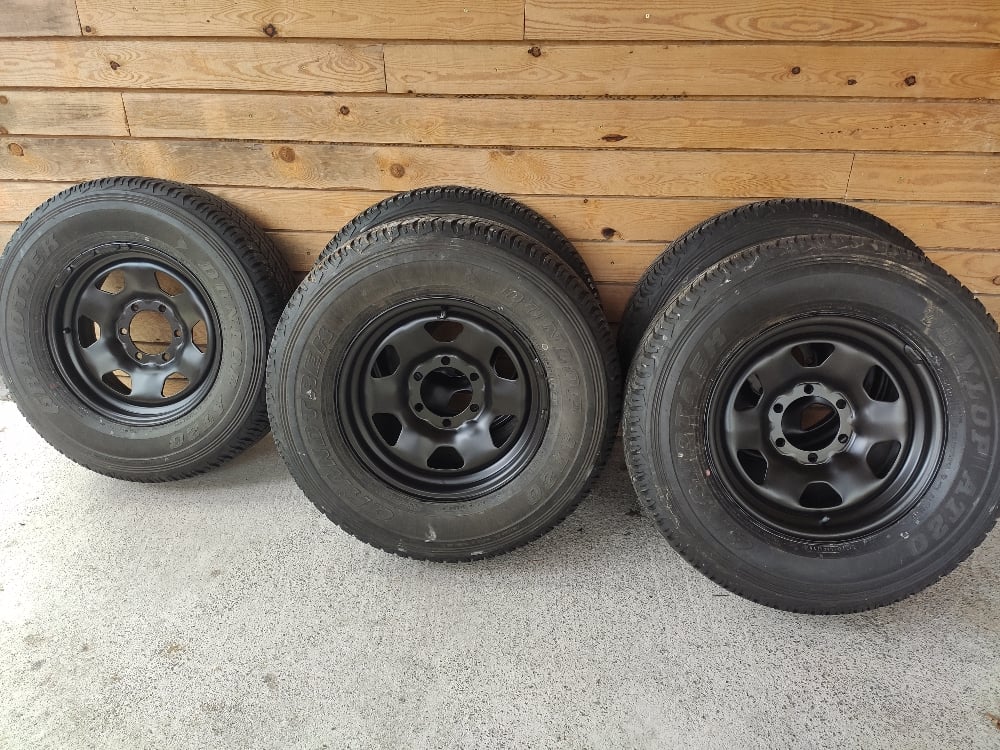

We're off to Italy again between christmas and new-year. Winter tires are mandatory there so i bought new tires and cleaned up the 15" rims that originaly came with our 4runner. We're crossing the alpes via Switserland and i know we will get checked at the border. (every year the same story) So i picked the largest legal-size tires i could get.
I never drove a 4runner in the snow before :)

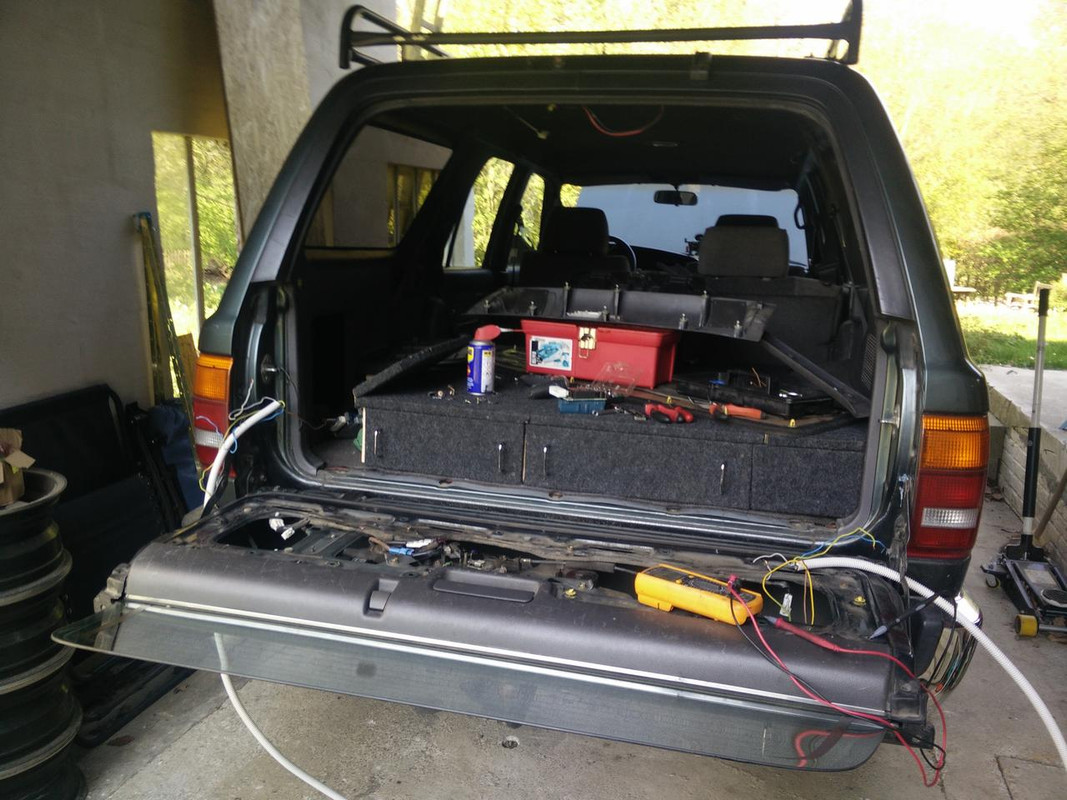

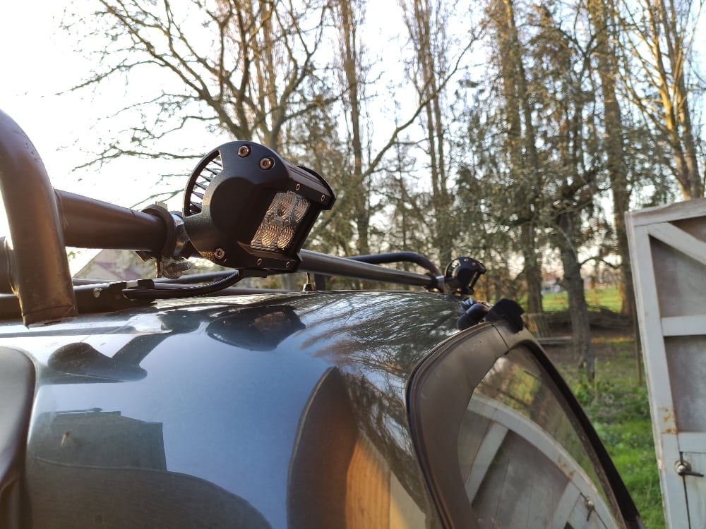

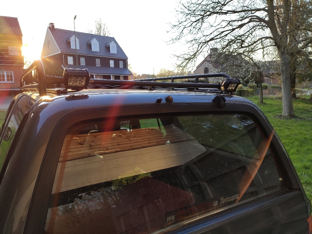

Installed some rear back-up/work lights today.
They come on when i shift in reverse or i can switch them on anytime i want.
But how do i route the wires through the roof?

Ah, rims are painted as well... I'm waiting for my rear bumper to be installed before i put them on.
