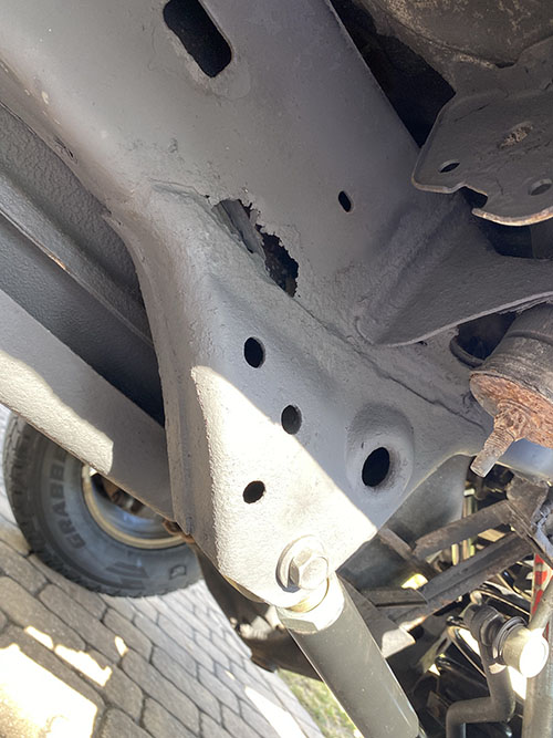

The first is driver side, no pitting on the inside side of the lower control arm mount, but there is considerable scaling that I have painted over.

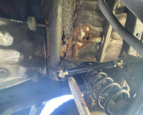

The second is passenger side, no pitting on the outside, only inside.

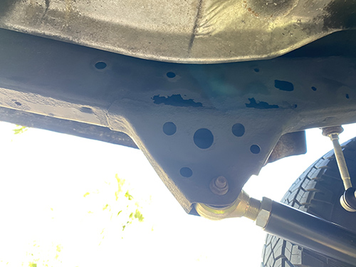

Third is the issue with the floor in the rear which I have layed fiberglass over top of from the inside. I regret not using chicken wire to help create the form, but this is not a final solution, just a patch for now.

Rust is a case by case situation. You'll have more luck taking it to an actual fabrication shop but they'll be expensive. I would clean the area up get all the scale off and poke around with a flathead screwdriver to see what's solid and what isnt then find someone locally that can weld (actually weld not half ass) and pay them to do the work.

Where the control arms mount on the frame is easily fixable. I paid a professional fab guy 500 bucks to fix my frame in that area and install my new muffler at the time which involved all new exhaust pipe and hangers. For me it was worth it. The other rust I'd take measurements of the area you're going to cut out, go to a junkyard and find a truck with that peice in good condition and cut it out with the same or slightly larger measurements and weld it in.
Right on brother- thank you. I need to sack up and start driving around to junkyards. I knew the floor repair was going to entail exactly what you said, cutting out a good floor from another truck...
Need to get some quotes on the control arm area ASAP. I also need some muffler work. If fact, the area of the floor that rusted out, I believe, was because the exhaust was never routed over the axle and out the side (behind the passenger rear tire like OEM) so the exhaust would just dump into that area and heat up the floor. In combination with salty roads up in western NY, where the truck spent a majority of it's life,and the constant freeze/thaw I am wagering that's what the culprit was. i I would like to sell this truck, but I afraid I am going to get haggled down pretty hard about those rust areas. Also my u-joint on the driveshaft is shot so that is also on the list before this project is at a comfortable rest area.

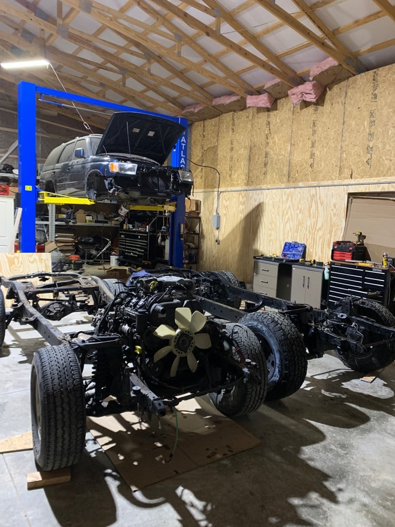

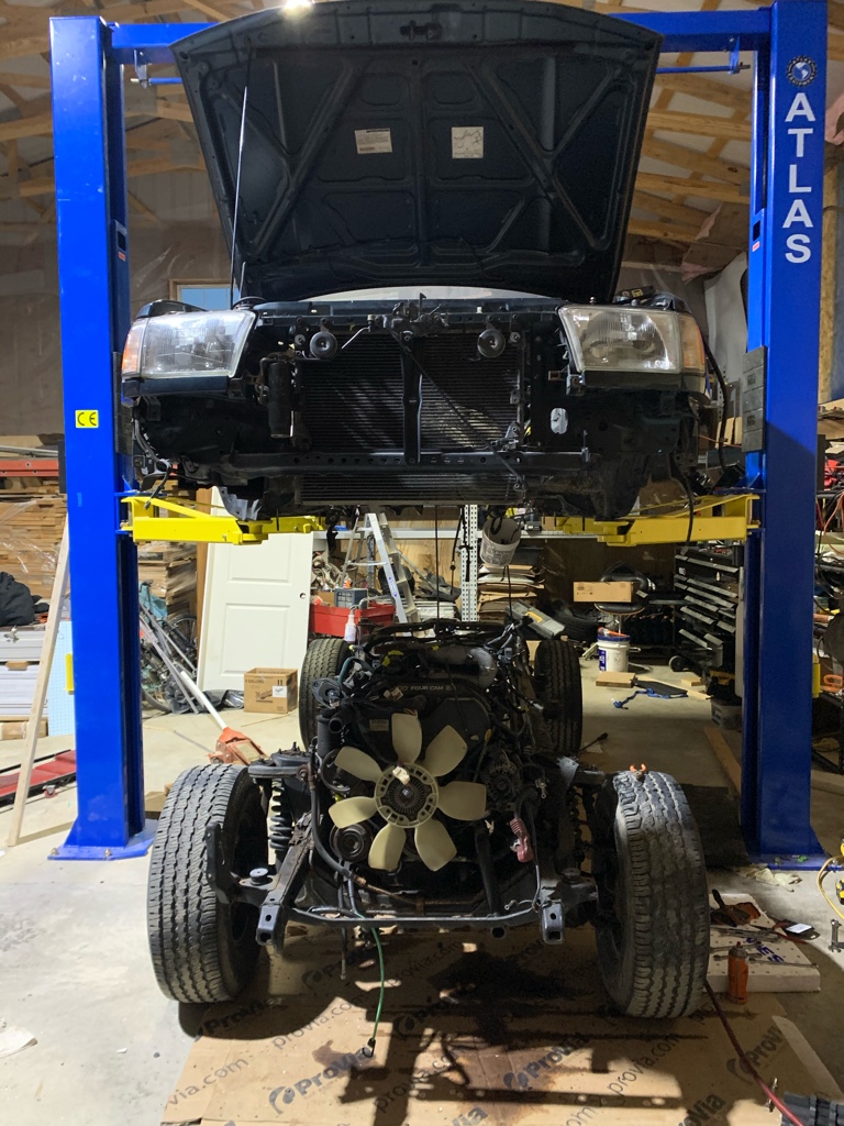

Got all the parts swapped over to the clean frame and hoping to have the body on frame tomorrow
