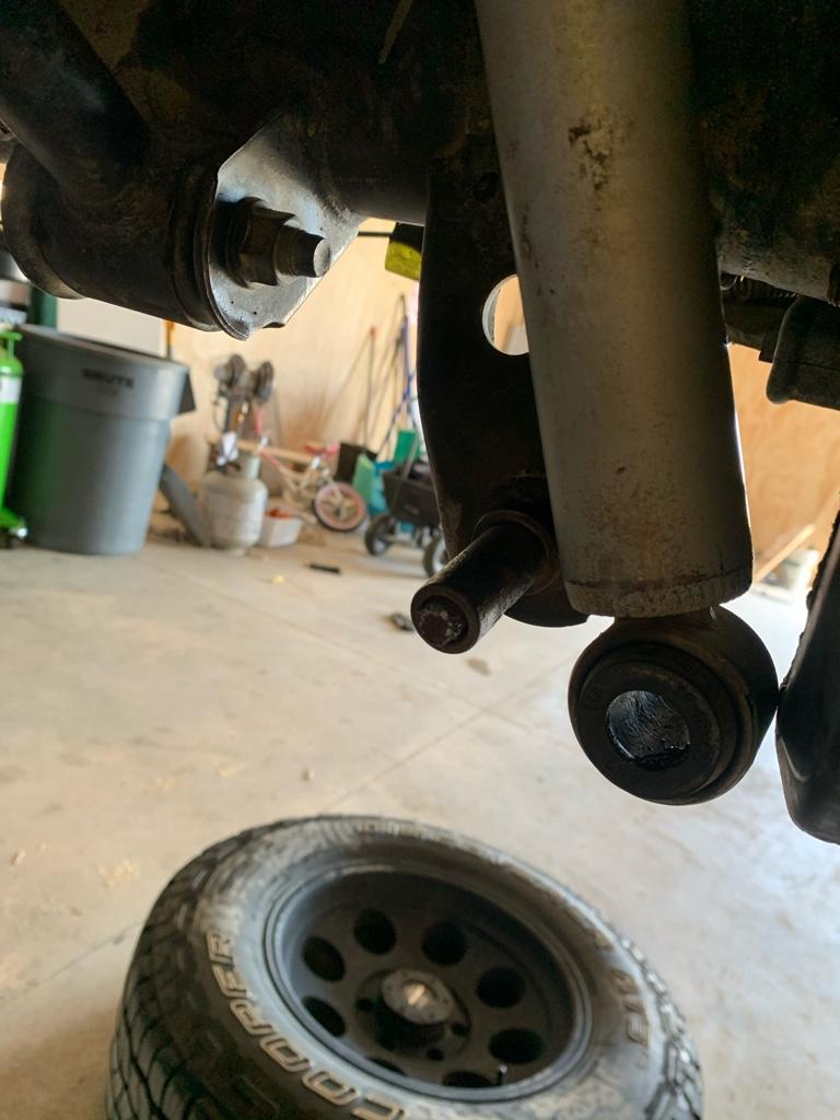

More adventures. Halfway through on of the trails I realized that one of my rear shocks came loose at the axle. Took off a bolt from the rear bumper for a temporary fix.

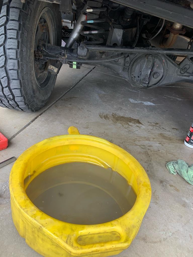

Do the diff breather extension boys and girls. I got lucky. Decided to check my rear diff oil out of the blue and found it to be grey. Definitely diluted with water. Only drove about 50 miles with it like that(rough estimate) so hopefully no serious damage was done[emoji1696][emoji51]

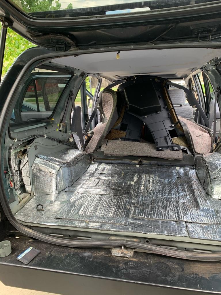

Finally got to extending the diff breather to the fuel cap. Also started killing off the sound[emoji379]. Only did the hatch area at this time. With time I want to do the whole truck including the doors.
