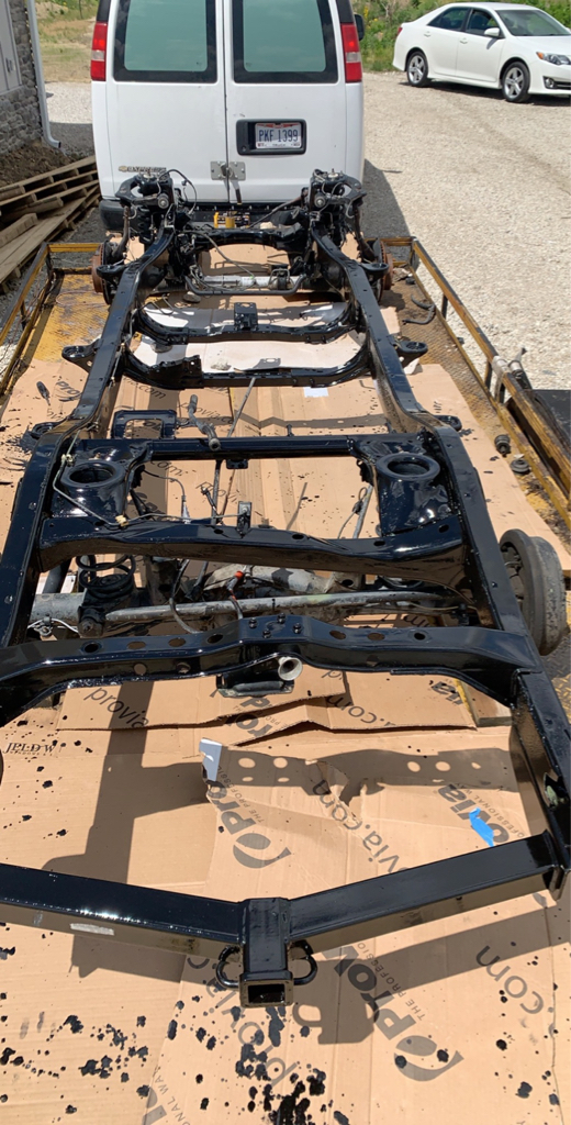

1998 sr5 frame swap + possible maintenance/build thread
Got all the parts swapped over to the clean frame and hoping to have the body on frame tomorrow

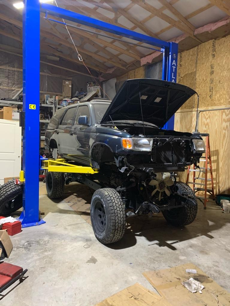

I didn’t see your reply earlier so I just went ahead and dropped the body on the frame. I actually did all of why you said except for cleaning the steering splines! Should have checked. My doner frame came with a gas tank that was in excellent shape so that worked out great. My father actually stopped by to help with watching out for things when I was lowering the frame and he told me all about that steering wheel needing to be in certain place. Did you end up using the front sway bar links for the rear and 2nd gen for the front after the lift?
Setting the body on the new frame was actually a lot easier than I thought. I thought that lining up the frame with the body mount bolts would be really tough. Honestly the only thing that sort of took a little time was making sure all the tubes and hoses were going in the correct places
I ended up installing my lift with the body off since it was all just there and easy access. I’m really liking the way it turned out so far.
Now all I really have to do is fill all the fluids back up and connect all the hoses and tubes in the correct places. Shouldn’t be too hard. Any recommendations for the sway bar links? I’m thinking the fronts would be too short still for the rear. I gained a lot more lift than I thought I would.

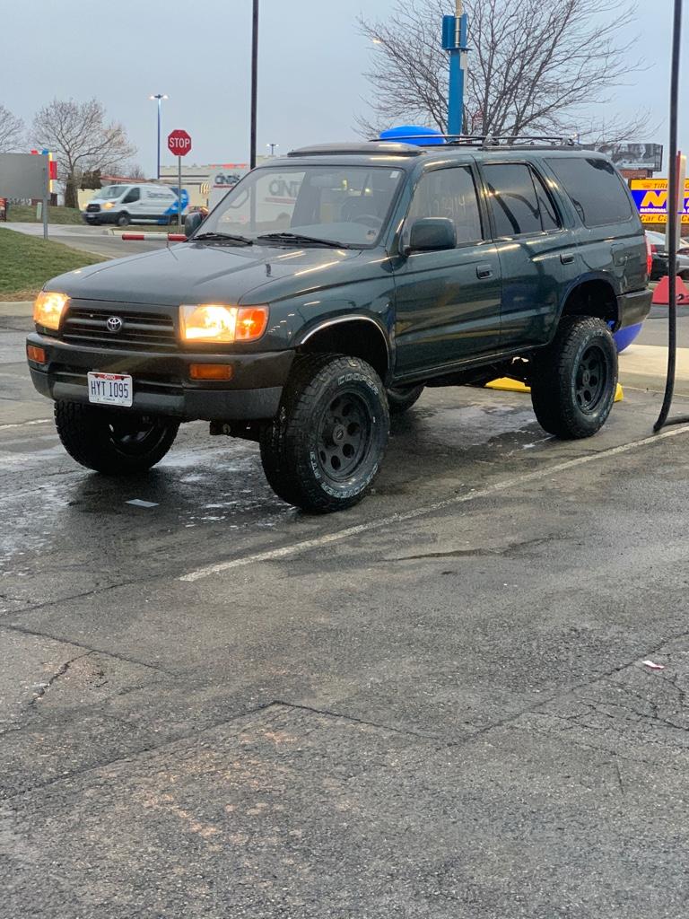

I’ve been driving my truck for almost a week and I’m really starting to like it. Got a few more maintenance things I want to do to it before I do any mods. After I get the maintenance out of the way, first thing I’m going to do it the center console mod. Those little cup holders make me laugh. The only positive thing I see in them is being by the vents. Keeps my coffee hot:)
Maintenance
-Seafoam
-Wheel bearings
-Change my wore out steering wheel
-Rear brake line(stresses me out with how tight it is after lifting)
-Aftermarket UCA
-I’m sure more will come up
Future mods
-center console
-aftermarket radio(don’t have any cassettes or cds haha)
-lower profile steel bumpers
-hood struts!

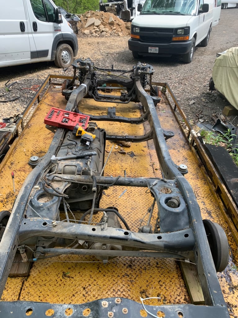

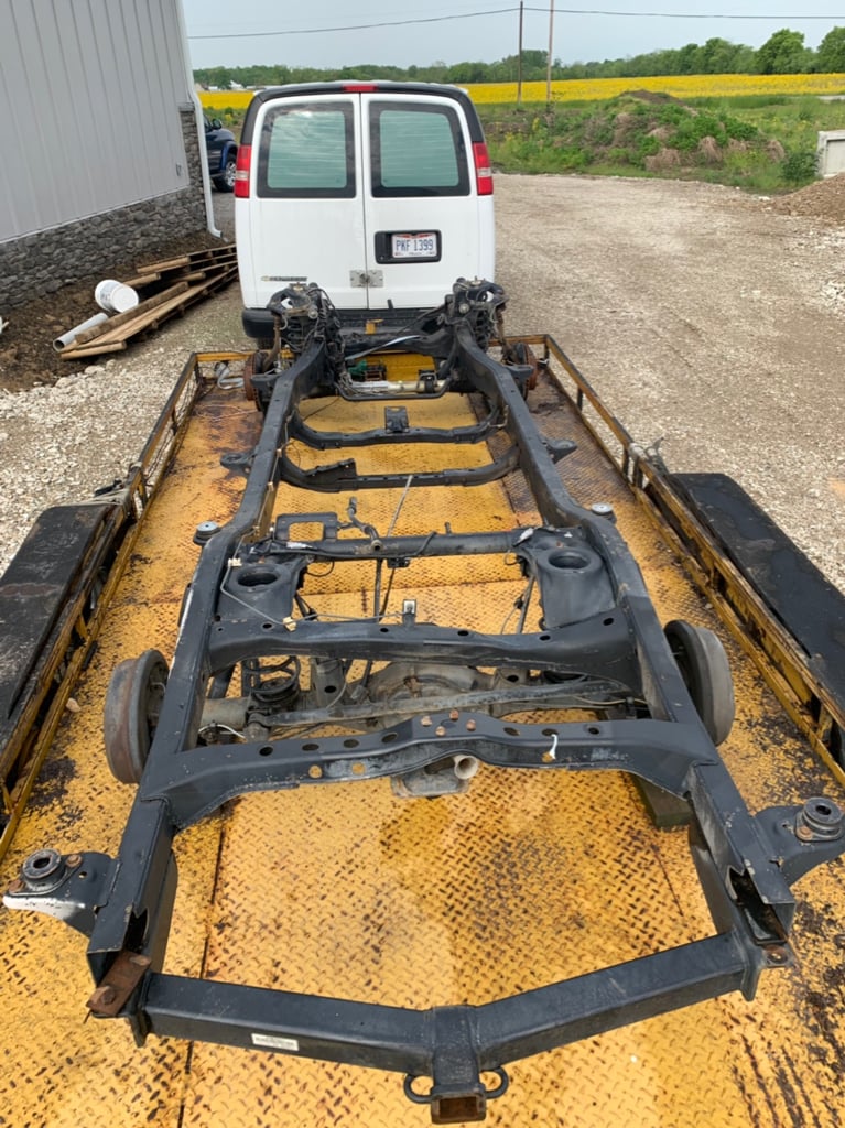

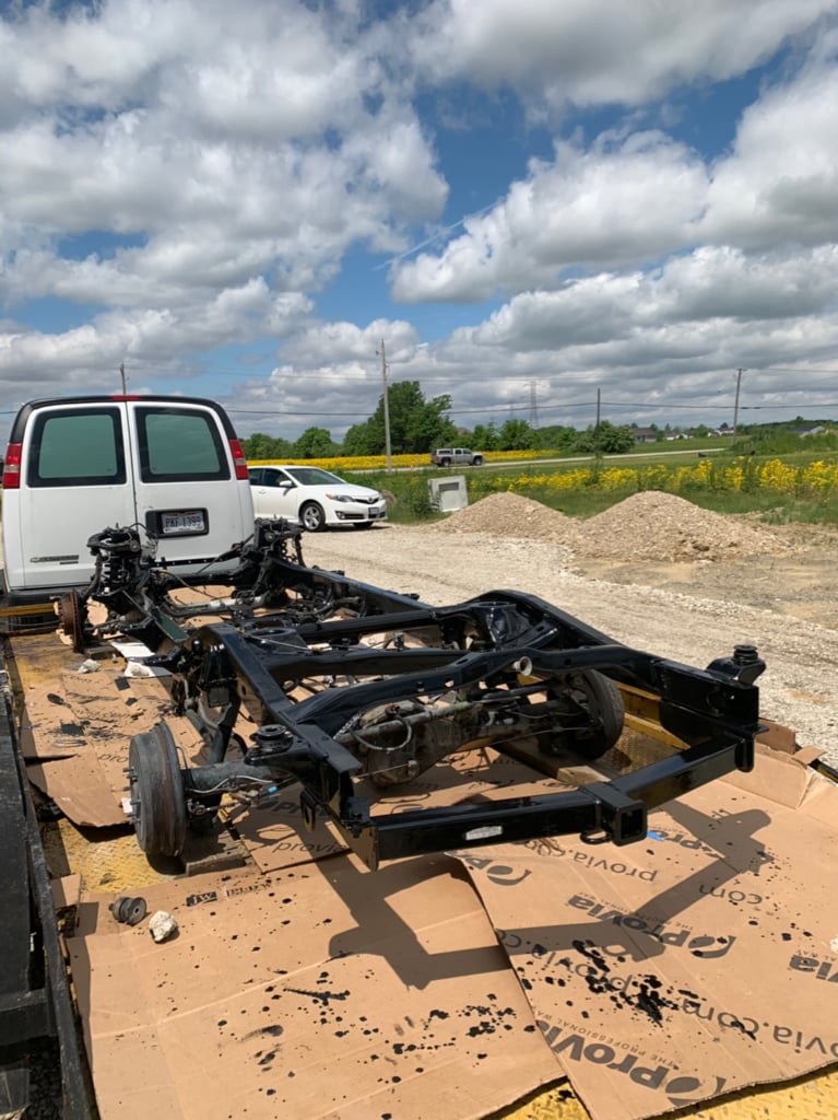

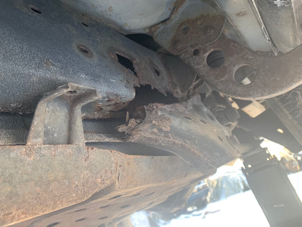

So I’ve been lurking on this forum for quite some time but joined early in 2019. I purchased this 1998 Toyota 4Runner sr5 with 123k miles from copart sight unseen. Damage description was “minor dents and scratches”. I figured it was something to do with rust considering that it was in Delaware. Either way went ahead and pulled the trigger on this and got a great deal IMO. Very well maintained by one owner according to CarFax report.
Sure enough the driver side rear lower control arm was rusted off.
Other than that the rest of the frame was in decent shape, considering the truck was in Delaware it’s whole life. I wanted to patch the rust but after some thinking I decided that a frame swap would be a better option for me. I started looking for a clean frame and found one for a great deal in TN with no rust at all.
After some reading on this forum I decided to go the Eastwood rust prevention on the inside of the frame and POR-15 on the exterior.
