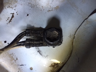

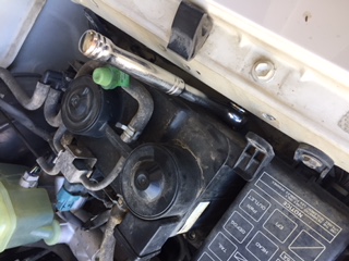

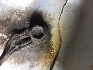

I believe I solved it. Earlier, I tore apart the rear side panels near the tail lights and checked the ground wires. All looked good. I then opened up the engine bay and looked at every ground wire connection. I found a connection that looked pretty suspect. I believe the ground wire came to the front drivers side turn signal.
I had to remove 2 bolts and a nut to move the exap box out of the way. I removed the bolt connecting the ground wire to the body, cleaned everything, and put it back together.
I also pulled up the rear drivers side seat and checked the fuel pump connector. I unplugged it, cleaned it (even though it was already very clean) and plugged it back in and made sure it was snug on there.
I then re-calibrated the fuel gauge and took it for a drive. I drove 3 miles (about 8 minutes) and it read accurately the entire time, never plunging to E. I don't know if the issue was solved or not, time will tell, but this is by far the furthest I've been able to drive without it giving any issues. Before, it seemed I could only drive 100 feet before it would plunge to E.
But, time will tell, I'll report back in a couple days. If I were you I would first check all the ground connections especially with the rear lights since that is where you were having your issues. Hope you get yours figured out.
