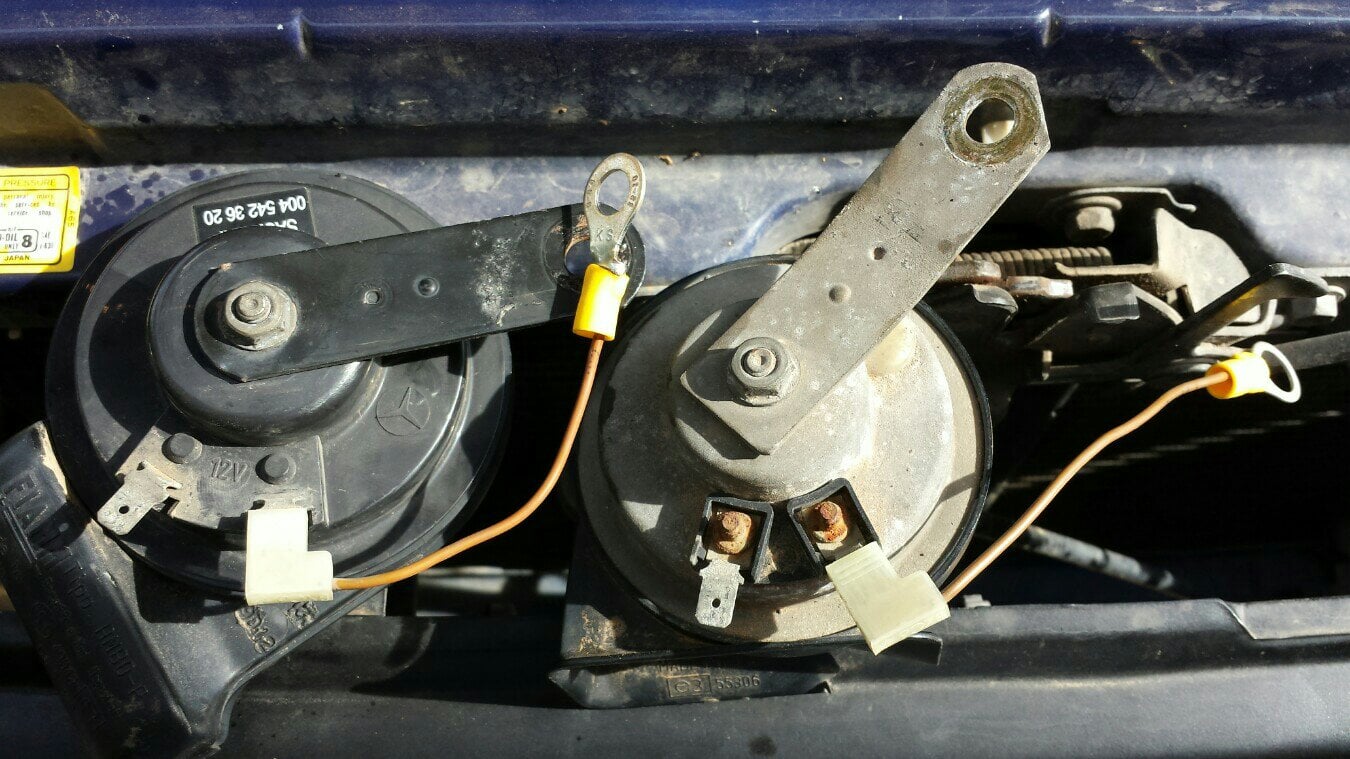

Stopped at the local pull a part today. I was surprised when I rounded a corner and came face to face with the new residents.

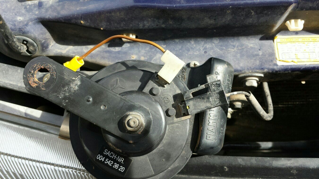

Picked up some decent rear hatch struts, horns off a Mercedes e-class, and some Jimmy bump stops.
I brought a small 12 volt battery and some test leads so I could listen to the horn tones. These were the loudest, most authoritative sounding horns I tested.
The Mercedes horns went on easily. They use a 2 wire connection, so I put a ring terminal on the neutral wire, and ran the mounting bolt thru it. Had to put a slight bend in the mounting brackets to clear the grill on one side, ac lines on the other. Positive wire lead from the factory Toyota harness was directly compatible, just plugged it right in.

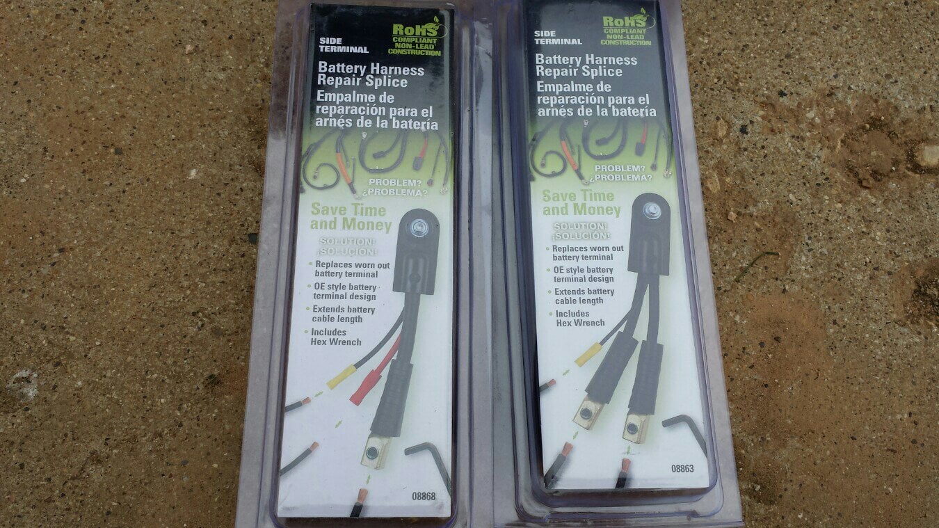

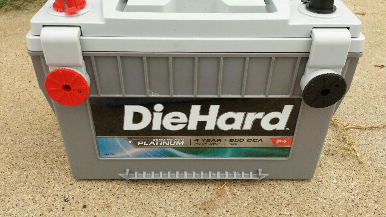

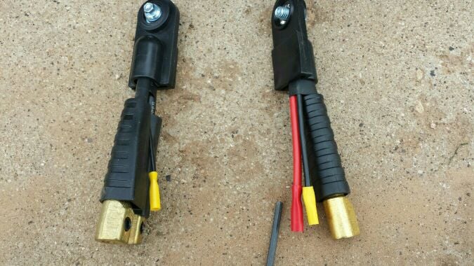

My 2 year old Die-hard platinum battery got drained to nothing somehow during our recent 16 day trip to Colorado. Left it on the trickle charger all night, but it never made it past 7.8 volts. 4 year full replacement warranty was hassle free. Took it to Sears and swapped it out. They let me get a different battery this time. I wanted one with side posts and top posts, to make the near future winch install easier.
I found these super handy side post conversion kits at AutoZone for $15 each. Gave me the extension I needed to make the positive cable reach.

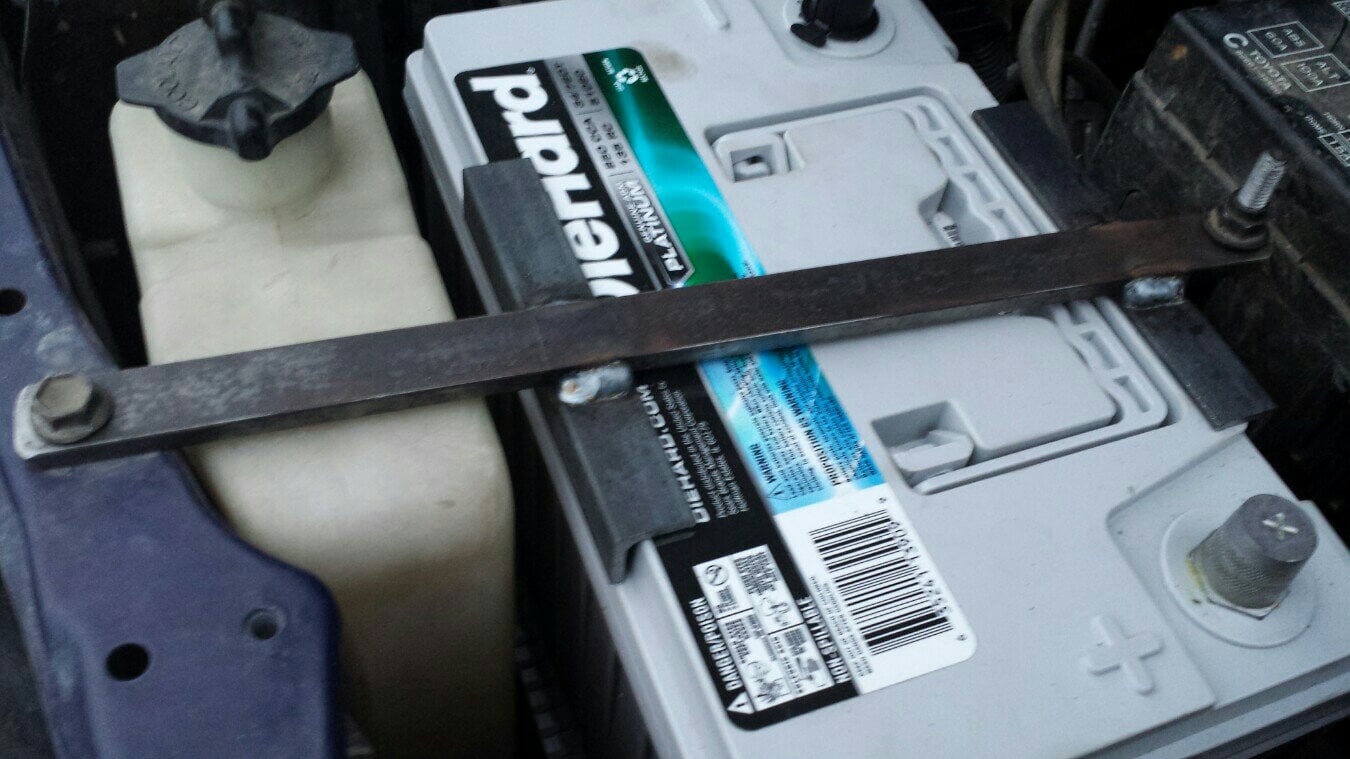

I had to weld up a new battery tie down bracket, as this battery is a good bit shorter than stock. Used some 3/4" angle iron, and 3/4" x 1/4" bar stock I had lying around.

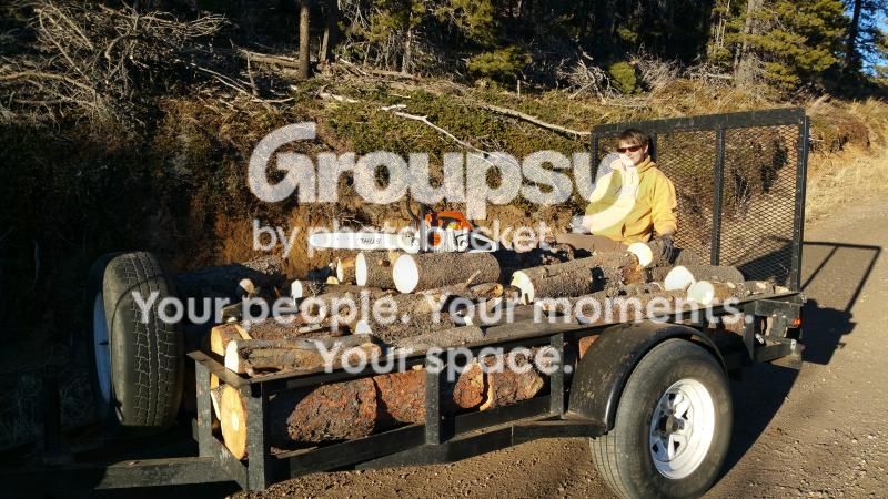

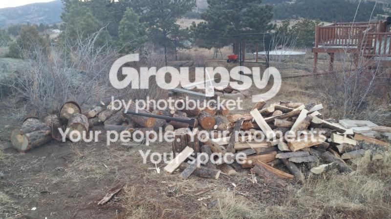

With the 4runner ready to go again, it was time to put her, and the 4runner, to work. Met a super cool neighbor with lots of dead trees that need to be cleared. Wouldn't you know it, I need firewood, and I have an itchy chain saw finger. Hard to beat free! The first of what should be several loads to feed the winter fire.
I just did this yesterday - thanks for the pics - i was totally messing up the connectors and your pics helped a ton. I went from 1 horn (the other was disconnected) sounding VERY anemic and wimpy to two horns that sounds like a freaking MACK truck. I highly recommend this swap with some Mercedes Benz horns from a pull a part. Cost me less than $10.
