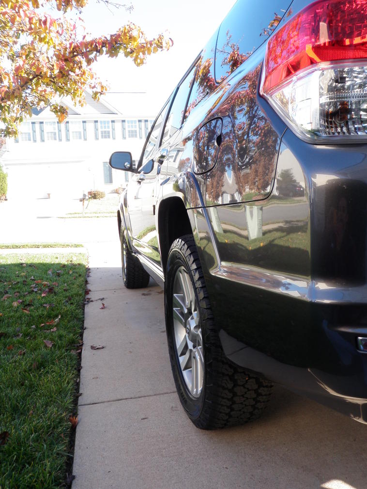

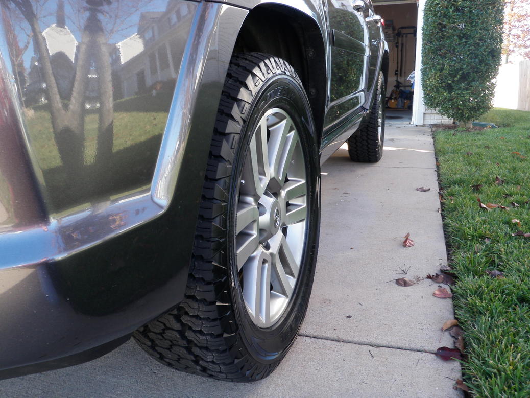

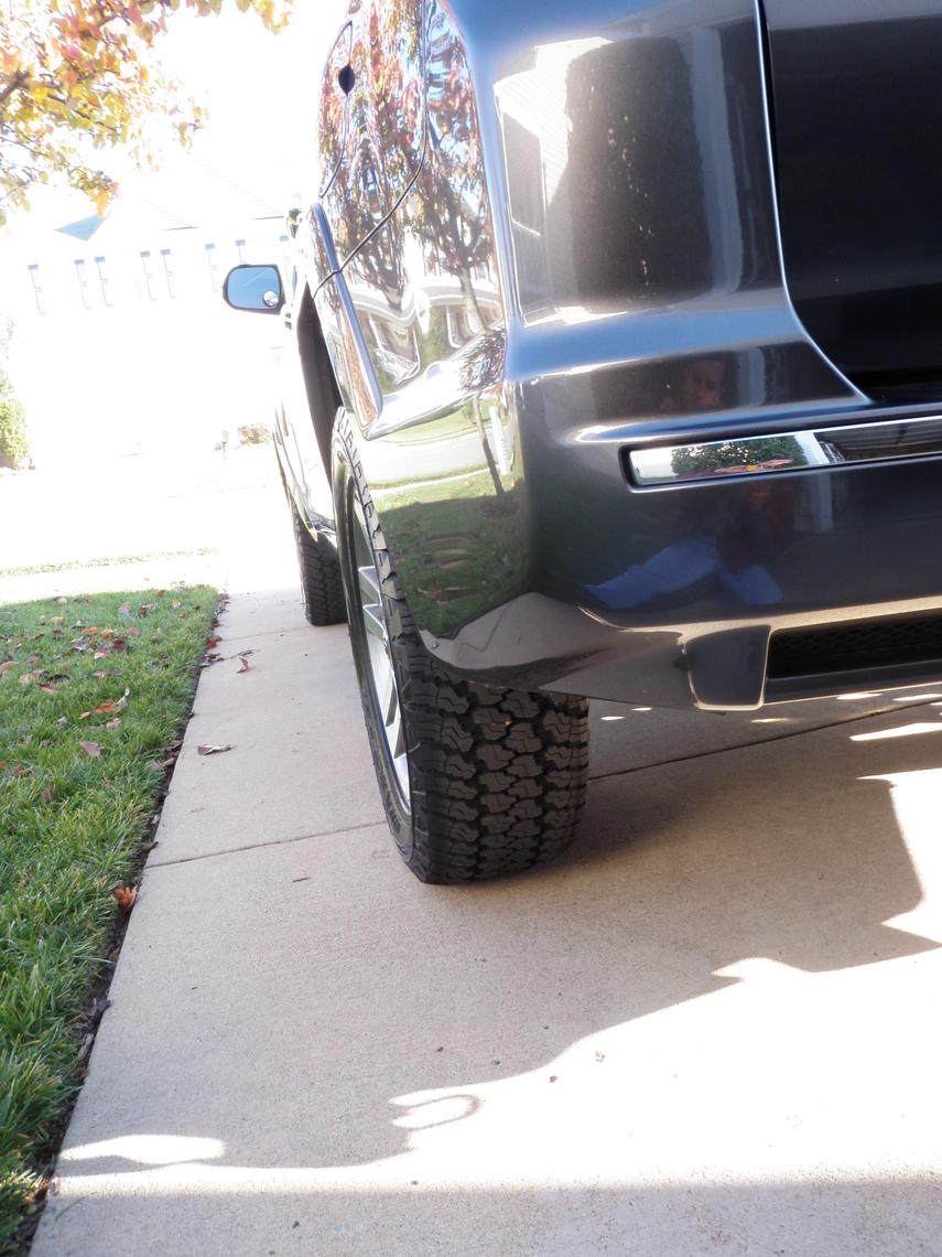

I looked at wheel and tire combinations for months, but the stock 20" are what sold me on the vehicle. I have about 4,000 miles on them now, rotated at my 5k oil change. I replaced the OEM Yokohama at about 2,600. On road, I think the NTG ride better than stock and they don't track the grooves in the road like the stock tires. I tend to drive fast and corner hard coming from a 20thAE GTI. The stock tires came with 40PSI so I run the same in the NTG's. They are good on the highway and I feel comfortable driving 70-80MPH. They are now starting to make a bit of a hum on the highway (only with the radio off), but not too bad for an AT tire. Around town they are quite. Off-road has been minimal, just dirt roads and mud - there is not much open to off-roading in eastern MA. Had them on sand, over-sand roads and they did great; never aired down - I didn't really hit areas that were not compacted by other vehicles. I have not seen any evidence of rubbing either.

those do look good. any impact on mpg and as bay33 asks the narrowness of the OE rim?

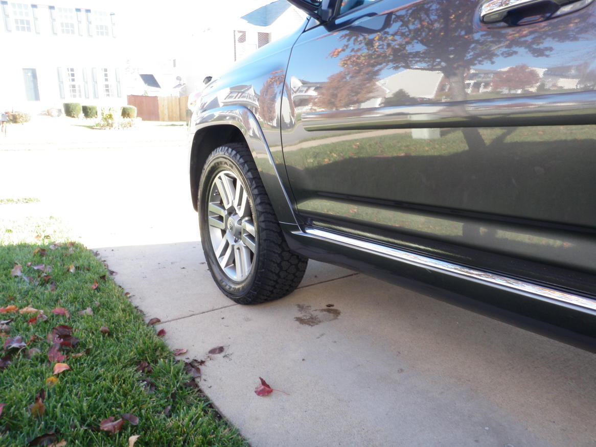

Here's a pic of my 4Runner with the Nittos.

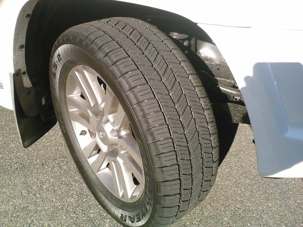

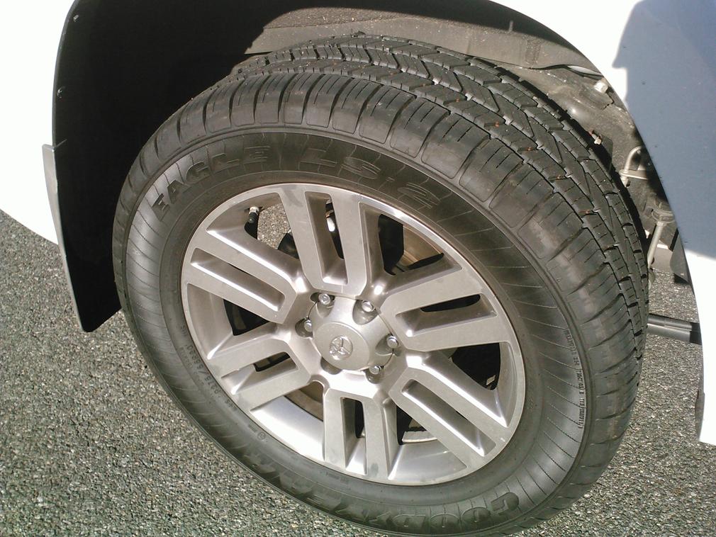

Now, just for clarity, I too have have replaced the O.E., Geolander G96B, 245/60/R20's to utilize the much meatier, GdYr Eagle, LS-2 275/55/R20 (All terrain); No lift, No rubbing, No problem!
There seems to be a bit of confusion wrt Toyota's rim size designations; not the most logical or user friendly system. So, just for clarification.
The "7J" rims for instance. The 7, does not represent the width of the rim, but the series {as in 7 through 7.5}. For example: A 7J X 17, as on the SR5 or the T.E. works out to be a rim that's 7" in width X 17" in diameter.
But on the "limited", a 7J X 20, measures out to be 7.5 inches in width, and a 20" diameter. A 7.5" X 17" rim for a SR5, or T.E. will have 7-1/2 J stamped on the inside of the rim casting.
So, a 7J on an O.E., L.E. will be "7.5 inches wide and 20 " in diameter (Not 7"); just for clarification.

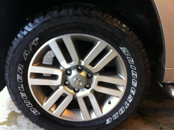

To the person asking for pics. I just had these put on yesterday replacing 275/55 Bridgestone Dueller Revos that lasted about 45k miles. (having some issues with my computer, if this doesn't work I'll try again later)

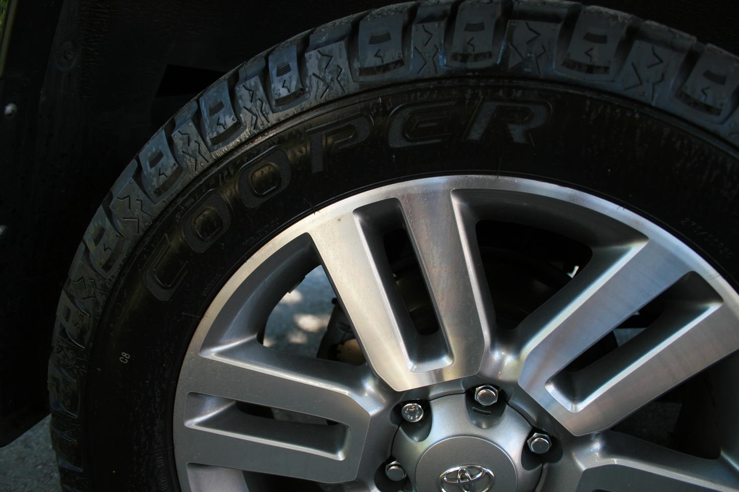

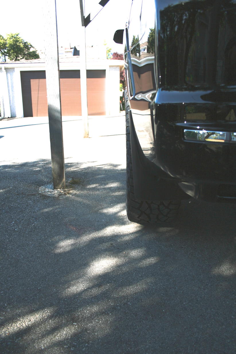

I didn't like the "lightning bolts on the side of the nittos so I went with cooper zeon LTZ. 275/55-20. They fit great, look awesome (except for the nasty tire shine the shop put on) and performed well in the winter.
They stick out a bit more because I do have spacers on.
