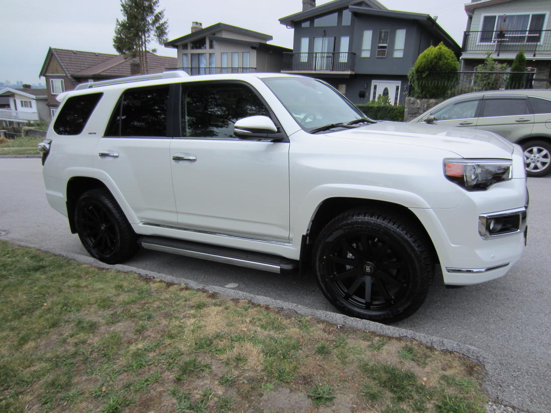

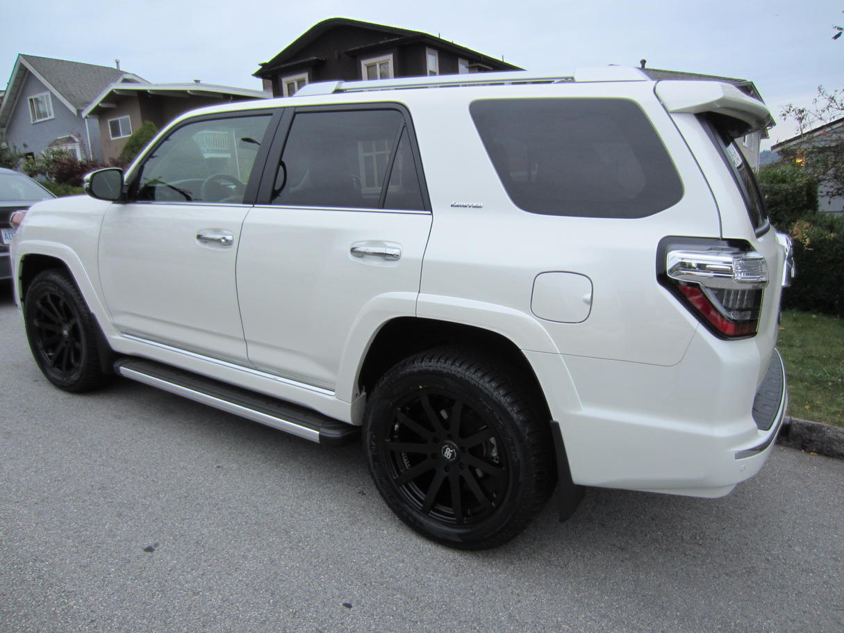

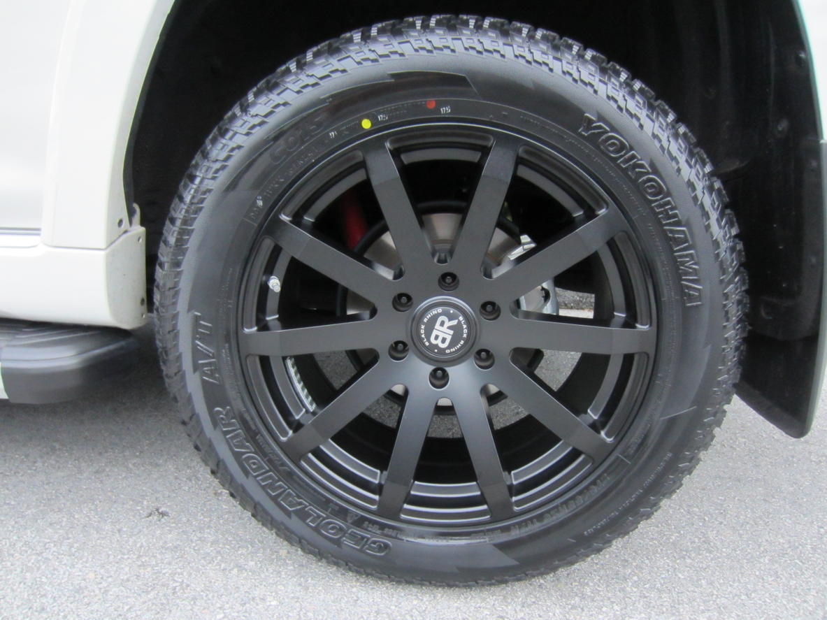

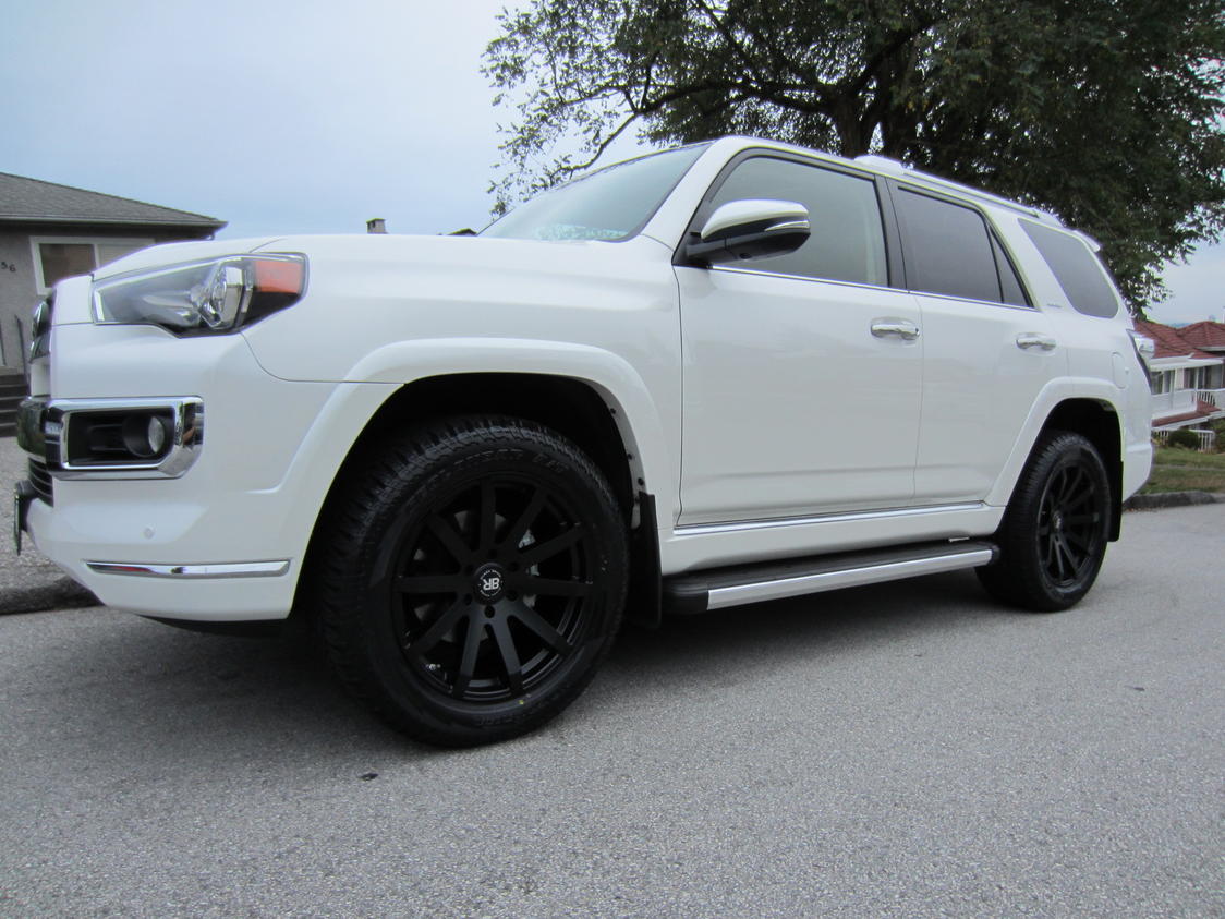

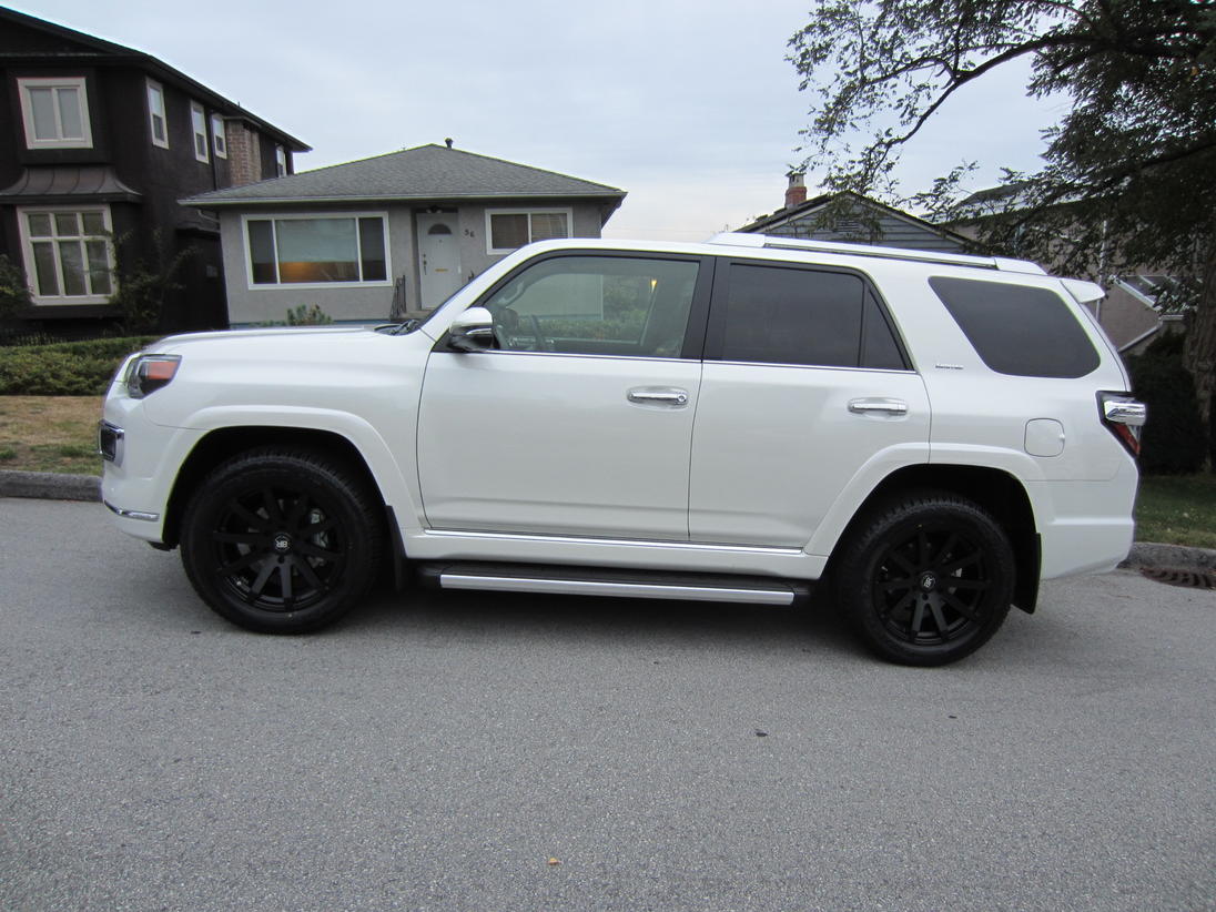

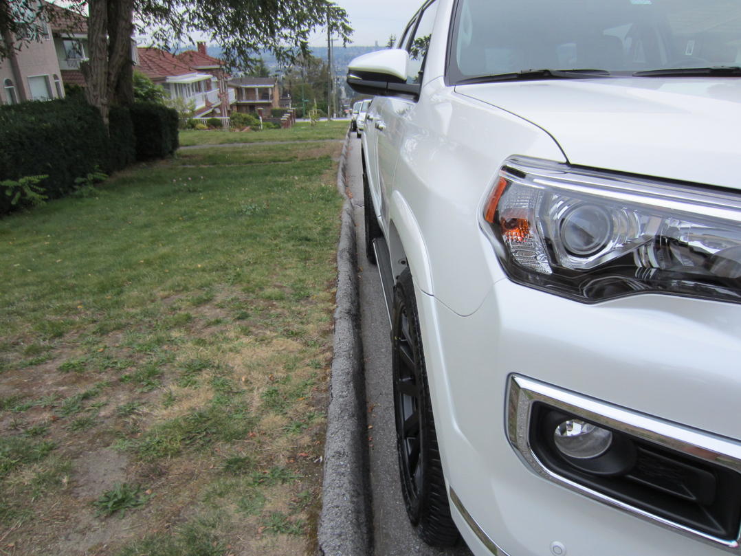

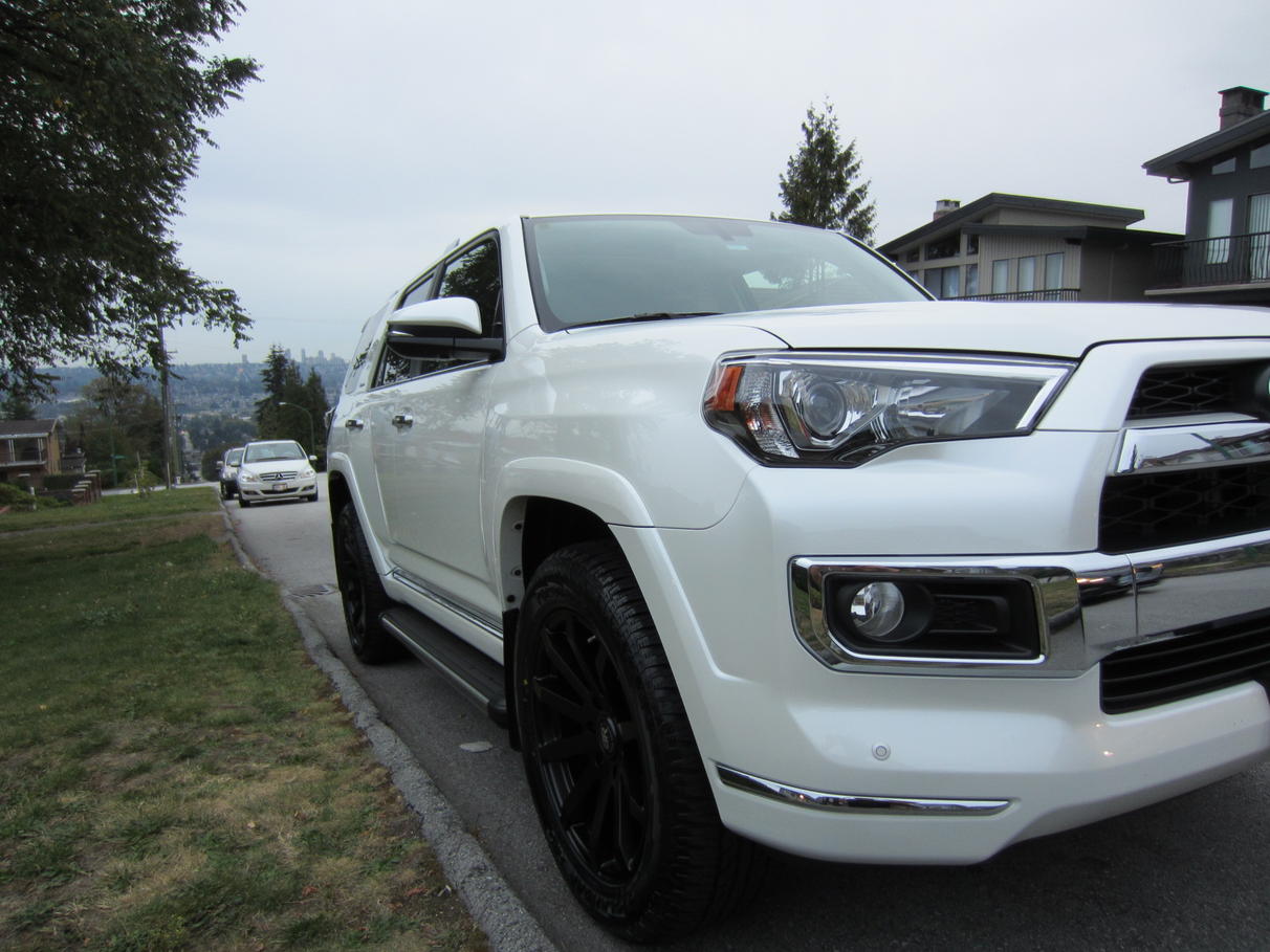

Finally got my wheels after 9 months of looking on this forum. Thought I would share as this forum has been a great resource for tires and wheels.
These are the Black Rhino Traverse 20" x 9" with a 15 offset. The tires are the new Yokohama Geolandar A/T G015 size 275/55R20. Not that aggressive looking as I do a lot of street driving, but All-Terrain and All-Weather nevertheless. They almost sit flush to the fender. A much better aggressive stance than the stock 20" x 7".
I'm very happy with the setup, and a huge improvement with the drive and handling. They slightest rub when the wheel is cranked on a slight slope, and I haven't seen a difference in fuel economy though I would expect it as they are a wider tire with likely more grip/friction.
Think I got it all covered. Thanks to all who contribute. Here are some photos. (It was a very dark day, and I'm lazy to re-take them).

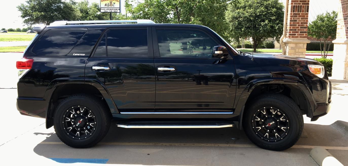

Looks great! My imagination or do you have a level kit or front spacer lift of some sort? My '16 LE doesn't sit that level. 20 x 9, -12 offset.
Crummy pics I know..

Love the offset on the sidewinders, wheels look great. I don't have a levelling kit. I live on a hill so maybe the slope makes it look level but mine looks thr same as yours.
Got it. Just saw your note on fuel economy, I lost about 1 MPG with my setup. But I went to the Cooper ATP which is an all-terrain tire. Likely the culprit. Went from 20-20.5 to now getting 19.0 - 19.5 MPG now on highway trips, somewhat hilly where I live though..

Ditch the step up bar and would like 10x better. Nice wheels.

That's looking nice.....:thumb3::thumb::bravo::dancin:

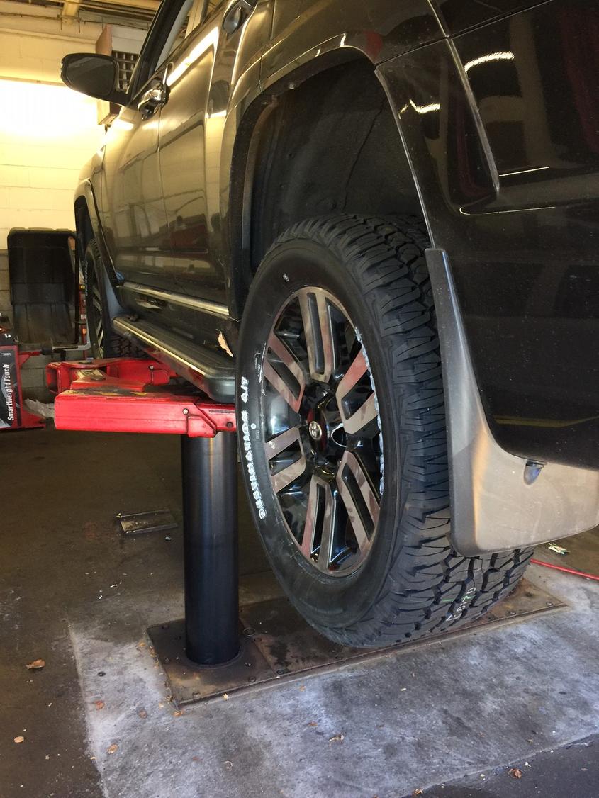

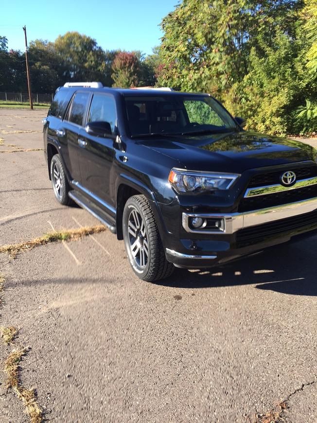

First time post here, long time member of Tacoma World. Wanted to thank everyone for the vital information here regarding this topic. We had our 2014 4 runner since new, and its primarily my wife's vehicle. We essentially live in the northeast where we see some brutal winters, making it worse is on top of a mountain. I essentially bought this vehicle for one reason, and to get us safely up and down the mountain in the winter. I've had 4 Tacoma's and know the capabilities of these machines, but essentially my wife said her Rav 4 was better in the snow than this 4 runner. I attributed this to the stock Geolanders which are essentially a summer tire. After going to a few tire places was confronted with the same issue everyone else was, there's nothing aggressive in the stock size. After taking into consideration the safety issues of the 275 on a 7 inch rim we were left with these decisions. 1, trade in for a SR5. 2, buy new wheels, added cost of $900, on top of the price of tires. 3, roll the dice on the 275 on narrow rim. We felt the right decision for us was to install the 275s on the narrow rim. We went with the Destination AT's ( 275-55-20) She only goes three miles to work every day and I feel the risk of tire separation at her low speeds would be a rare occurrence, but she does needs to get there in the winter/snow. We certainly understand the risk and thank this site for pointing it out, but the risk of leaving those stock tires on for yet another winter was more of a safety issue for us.

I would probably do this, but it is my understanding that wider wheels will not fit correctly without rubbing?
I've had a very slight rub under extremely hard brake, cutting wheel full lock right, not left though. It was a little plastic flange on mud flap that stuck out, no issue resolved quick.
Yeah, I meant if I went with your option #2 and bought different wheels/tires.
