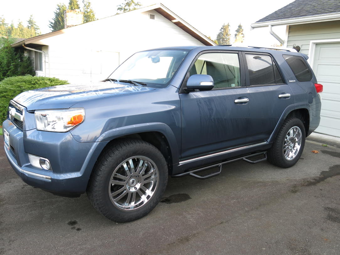

Update:
Currently three years after installation of the 20x9 Black Rhino wheels and 275/55 Toyo Open Country tires, I'm still happy with this change. I sold my stock wheels for $550, as I do not see a reason to go back. There's been no concerns with fit at all, using the stock suspension on the Limited.
With the traffic that I encounter in the Northwest, I've had to take evasive action a number of times in both dry and wet conditions. In all cases, I have been very impressed with the handling. So the change of tires and wheels has not adversely changed the handling, performance, or fit.
In tracking the fuel mileage, I thought that I may take a hit with the larger footprint. But around town and on backroads I'm getting 17.6+ mpg, and 22+ mpg on the highway.
I consulted a number of knowledgeable people in the tire and wheel industry before making this decision.
Whatever, you decide, enjoy your 4Runners. They are good choices for independent adventurers.

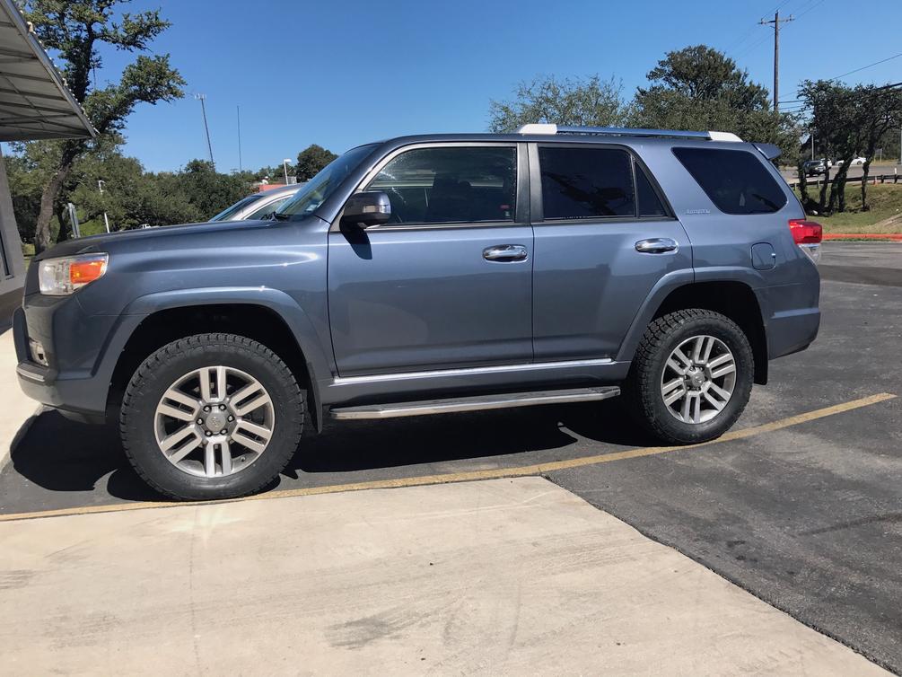

Thanks to all those who shared their internal LE wheel struggle. After reading and re-reading. I opted for 275/60r20 Terra Grapplers on the original wheels. To make sure they fit I installed a 2.5"/1.5" leveling kit from Daystar and pushed the fenders forward before having the tires mounted.
Also, the Discount Tire here in Austin flat refused to mount them.
First pic below. Headed out for opening weekend of deer season here in TX so action pics to follow.
