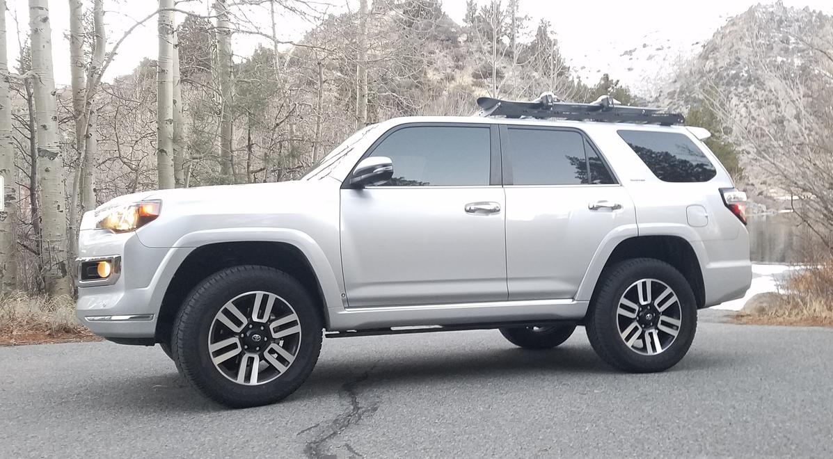

Thanks to all those who shared their internal LE wheel struggle. After reading and re-reading. I opted for 275/60r20 Terra Grapplers on the original wheels. To make sure they fit I installed a 2.5"/1.5" leveling kit from Daystar and pushed the fenders forward before having the tires mounted.
Looks great atx! I've got basically the same set up (1.25" Spidertrax spacers – ToyTec 3/1.5” leveling kit – Michelin LTX M/S2 275/60/20)
Glad to see more people adopting the 275/60/20 on stock LE wheels!
Another 275/60/20 install, currently waiting to install my 1.25 Spidertrax spacers
XREAS removed for Sonoran Steel 3 inch lift

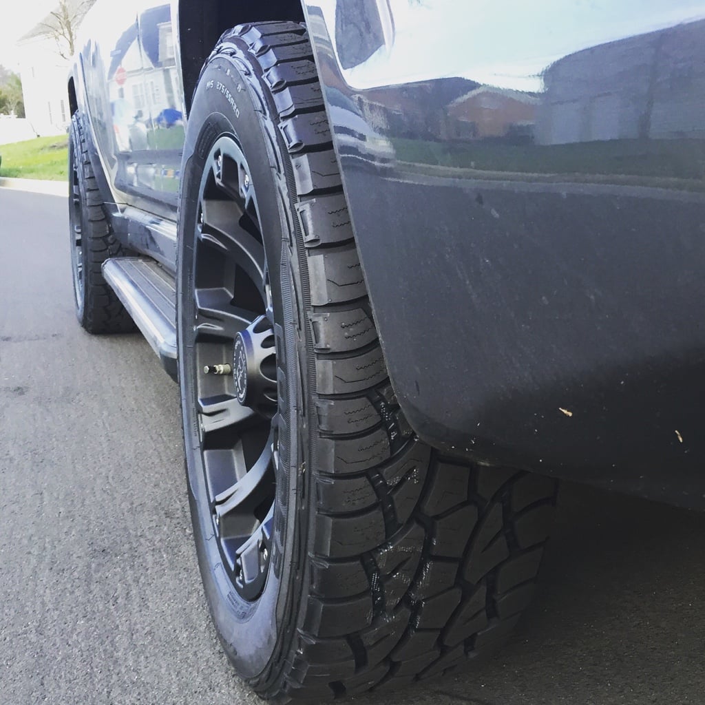

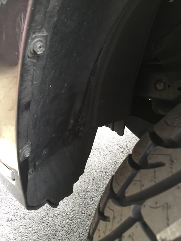

Here are my Cooper Discoverer 275/55/R20s on Black Rhino Sidewinder wheels. Rubbing on full lock. Removed front mud flaps from Limited. Had to use a heat gun and drill to open up the wheel well plastic to reduce rubbing. Love the look and worth the extra inconvenience.
Here are my Cooper Discoverer 255/75/R20s on Black Rhino Sidewinder wheels. Rubbing on full lock. Removed front mud flaps from Limited. Had to use a heat gun and drill to open up the wheel well plastic to reduce rubbing. Love the look and worth the extra inconvenience.
Looks good. Do you have a picture of the wheel well? I'd like to see how you did it. For the tires, is it 255/55/R20s?
^^this is one popular wheels and tires combo. =)
[MENTION=107460]Magnetic4R[/MENTION] big fan. Been following your build thread man for awhile. Whole reason I got the truck was your initial setup was inspiring (:thumbs up). Finally started doing the upgrades recently with the exact tire/wheel combo. 275/55/R20 Cooper Discoverers with Black Rhino Sidewinder wheels from Discount Tire Direct.
Sorry typo. 275/55/R20.
Used heat gun with a hammer to push in the plastic. Also used a Dremel device to score some of the plastic.
