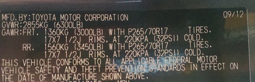

Wheel Size
It may also show on the door sticker. Here's mine showing 7 1/2 for my Trail.

I received this Toyota spec sheet with my 2013, I'll bet it's the same for other 5th Gens. Looks like the Trail and Limited have 7.5 wheels. It's on page 2.
Is that a misprint for the Limited? I no longer have my wheels but I think they were 7 NOT 7.5"

Rim Width
Check the door sticker, here is mine from a 2013 Trail and it appears to match the spec sheet.

The door sticker on my 2010 LE shows the rims as 20x7J.
Mine too and we need somebody to check their 2013 Limited door sticker to see if they did indeed go up to a 7 1/2J or the specs were just a misprint.
Somebody showing the undisputed truth with pics or a video is the only way this controversy is going to end obviously.
