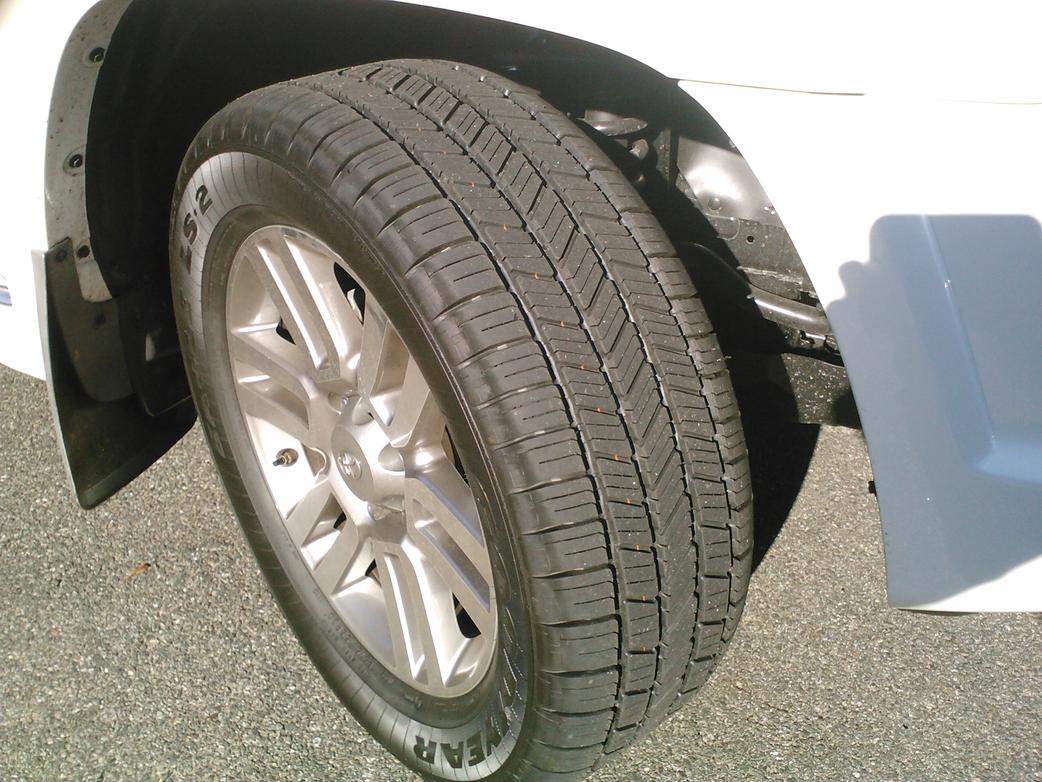

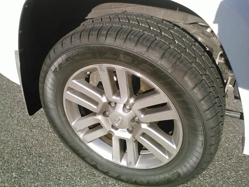

Does anyone have any pics of the 275/55s mounted?
Hi Ratt1,
I snapped these today with the ole' Android phone; hope they help. Installed them 2 weeks ago, couldn't be any more satisfied with their performance!!!
These are 275/55/R20, mounted on O.E. Limited rims-definitly no problems here!!
