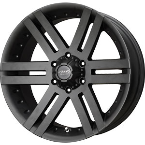

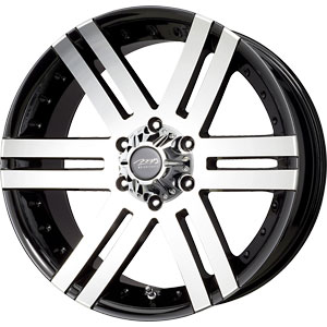

the closet I can find to the OEM are these MB Wheels Vortex (silver & black) from discount tire.

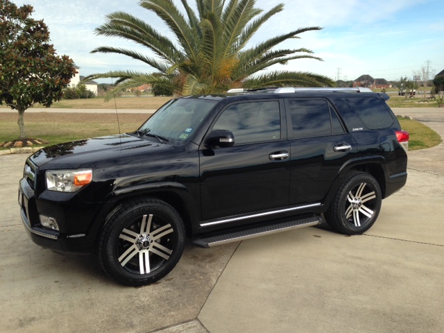

Vortex Rims on 2010 4Runner Ltd
I just picked up these Vortex Rims a couple of weeks ago to go with some 275 55/20 Goodyear Eagle LS2 Tires at Discount Tire. I originally had installed this size tire on the stock spare rim back in 2013 at Discount Tire, but the salesperson said he would not sell me 3 new tires to put on the other stock 20X7 rims, as they did not want the liability (he was even willing to buy back the unused tire mounted on the spare). Basically, he said there were no other choices other than the 245 60/20 tire that he would sell me to go on the stock rim. I really didn't want to change the look too much, but as others have stated on this thread, the 7" rims are simply too narrow. The salesperson ended up giving me a good deal on these rims; buy 2 get two free, so I went for it. I like the ride, but there is some minimal rubbing on the plastic fender well on the drivers side with full right steer. Overall, I'm pleased with the looks, and the performance so far.

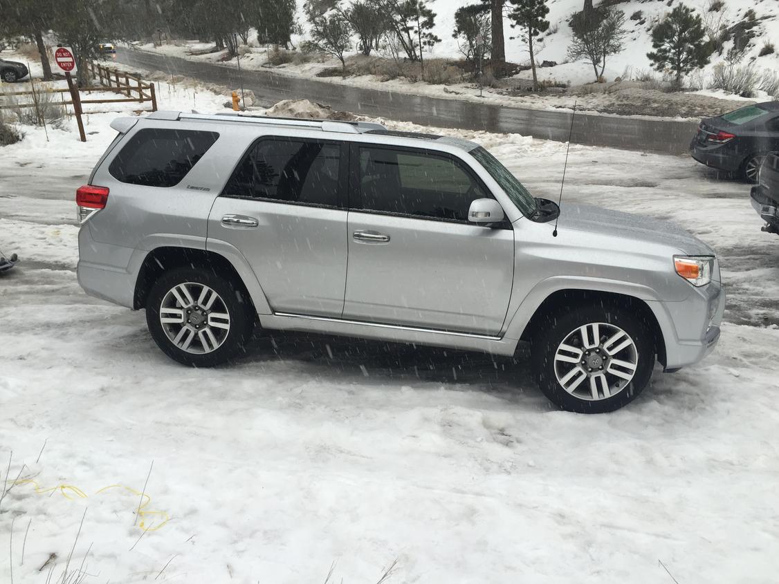

The picture that I posted (5th gen) is just after purchase w/stock tires. Now I'm on 275/55 R20 Gd*Yr Eagle LS-2's; love the way it handles at high speeds, on corners and on banks!:

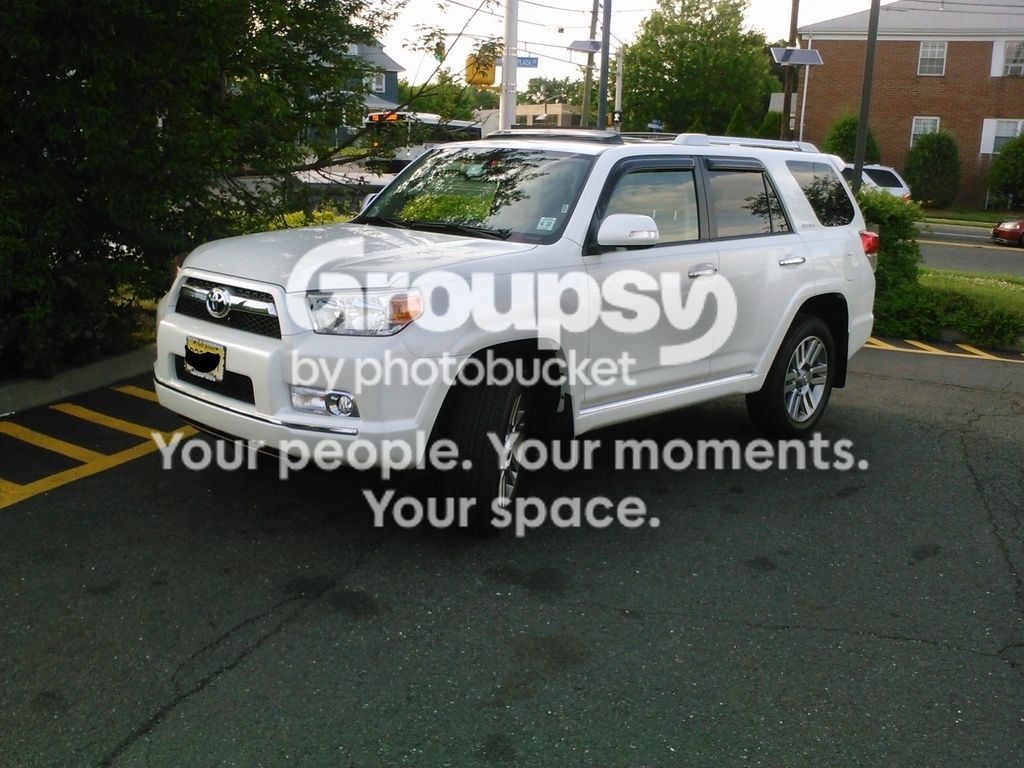

I NEED HELP ON DECIDING WHICH WHEELS TO CHOOSE FROM 18x9 or 17x7 TRD's for my 4Runner any ideas I would truly appreciate...
