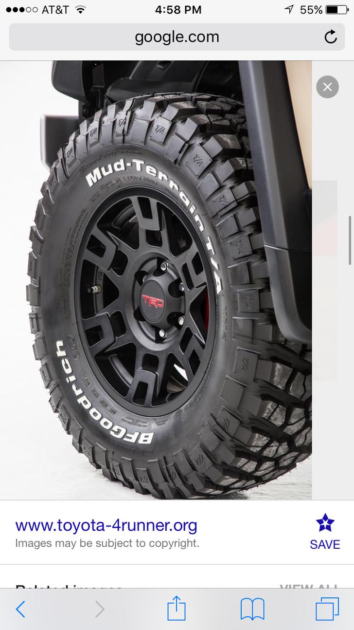

Yeah I love the oem wheels and maybe just keep them on and change the tires but I like the TRD's pro 17

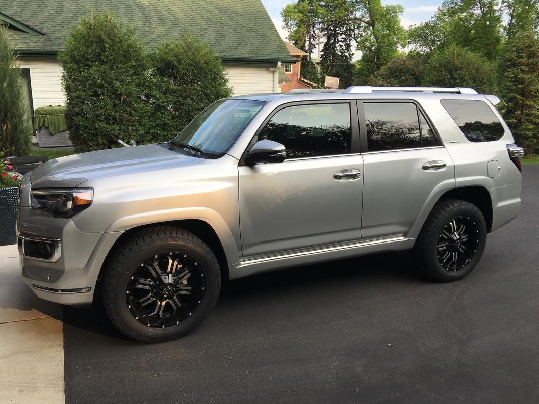

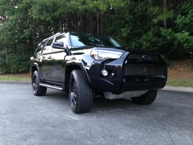

I still think the 20" Limited wheels look fine and tires should be ok.
I could change my mind - there is only 700 odo miles on it. I am working on installing the Thule Canyon roof rack now. I have made modifications before it had 250 odo miles on it (Magnaflow catback). I might not be that interested in wheel and tire changes.

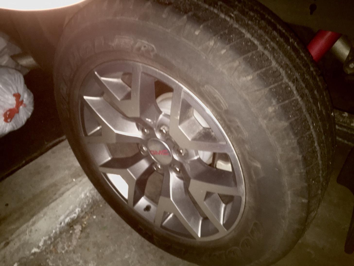

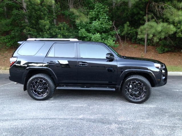

Was together with the family for Christmas and got a good look at the tires on my nephews truck. He's got a '16 GMC Sierra All Terrain, think it's basically the Z71 package. It's got factory 20" wheels probably 8" or 9" wide, the wheels are huge, really nice looking. Anyway these tires came stock on the truck, Goodyear Wrangler SR-A's in 275/55r20. They're a real nice looking tire. Center section looks to be a basic all season tread but the outside blocks are big with fairly deep grooves. Edge blocks extend on tread face and up sidewall about 1 1/2".
He said ride was pretty good with no road noise issues. Don't think he's had it off-road yet, didn't mention anything about off-road performance.
Not a big Goodyear fan but they are a really nice looking tire.
