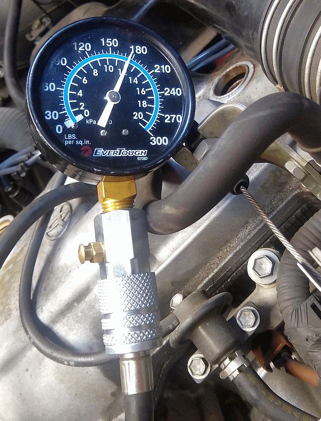

My compression was roughly between about 165 & 175 when I checked the four cylinders.
Is there any clue in the compression numbers for whether valves need checking? Or is it just something you have to check visually, like brakes are?
I’m not 100% on this, but I think if your compression was low then it means a valve is already burnt and adjusting would not help. Keep valves adjusted to stop that from happening.

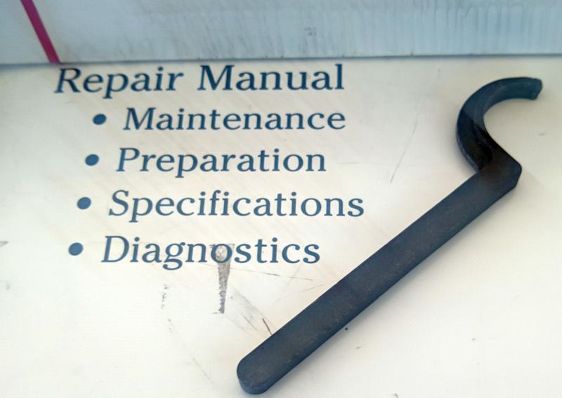

I don't mind buying the right tools but I just wonder if this old tool I already have for a motorcycle overhead cam bucket depressor might work?
