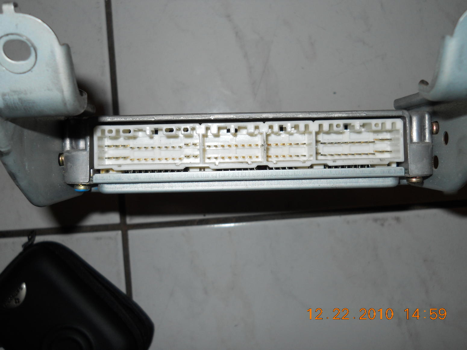

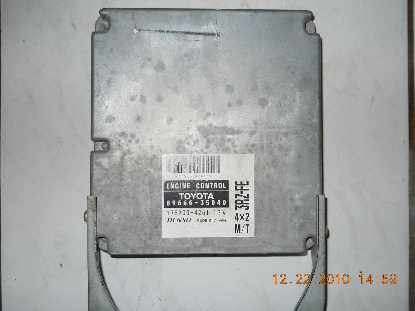

Finally found and got my ecu for the auto to manual conversion.!!!

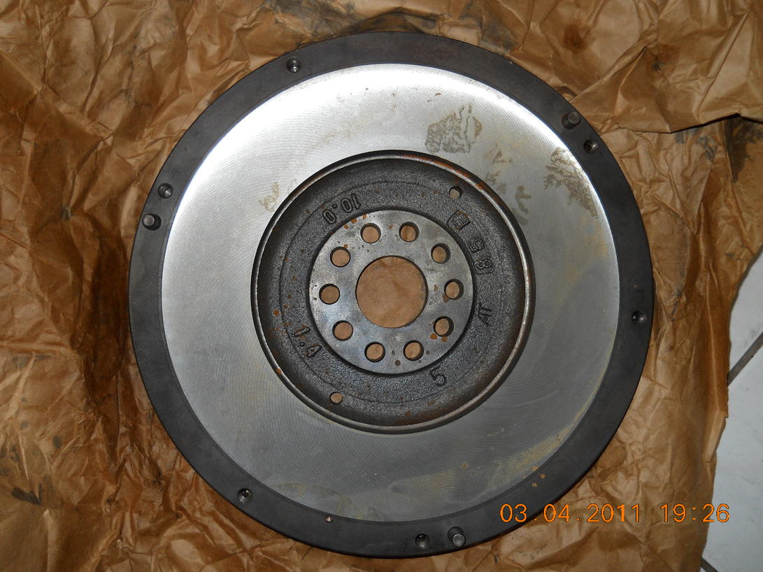

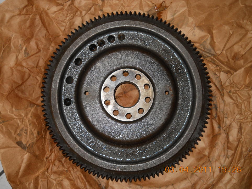

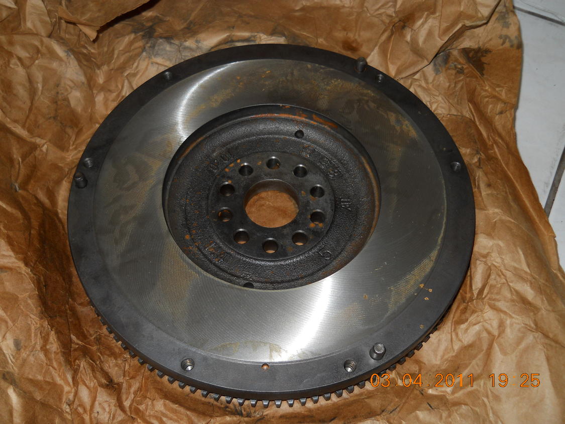

3rz Flywheel
Here are some pictures of the resurfaced flywheel. $45.00 shipped from Part-Spot.com and $25.00 for resurfacing at my local clutch and transmission shop.

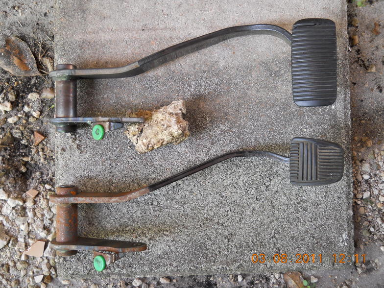

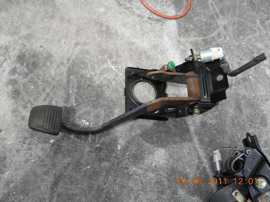

Brake pedal
Some pictures of the stock auto brake pedal and the manual brake pedal...

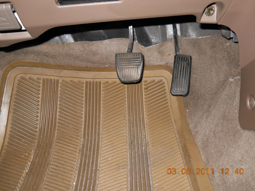

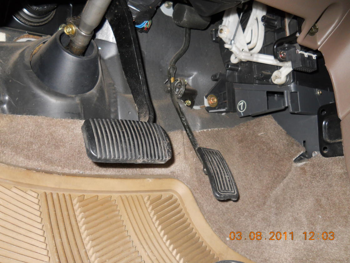

manual- brake pedal installed
The new brake pedal installed from a manual donor... I eneded up swapping just the pedal without the bracket. Clutch and brake pedal with their brackets were $110.00 shipped from car-part.com Drilling the holes on the firewall for the clutch pedal will be next.
