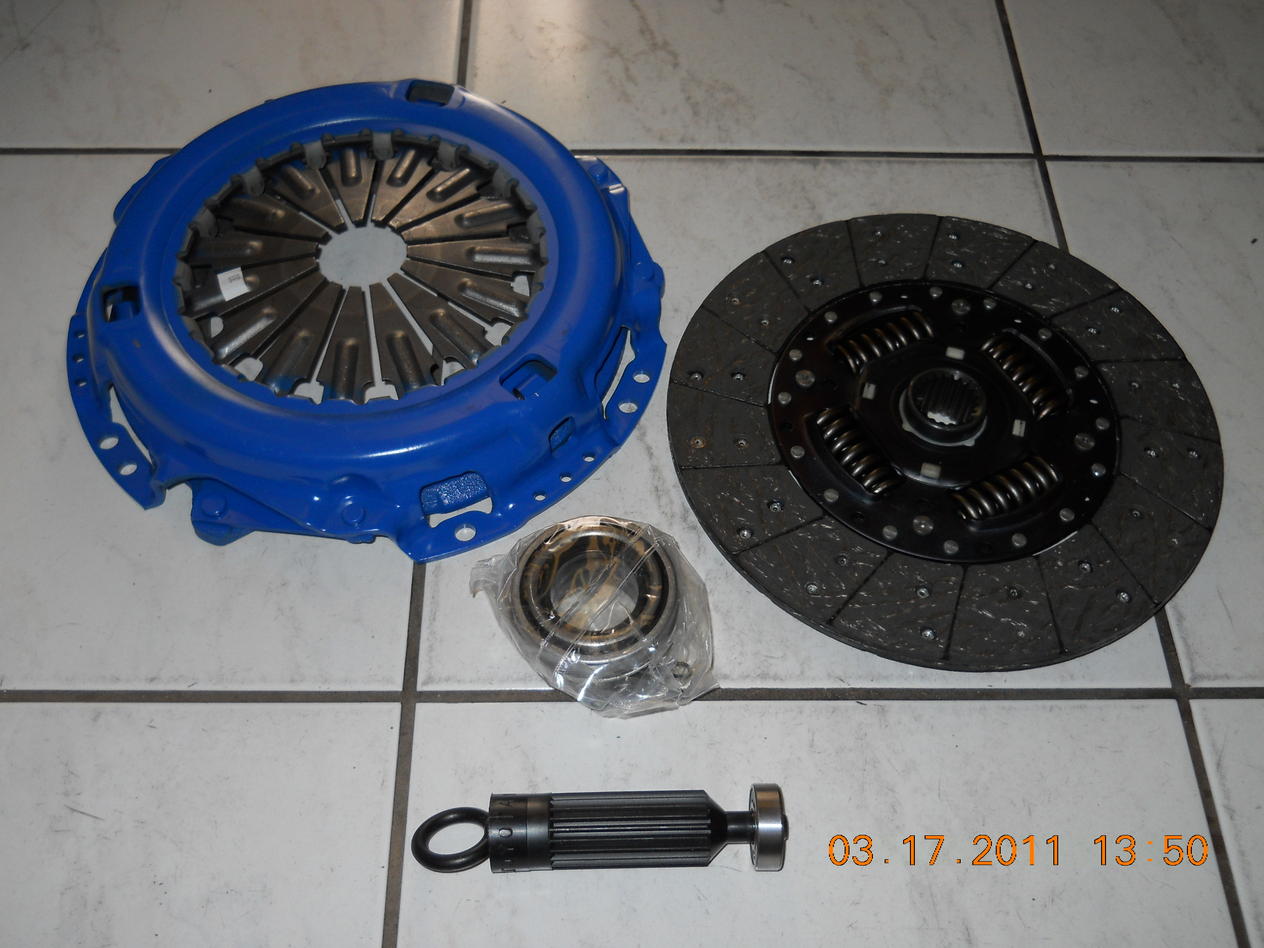

F1 Racing state 1 clutch kit from good old ebay for $106 shipped. I think it's pretty good and you can't beat that price.!

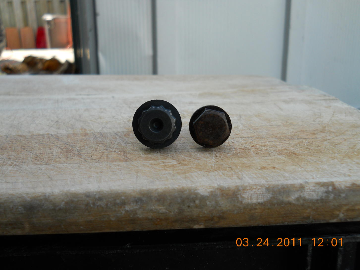

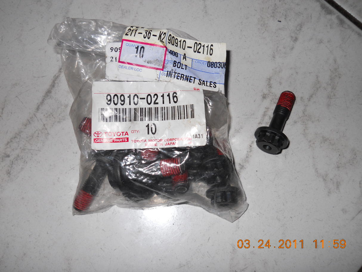

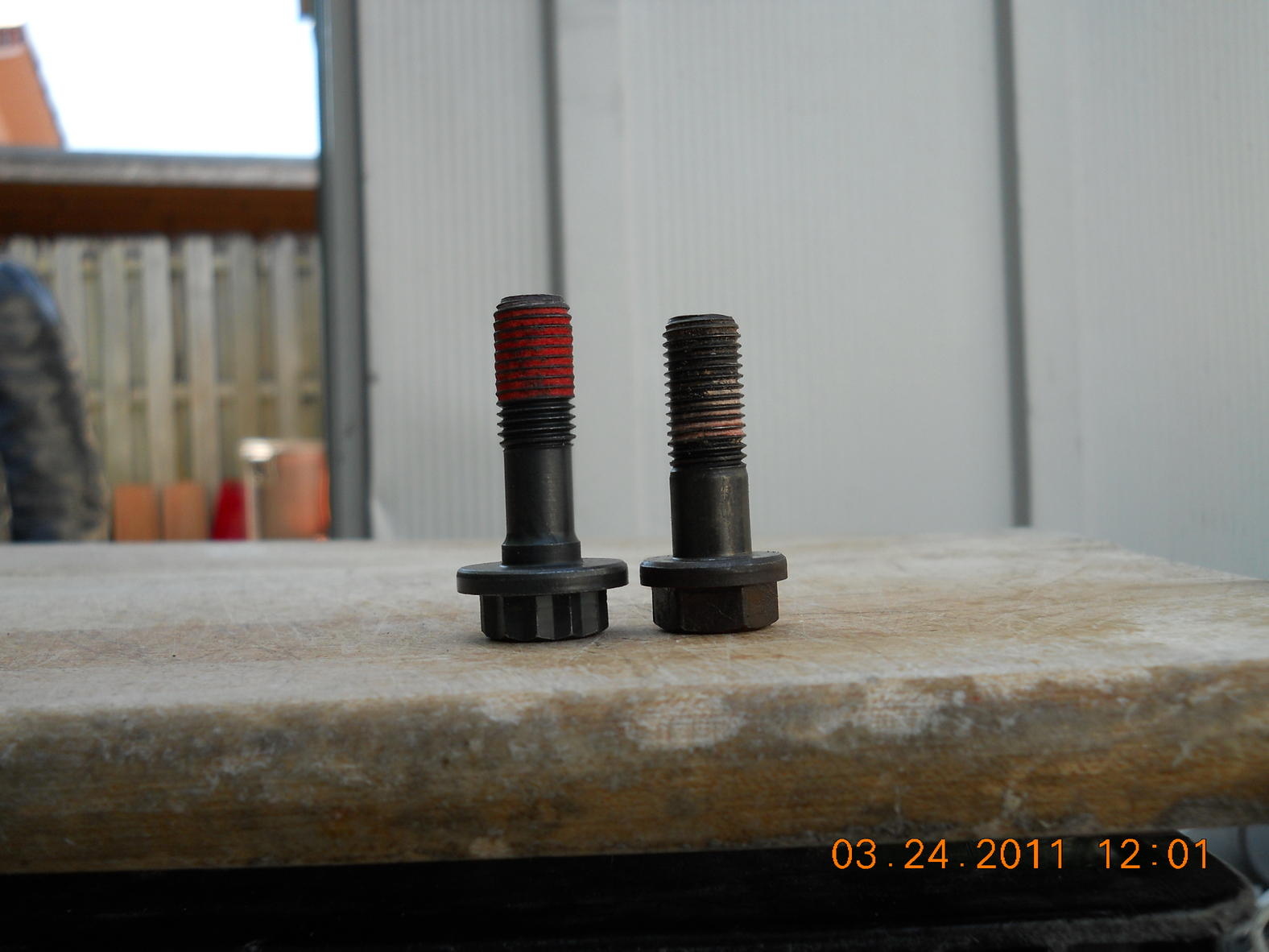

Flywheel bolts
Here is the p/n for the flywheel bolts for a 3RZ engine: 90910-02116. The bolts for the flexplate are not the same as the flywheel bolts, so you're going to have to buy them. The flexplate bolts measure about 30mm from under the head to the end of the threads. The flywheel bolts measure about 33mm, they were $2.04 each from an online Toyota dealer which is the dealer I'm getting all my hardware and misc. items; they got better prices than if I were to buy them from the counter. This might be just too much info but for future planning, the head of the bolts for the flexplate are six point, the flywheel bolts are 12 point so, you're going to need a 12 point socket to torque the new flywheel bolts just in case you don't happen to have one.

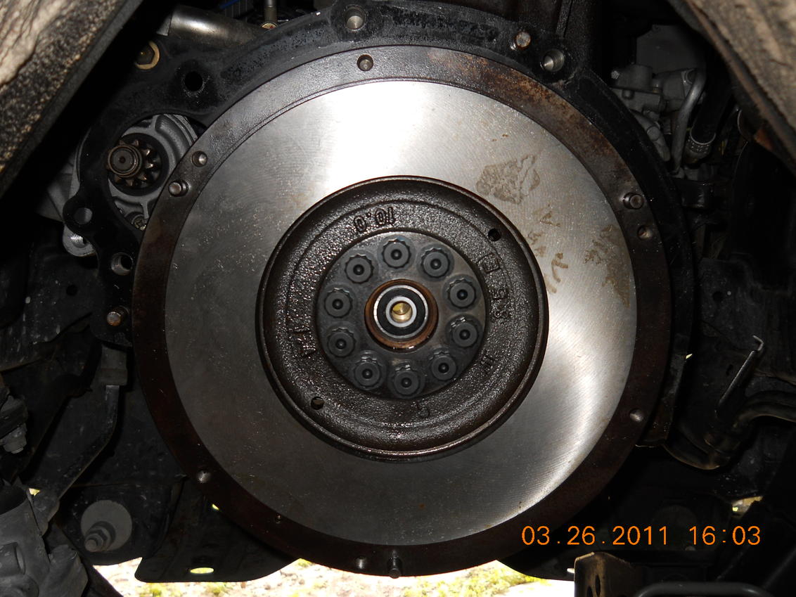

Flywheel installed.
Flywheel installed. Bolts torqued to 19 ft.lbs on 1st pass and then 90º for a 3RZ engine. This is what the manual says, I didn't quite give it the 90º degrees. My calibrated arm said it was too much. I really don't trust that. Even though they're new bolts, I did not want to take a chance and strip the threads or mess up the crankshaft. Again, this torque specs I got from a Toyota Haynes manual and from an online source at ncttora.com, both torque specs matched. I still did not want to go the full 90º degrees.!!! I got most of the parts already just haven't had time to do anything. Notice the new pilot bearing in the middle of the flywheel, I used a socket that had the same outside diameter (well maybe a few mm's smaller) as the pilot bearing. I sprayed some WD-40 on the flywheel so it doesn't rust until I get to install the clutch and the tranny. No, I won't forget to wipe it clean with alcohol before I install the clutch.

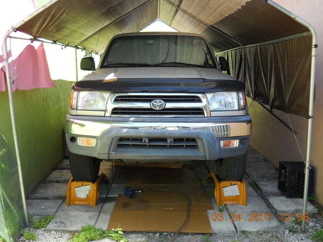

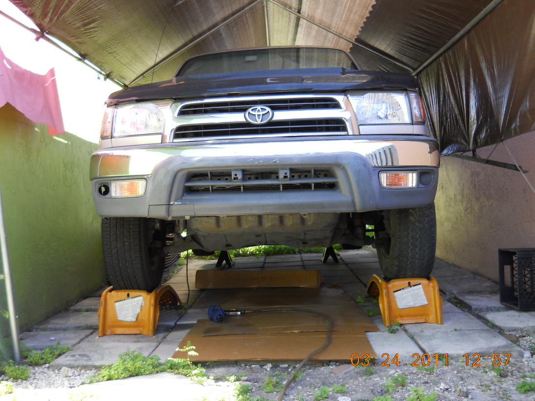

2000 4runner 4 cylinder
A couple of pictures of the vehicle.

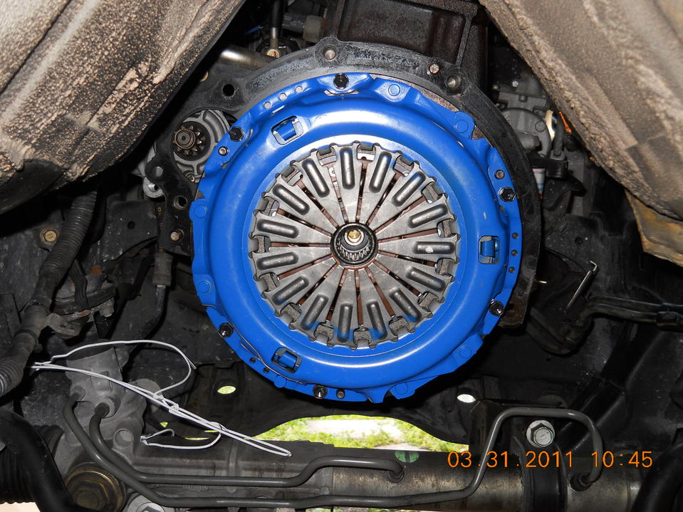

new clutch installed...

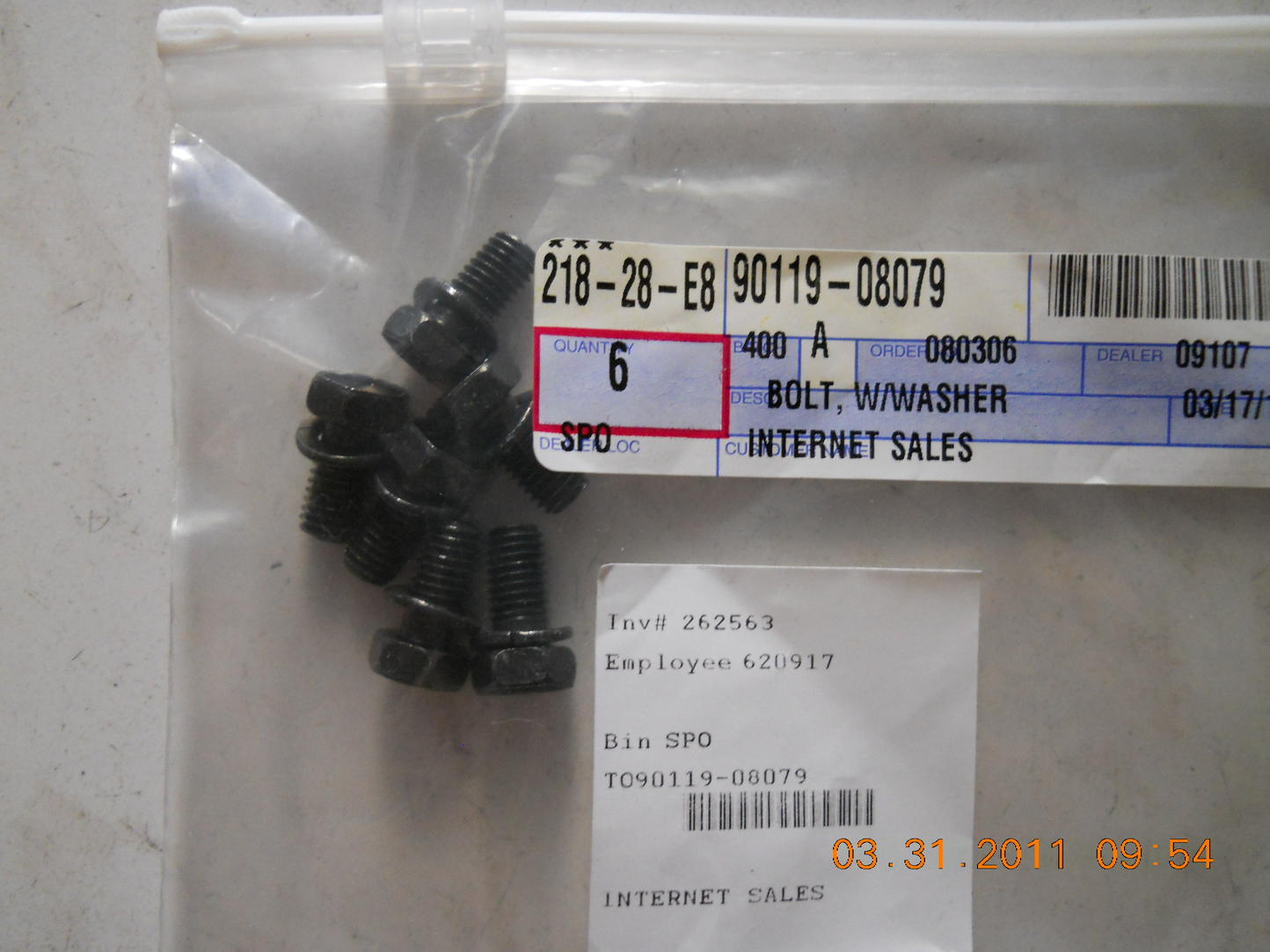

Here is a picture of the clutch cover bolts (6EA). The part number is: 90119-08079. They're relatively cheap, $0.47. The size is M8x1.25 and the length is about 14mm without the locking washer. Yes, it does take a locking washer. You can either buy them from the dealer or buy the kit from marlincrawler which are stronger. I'm giving you the specs on the bolt just in case you decide to get your own from a different source.

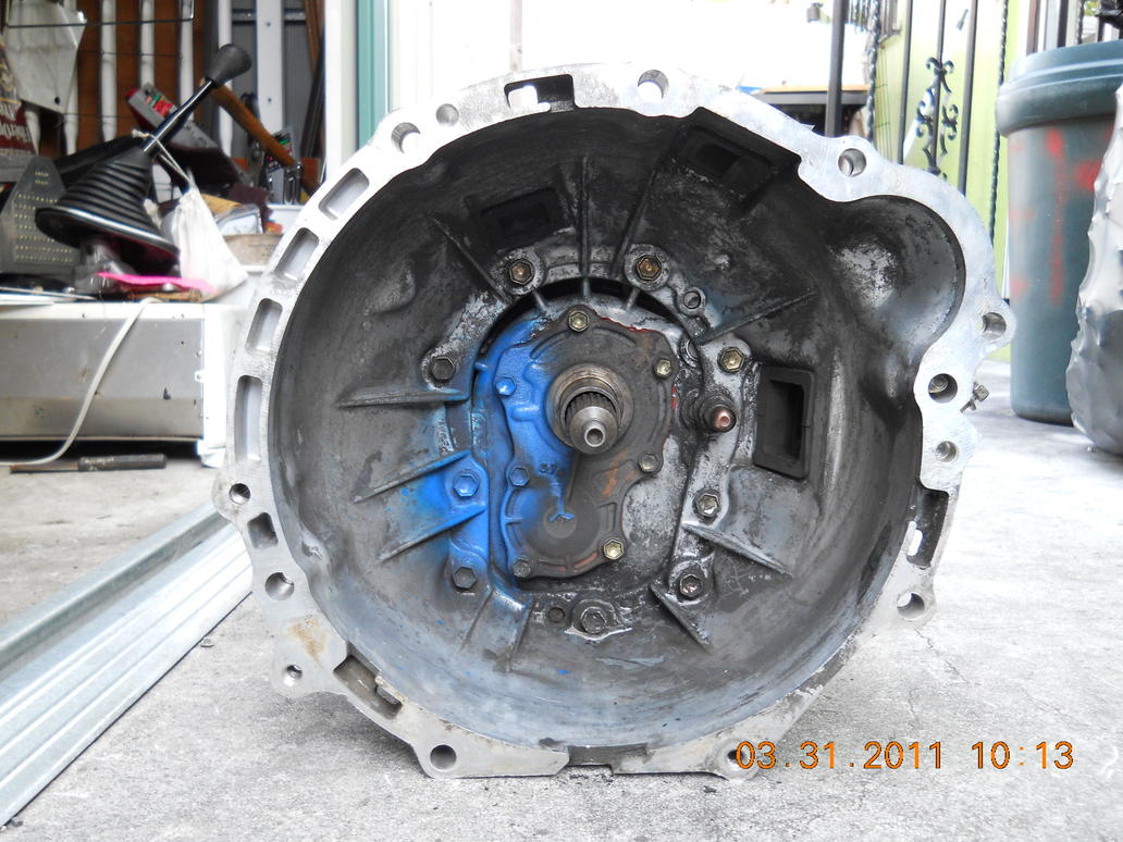

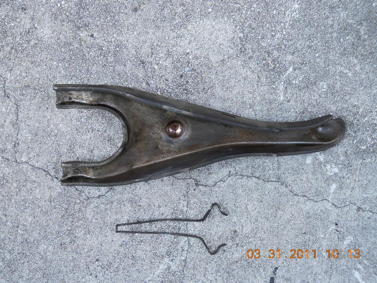

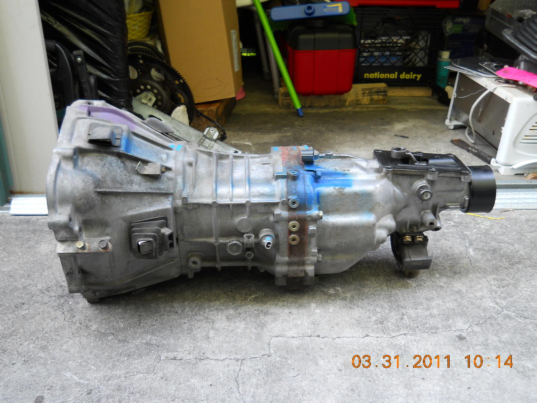

W59 transmission
Here is a few pictures of the W59 tranny and the clutch release fork and spring that holds it in place. I purchased the tranny in a package. It included the tranny, the driveshaft, shifter, clutch release bearing fork, shifter boot and the shifter knob which is all beat up and I'm not going to use. Everything shipped for $775.00. I had the guy ship it to where my brother in law works since they have a forklift to lower the pallet, otherwise I would had paid about $120.00 more. You can see the shifter on the far left side of the 1st picture. The tranny mount came with the transmission which is the same as the automatic. I ended up using the automatic transmision mount since the other one, the center shaft was bent.

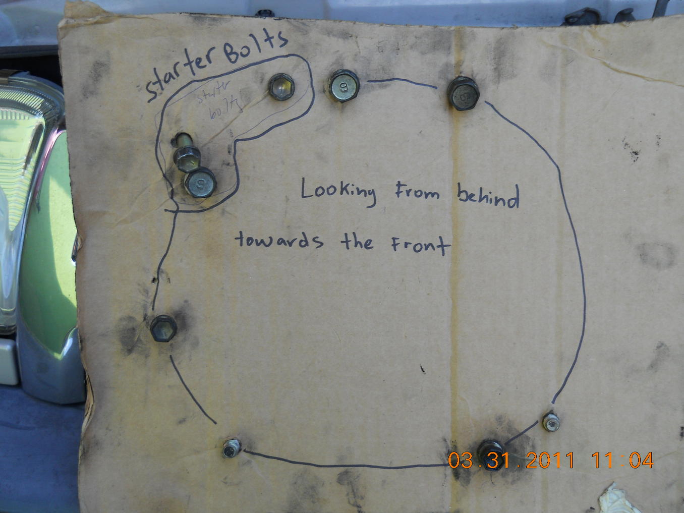

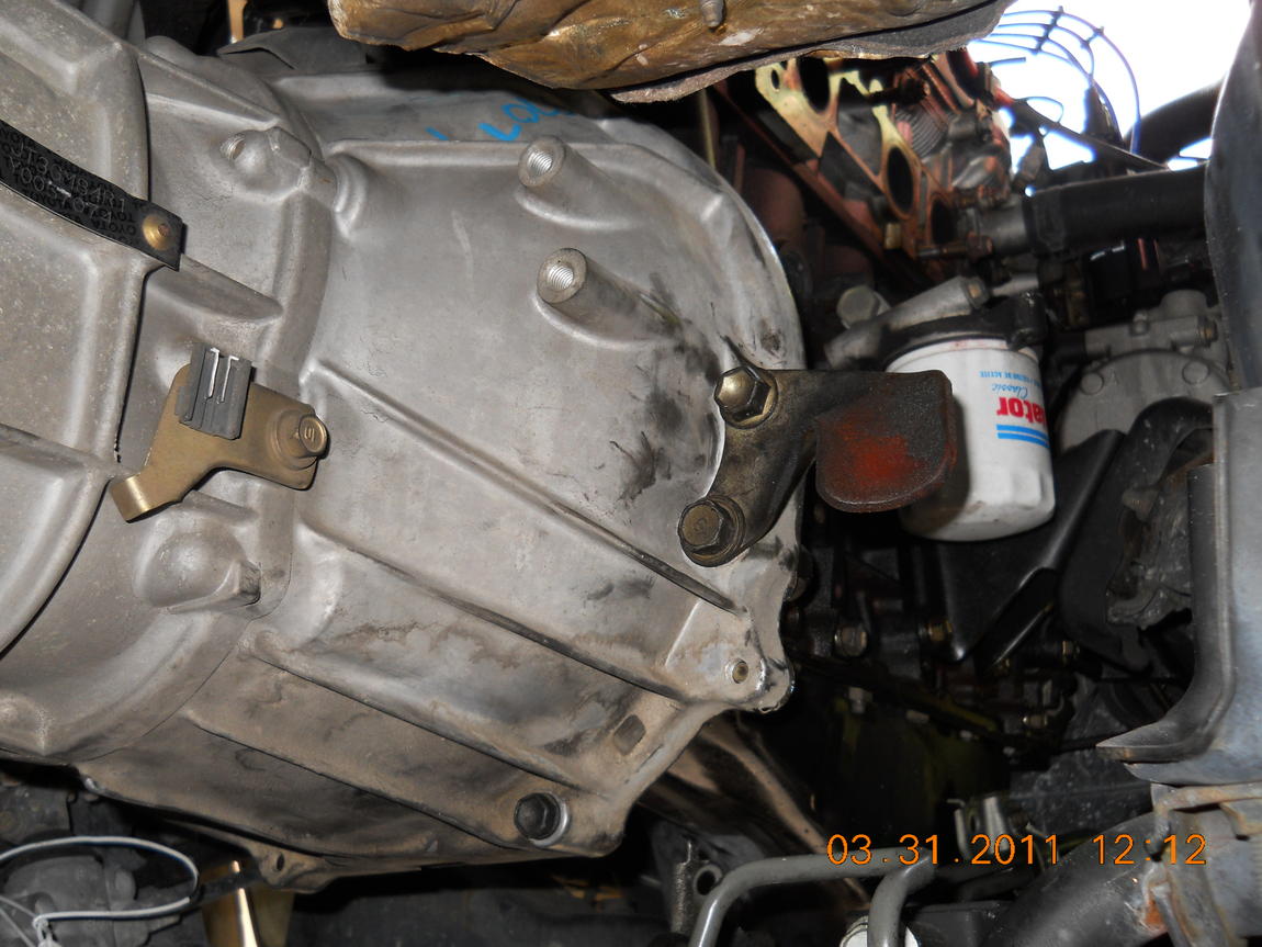

transmission mounting hardware....
When I removed the auto tranny, I made a template out of cardboard and installed all the bolts on it so it would be easier to put them back in their original location. The only bolts that I did not put on the cardboard were the ones that hold the support bracket for the exhaust pipe that comes down after the exhaust manifold which are located about 4 o'clock position. All the bolts that that attach the auto tranny to the engine fit the manual tranny. The lower cover plate from the automatic transmission fits perfect, too.!

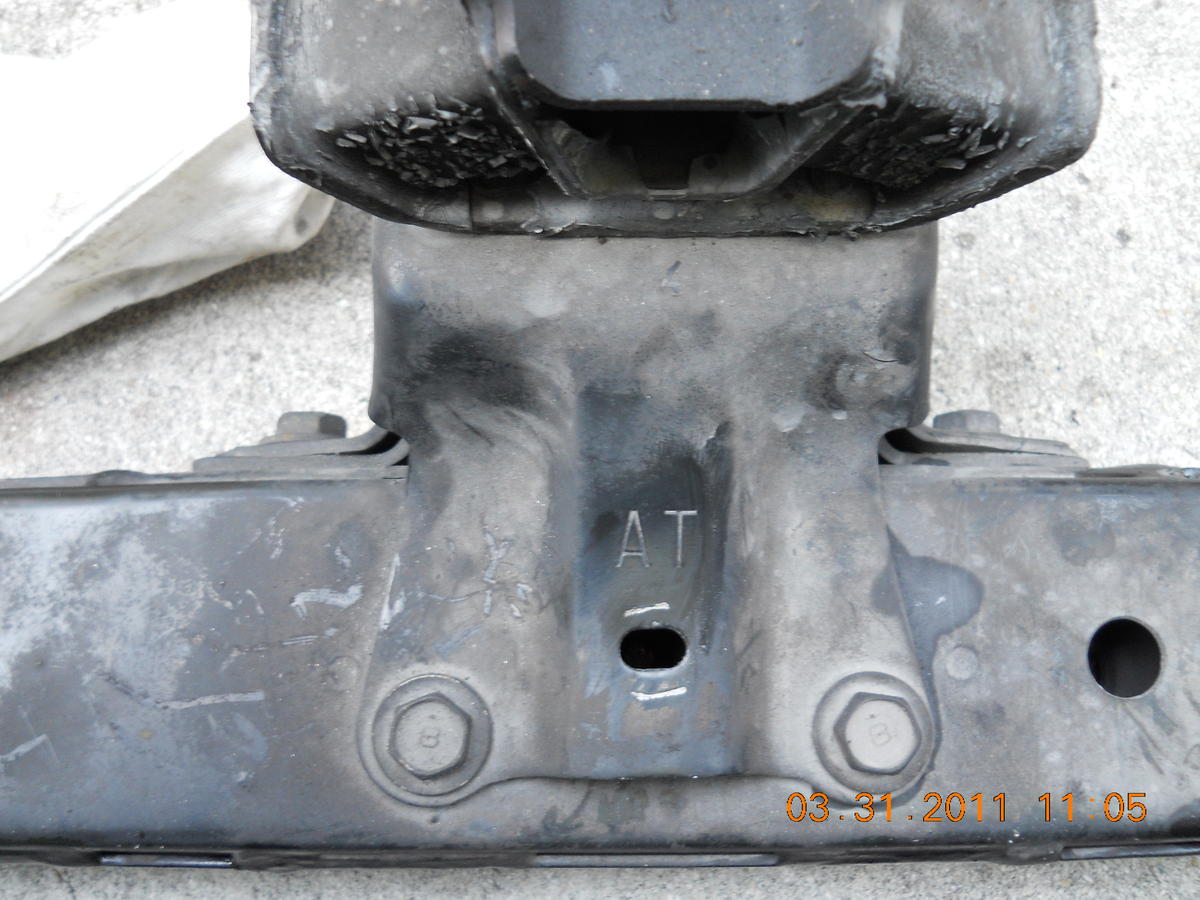

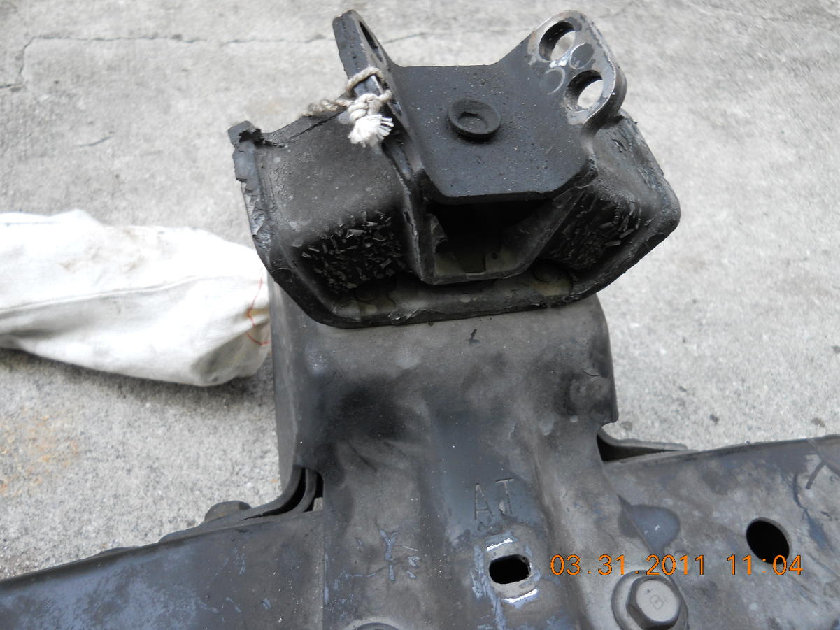

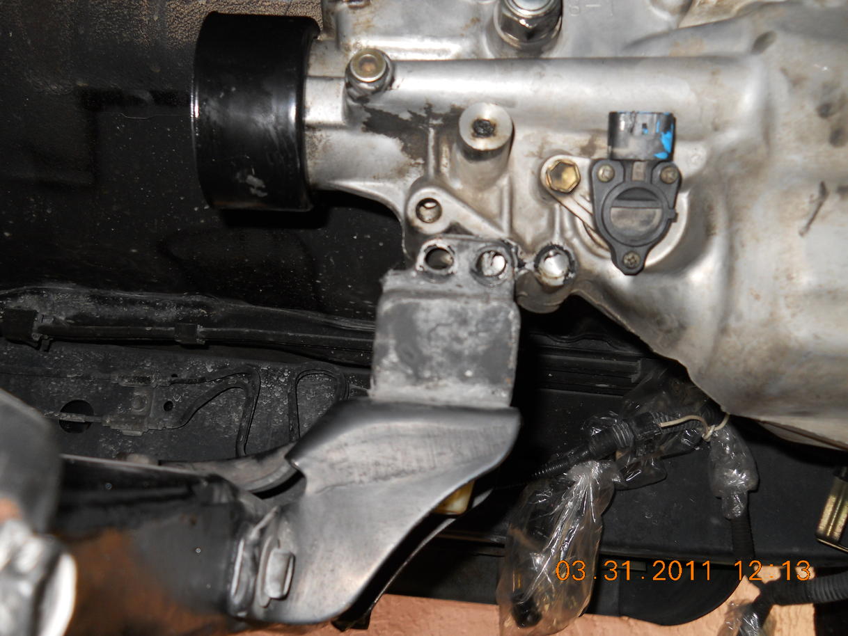

# 3 crossmember bracket...
So, the manual transmission is installed. The center bracket where you bolt the transmission mount is different from the manual tranny. With the auto transmission center bracket the manual tranny sits too far forward and cannot align the holes to install the bolts for the tranny mount. The bracket from the auto tranny has the letters "AT" stamped on the bracket. I ordered the bracket from the same guy I bought the tranny, it should arrive tomorrow. The hardware is the same for the tranny mount and the bracket. The crossmember is the same according to the p/n's from Toyota. I will confirm this once I get the center bracket.

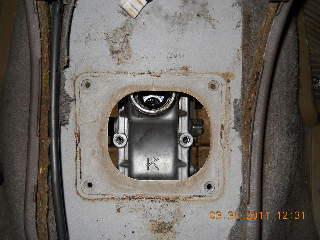

Another issue that needs to be adressed...
As you can see in the picture, I need to trim the center tunner so that I can install the shifter. It shouldn't be a problem... I also need to fabricate an adapter for the dust boot retainer if I want to use the original mounting holes... that should be fun.!!!
