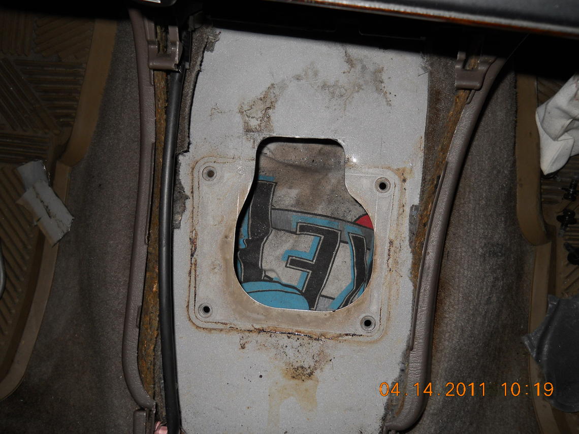

As you can see in the picture, I need to trim the center tunner so that I can install the shifter. It shouldn't be a problem... I also need to fabricate an adapter for the dust boot retainer if I want to use the original mounting holes... that should be fun.!!!

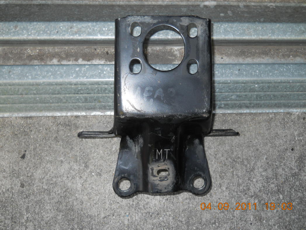

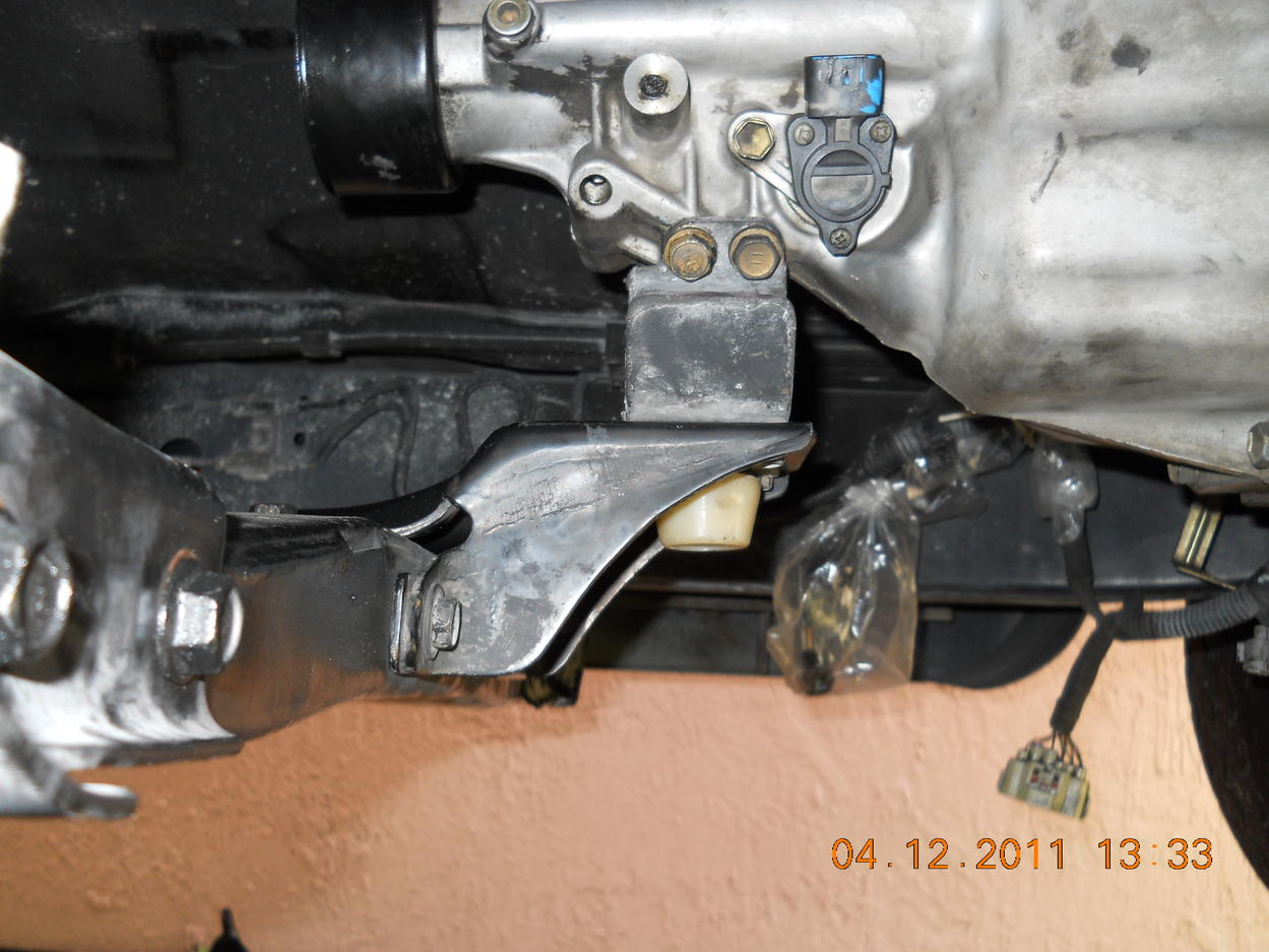

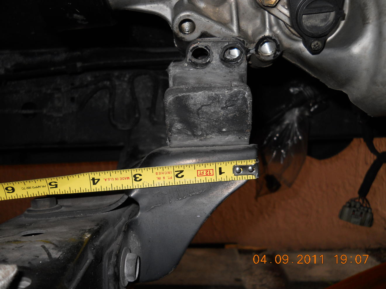

transmission mount bracket....

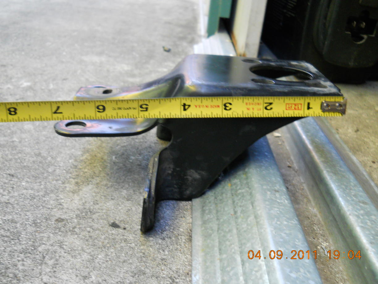

Ok, here we have a few pictures of the manual tranny mount bracket. As you can see, the bracket is longer than the auto. I believe the p/n is: 51431-35200 (for the manual) and Toyota calls it: "Bracket, engine rear mounting" Double check this p/n with your dealer, like I mentioned before, I ordered if from the junk yard I bought the tranny. The guy charged me $40.00 bucks shipped to my house. The crossmember is the same for the manual, so you can reuse your crossmember. Keep in mind that this is for a 4x2 4 cylinder conversion. If you're doing a V6 you're going to do your own research. You can use all the mounting hardware from your auto.

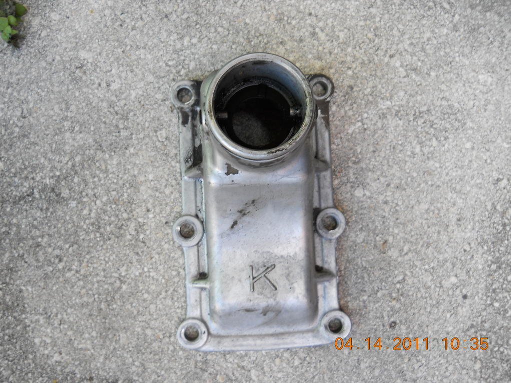

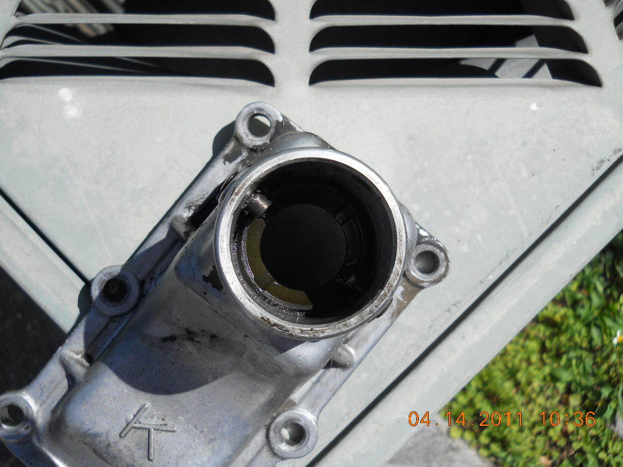

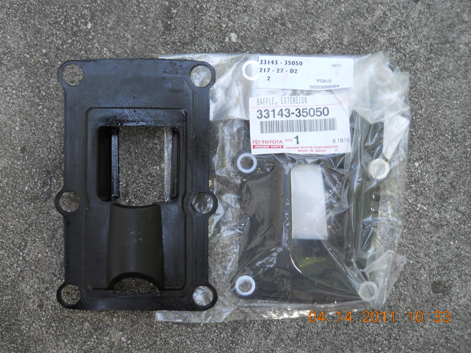

shifter tower...
Ok... for the shifter tower, I replaced the seal that seats between the tranny and the shifter tower, toyota calls it: "plate, extension housing oil baffle" and the p/n is: 33143-35050. I paid $30.65. Becareful when you replace it, it has 6ea spacers that look like washers that may fall inside the tranny. These keep the installer from overtorquing the baffle. The shifter seat was in good condition so I left it alone. Here is the p/n if you need to buy it from your Toyota dealer: 33548-31010, Toyota calls it: "seat sub-assy shift lever" and the price is: $9.50 from where I purchase my parts. For this price you might be better off buying it from marlincrawler.com since they make one that last the life of the vehicle and maybe more... Price from marlin: $10.00

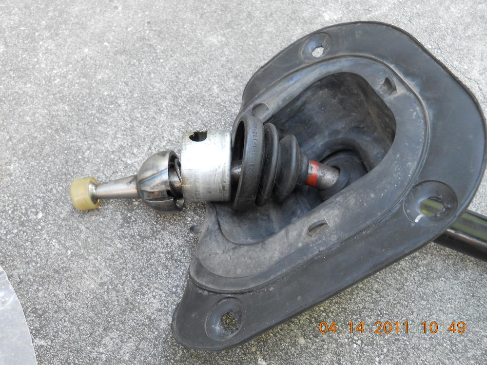

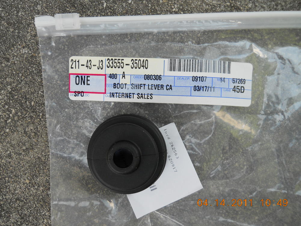

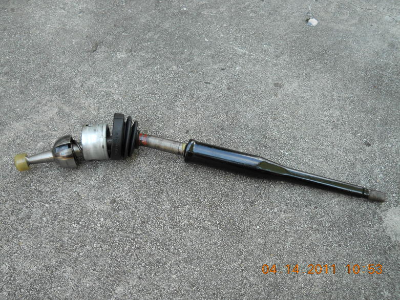

shifter boot...
The shifter boot was kind of old and you could see cracks around the boot so I bought one from the dealer: P/N :33555-35040 $5.77 Toyota calls it: "boot, shift lever". The hole is kind of small but with a bit of vaseline it goes right in. Here is a couple of pictures... before and after.... The p/n for the white bushing at the end of the shifter is: 33548-31010, name: "bush, shift lever" price: $4.04 (remember... price may vary from your local dealer) I did not replace mine since it was good.

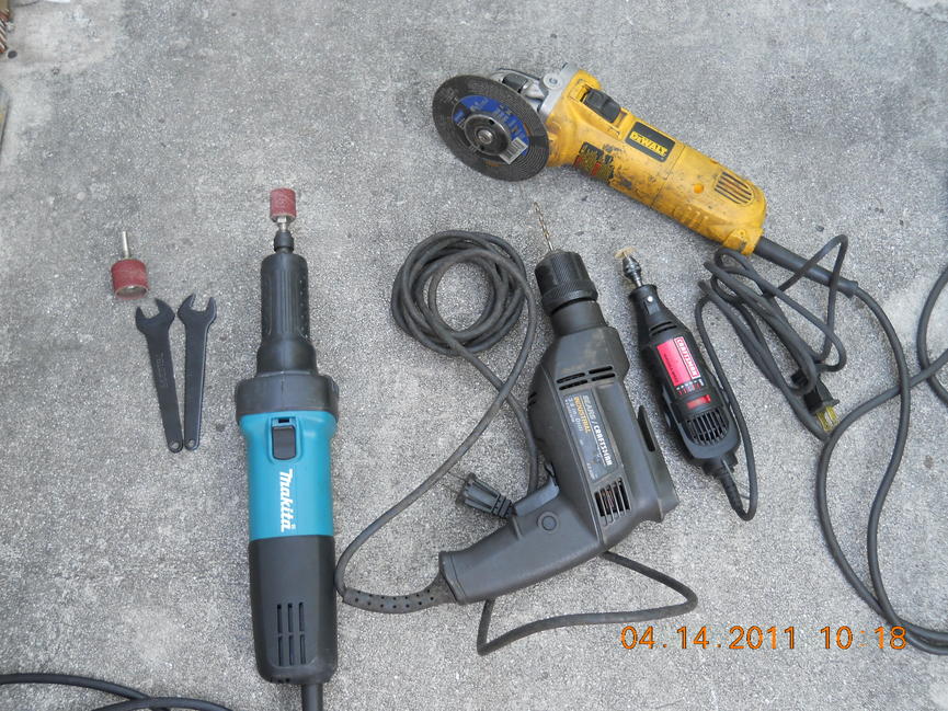

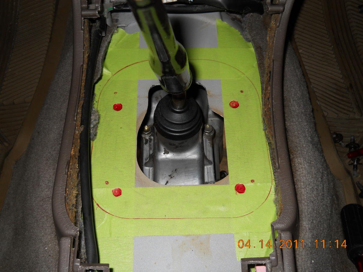

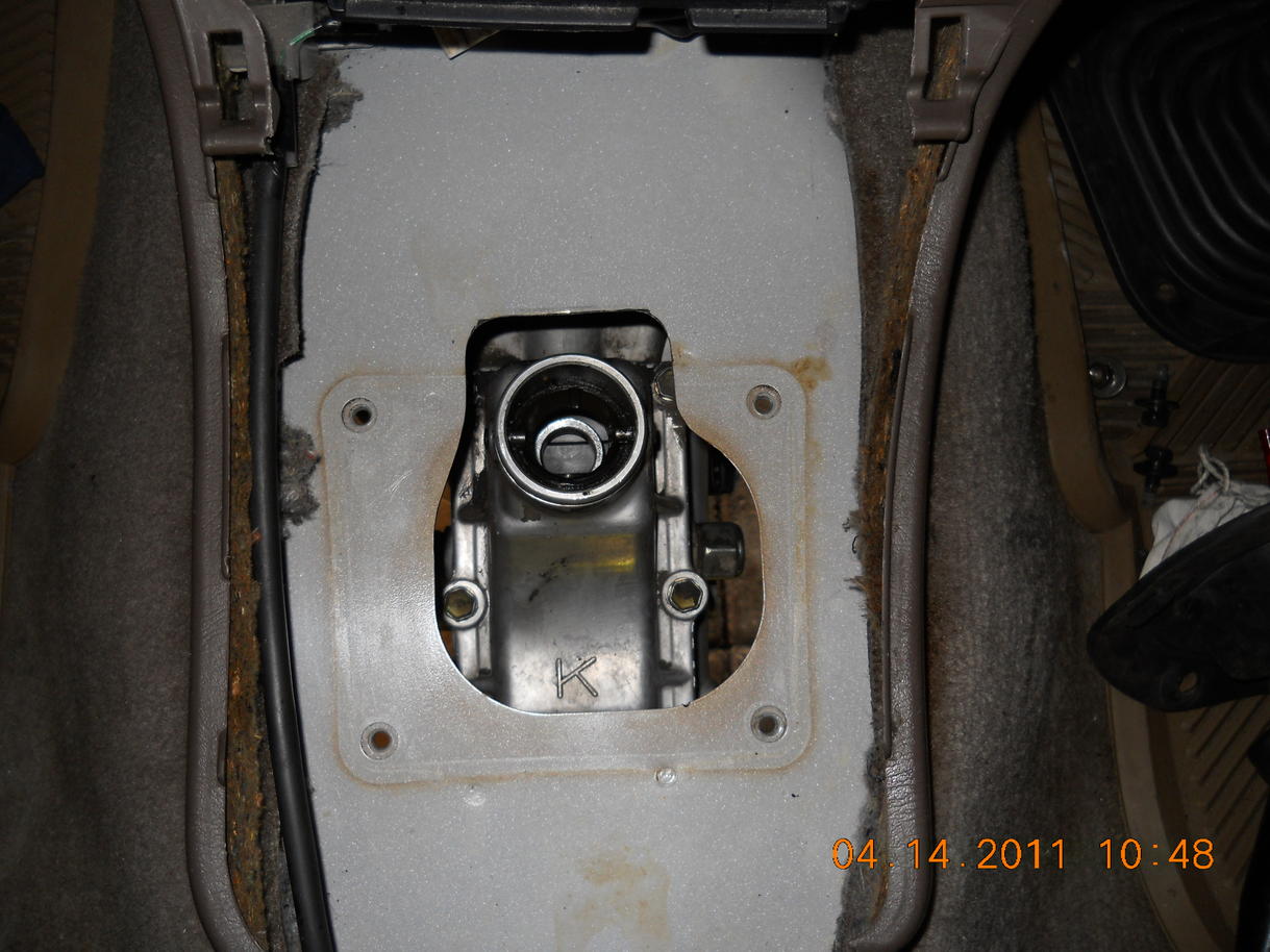

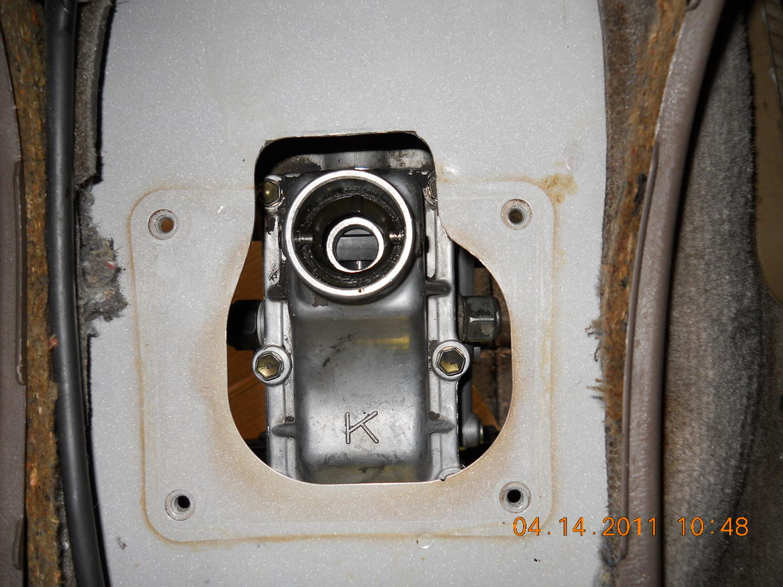

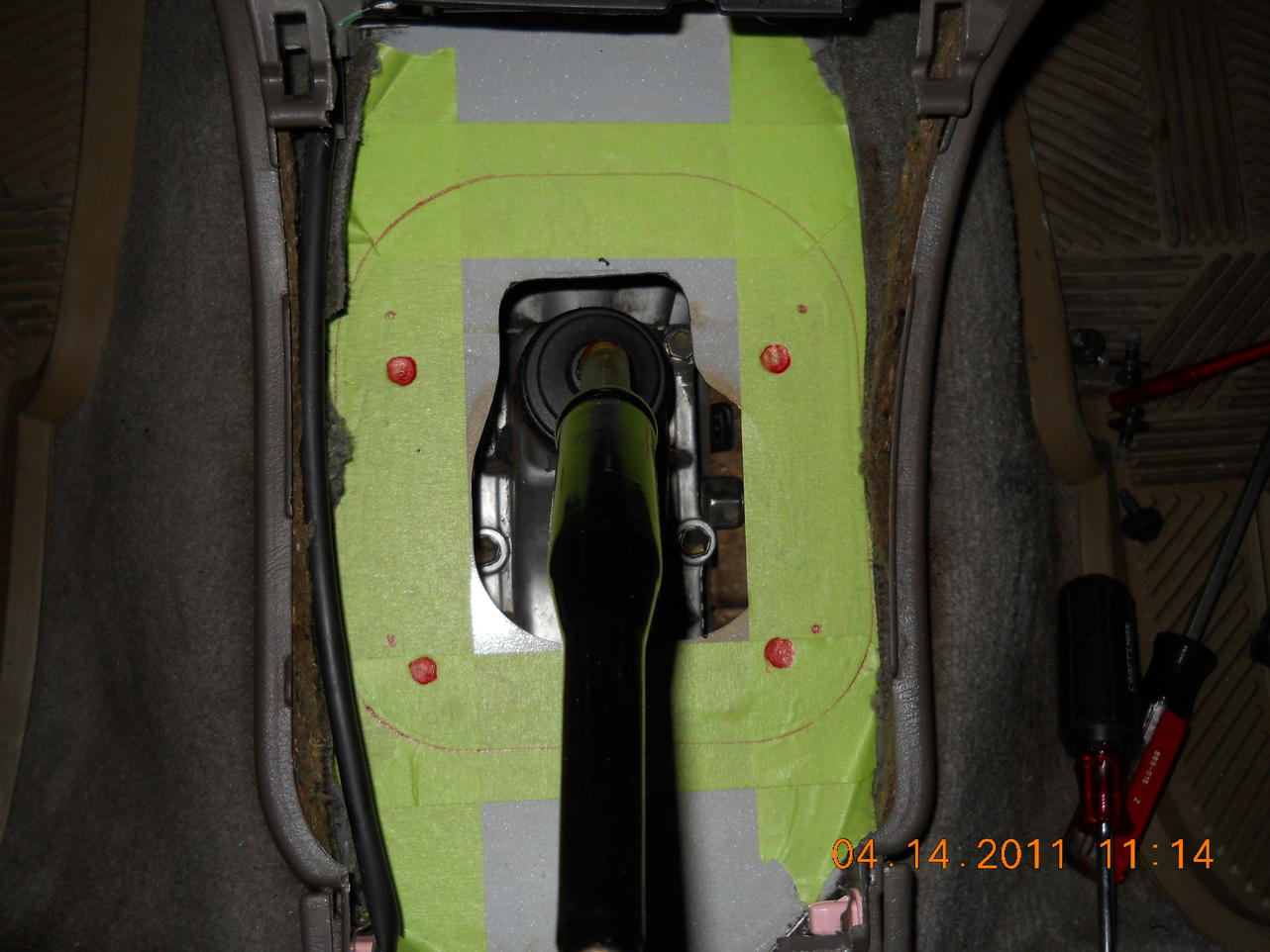

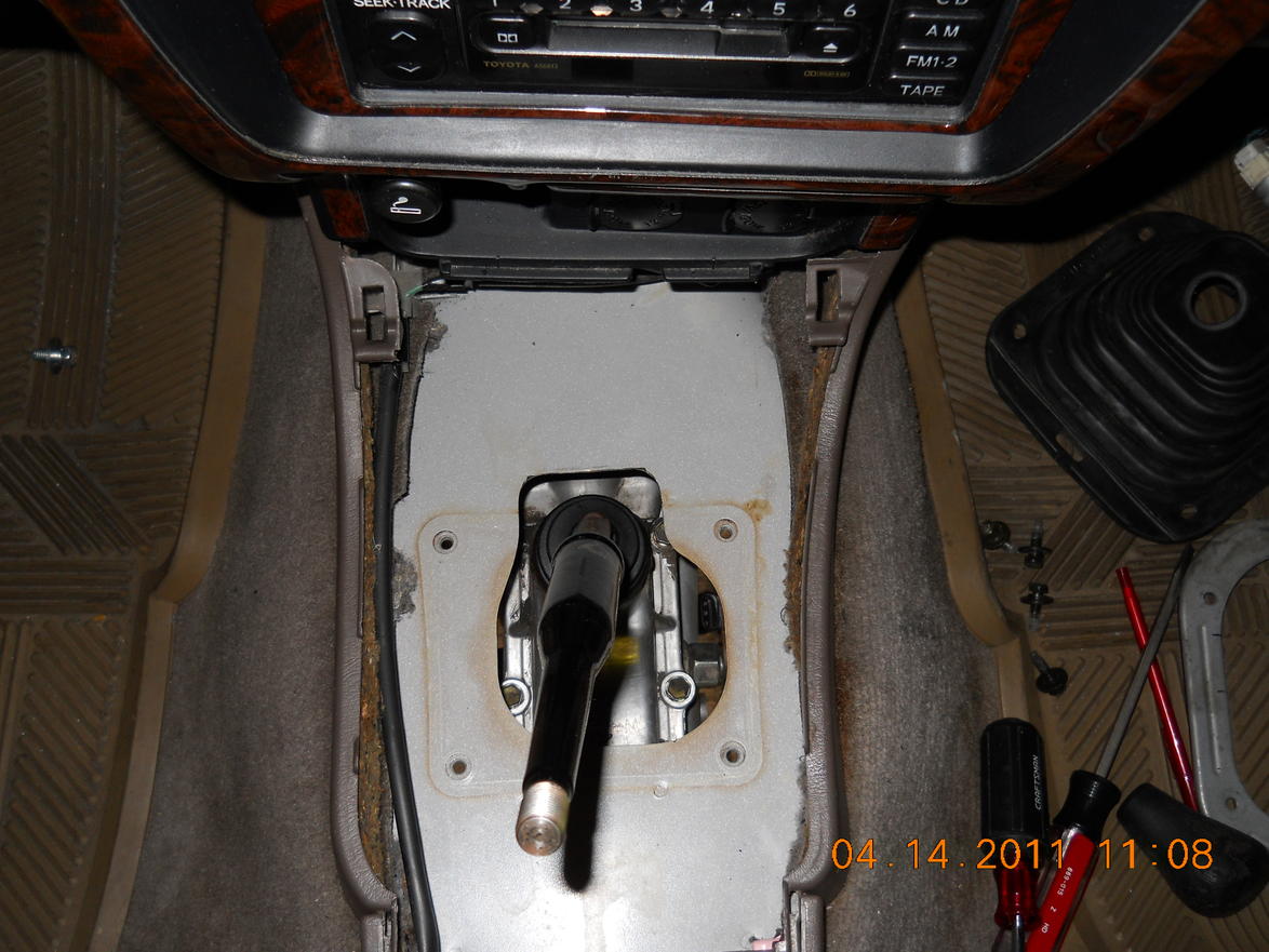

Trimming the tunnel...

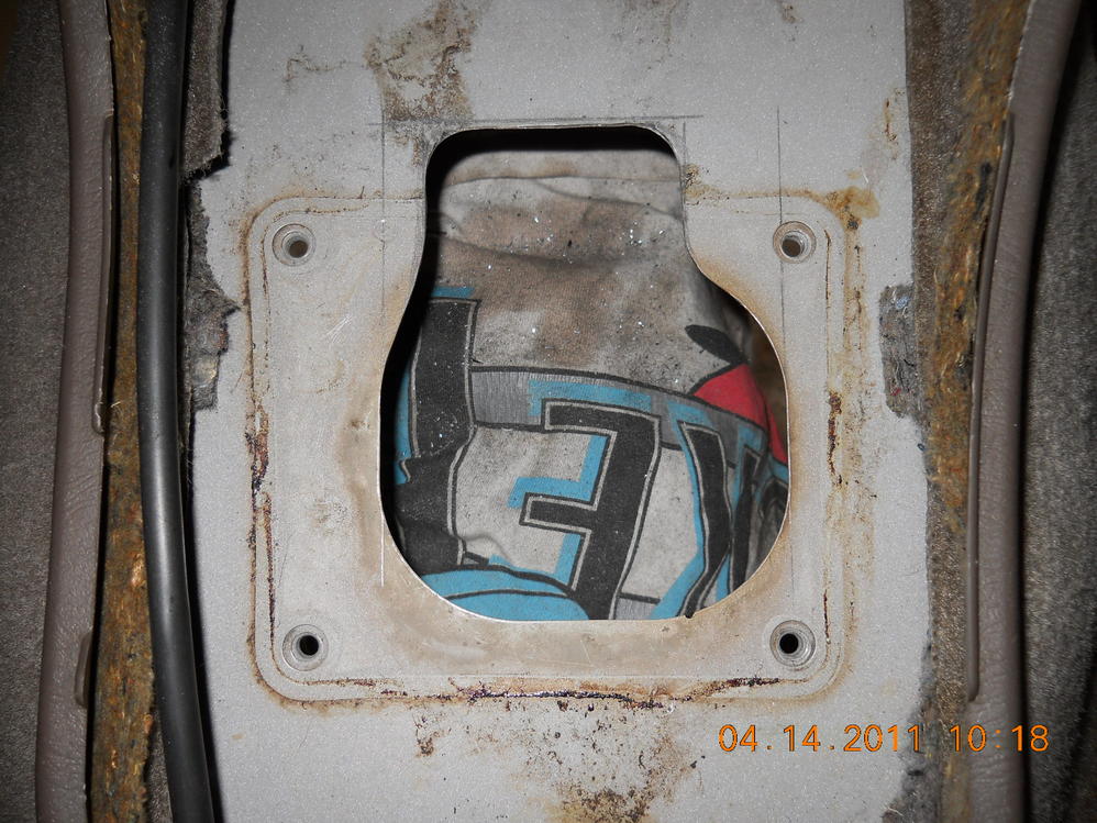

Here are some the tools I used to cut or trim the hole for the shifter. I marked with a pencil what I needed to cut. After trimming the hole I placed the shifter boot retainer and marked where I want the retainer to be. I'm making an adapter plate out of an 0.100" aluminum sheet. These will hold 4ea. studs to accomodate the new shifter boot retainer. The big 4 red dots are the original mounting holes for the auto shifter. I'm planning on using them to hold the adapter plate. The smaller dots align with the holes on the shifter boot retainer. Nuts and washers will be used to secure the retainer onto the studs.

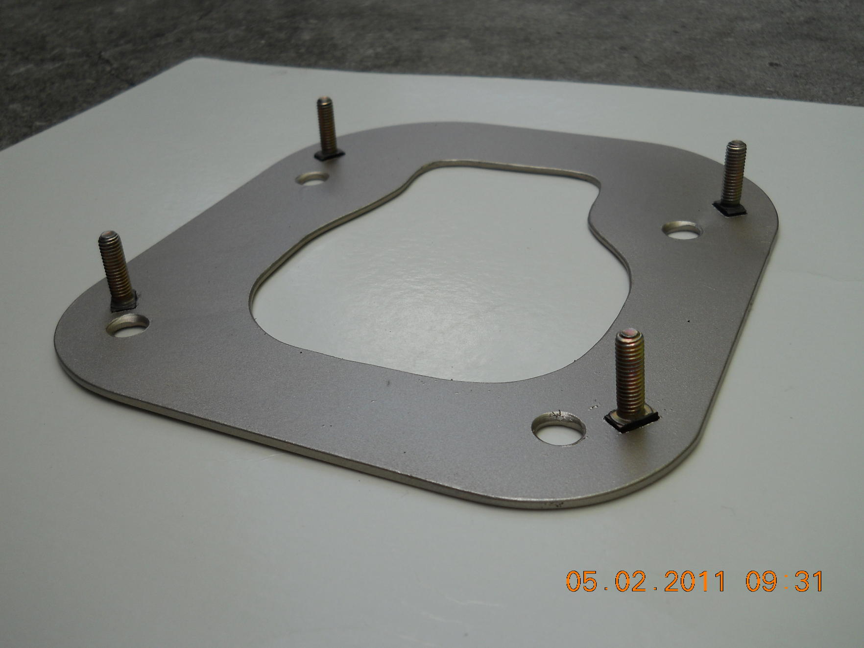

shifter boot adapter plate continue....

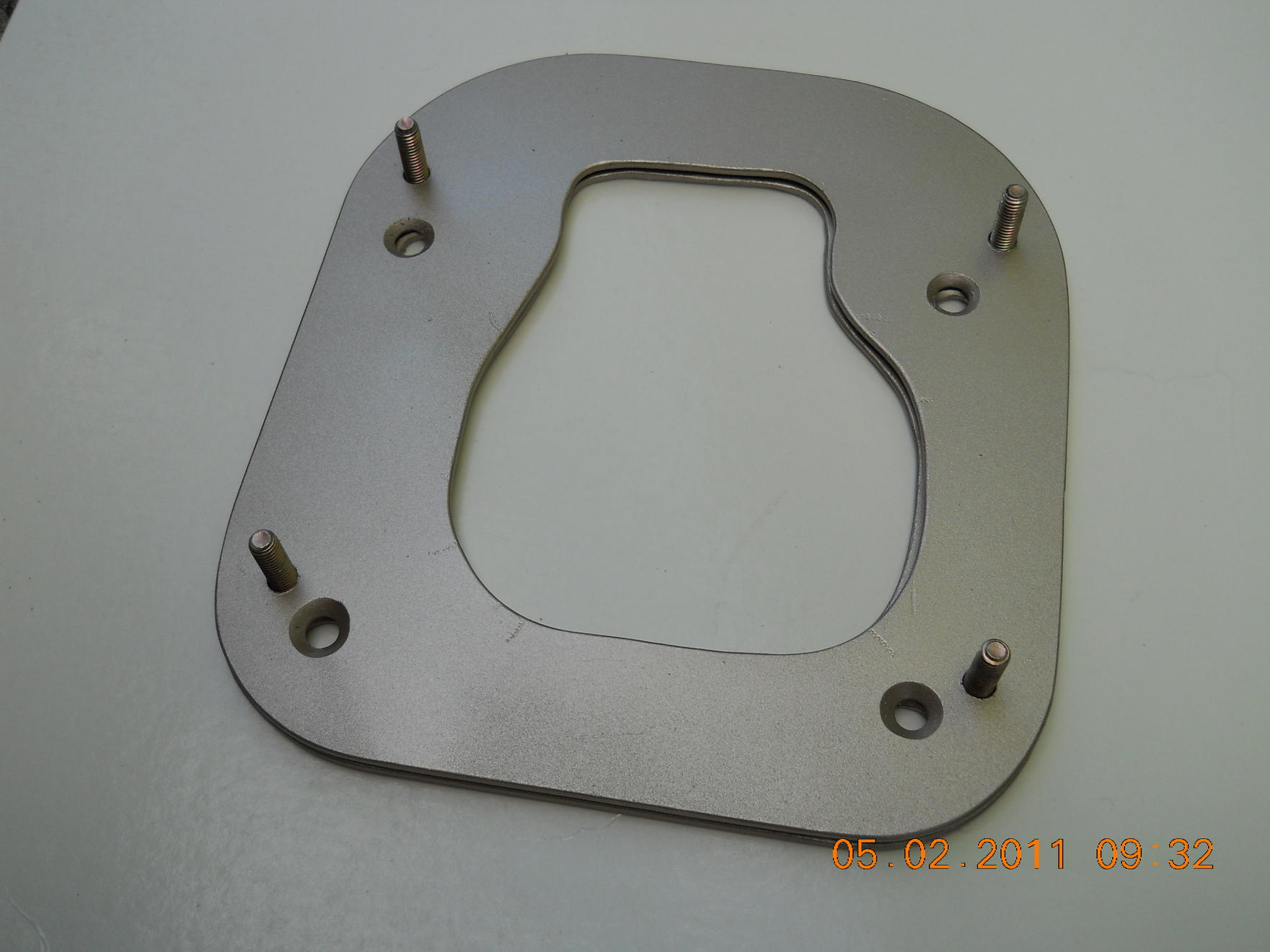

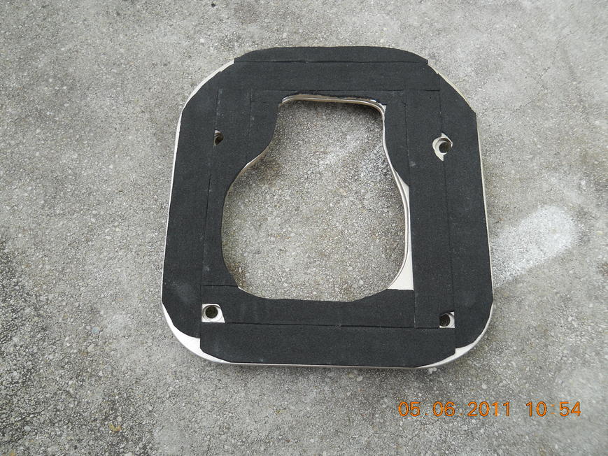

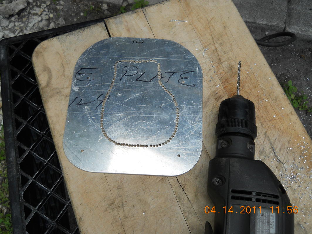

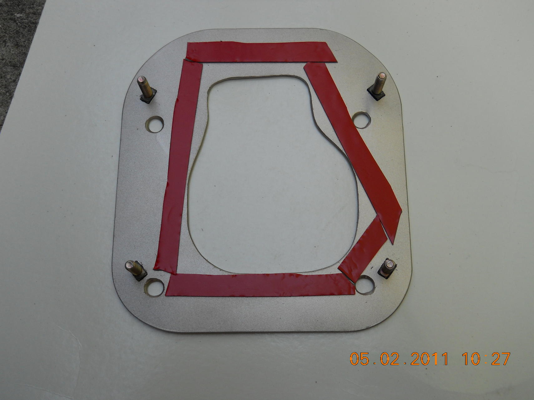

Finally back from having some time off and having some issues with my camera and loosing all the pictures that I had taken to post them here.:crybaby: Therefore, you're not going to see the whole process of doing some things on this project. I left off on the adapter plate for the shifter boot. I don't think a lot of you will get into this since it's a lot of work for something that is cosmetic, but I wanted to do this as good as I possibly could. So here is the rest of the info on the adapter plate project: There is two plates, a bottom plate and a top plate. The bottom plate will hold 4ea studs that I made out of M6-1.0 x 20mm bolts. You can get them from your local Autozone. I trimmed the bolt heads into rectangular shapes, I also trimmed the bottom plate holes so the bolts will fit into the bottom plate and would not allow the bolts to turn. I used a dremmel moto tool and a hand file to trim the holes for the studs. Yes, it did take me a while to do this.!!!

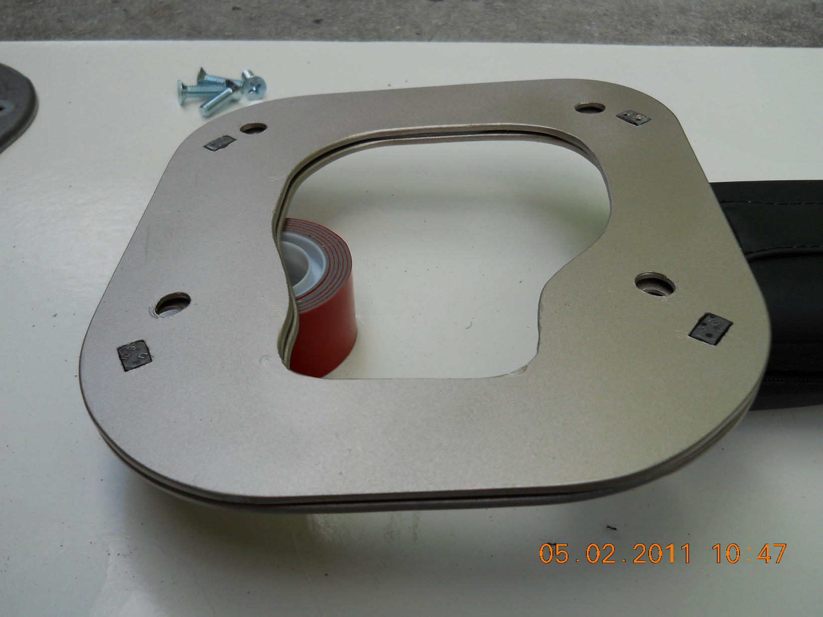

The top plate has the same holes as the bottom plate and it will sit on top of the bottom plate. Its job is to keep the studs from pulling thru the plate. I used 3M double side tape to keep both plates together, this will keep dust & water from getting in between both plates.

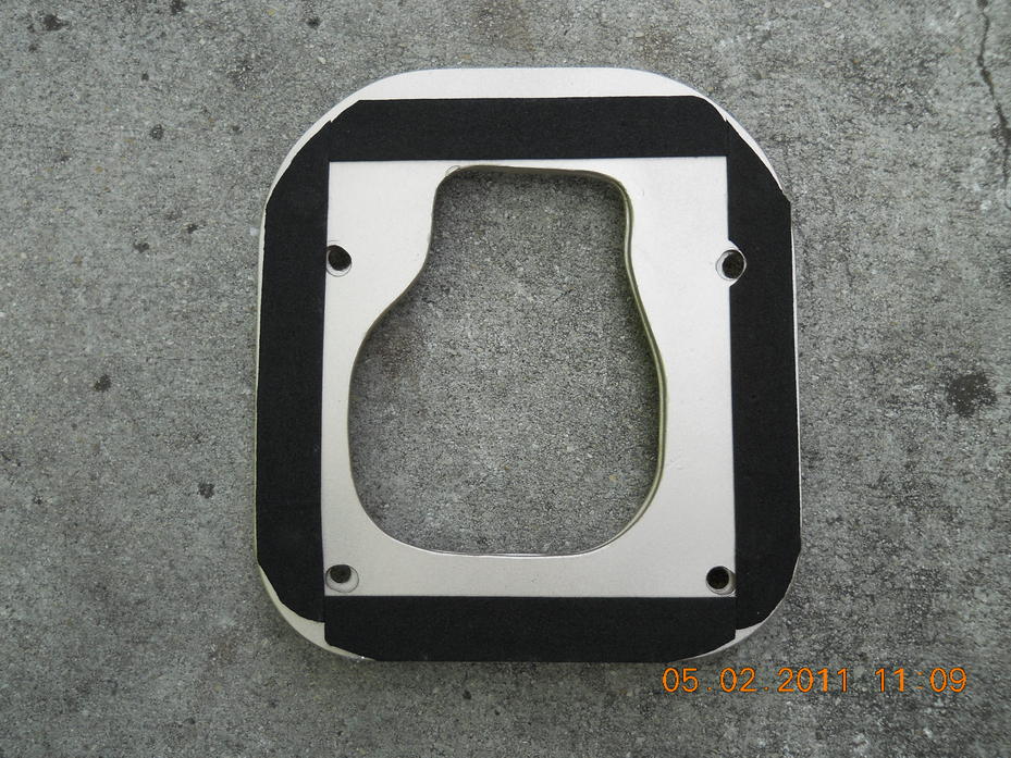

I put foam tape at the bottom side of the bottom plate to keep dirt out of the cab, you can get this at your local home depot.

Awesome stuff man. Its gonna be cool to see the finished product. You must have experience with sheet metal huh? Based on that chain drilling

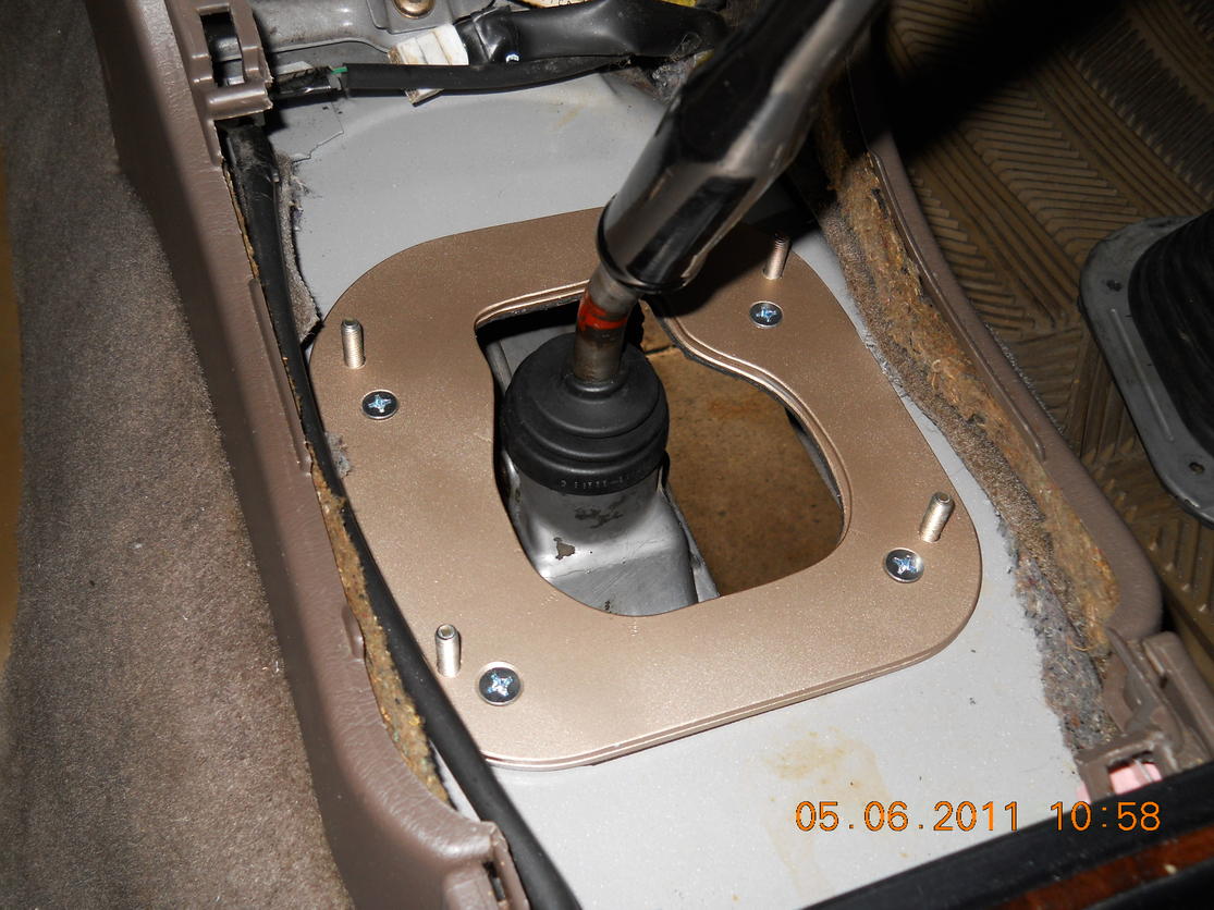

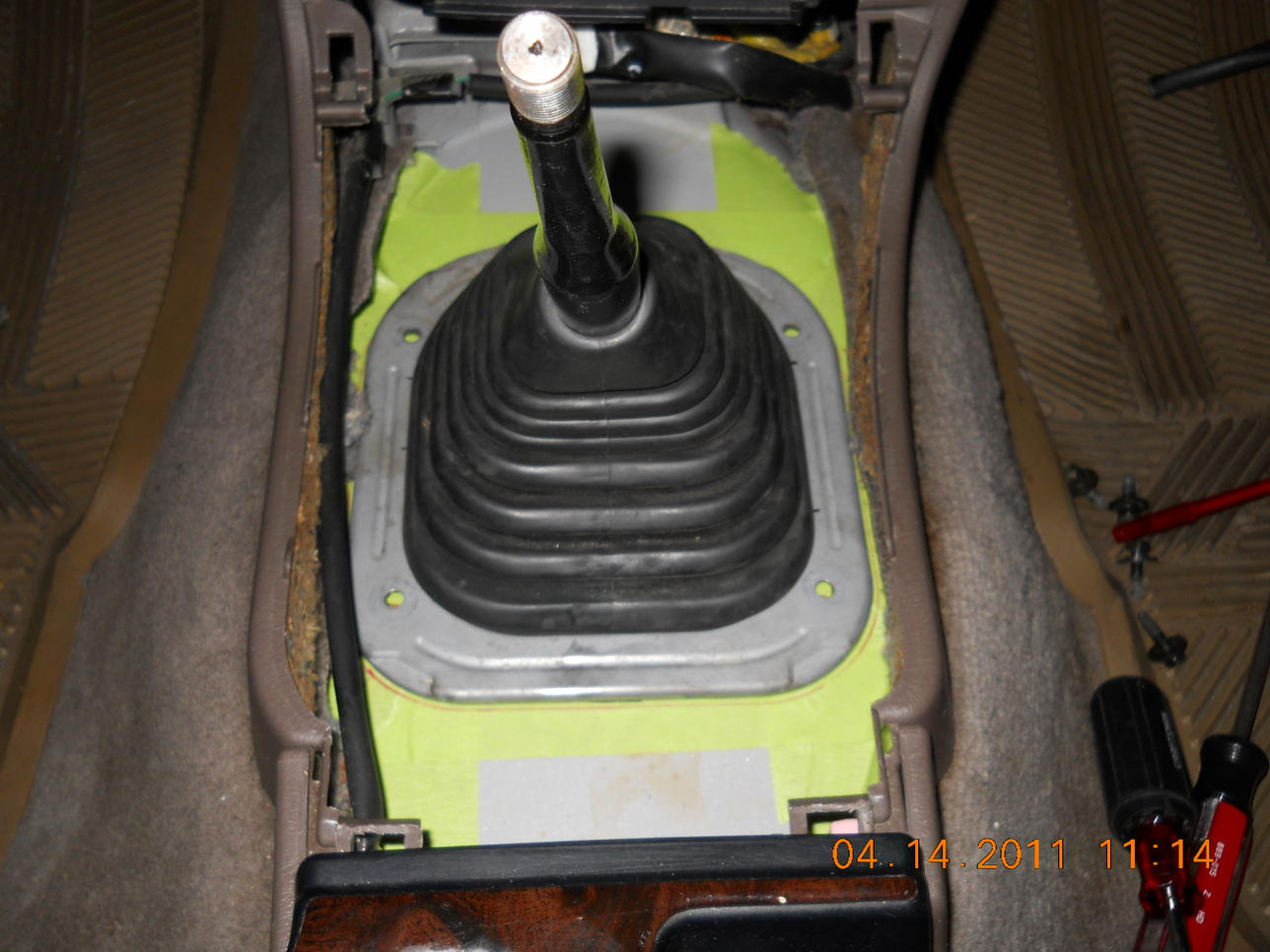

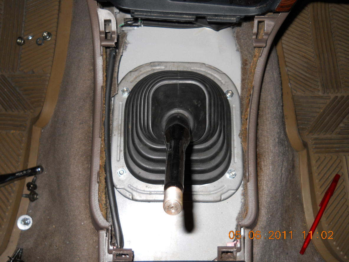

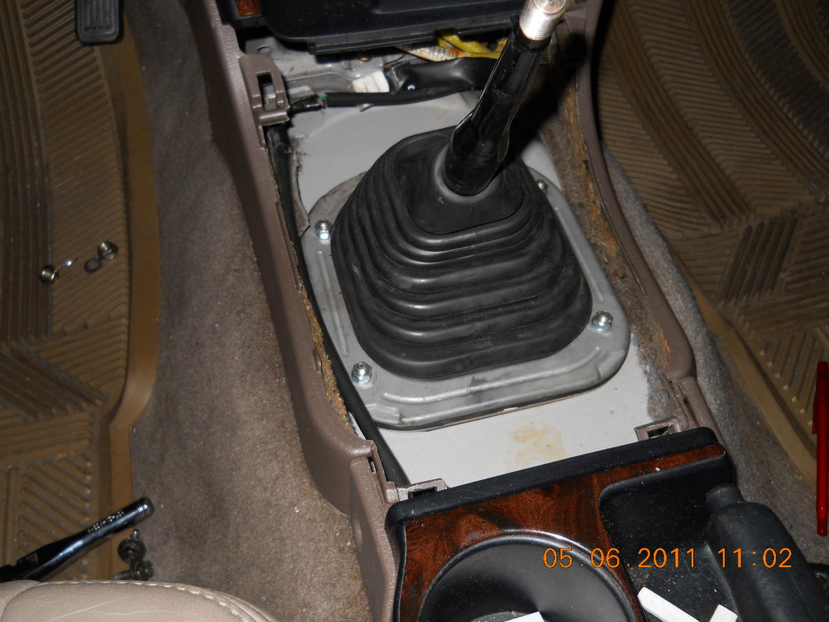

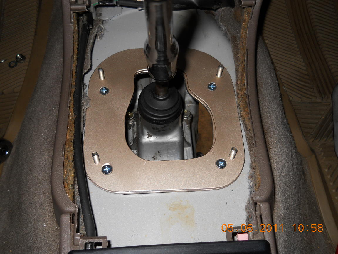

Here is the shifter adapter plate installed on the vehicle. I used 4ea countersunk M6-1.0 x 20mm screws from my local home depot. I found these in the hardware section. You have to countersink the holes on the top plate so the countersink screws will sit flush when you tighten the screws. I used a countersink bit from a friend that works in aviation. You may find the washers and nuts for the shifter retainer at your local autozone. The shifter, the shifter boot and retainer was part of the package deal when I bought the transmission.
I know... the paint does not match, but that was the closest thing I could find. I used some primer first.!
