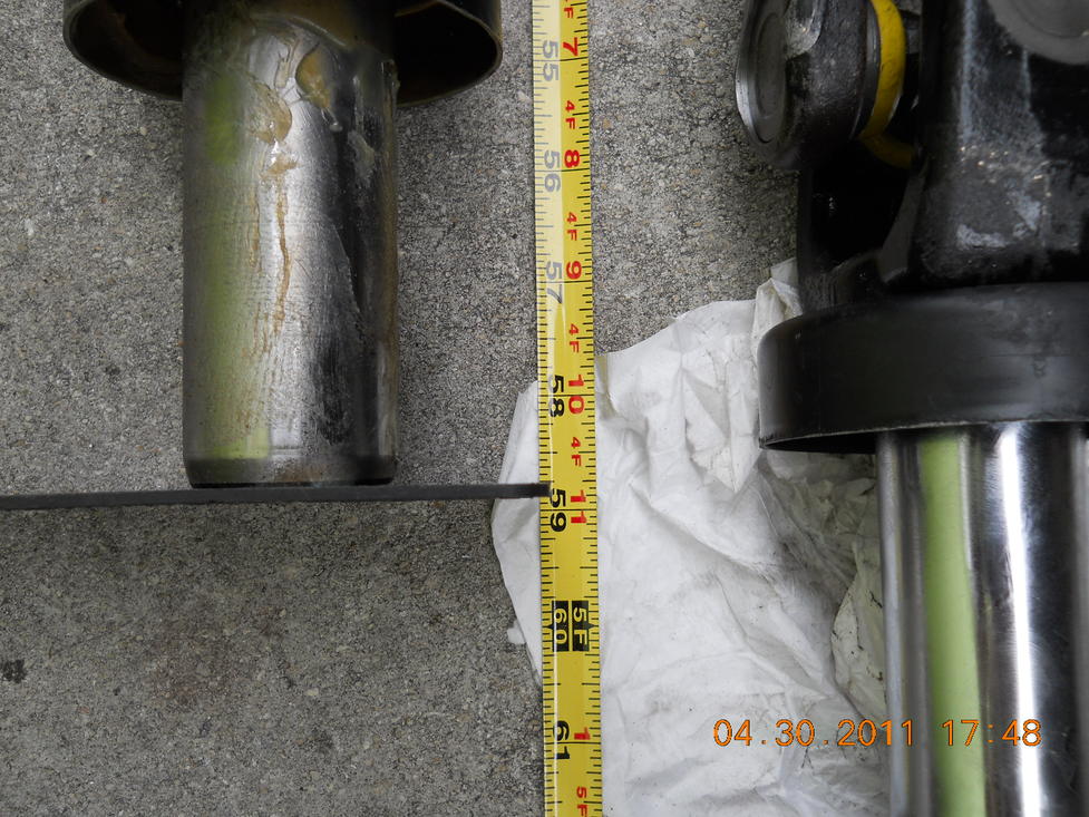

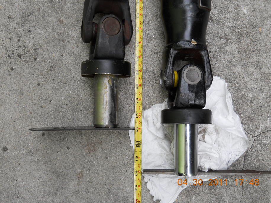

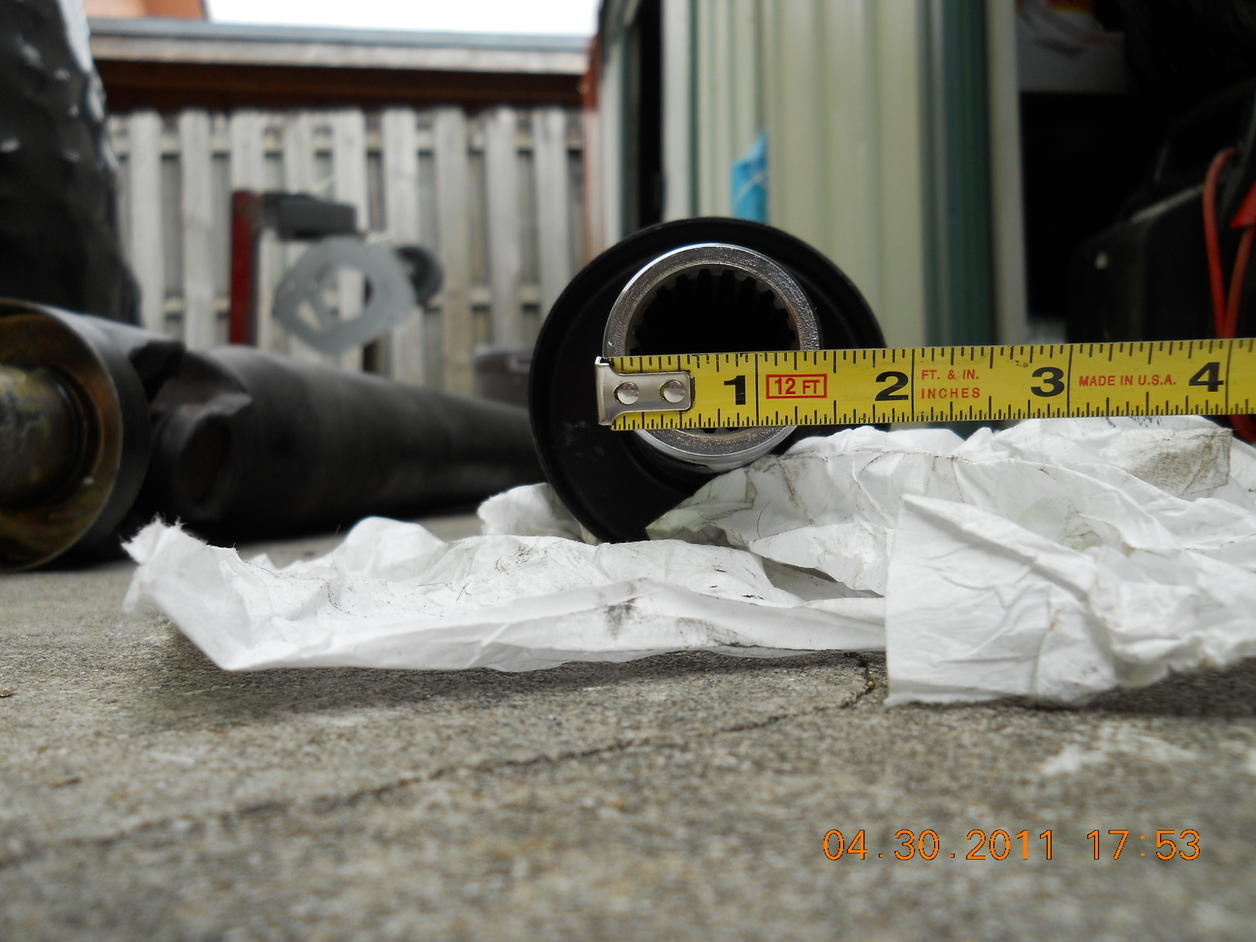

driveshaft installation....

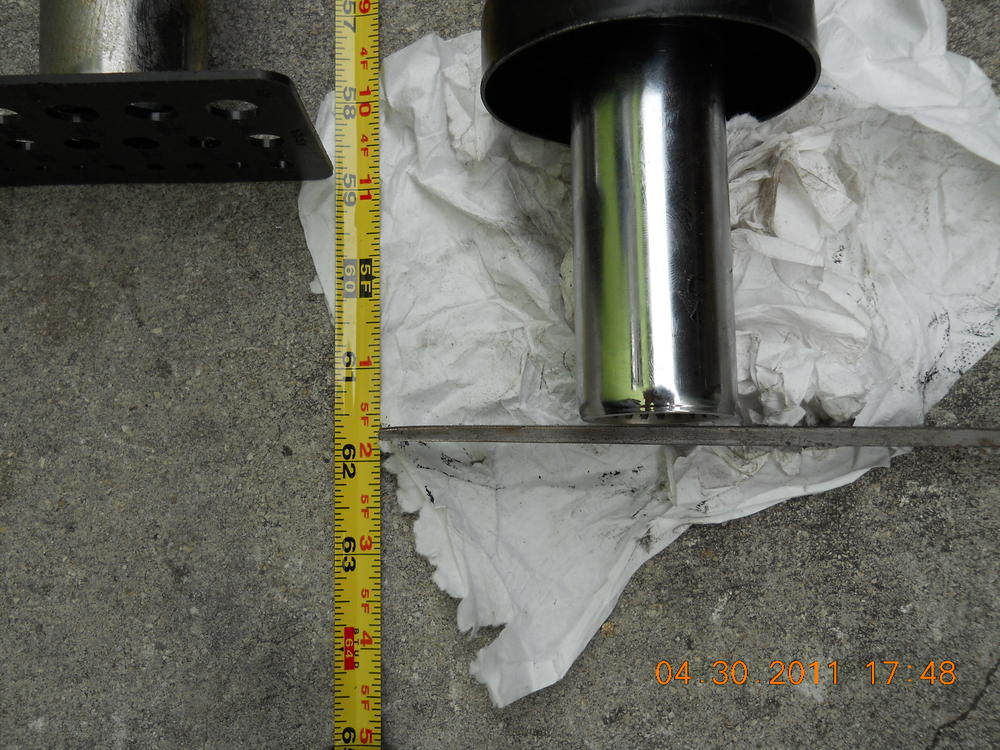

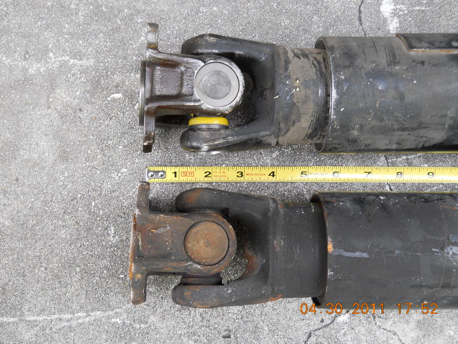

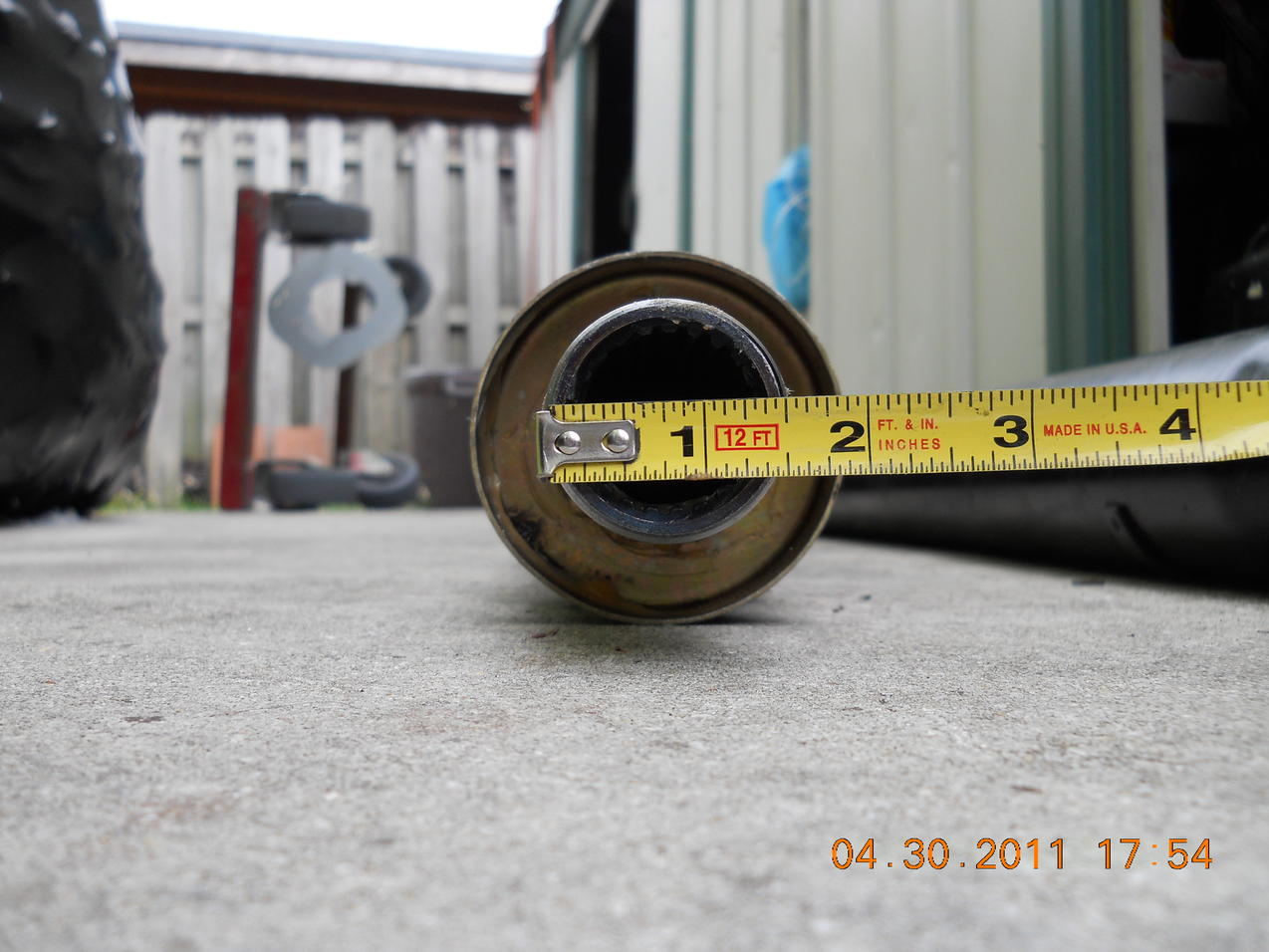

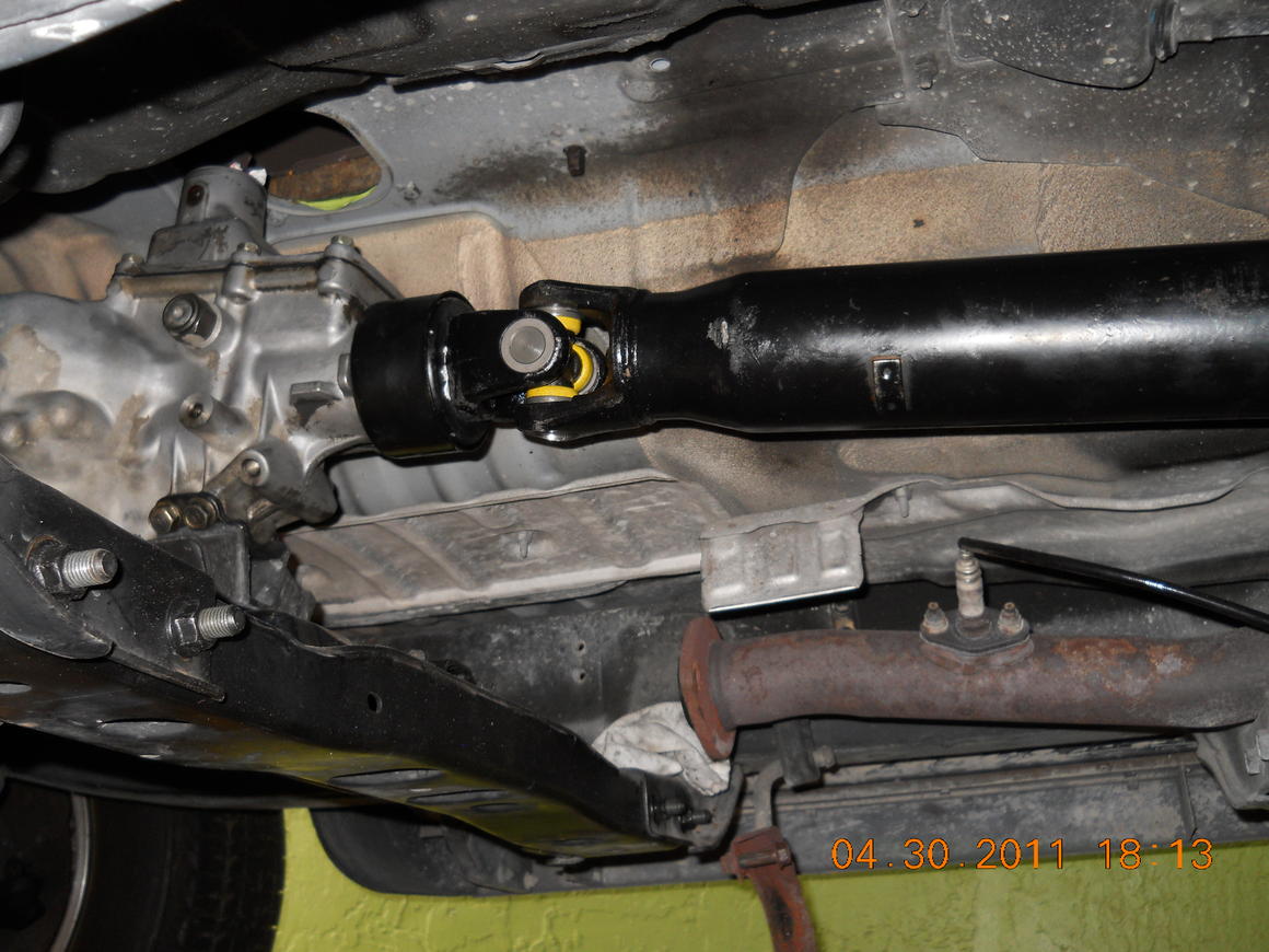

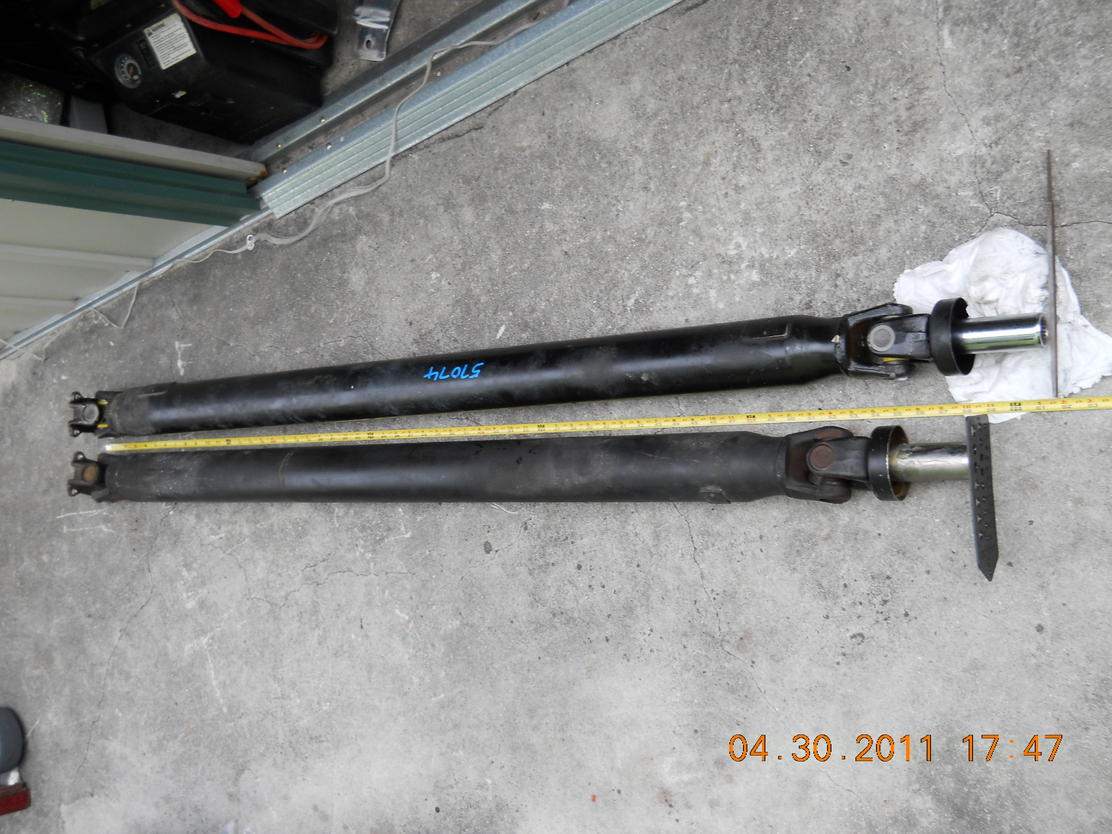

The driveshaft length from the auto tranny. is different from the manual tranny. The auto driveshaft measures 58 3/4" from one end to the other or 52 3/8" not counting the sleeve yoke and the flange yoke. The manual driveshaft measures 61 5/8" from one end to the other or 55 1/8" I paid $100.00 for mine. The sleeve yoke on the auto tranny is wider in diameter than the auto; the auto being: 1.582" and the manual: 1.493" Take into consideration the rechroming of the sleeve yoke. I had to take it to a chrome plating shop since it was bleeding rust, I didn't want to risk the output seal going bad because of the rust. I had taken pictures of the sleeve yoke before the chrome plating but lost them along with a bunch of pictures I had set up for uploading later on. The shop charged me $30.00 for chrome plating it versus $106.00 plus S/H from the stealership. Here is the P/N for the sleeve yoke just in case you need to buy it: 37302-35030 I also replaced both front & rear u-joints. The front one was binding so I purchased both. I bought these from my local autozone for $19.25 ea lifetime warranty! If you prefer the genuine part, here is the p/n: 04371-30040 It costs around $70 bucks. A word of advise when replacing he u-joints.... clean the holes where the bearings go real well with scotch brite before installing, it'll make your life easier... don't oversize it just clean it. The hardware to install the rear portion of the driveshaft is the same as the auto.

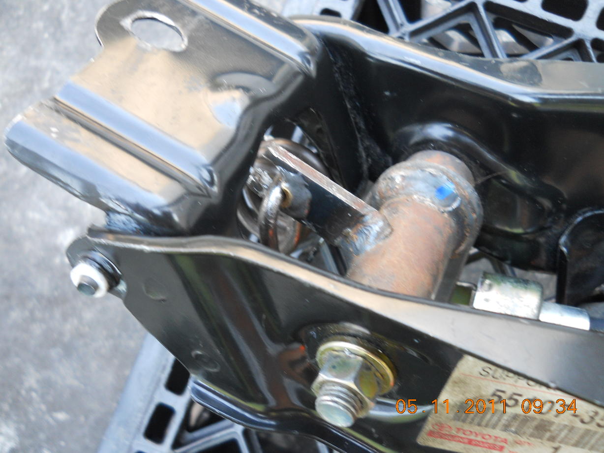

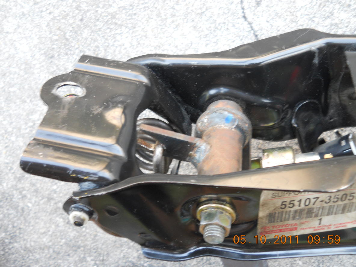

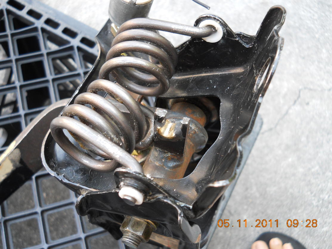

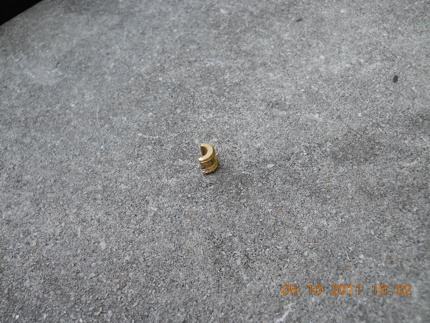

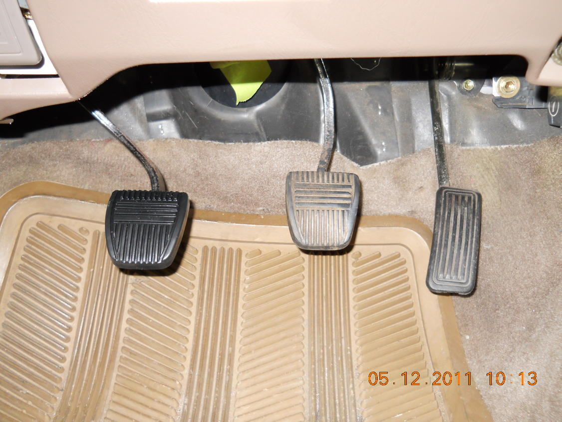

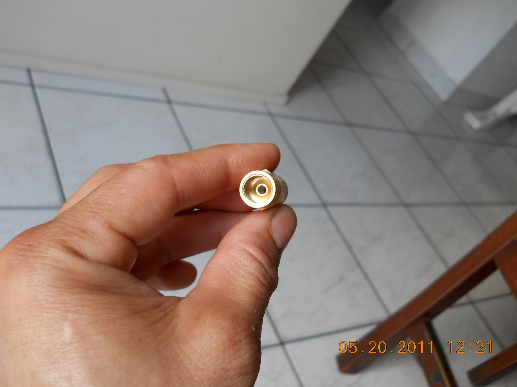

clutch pedal repair....

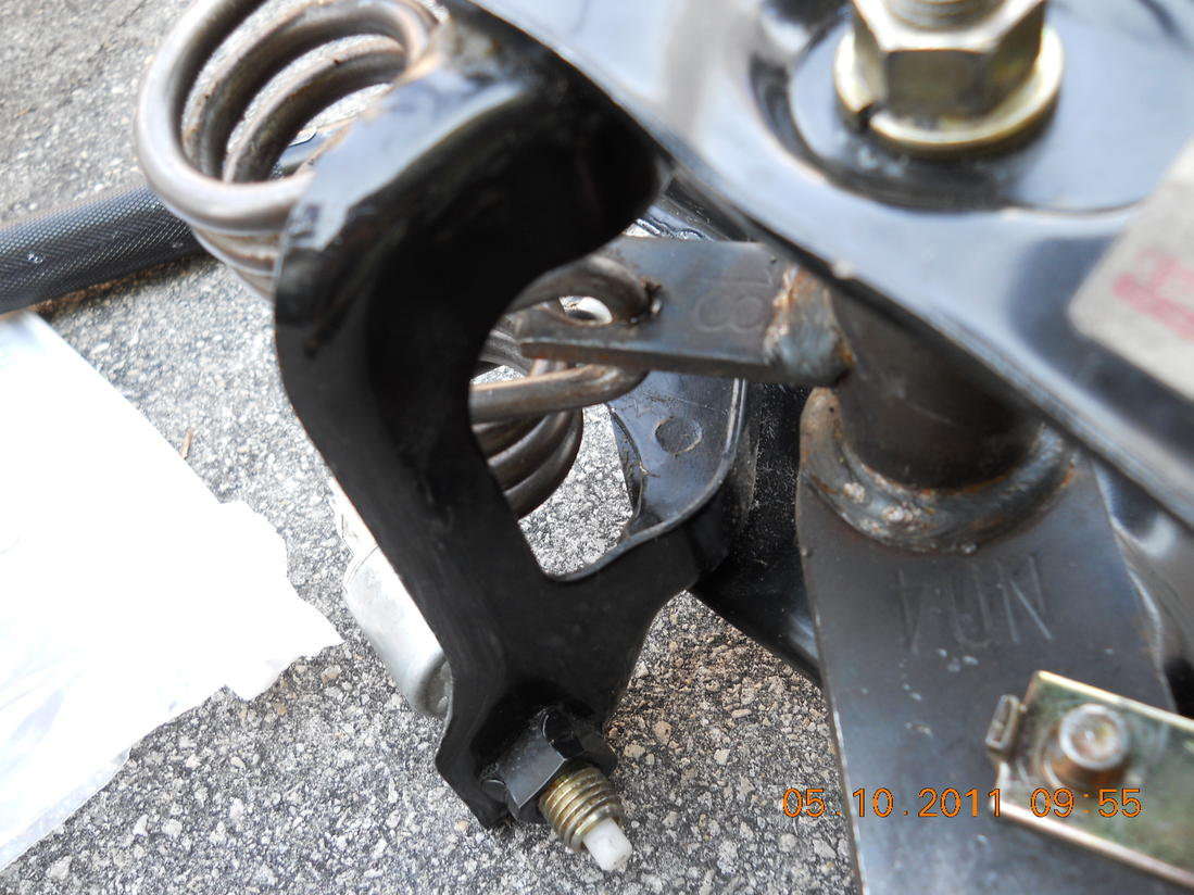

As you may all know about this issue with the tacomas and 4runners, the clutch pedal center spring bushing wears out and starts to wear out the area where the spring rests. Mine was not an exception so I decided to do as many of you guys out there may have done. I grabbed a pipe plug made out of brass and drilled a hole in the center. Then I cut it in half to make a half moon bushing out of it and shaped it. (You can find male pipe plugs at your local home depot) Sorry, I'm not providing pictures and p/n's when I was making the bushing, like I said before I lost all my pictures. I removed the spring (you may have a hard time putting it back since it has a lot of tension, but it's not impossible) and placed it where the original plastic bushing used to be. I put a little bit of JB weld to keep it in place and let if dry for a whole day. You can see the tremendous amound of wear that the spring caused on the pedal.

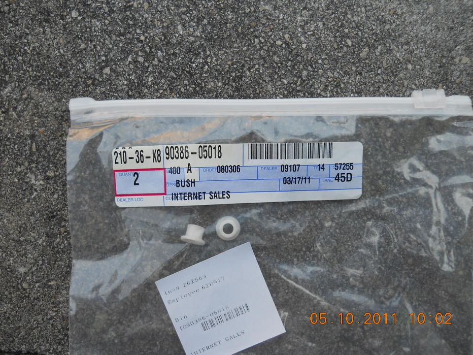

clutch pedal center spring side bushings...
I also replaced the center spring side bushings, they were not too bad, but decided to replace them since I was fixing the problem with the center spring. The p/n for the side bushing is: 90386-05018 and you're going to need 2ea. and my price was $1.68 ea

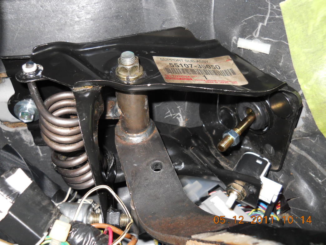

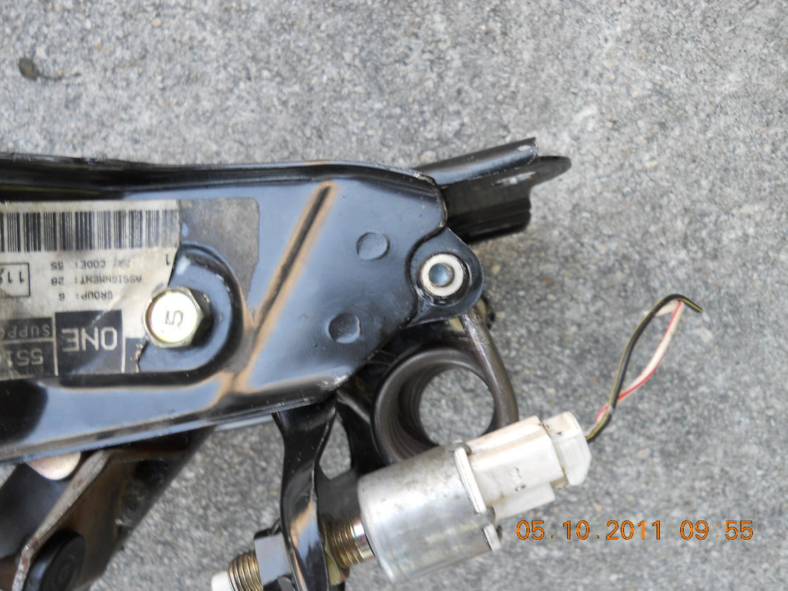

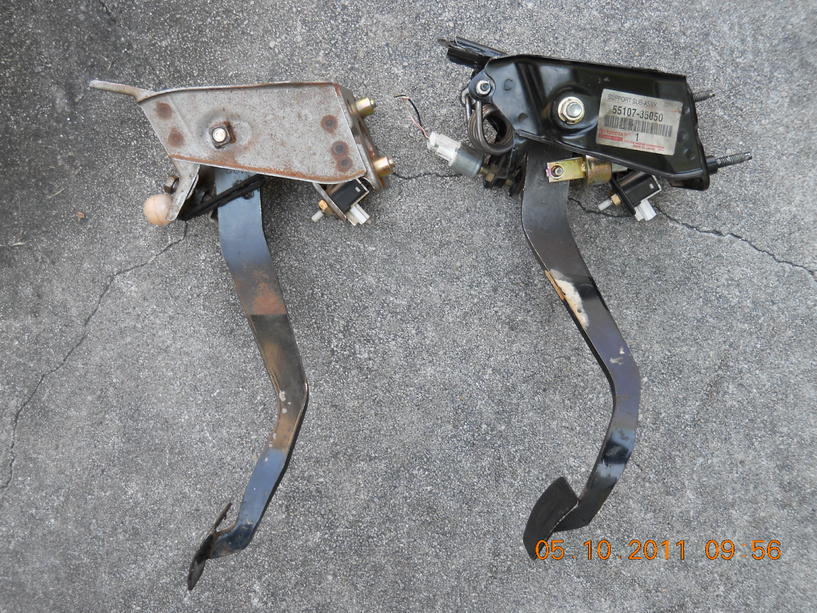

clutch pedal assy. installation....

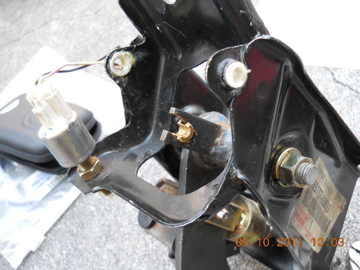

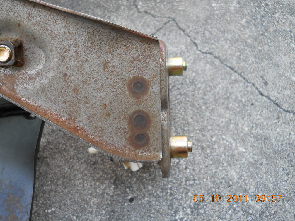

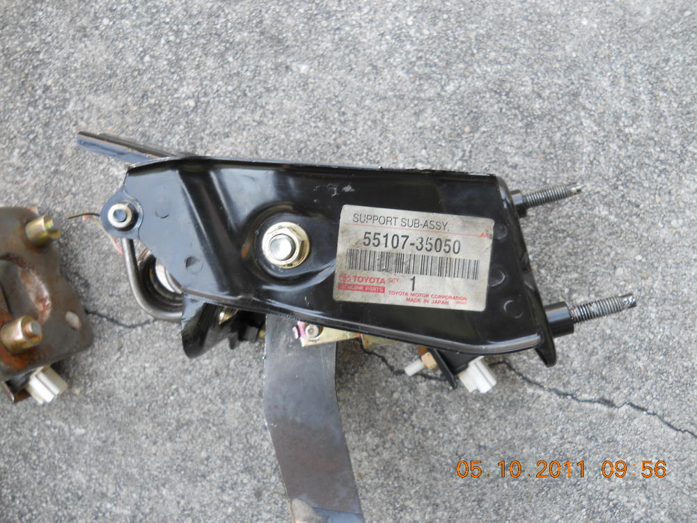

Ok... I paid $50 dollars for my clutch pedal and bracket assy. The p/n for the bracket is: 55107-35050 and the dealer calls it "SUPPORT SUB-ASSY, CLUTCH PEDAL" The pedal and the rest of the parts that makes the assembly come separate so it's better to get it from a junk yard. I had another clutch pedal that wasn't exactly for my 4runner, so I cut the studs to see where I could drill the holes for the clutch master cylinder. This would give me an idea more or less where I needed to drill the pilot holes for the M.C. After aligning the dummy clutch pedal I marked where I needed to drill. I also bought the clutch master cylinder gasket (p/n 31415-10010, $1.02) and used it to mark the holes on the engine bay side. After drilling the mounting holes, noticed that the holes I drilled did not match the ones on the engine bay ...~!@#$%^& :wow2: But that's ok, I used a 1/16 drill bit, so the holes were small and I covered them with JB weld. You want to make sure these holes are pretty much where they're suppose to be so your clutch pedal is straight and not misaligned unless you don't mind. Ohh.. yeah you need to remove that emission canister to gain access.

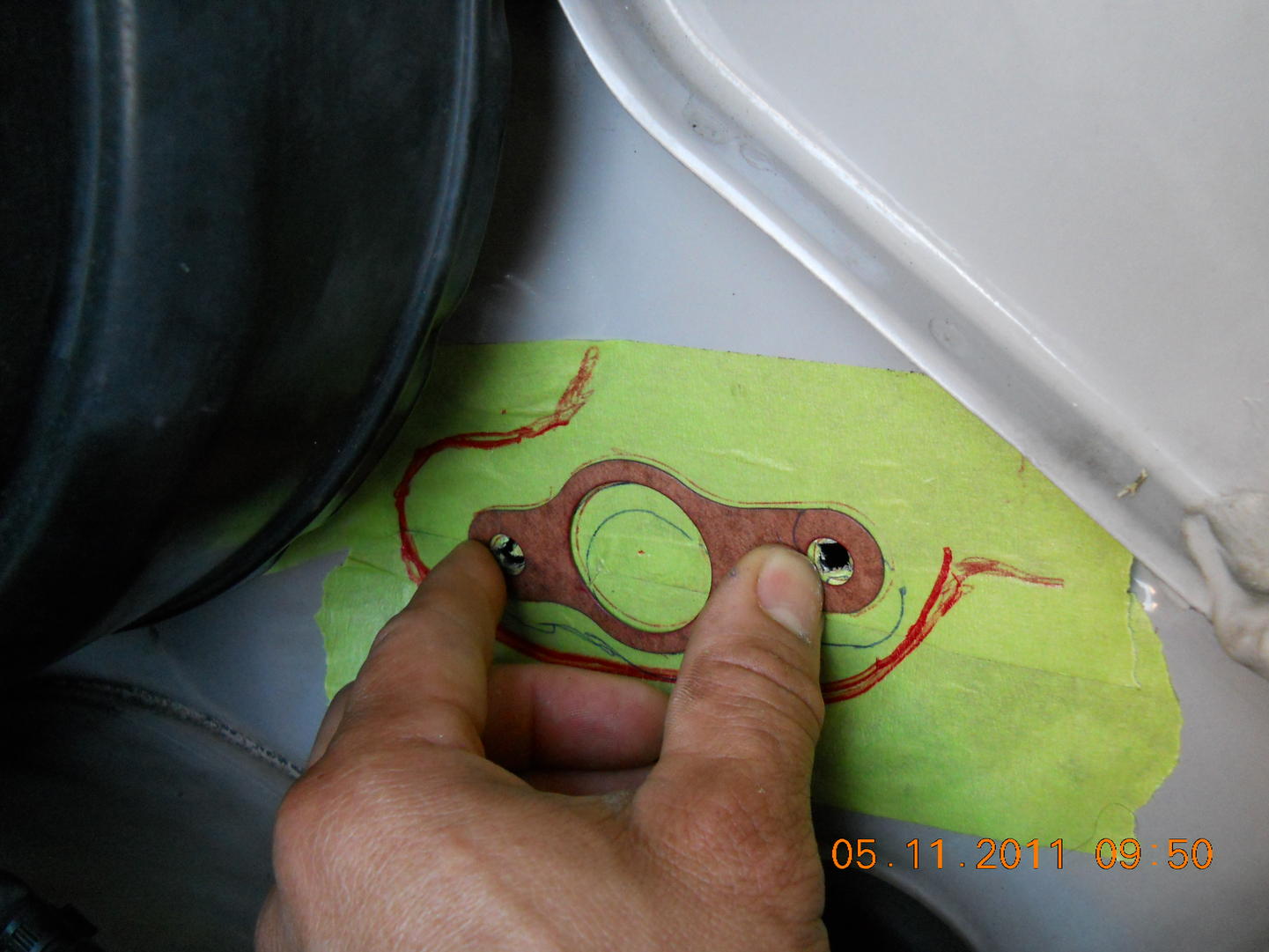

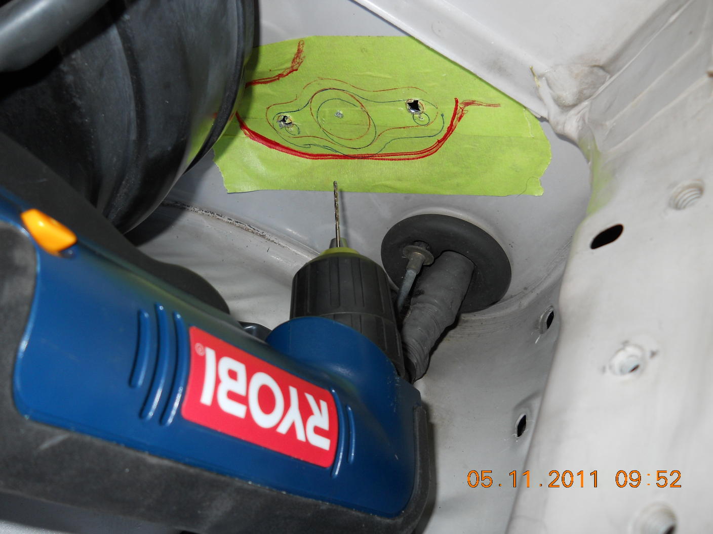

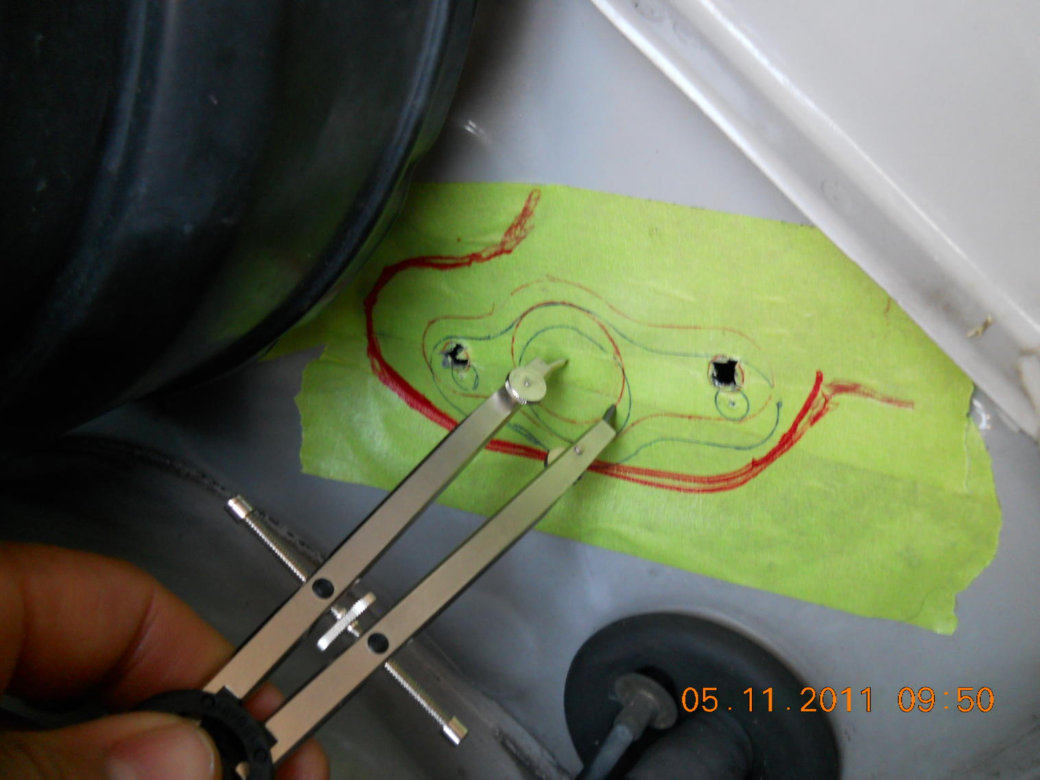

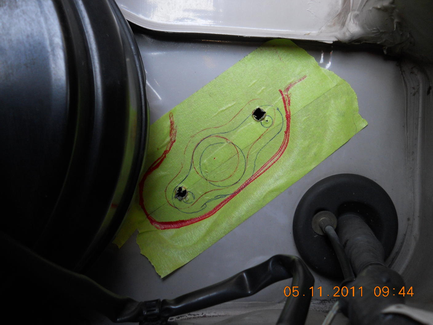

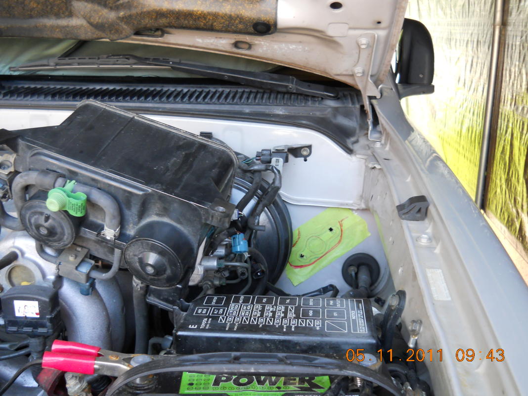

The red heavy marking is the area where the M.C seats. I more or less centered the M.C gasket in that area to drill the pilot holes. You can see in the pictures my first marking with a blue pen. This one, is too far down and too close to the bottom edge. I traced the M.C gasket for a second time with a red pen and removed the pushrod from the clutch master cylinder so that I could align it with the red marking just to verify that the M.C was vertical. It looked good so I went ahead and drilled the mounting holes with a 1/16 drill bit, then I used a 1/8 drill bit. Next, I used a unibit that starts with 1/8 and took it all the way to 5/16" which is the size for the studs on the clutch pedal bracket. I used a unibit since it makes cleaner cuts than a regular drill bit.

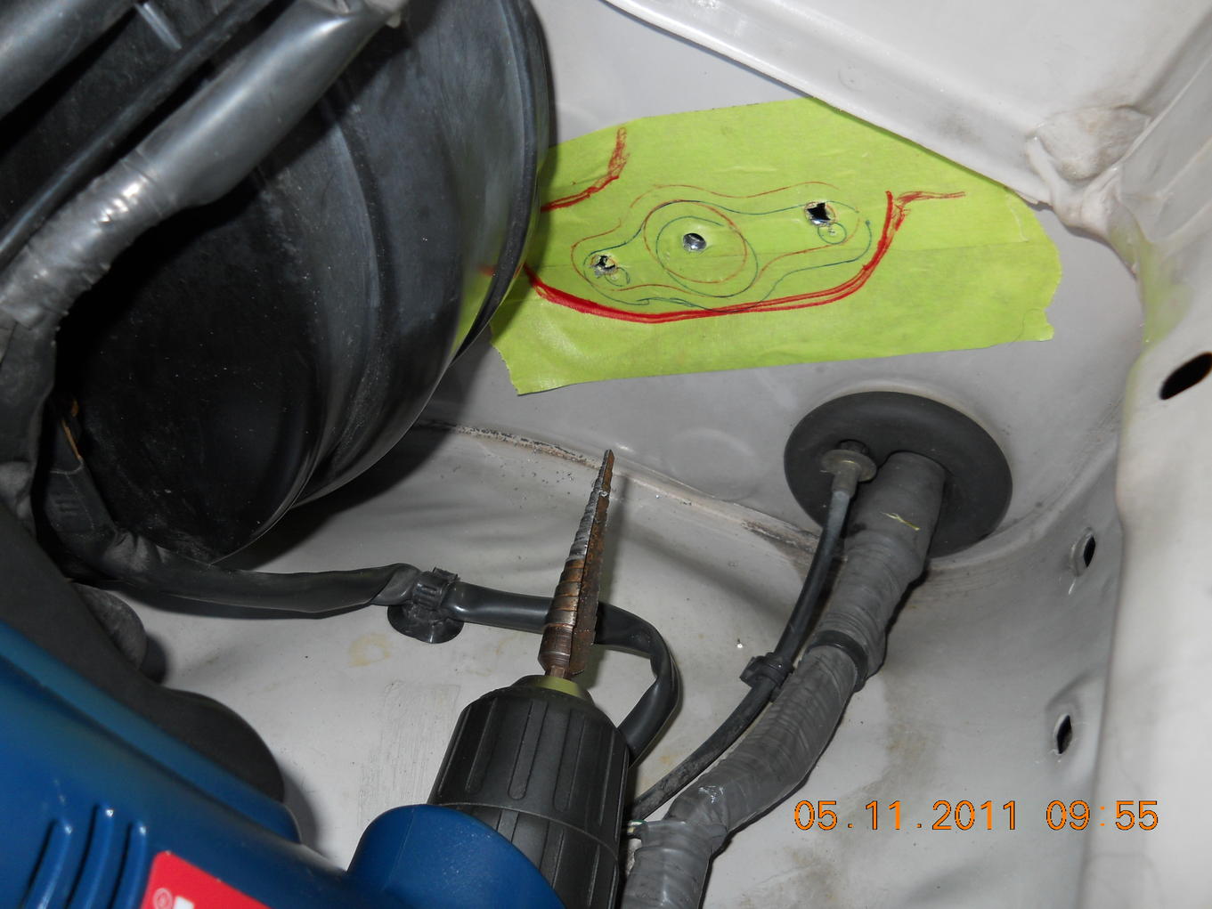

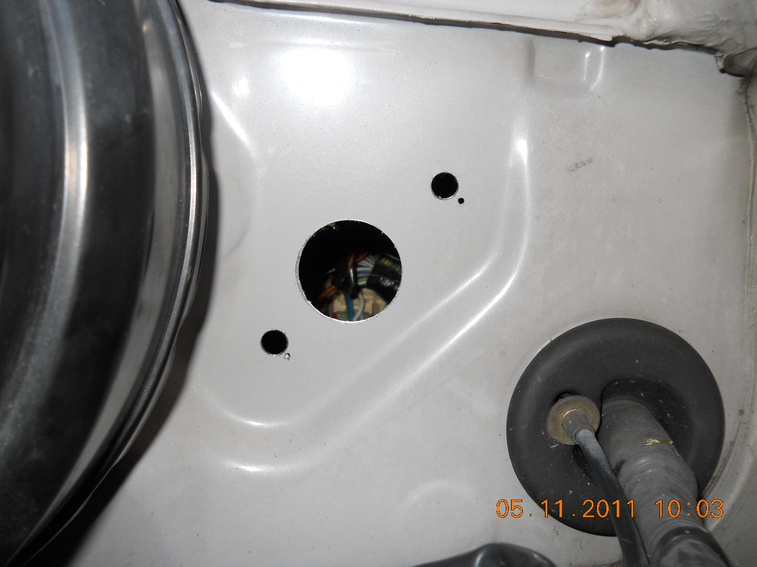

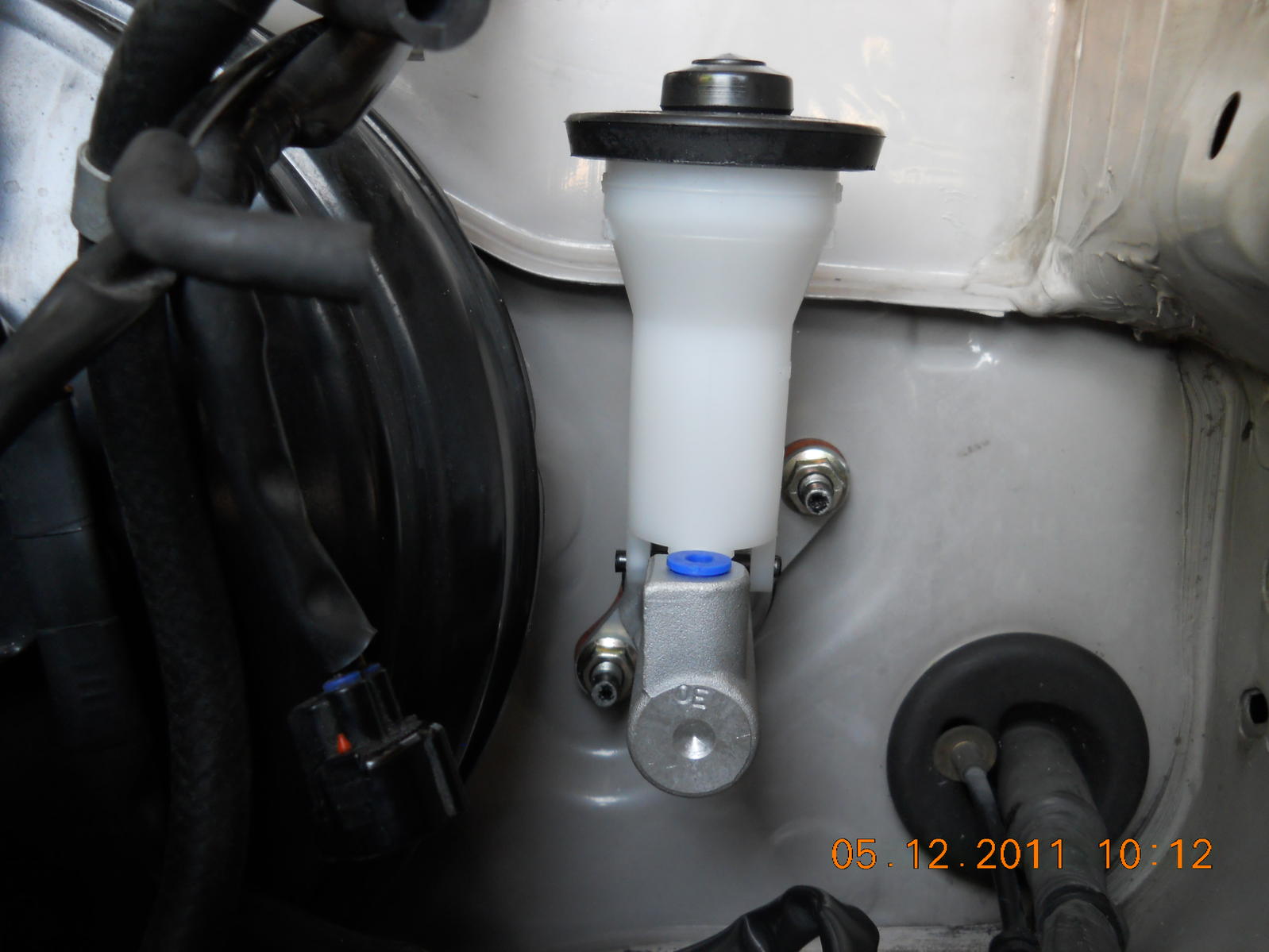

clutch master cylinder installation....

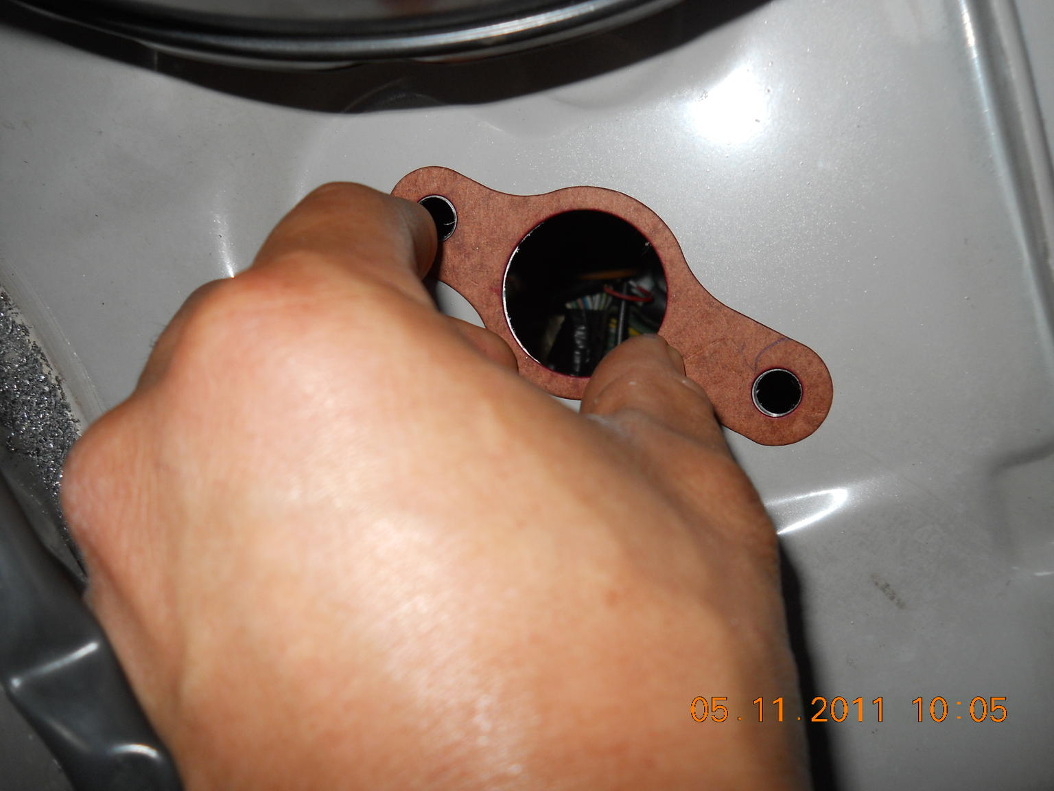

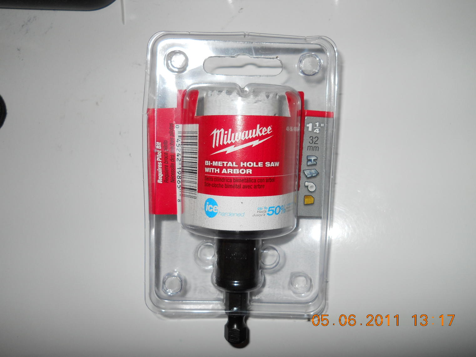

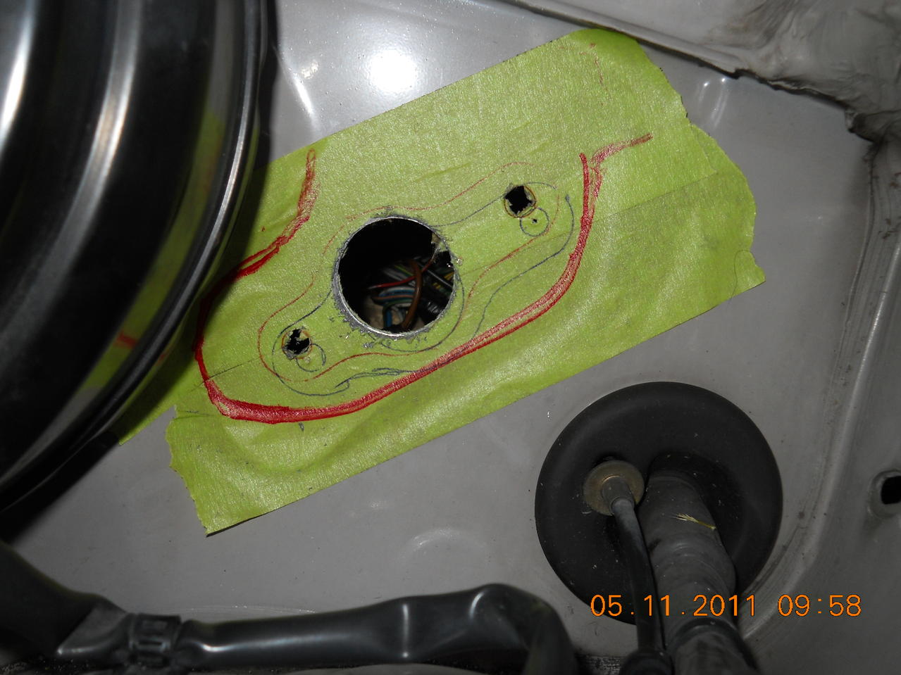

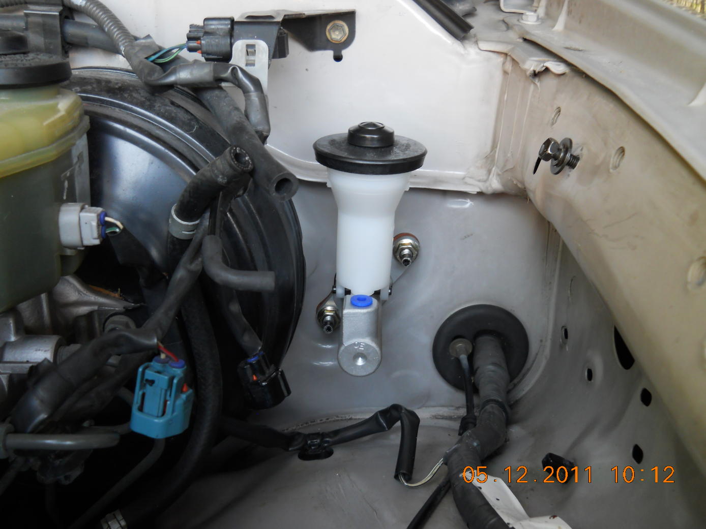

I used a protractor to find the center on the M.C hole. (very important, if not your M.C won't fit thru. the hole) Again, I used a 1/16 drill bit, a 1/8 and then the unibit all the way to 1/4" size hole. Why.??? well the pilot drill bit for the bi-metal hole saw is 1/4", that's why.! As you can see I used a 1 1/4" bi-metal hole saw to cut the center hole for the M.C.; about $11 bucks at my local home depot. Try to go easy and firm on the hole saw, you'll get better results. It took me while to do the holes for the M.C but I'm very satisfied with the results. I got cleaned cut holes and the alignment on the pedal and M.C are perfect.:D I painted the holes to prevent corrosion. I used nuts that I already had from my extra parts bin to secure the M.C but here is the p/n in case you need it: p/n 90179-08052

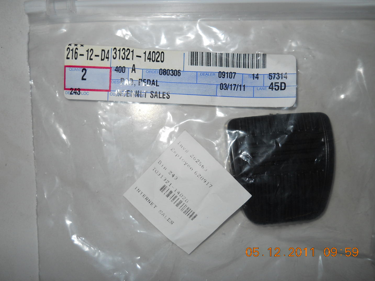

clutch master cylinder installation continue...
You can see in the above picture the very first holes that I drilled, they were in the wrong spot but that's why I used a small drill bit. I also replaced the clutch pedal pad, mine was worn. The p/n is: 31321-14020 and $2.73. The M.C gasket p/n: 31415-10010 $1.02 Hmm.... I think I already posted these numbers but just in case.....

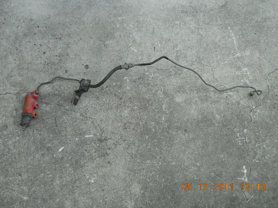

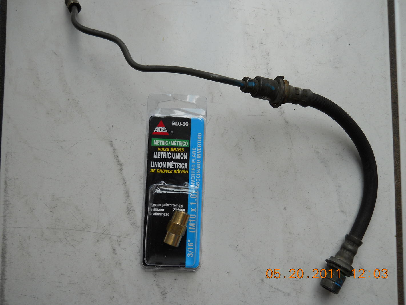

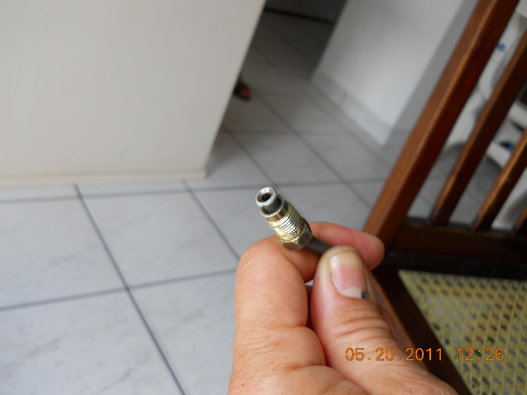

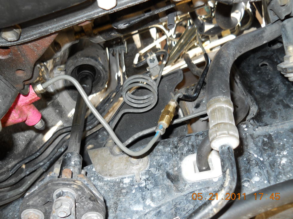

M.C hydraulic line...
I bought the M.C at my local advance autoparts for $39.05. The hyd.lines were included with my transmission. I did not use the flex hose nor the bracket. The hyd. lines had so many bends that I didn't know the exact routing so I bought a union (p/n BLU-9C Inverted flare fitting for a 3/16 line M10x1.0) for $1.49 at my local auto zone to connect the upper & lower hyd.lines, just had to reshape it a little bit and worked fine. I'm working on a bracket to support it againts the chassis. I also bought the upper bolt with washer from the dealer to install the clutch pedal bracket, it was too cheap not to buy it so I ordered it... p/n is: 90119-08079 for 0.47 cents.! The washer comes with bolt. The slave cylinder came with the tranny, too. When bleeding the slave, I pushed the rod in and held it there while bleeding it. I placed a screwdriver between the slave cyl. rod and the clutch fork to hold the rod it in. This made the bleeding process a lot easier.!

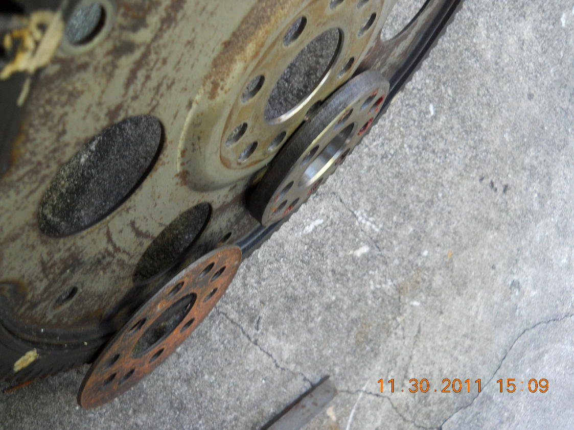

Ok, a couple of days ago, I tried to crank the engine, but the starter spins but does not engage, so today I got under the truck and disconneted the wire from the ignition and used a jumper to crank it. I could hear the plunger come out and spin. I removed the starter and kind of measure how far the flywheel is from the starter flange. According to my measurement, the starter gear won't reach the flywheel teeth. I got the vin number from the donor vehicle and is a 98 tacoma 4x4 with a 3rz-fe. I checked the p/n's from a toyota website and the p/n from 2wd 4runner with manual transmission and the donor are identical.!!! The starter p/n from the auto and manual tranny 4runner are identical, too. ~!@#$%^&* I ran out of time today, so I'll go to my local auto zone sometime this week and see if they have a flywheel for a 2000 4runner and compare it to mine. I checked the reverse lights and they work, so that part is good.

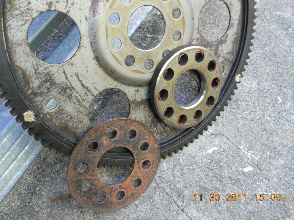

issue resolved
Ok, I found out what the problem was with the starter. As soon as I removed the lower transmission cover I saw the problem. I failed to remove the spacer for the pressure plate. (see picture) I removed the tranny the clutch and removed the spacer. I already put everything back, I'll try to crank it tomorrow...
