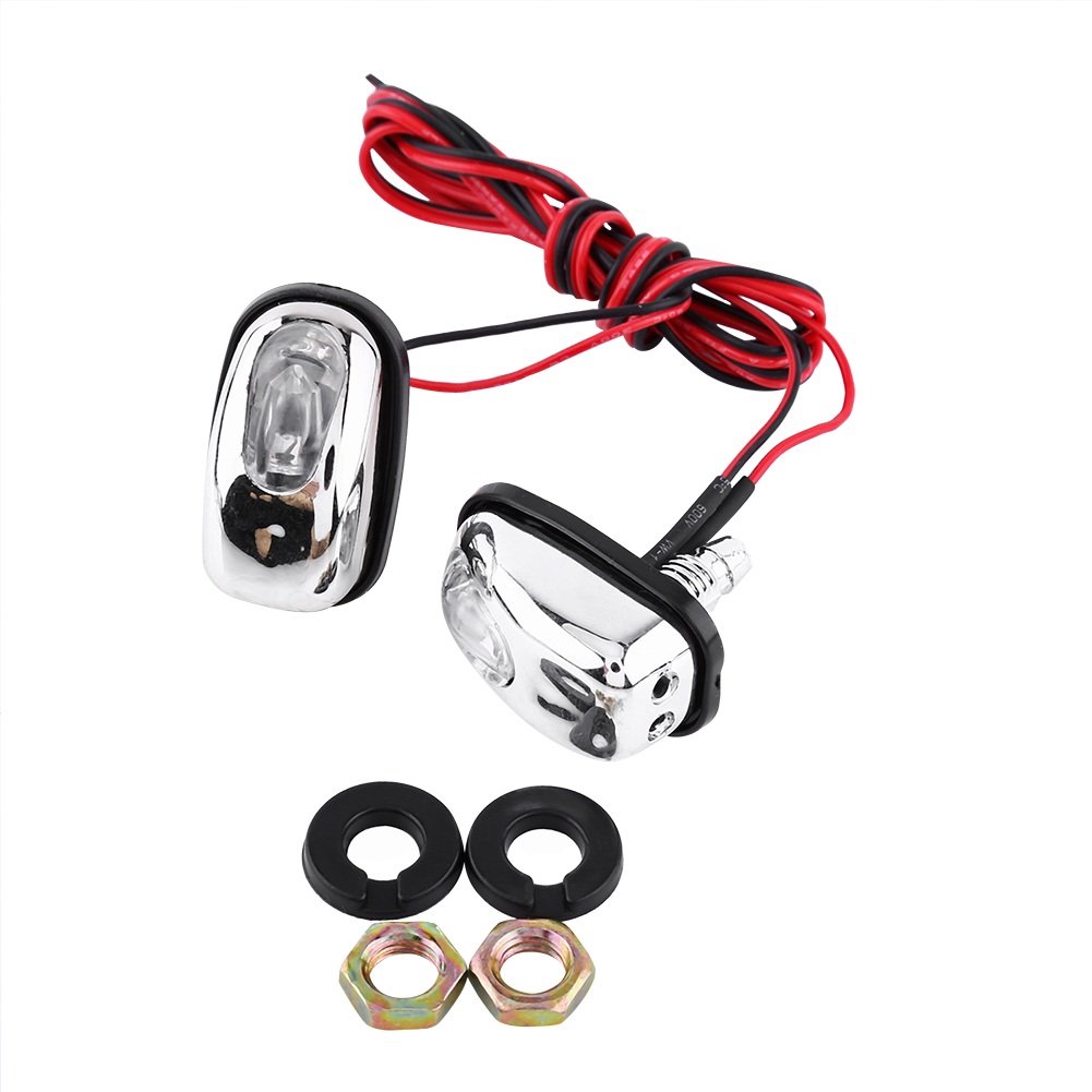

just bought a hood from pick'n-pull today and discovered it has the sprayers with led's on the front, I had no idea those existed. I also had no idea there 3 nozzle sprayers!! mind blown today
wait what? they make ones with LED! no way. I feel so empty inside now. so like when you hit the wash me it lights up and sprays at the same time? the future is now!
im not 100% sure but I dont think so. I think you can wire them up to turn on when you turn your headlights on...the lights face forward.
I don't know if the Rav4 ones are just like the ones for the 4th Gen 4runner but take a push pin to angle then streams for maximum coverage....
