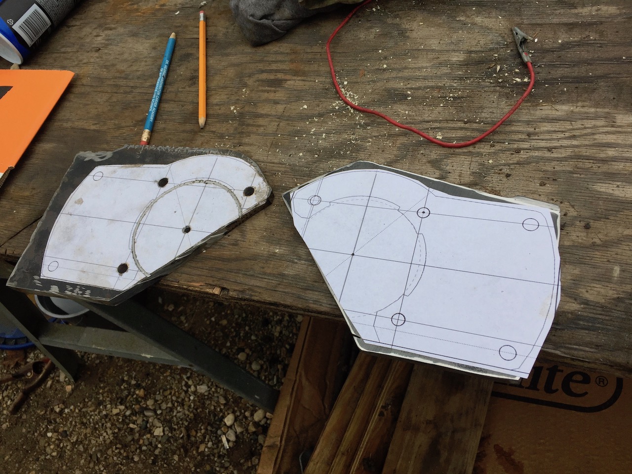

I am finally getting around to making my adapter brackets.The bolt holes that align with the axle flange are easy. As you can see, I have two of the axle flange bolts and one of the caliper attachment bolts in the same line like you do. Would you care to share the dimensions for the caliper mounting hole placement?
I am also trying something that is new for me. I found that I could make the drawings for the parts in the free, open source drawing program called Inkscape (it's like Adobe Illustrator). I could draw the part to the dimensions I wanted and get those dimensions to print to paper with a pretty good amount of precision. Then I just cut what I need from paper and use spray adhesive to stick it on the metal. I check the work with a caliper as I'm going along, but so far the paper is a real help in doing the layout for the machining work that is involved, which amounts to drilling six holes, including one hole drilled with a holesaw to four inches in diameter.
By the way, I got a fantastic deal on the steel. I picked up about 4 square feet of the 3/8 eighths inch steel for four dollars at my wonderful local recycling center, where they recycle in industrial and agricultural equipment and machines. The place is a veritable goldmine for a guy like me.

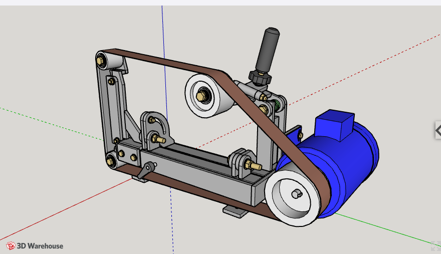

One thing I notice with every new project I undertake is the vast universe of tools I could've used to make my work easier. Since you work with Sketchup I will leave you with some links about a 2 x 72 belt grinder that would be helpful in such endeavors. It is a project that can be built from plans that I think would be a lot of fun.
belt grinder sketchup file download page
The authors build video:https://youtu.be/a_RlL1O-bK4
The author's Etsy page where plans for the grinder can be purchased.
