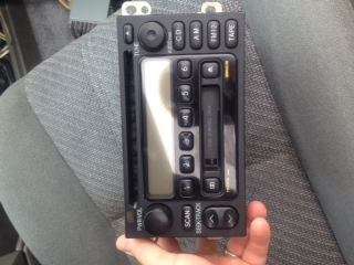

that looks like my exact radio from my 2000 4runner!

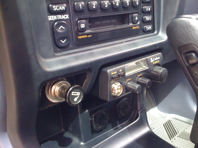

I know, not the best picture, it was taken to show my CB radio location for another thread, but again looks to be the same radio! If it fits in a 1st gen, Id bet the wiring harness is the same for a 2nd Gen, you shouldn't have any trouble

by the way Joel, that is a nice fit in a 1st Gen! looks great! I like the fact is has the tape AND CD, it almost looks stock, like it was just an expensive option for a 1988 4runner!! LOL
it's from my wife's 2000 4runner. i put an alpine with ipod control in her's a few years ago. i had just gotten my 88 and the stock single din am/fm radio didn't work. so, i removed the radio and pocket and put her radio in. i just had to include the factory amp.

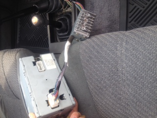

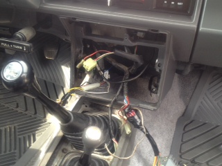

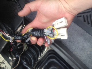

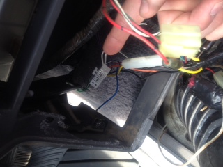

I am having trouble with the install of a dual head unit from a 2000 4runner in my 88. I saw your post that you had to only "plug-n-play". I didn't have the same experience, probably because the PO had installed a Clarion CD player and spliced the original harness. From what I can tell, the original male radio harness was still intact, so I plugged the two male ends into the amp, and then the one amp plug into the back of the dual head unit. Is this how you did it as well? Any additional info would be helpful. It seems that most people upgrade to an aftermarket radio and not a OE replacemant, especially after they already have an aftermarket. I've searched all over the net for answers and am stumped. Thank you.

I also forgot to mention that I do get reverb through the speakers when I have the amp attched to the harness and the head unit attached to the amp. Might I have a bad amp? Should I try and pull an original harness from another 1st gen? Does anyone sell aftermarket OE replacements?

Matt,
I believe you are correct... Two plugs from the factory wiring to the amp and then a single connection from the amp to the head unit.

Do you know if the head unit and amp are good? Working correctly before you got it?
Joel
You might want to disassemble / remove the tape from your wiring bundle and check the connections. Also verify your ground is solid - the back wire.
