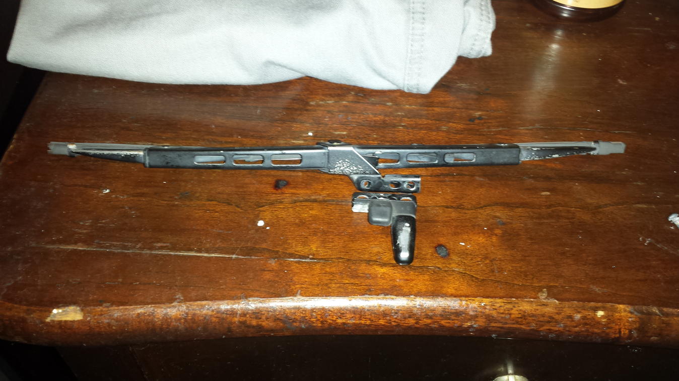

So I fixed it :whoo: After changing the bulbs, testing the wires and no results other than they weren't working and somehow the dash lights went out. I said the hell with it and changed my 10A fuse that's supposed to be for the tail lights. But instead there's a 20A fuse that is there. And is the only one that works for it. IDK what's up guys. My truck is really strange. Even had trouble finding a rear wiper blade replacement for it. I went to the dealership yesterday and ordered what I needed.
Tail lights
