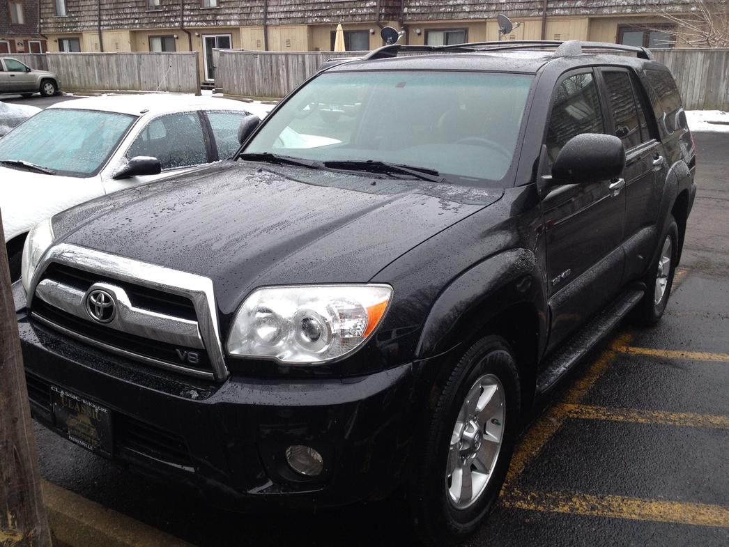

Thanks for the replies. I will start with the plug wires and go from there. It reads the cylinder 4 misfire on the code reader. Sometimes random cylinder misfire. Next time i drive it I'll get the exact codes. It's not daily driven currently. When we started having these problems we got an 07 V8 4runner :lookout:

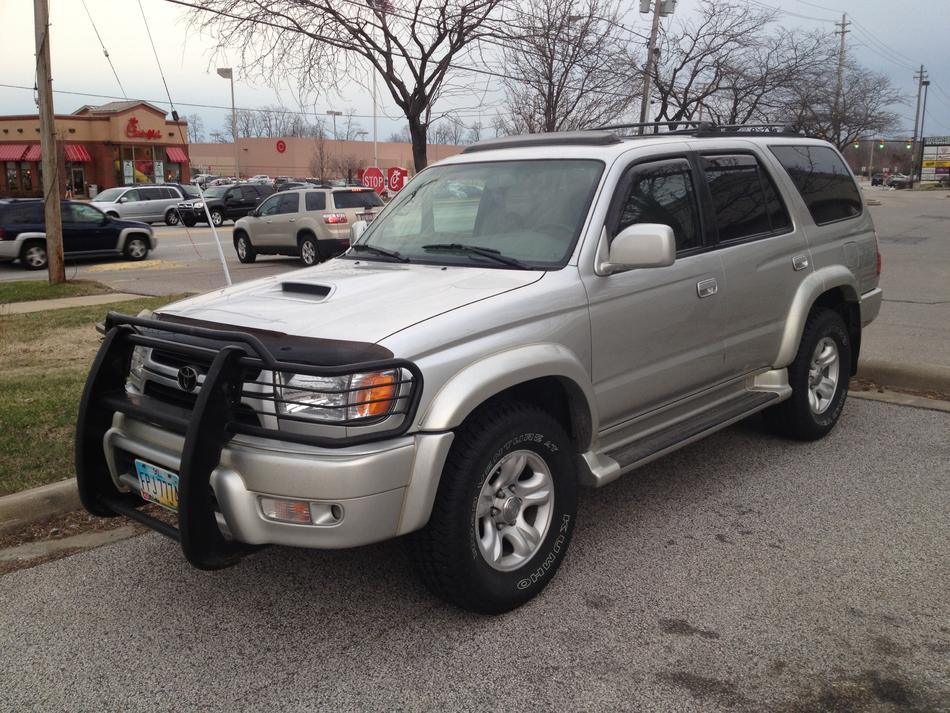

Here is the 01. Cool thing about this pic is if you look hard enough you can see the 07 my gf is driving in the background lol
