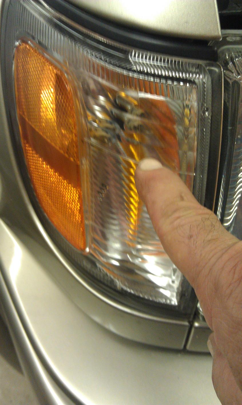

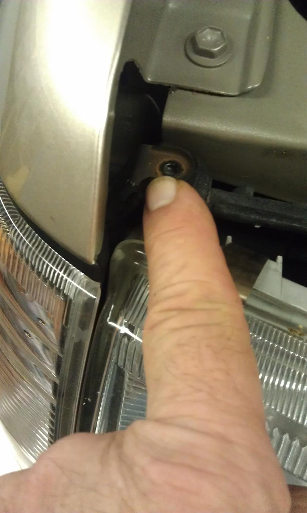

I need to replace one of my front parking / dimmer bulbs and can't figure out how to take the fixture out to get to the socket/bulb .... I see a phillips screw on top but didn't want to force it for fear of braking a tab or something .. Any advise/ guidance would be appreciated ......

Standing in front of the headlight, take out the screw and pull the whole fixture towards you. Dont worry you won't break anything, just pull the entire thing towards you. Once its out its just a twist socket that you twist to the left and it should reveal that 194 bulb to you.
hummmm .. just wanted to be sure I wouldn't break something ....sounds pretty much light the tail light assembly .....
Thanks
