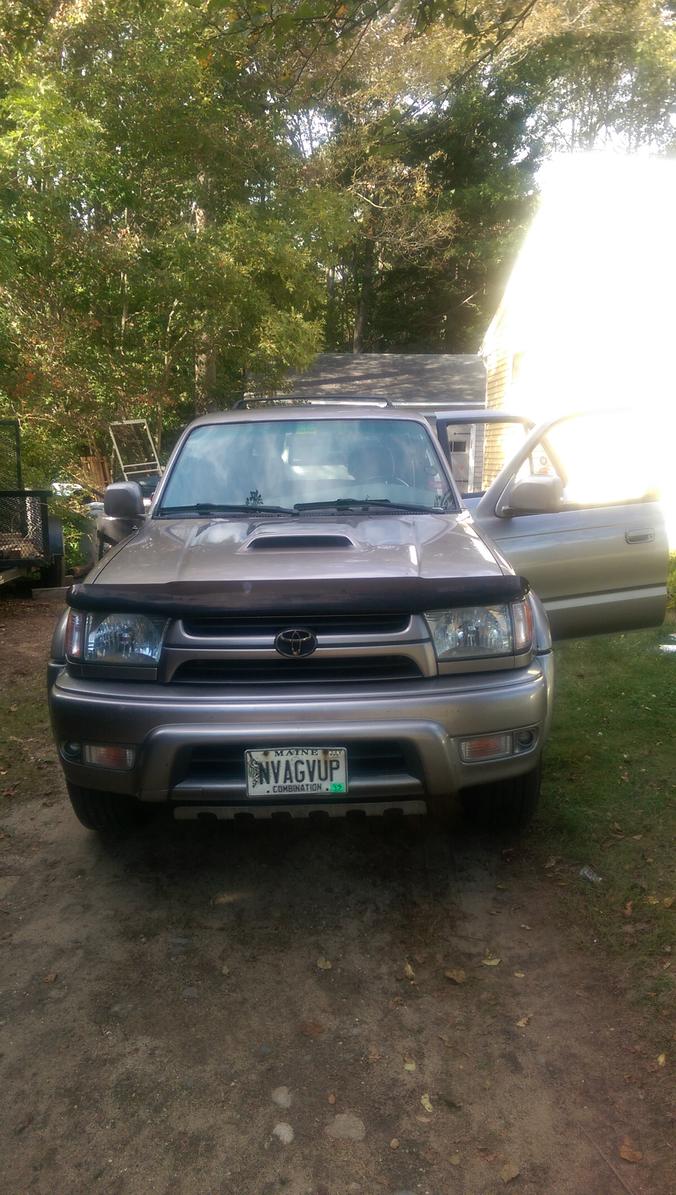

Headlights and Fog lights suddenly cut out. 2002 with 188K miles.
All other lights work including turn signals, brake, parking, dash lights, and all fuses are good. Anyone have any ideas other than the chipmiunks might have eaten some wire?
Is there a relay that powers the 2 headlights and 2 Fog lights that may have failed? Some moisture makes its way into drivers foot well if a heavy rain.
Until I figure it out it is a daytime driver only.
