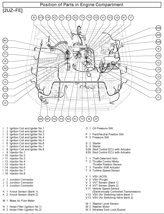

It could very well be the oil pump as the guys mentioned. The thing that makes me pause though is that oil pump failures on later modeled Toyota product is very rare (6 pages of searching "oil pump" here 7 pages at tundrasolutions produced zero hits that I could see). A squealing belt is sure an indication that something is wrong but that could be something else. I'd start by getting a stethoscope and isolating squeal and replacing the oil pressure sender. Also verify the connector and wiring is ok. Keep an eye on the temp gauge.
Do you have any info on replacing the oil pressure sender? Also, I have verified that the squeal is in the belt as I did a very very light spray on of wd40 on the belt about 2 weeks ago and the squeal subsided instantly. So I should start my fixing with a oil pressure sender and a serp belt and go from there?

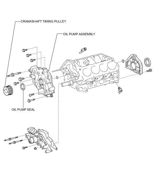

Second. The oil pump is not belt driven. It hasn't a thing to do with it. The oil pump is connected directly on the crankshaft.
Finally. If you heard a strong knocking or audible evidence of metal on metal, that isn't a pressure sending unit issue. I know in these situations one wants to hope for the best, but be logical. If it was just a simple issue of the sending unit being whack and giving wrong info to the computer, you would still have OK lubrication and should not have heard the audible metal on metal thunk you appear to suggest you heard.

Start by pulling the oil pan. A clogged pickup will cause this. I've never seen a Toyota oil pump fail in 4 years as a dealer tech.
Yea, my brother had this exact problem on his audi and it eventually caused oil pump failure with sludge build up so I will start with dropping the pan and checking it out and will probably look into one of the big engine sludge treatments if I find it to be real rough. Secondly, lubricant especially light lubricant and be used very effectively as a diagnosis on bad belts because within an hour of running time the lubricant is completely gone so if the wd40 on your belt initially removes your squeak and then returns, you know if you have a stretched or bad belt, even if there is no visible wear. I completely agree with you guys in this not being a sender unit or belt problem. I am going to start by pulling the pan and doing some looking around at things for sludge or just gummed up pump screens and all. Thank you guys for your help and direction
