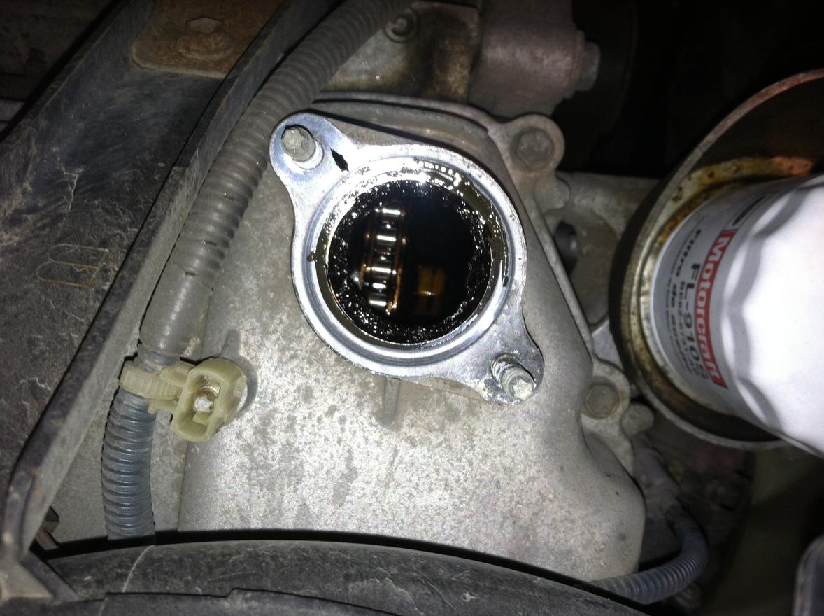

well I ran it for about 15-20mins with atf fluid and did some revving and all and there was no knocking but while i was waiting for it to cool down to drain the oil I took the fill housing off and this is what I found... sludge fest
Well, this is almost slightly oddly a good thing because you know the source.
I'd just drain that stuff and the atf with it now, and just refill with a quality ''high mileage'' oil, like a Valvoline high mileage. (IMO, you don't want to do any more harsh cleaning in there, but rather you got it loosened up now, and some will come out with your drain.
I'd change the oil again in 500 miles or so, then go back to regular oil changes.

Well the thing is I just bought the 4runner and I have only put 1000 miles on it but the guys I bought it from said he used 5w30 and changed every 4000-5000. I guess I am going to have some quotes done for a tear down and cleaning also just to weigh those options. Needless to say I better start checking oil fill holes much better before buyin vehicles
I would definitely get someone to price out how much it would cost to take the cams, valves, and springs, and have them put them through a parts cleaner. Also, you could also try finding a guide to take off one of the valve covers to get a even better visualization of the sludge problem you have.
When you have a sludge problem to the point of it clogging the pickup from your oil pump, then I don't think simple detergents will do the work considering you can't drive very long without the oil pressure light sending you a signal. The problem is of a bigger magnitude.
Look for a solid mechanic in your area that has experience with pulling the necessary parts to properly rid them of sludge. Keep us posted with whats in the bottom of your pan.

WOW, what a mess. The bigger issue now is how do you get the rest of the gunk out from where you can't clean?
Are there shops that can run a whole engine flush on it?
Or do you just run some good motor flush thru a few times.
Amsoil AMSOIL Engine and Transmission Flush has a flush
I don't think ATF is going to work on that sludge.
Here is some info that I found.
1
A subject that's been getting more attention these days is internal engine cleaning or flushing. This is being promoted by the quick oil-change people, among others, with the advice that if you clean out the engine of accumulated sludge, deposits and other disgusting stuff, it will run better and hopefully longer. Is this effective or not? As usual, when it comes to things automotive, the answer is both yes and no.
2
If you've read other articles on engine oils, you'll know that unless the oil is changed frequently, not only will the oil's "oiliness" will go away, but varnish and other compounds will form inside the engine. These get deposited at various places including the small oil galleys( passages) and begin to restrict oil flow-much in the way that cholesterol blocks flow in a similar, biological system.
Personally, I consider engine flushes a waste of money, but they can be beneficial, in certain limited situations. For example, an engine flush might be useful in a relatively low mileage car with 30,000-40,000 miles that hasn't had its oil changed as often as it should have been-such a car may be an off-lease car. At this point, cleaning the engines innards may prove to be beneficial because sludge and varnish buildup may not be that bad yet. Notice how many times the word "may" is used here-you can't really know for sure without taking the engine apart.

You may be able to get an idea of what the engine looks like inside if you're able to remove a valve cover. On some engines, where there aren't tons of hoses, lines and other things over it, it's all a matter of removing a few bolts. A clean engine will not have any encrusted deposits on the cover or any other deposits on the cylinder heads. I've seen engines where there's been so much coking (crusty deposits) that after the valve cover has been removed, that a perfect mold of the valve cover (writing and all) has been formed on top the cylinder head so it looks like the valve cover hasn't been removed at all! And I've seen engines that after the intake manifold has been removed (on a V-8) all you see is a huge mass of black carbon in the lifter valley. It's always amazed that such engines still run.
4
On a badly maintained engine, there's probably already too many deposits for the flushing chemicals to completely remove. But the real danger here is that the chemicals will dislodge enough crud that it will block the very small passages in hydraulic lifters or even clog up the fine mesh oil pump pickup screens. On such engines, you're better off changing the oil frequently, say around every 2,000 miles, so that the natural cleaning properties of the oil will reduce, somewhat, accumulated deposits.

With the excessive sludge I would suspect excessive blow-by or excessive lack of breathing (Old School that should still apply). Did you run a compression check (and good results) or do any diagnostic work prior to the purchase? Were there any written or gentlemen’s agreements on the conditions of the T4R? This has to be hard to deal with @ only 1000 mi. There had to be some indications of this condition as sluggish, high temp gauge, blown valve cover gaskets on and on. Man! I Hope You The Best. Jow
PS. You oil filler pic made me go out and take a look, which is good at 46,000+ purchased @ 43,000+ Certified + Ext Warr. Really, I wanted to see that oil filler top hold or pull a dollar to show low vacuum vs blow-by (but too much air from the fan). Was that all carbon build-up on the oil pick-up tube or any gasket materials? You are doing a super job but please look for causes other than lack of oil changes. Toyota had an oil jelling problem in some cars in the past (I think I read w/o remembering the cause).
